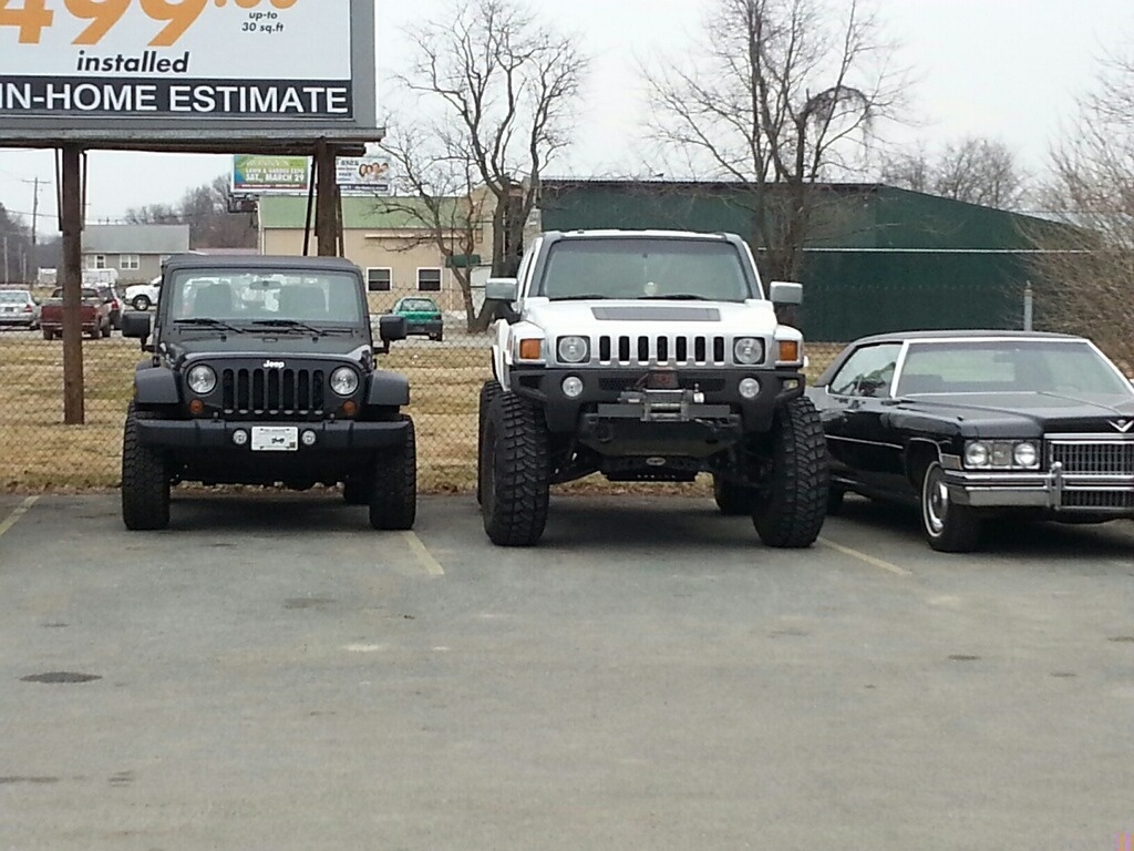

This guy did a 2" B.L.
Offcourse he went all the way and added 40" tires on top of a rancho.
You can see he modded his front bumper really well to hide the B.L. the rear bumper was relocated upwards too.
