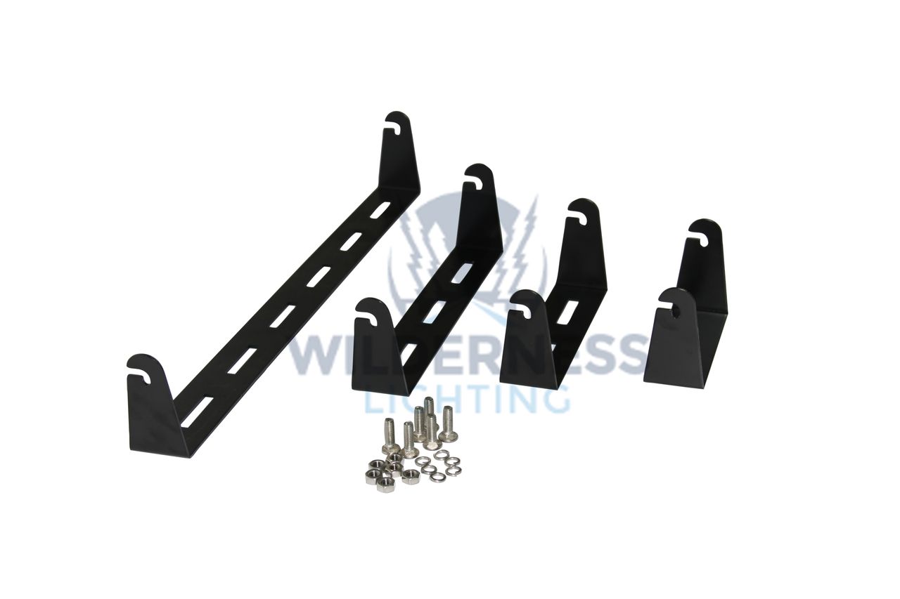

Im sorry about the drawing part, but below is a picture of the U cradle:

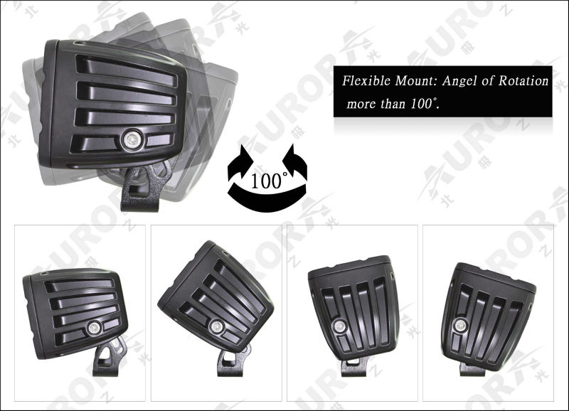

We can mount the 40" in the middle of the cradle, and one D2 on each side. If the D2s mount like the Auroras I have:
Then the D2s body can probably overlap abit over the base mount of the 40" light bar mounts hiding part of it, and you can have them pointing slightly sideways for more side coverage!
The cradle can then be mounted directly to the G2 mounts.
Offcourse thats ALL talk, but unless I figure out a way to sell my 40" and wait for a 50" (or an alternative way to mount them), this is what Im planning to do.
