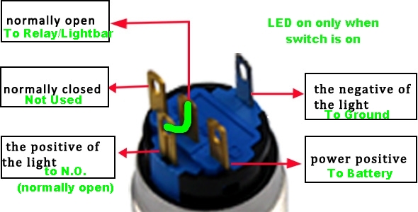

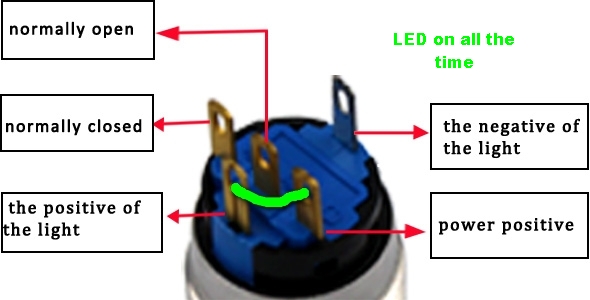

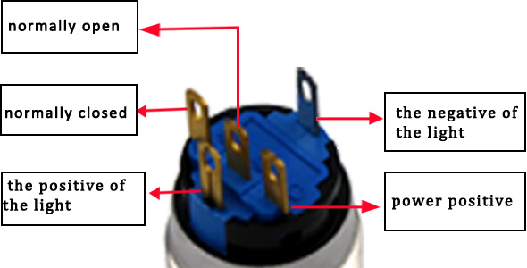

I've seen a number of posts where people keep asking about the LED on the switch remaining on all the time. It is simply the way you wire the switch. Look at the pics below of a typical 5-terminal lighted switch:
"Power Positive" is the one that comes from your battery (it is typically labeled as "COM").
"Normally Open" is the one that goes to your relay/lightbar, labeled "NO".
"Normally Closed" is not used in this application, labeled "NC".
"Negative of the light" is the ground for the switch's LED; this should go to ground, labeled "GND" or "(-)".
"Positive of the light" is the + side of the switch LED, and will determine when that LED is on, usually labeled "(+)". Hook it to the "Power Positive" and the LED be on all the time (left pic). Hook it to the "Normally Open" and it will only be on when the switch is turned on (right pic).
A rectangular switch will have the same terminals/labels, just a different layout of course.
Sorry, I can't seem to get rid of all of these extra images showing up (below), and I can't figure out how to delete a post and start over.

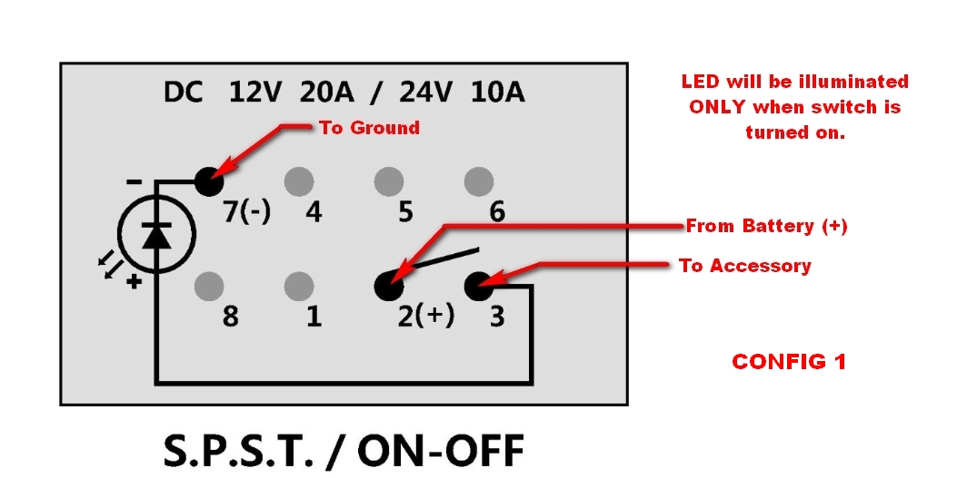

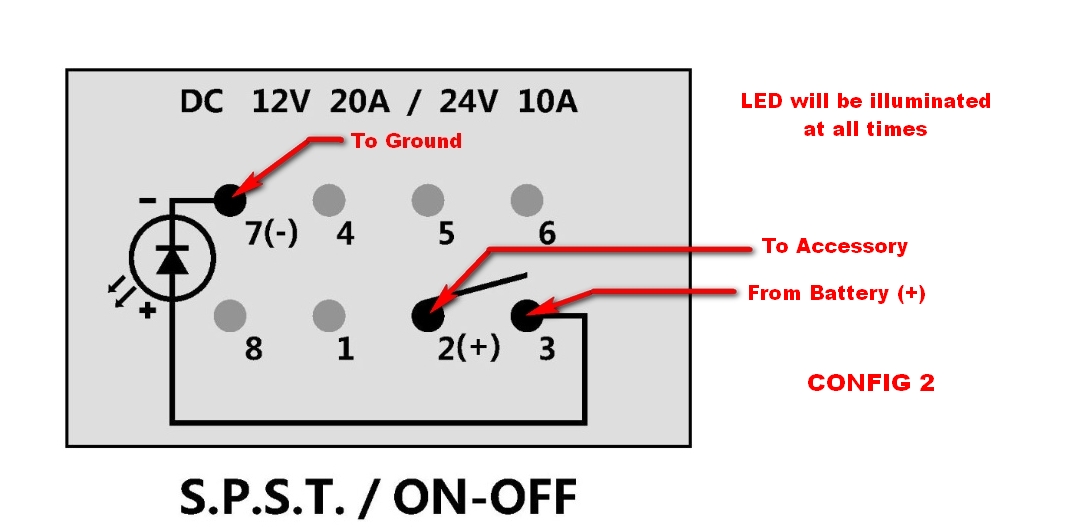

I tried to change the wires up on the 5 prong rocker so the led would only turn on when I flicked the switch but it was led light or no light
so now my light is always on for my bar

Any way to post a pic of the back of your switch? Or post the list of your switch terminals (C or COM, NC, NO, +, -) and what each is wired to, and I'll try to solve the problem. Any 5 terminal illuminated switch can be wired to illuminate only when the switch is turned on, or only when turned off, or all the time; whichever you choose.

mine also isn't grounded to the body, just the battery
and I used a harness I got off amazon which uses a relay and does not have more than one ground

So there is only 3 terminals on the back of the switch?
#7 should go to ground (chassis or battery, no difference).
#2 should come from your battery (+).
#3 should be going out to your lightbar relay.
I suspect that you have #2 and #3 swapped. Also, #7 can share the same ground with your relay, but they both still must actually go to a ground point (chassis or battery (-)).
With the way those particular switches are setup, you have to disassemble them to rewire the LED, it's not as simple as just changing where the terminal is hooked up. That schematic looks like there actually is not a separate terminal for the LED other than the negative terminal (and hooking that to positive won't do anything except possibly blow the LED).

Correct, the LED's positive is wired internally to terminal #3. That means the LED will be illuminated when terminal #3 is hot. So if you hook your incoming power from the battery to #3 and the accessory (lightbar/relay) to #2, then the LED's positive side is always hot and it will be on all the time (because terminal #3 is always hot). If, however, you hook the incoming power from the battery to #2 and the accessory (lightbar/relay) to #3, then the LED's positive side will only be hot when the switch is turned on (because that is the only time that terminal #3 will be hot). There is no need to disassemble the switch or "rewire" the LED to get it to work right. See the diagrams below, for the exact switch in question:
