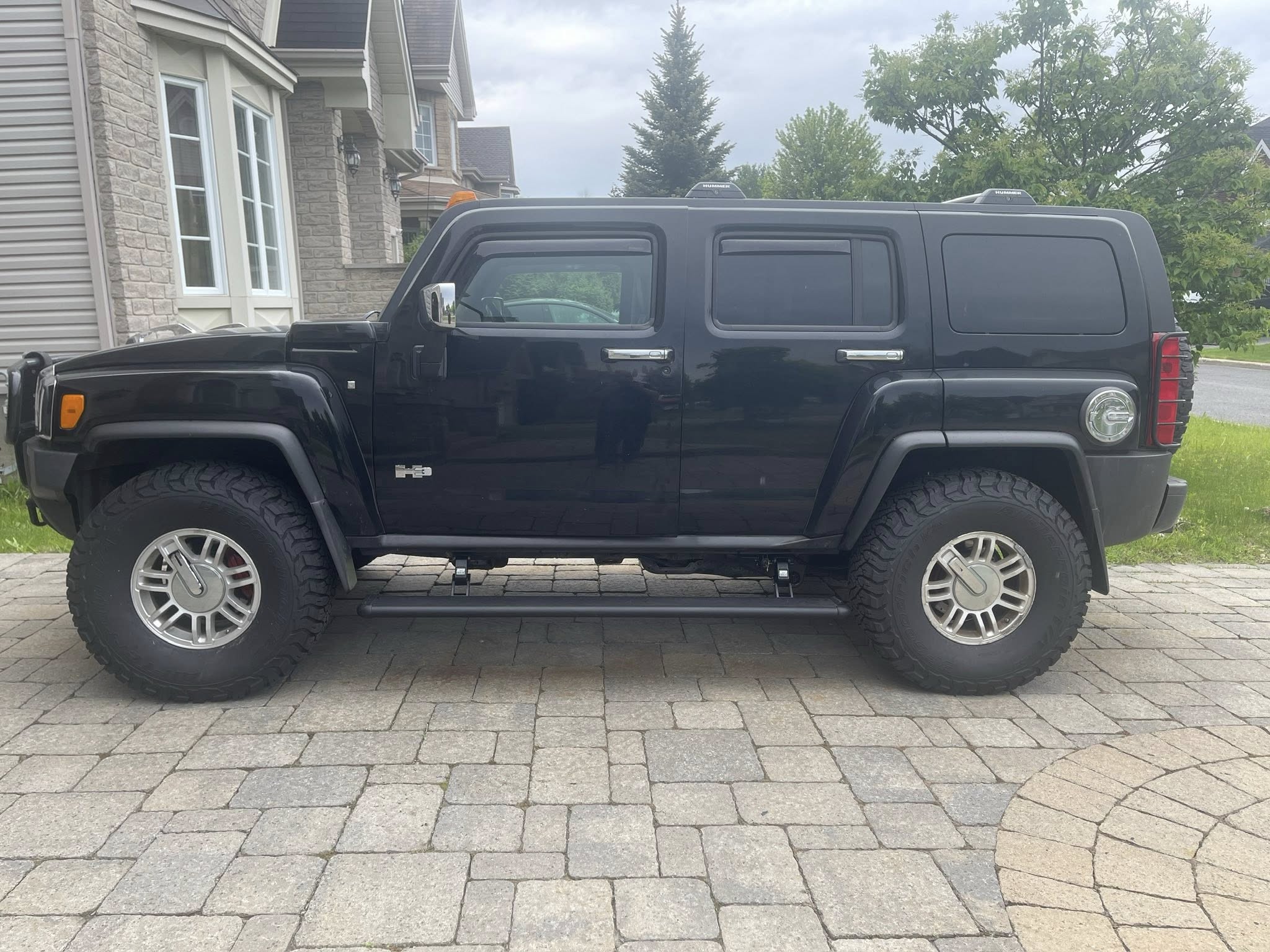

New BF Goodrich All-Terrain T/A KO3 315/75R16 and AmpResearch Power Step on my 2008 Hummer H3 Alpha 🤘🤘
