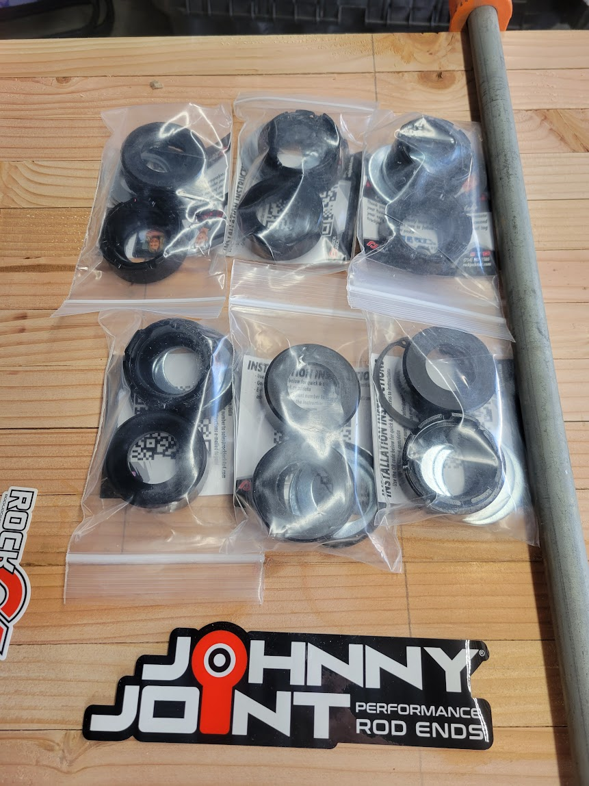

Will be busy next weekend replacing Johnny Joints. Sand Hollow prep has started.

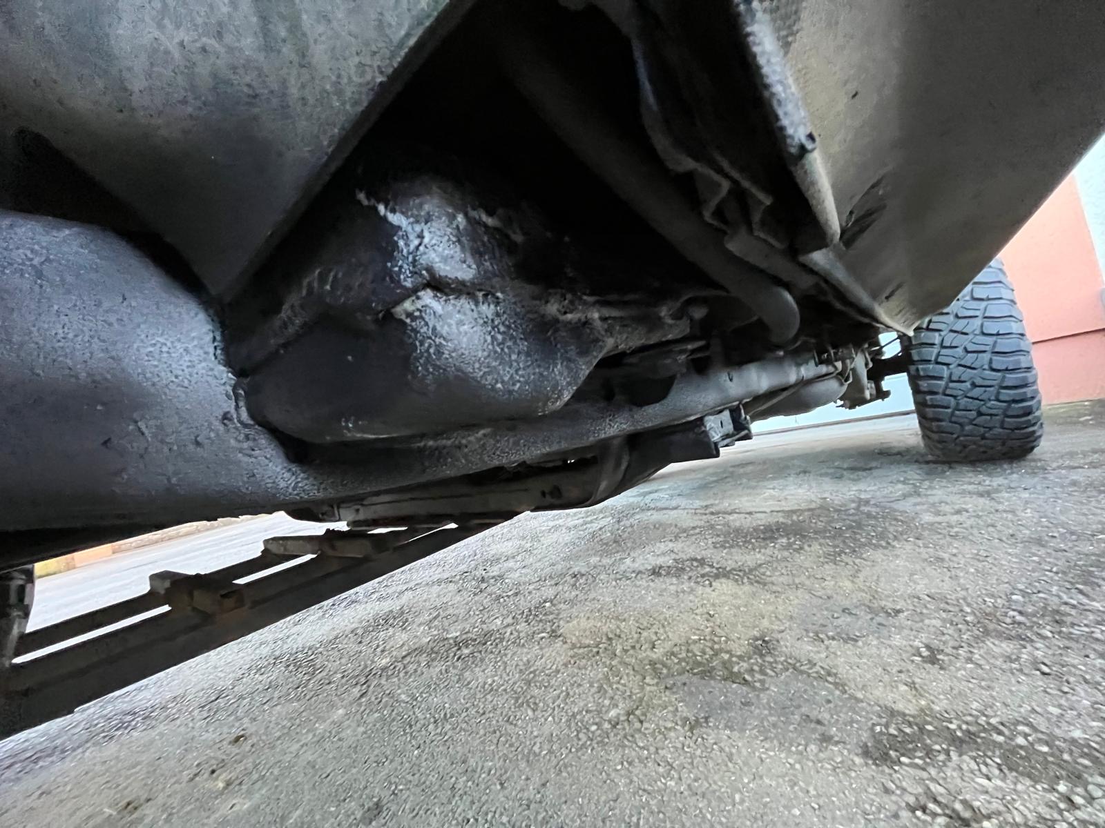

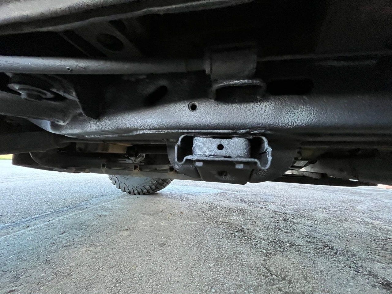

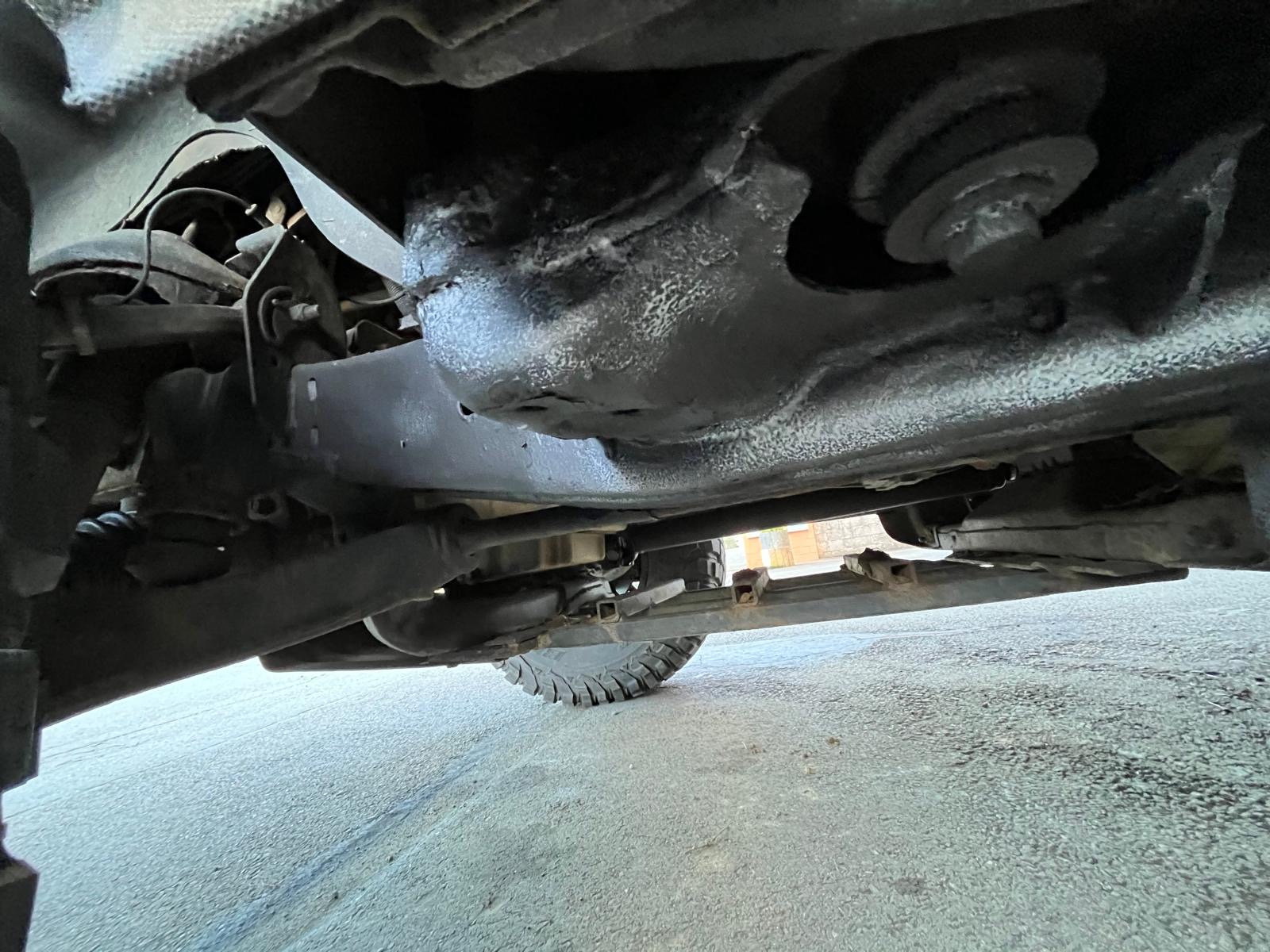

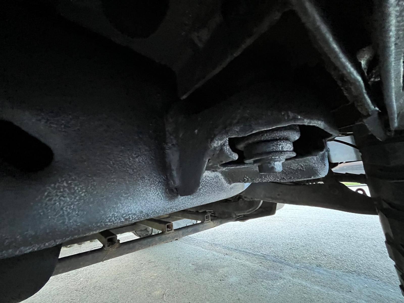

So this time my Hummer got some new chassis protection, rust treatment an wax at front, after the body mounts on driver and passenger side got cleaned, rust treatment and new all round welded ...just in case ;)
Then painted again all in black with ...eh like Rustoleum paint
Now my Hummer is 10 years younger again :cool: made by my professional Buddy , in his garage (he loves oldies and US trucks)
Few pics

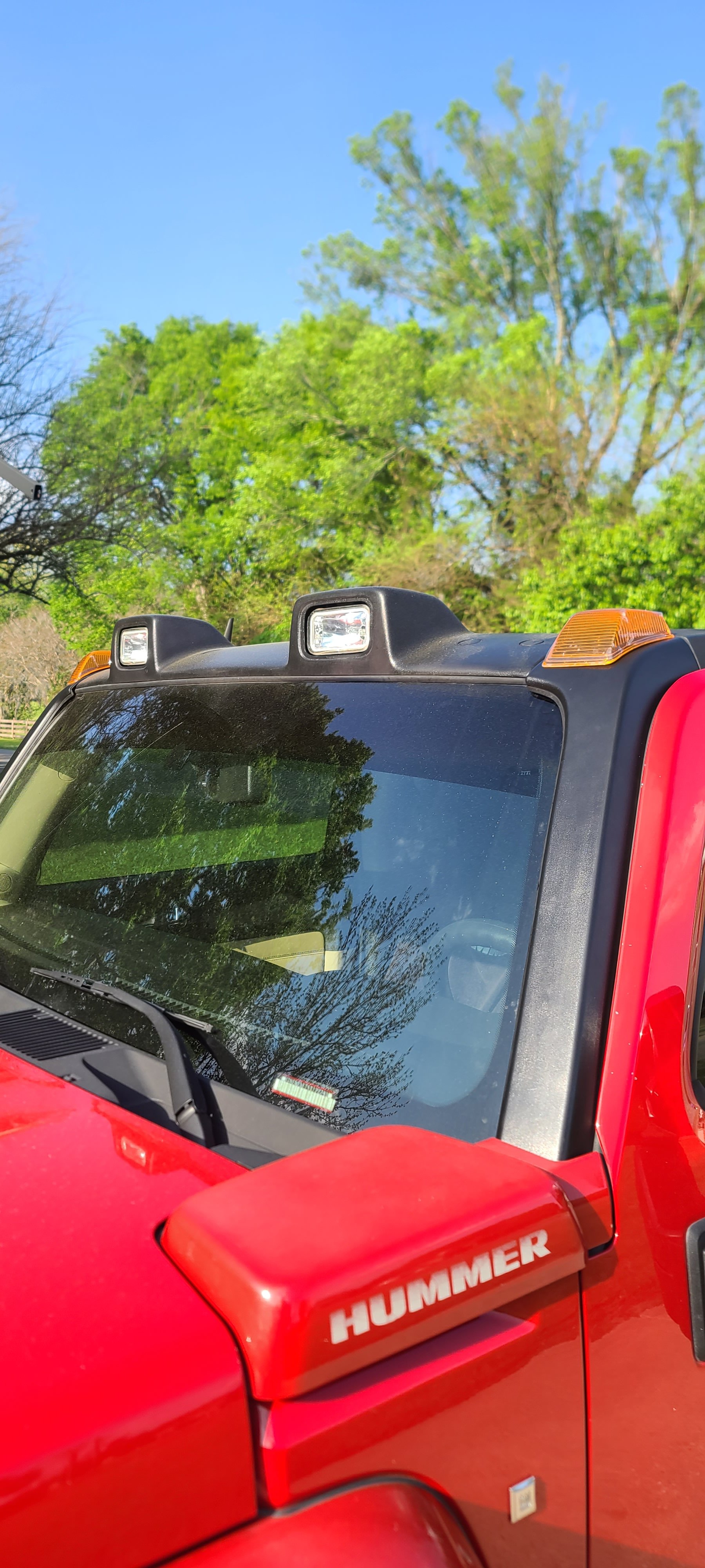

Installed marker lights on the windshield trim.

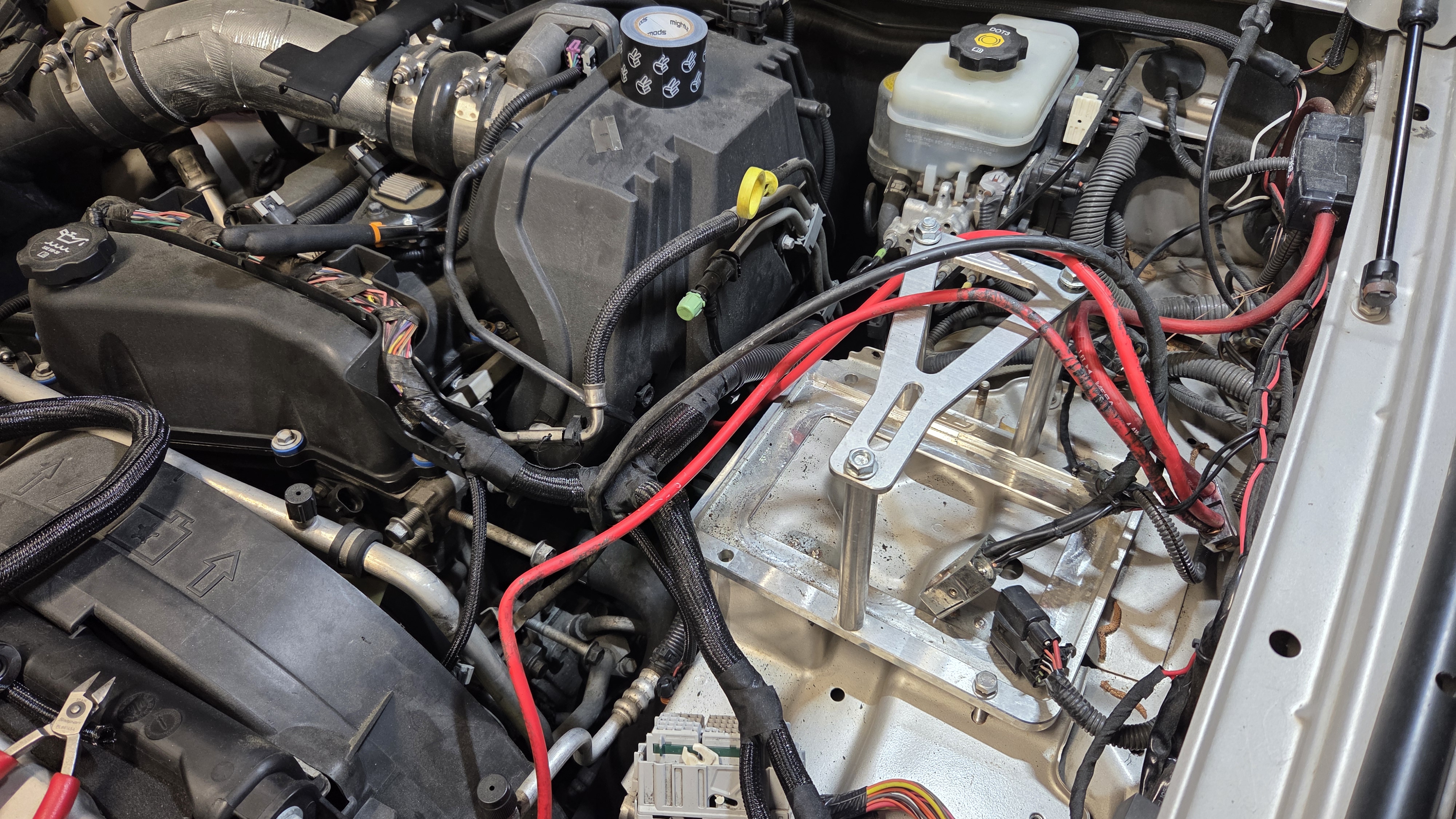

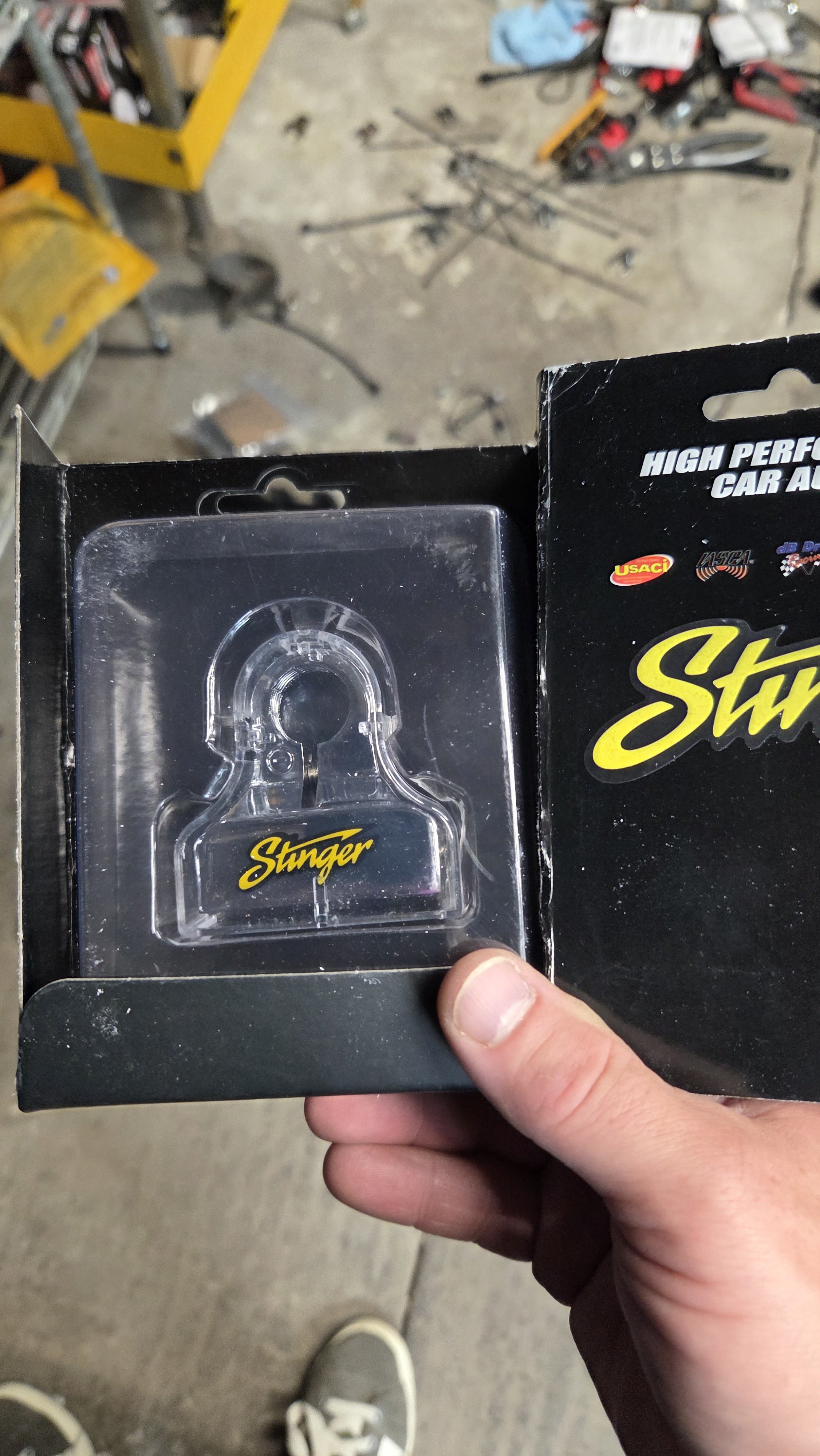

Re doing the wire loom and upgrading the battery cables to 2 gauge.

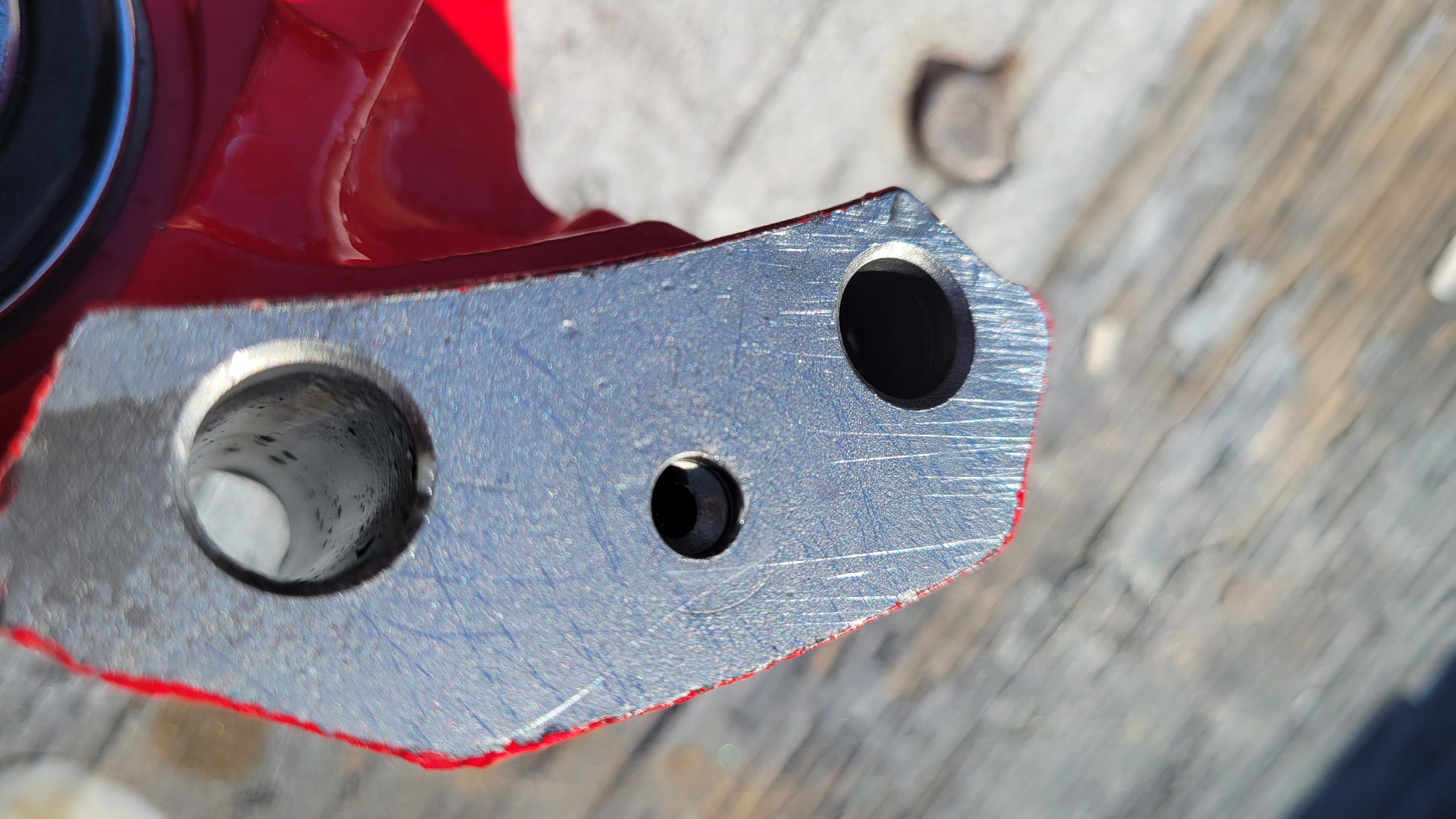

Some concerns with PowerStop calipers. Supposed to be pressure tested but leaks with no brake pressure. Last set had early failures too, quality has dropped.
We were maintaining around 10 h3s at one point and were exclusively using powerstop z36 full kits with calipers as they came due for new brakes. Were were swapping over to powerstop and new stainless hardlines and soft lines with full fluid flush. About four years ago there was a national shortage of H3 powerstop calipers and they must have switched to a new manufacture as we started having issues with them leaking and eventually seizing. No good replacements unfortunately since then. Same issue with the "OEM" calipers from GM parts
