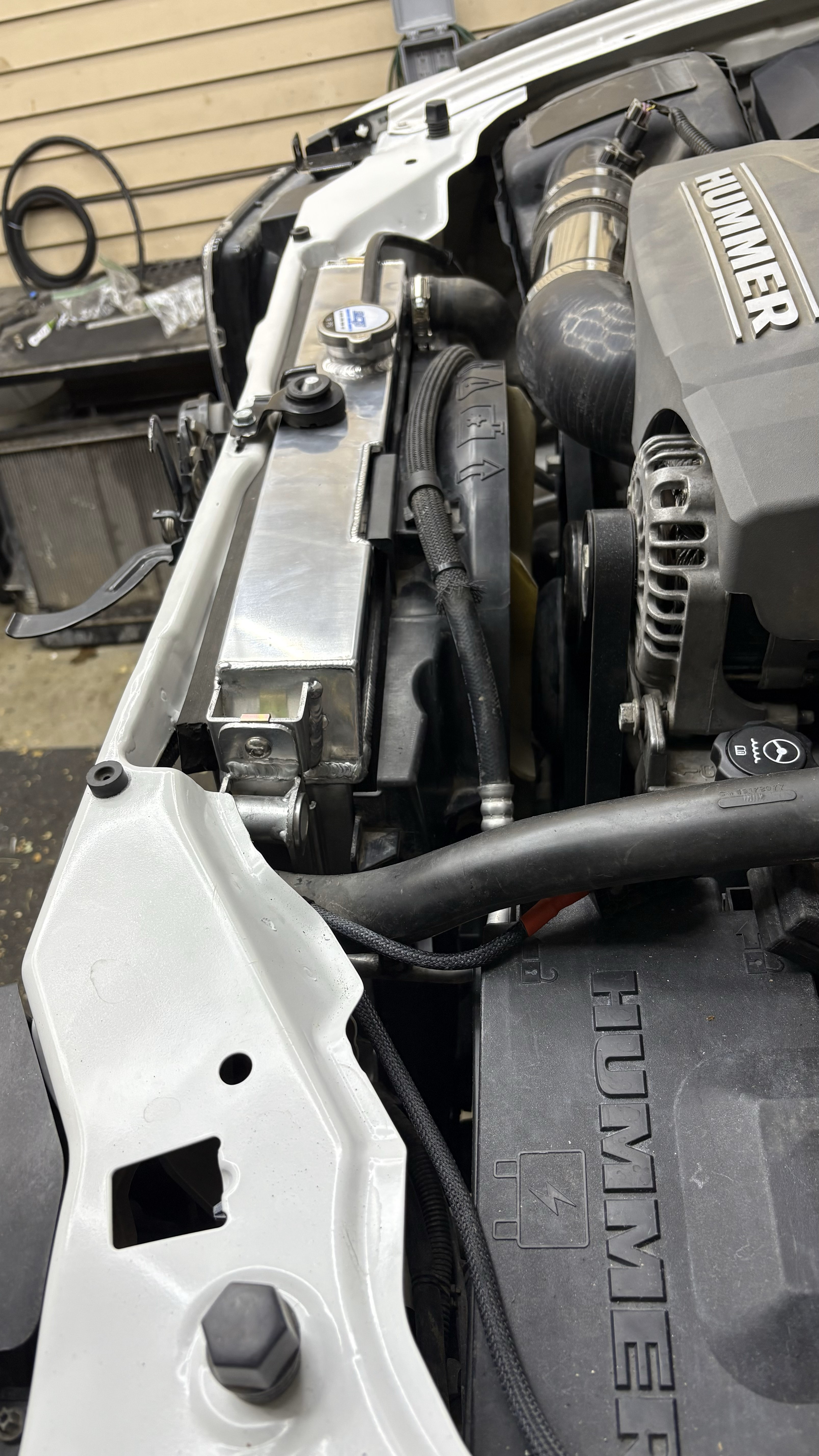

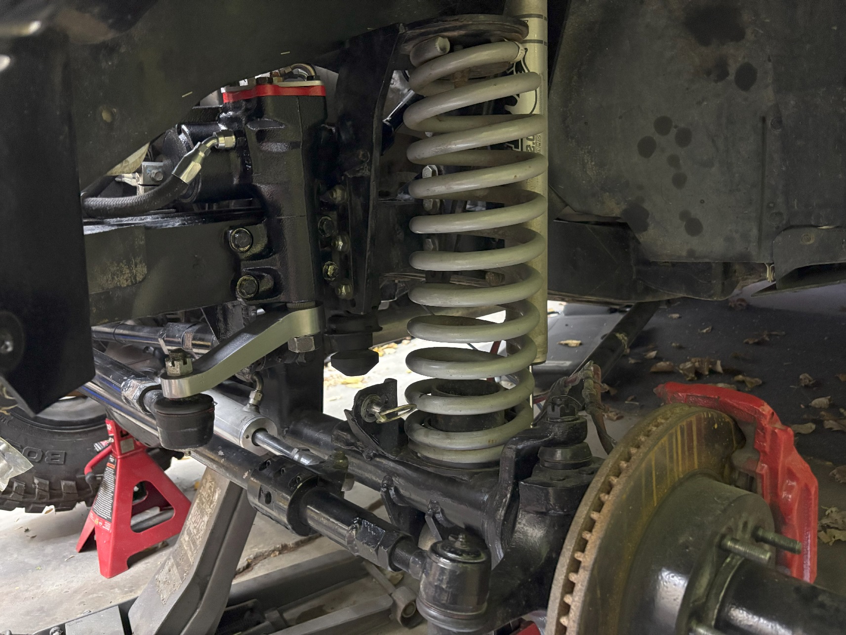

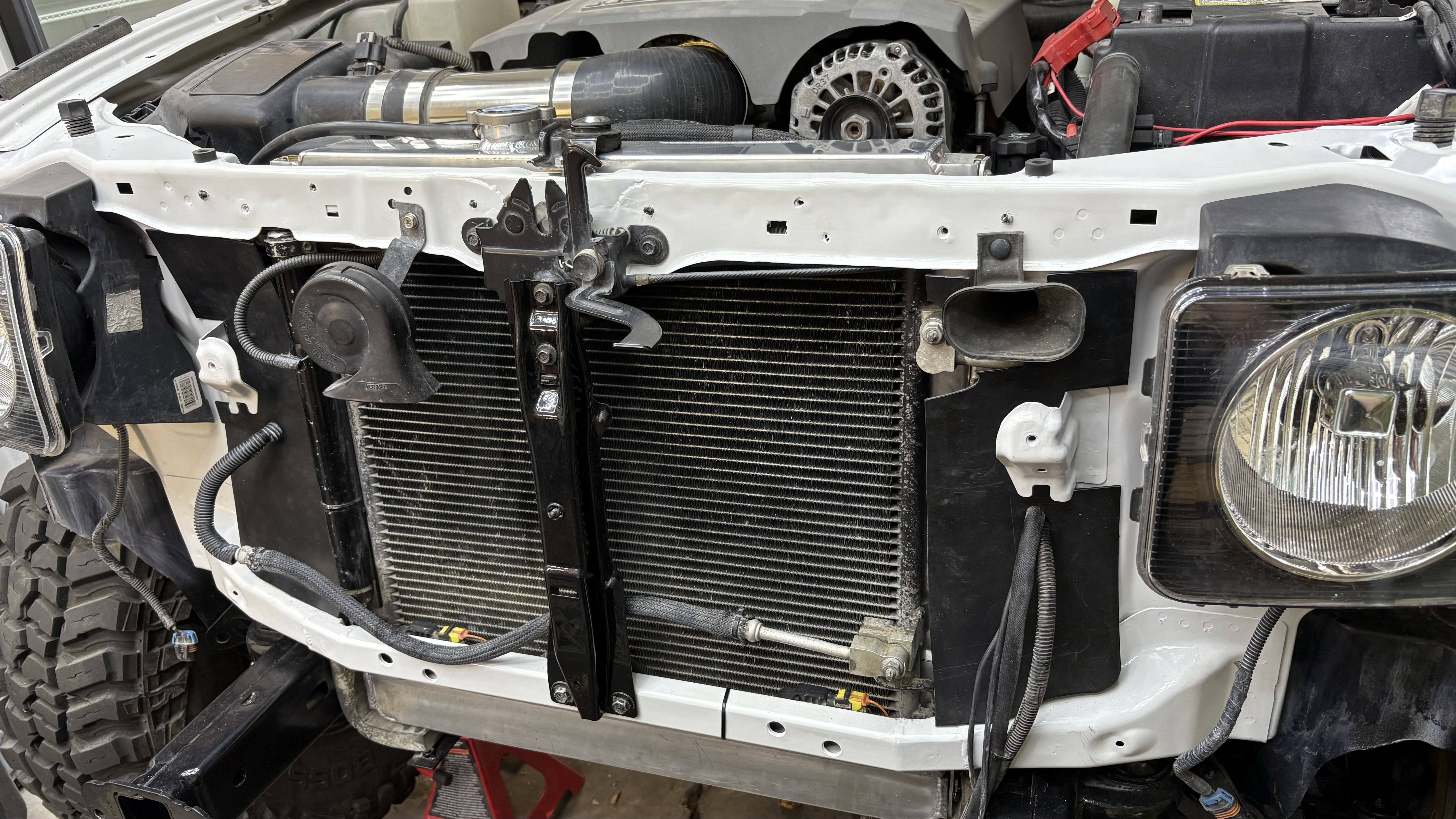

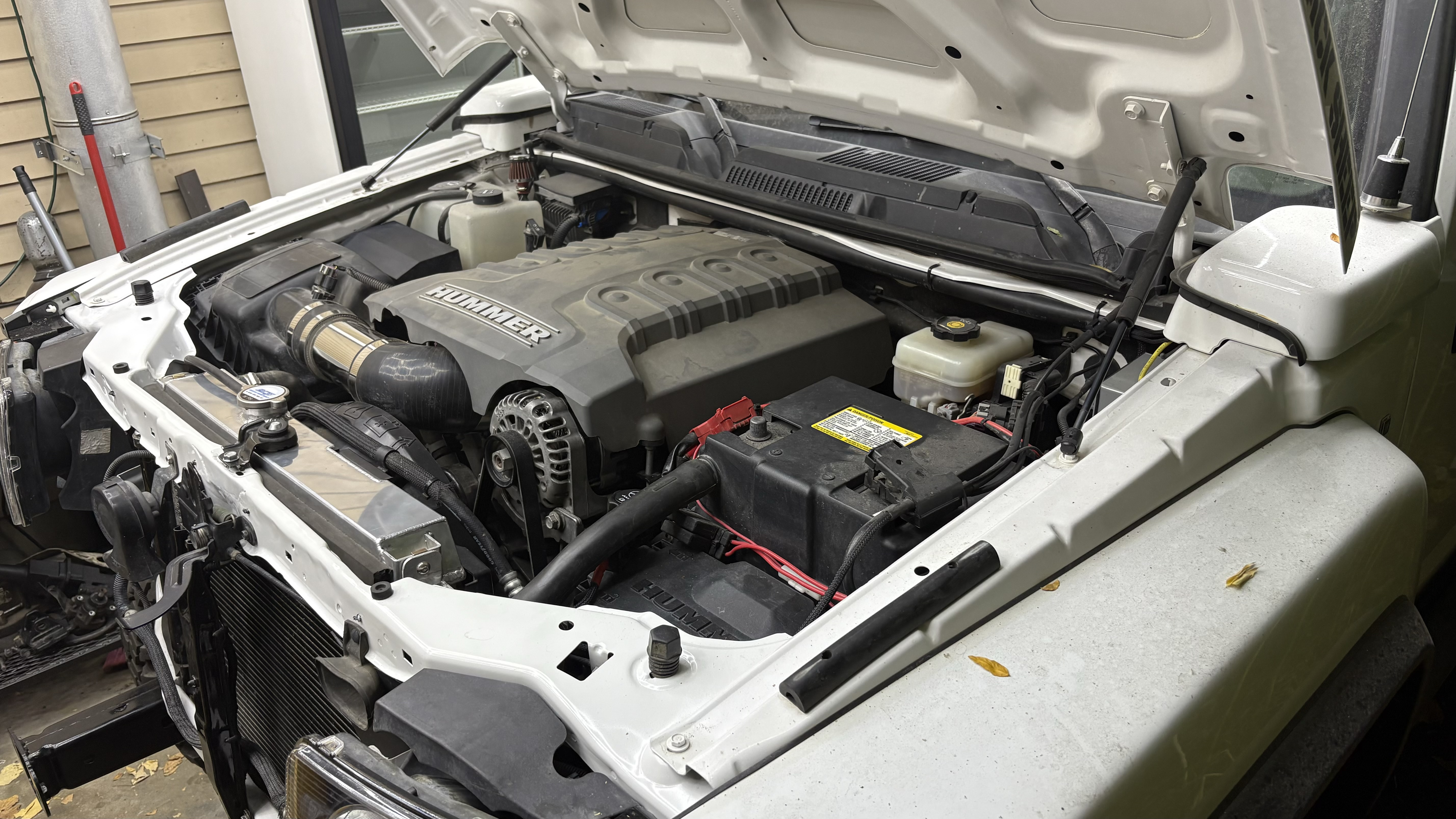

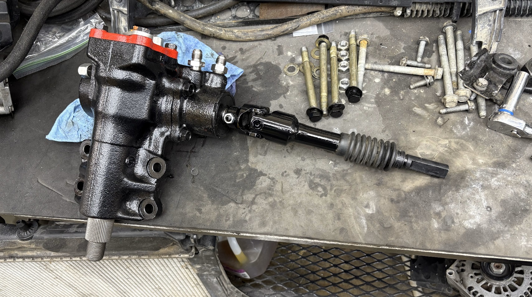

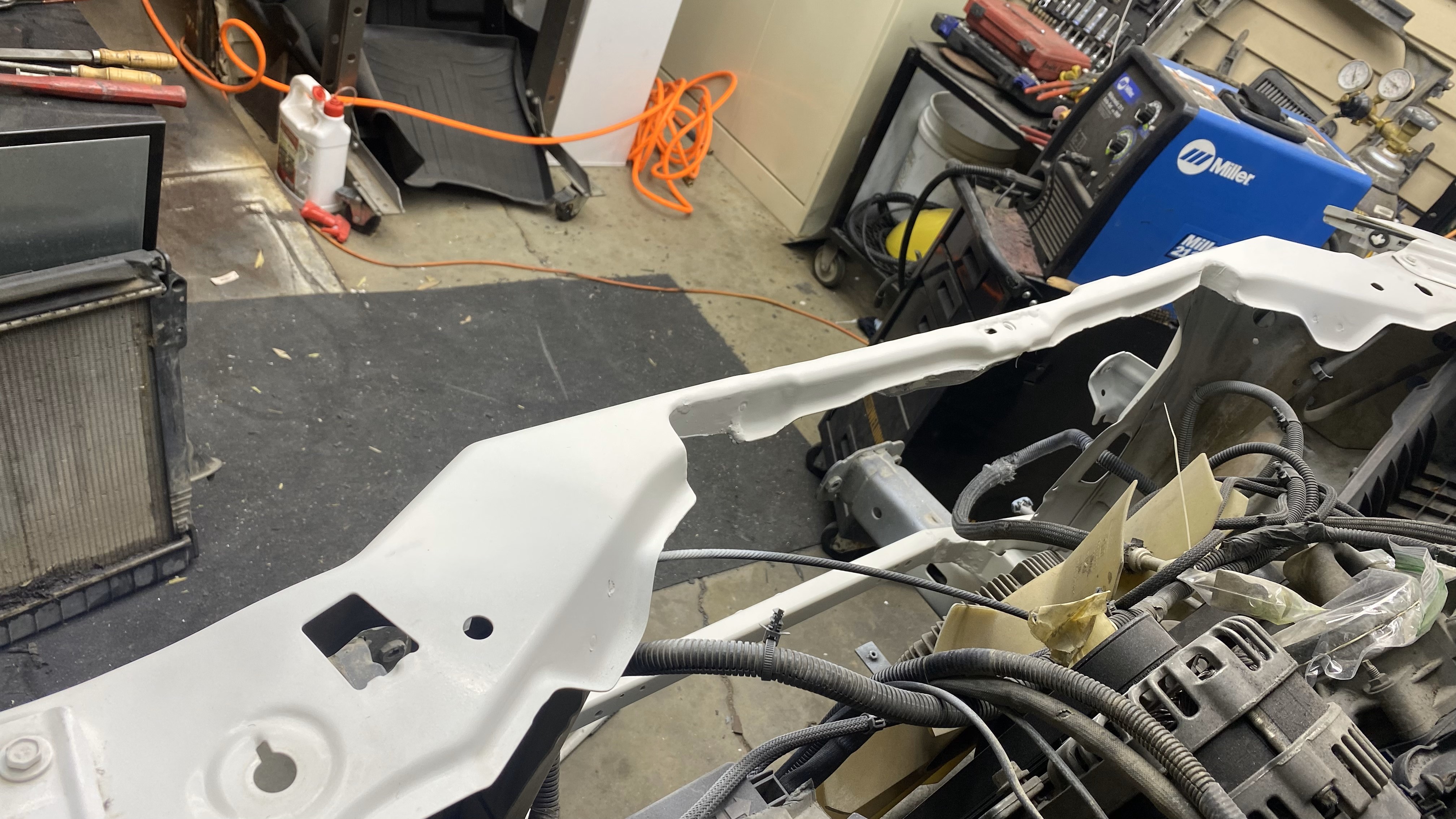

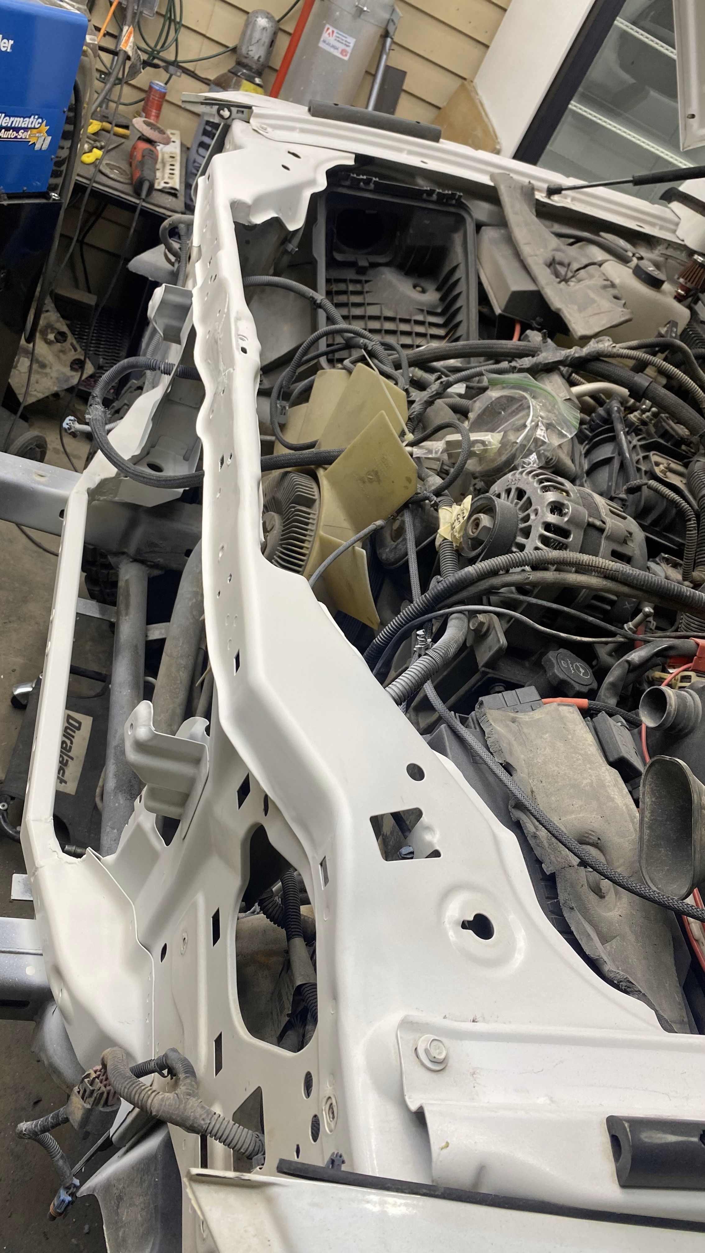

ECP radiator finally in. Cut out and rebuilt the lower core support for clearance and a little nip tuck on the upper core support to push the new much larger radiator forward one inch similar to what 06H3 did with his. Had the FJ60 steering box rebuilt by Red Head and replaced the Borgeson U joint on the steering while I had everything apart.
