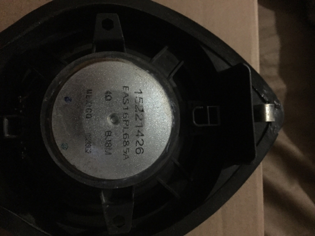

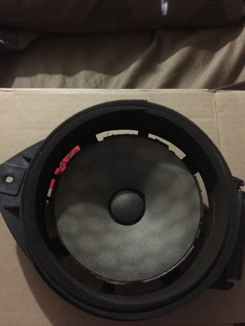

Well I got my order from Amazon today... ImageUploadedByTapatalk1449165334.536590.jpgImageUploadedByTapatalk1449165343.872469.jpgImageUploadedByTapatalk1449165353.524886.jpg
I ordered two of the "Monsoon" speakers. I only opened one box and that is what I found.
The sticker on the box has the right part number but obviously that is the regular speaker and it is completely messed up.
I'm going to return these and get a refund.

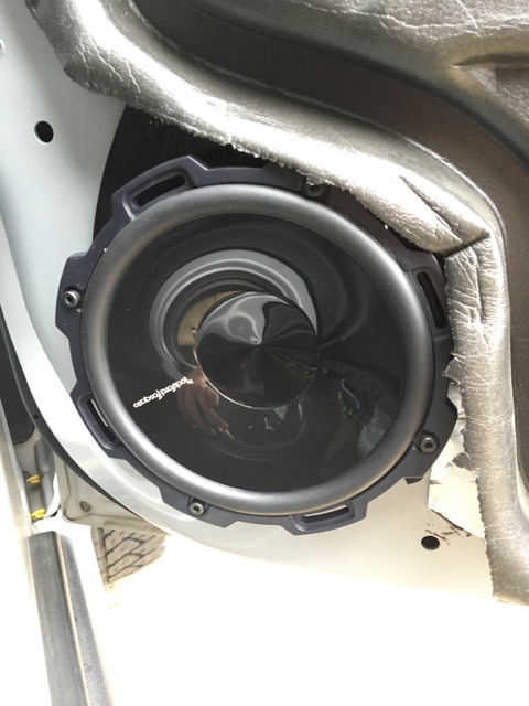

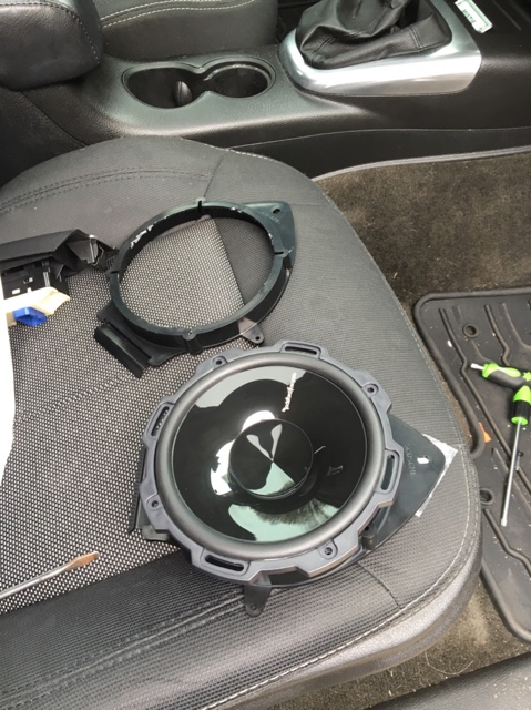

I installed some Rockford Fosgate 6.75 speakers in the front doors today. I had to cut some tabs off the speaker adapter to make them fit. ImageUploadedByTapatalk1449941709.175064.jpgImageUploadedByTapatalk1449941718.340283.jpgImageUploadedByTapatalk1449941728.058610.jpgImageUploadedByTapatalk1449941736.942267.jpgImageUploadedByTapatalk1449941746.875178.jpg
I was worried that I might have to get an amp to give these speakers enough power, but my Kenwood head unit powers then good enough for my tastes.
Overall I'm really impressed with these speakers.

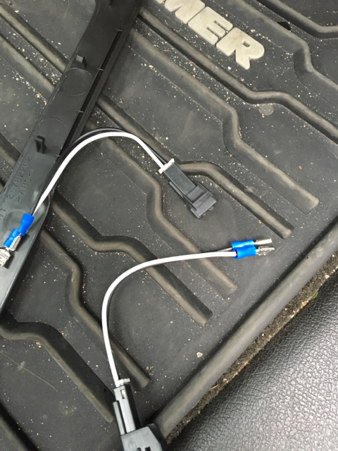

Anyway long story short my speaker connectors in both front door speaker had water in them. It rained pretty good all day yesterday and some last night. The inside of the doors were dry, just the connectors had water on them somehow.
This connector:
So I dried them off, put some dielectric grease on them, and then wrapped them in electrical tape to try to keep it from happening again. I thought about covering the connectors in liquid tape but I couldn't find my bottle. I also pulled the radio fuse and it was good. Anyway now the speakers work again:sigh:

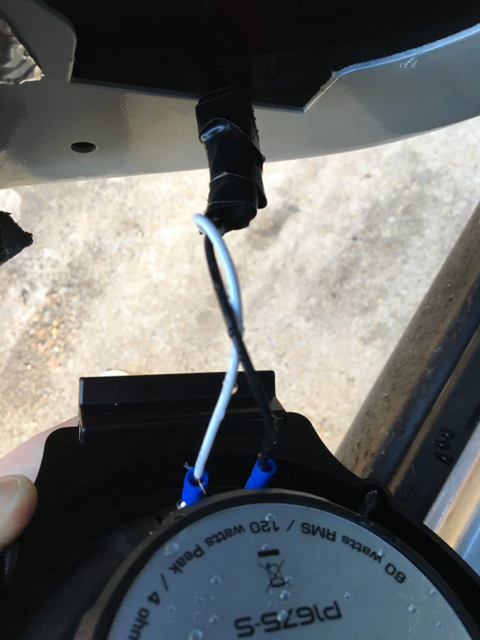

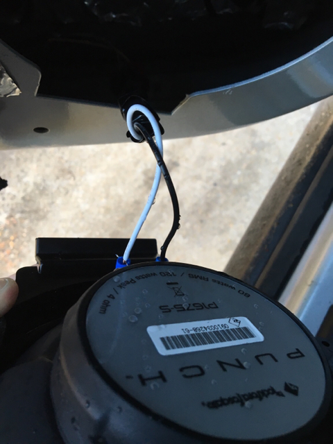

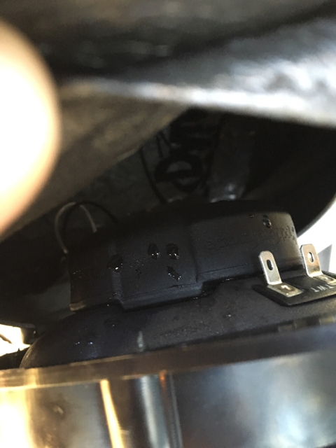

Well the speakers stopped working again. I got the same miswiring Dc offset error on the head unit. So I pulled the fuse again(didn't look bad) and put a new fuse in and the speakers worked for like one minute and then stopped and the error message came up.
So I took my drivers side door panel off and found a lot of water droplets on the speaker and wires... So I guess I can't roll down my window after it has rained...
I'm going to try to dry it out and cover all the connectors with liquid tape.

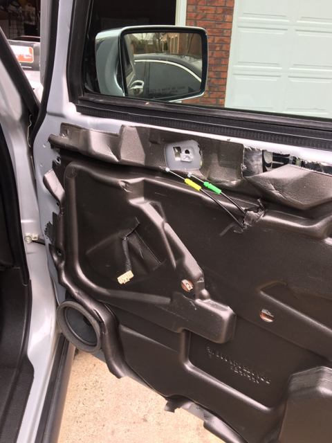

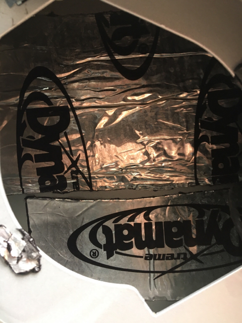

ImageUploadedByTapatalk1450907262.287747.jpgImageUploadedByTapatalk1450907272.888309.jpgImageUploadedByTapatalk1450907285.372568.jpg
Ghostbuster
862
All of the speakers had water dripping on them. I took all the door panels off and I covered all of the connectors with liquid tape. Then when I was reinstalling the last speaker, I noticed that it cut off when fully installed into the door panel. It was like if you push it back far enough it was pinching a wire or something, and if you pulled it out just a little, then it would start playing again. Well it turns out that one of the speaker screws was contacting the metal door panel and shorting it out. You can actually see in one of the pictures where the screw has scuffed up the paint. Well I unscrewed that bottom screw and cut a little bit of the screw off so it wouldn't touch anymore.
Hopefully that is the last time I have to pull all of the door panels off again.
