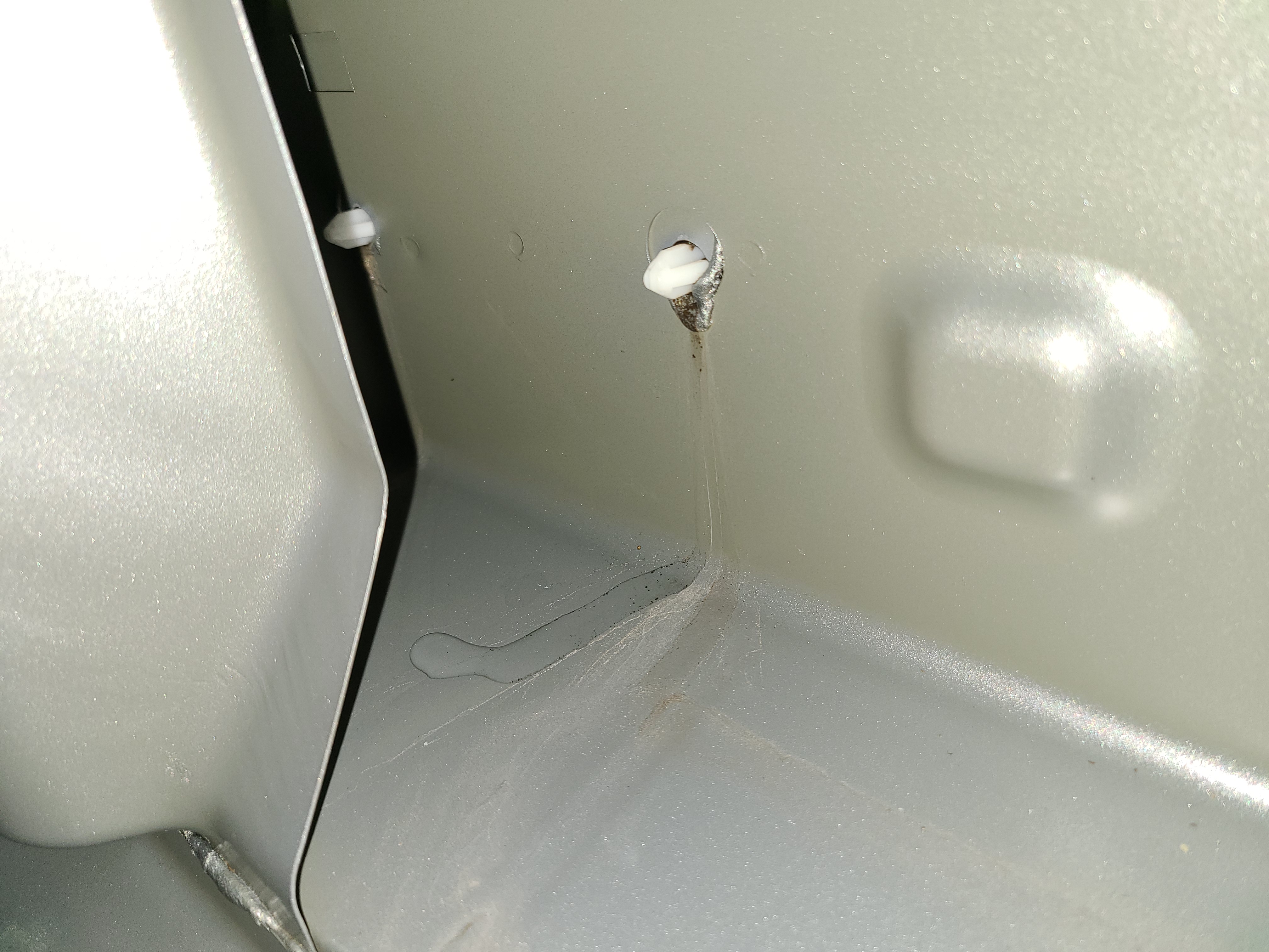

I decided to remove the passenger side rear interior panels as well as the rear cargo padding to measure/plan for the sleeping platform I just mentioned, and I discovered that the insulation in that padding was SOAKED with water. I drove a lot in slush/rain recently.
I'm pretty sure the water is coming in from the body clips on both sides that hold the rear outer fenders in place because there are trails of dirt coming down from them (need to get the hose out to verify. I'll try that today if I feel better than I did yesterday). Has anyone else run into that issue? I'm thinking I might just gob RTV over those holes to seal them up but that would sort of 'glue' those clips in place which isn't ideal.
The clips are the little white protrusions that you can see here coming through the vertical section of body inside the little cubby area:

Well, didn't even have to play with the hose. It's raining, not very hard mind you, and I saw this. Sigh.

Hadn't realized these were so leaky until I dealt with and researched everyone's favorite sunroof leak the first summer I had it (screw that... sealed it), and now this. An allergic reaction to mold exposure nearly killed me once... I don't want to mess around.
If possible, I might try using real bolts, nuts, and rubber washers in place of the plastic clips with the pathetic thin foam gaskets that the factory thought was just fine. I looked at some fender pics and it looks like it might be doable (with two people or some enginuity).

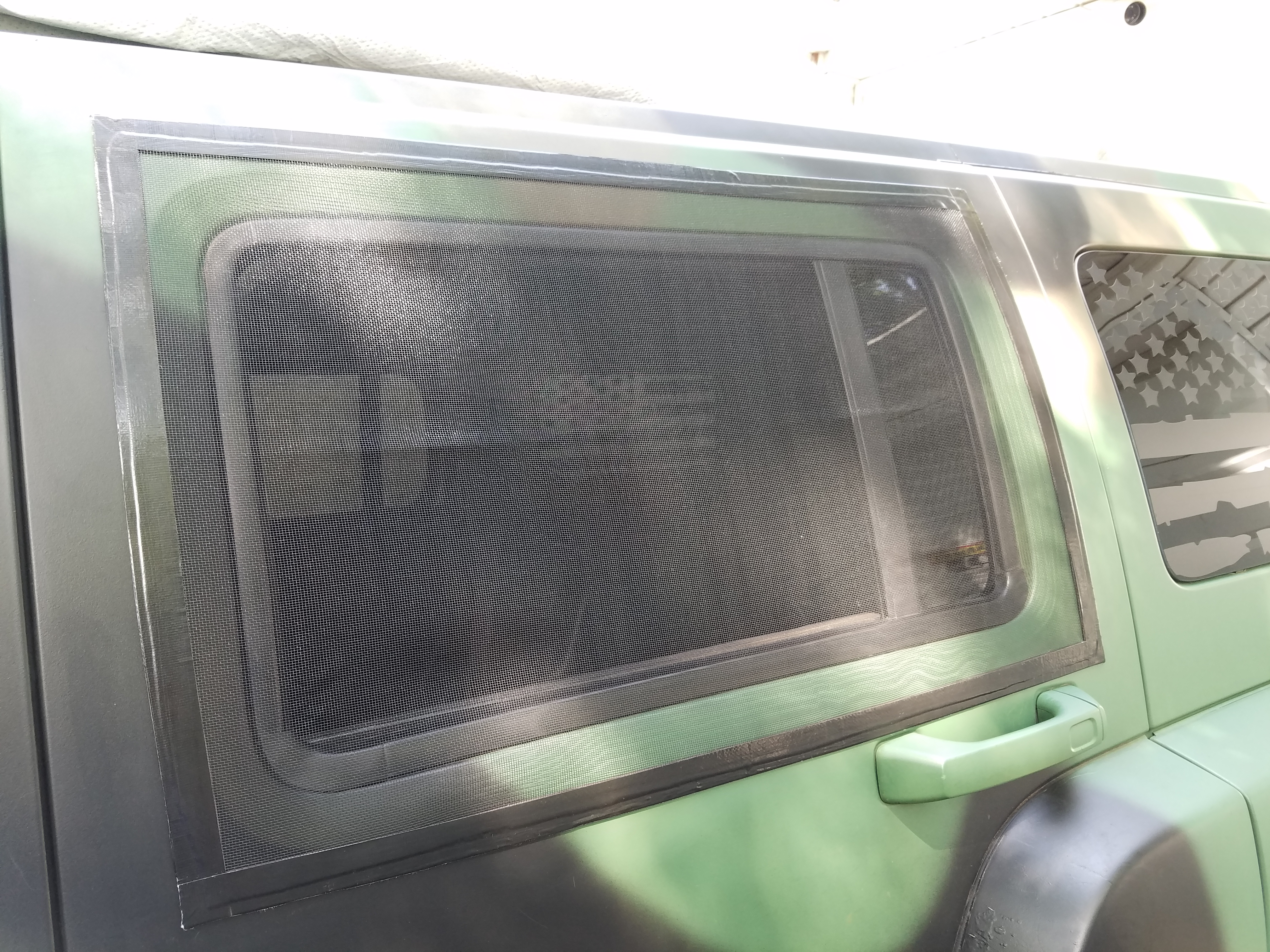

I'll try to post something positive though... Look at the driver side magnetic bug screen I made prior to my Flagpole trip (passenger side same but mirrored). They worked beautifully:

Stationary was the intention, primarily for overnight sleeping but for whenever at rest because the skeeters can get real bad in the summer.
The magnet strips aren't super strong but I imagine they might stay on up to a pretty reasonable speed. However, branches on the tight trails in this region mean that they definitely stay off during the trail rides.
I decided to make a full border of magnet strip to create an easy 'bug-tight' seal all the way around.
It's nice that I can roll up or down the windows as much as I want without messing with the screens.
I've been considering making a window insert for one side for some small panel mount fans. I would still use these screens with that because there's plenty of clearance and I wouldn't have to let the mosquitos in to mount or dismount it. If I ever do that then I'll post about it.

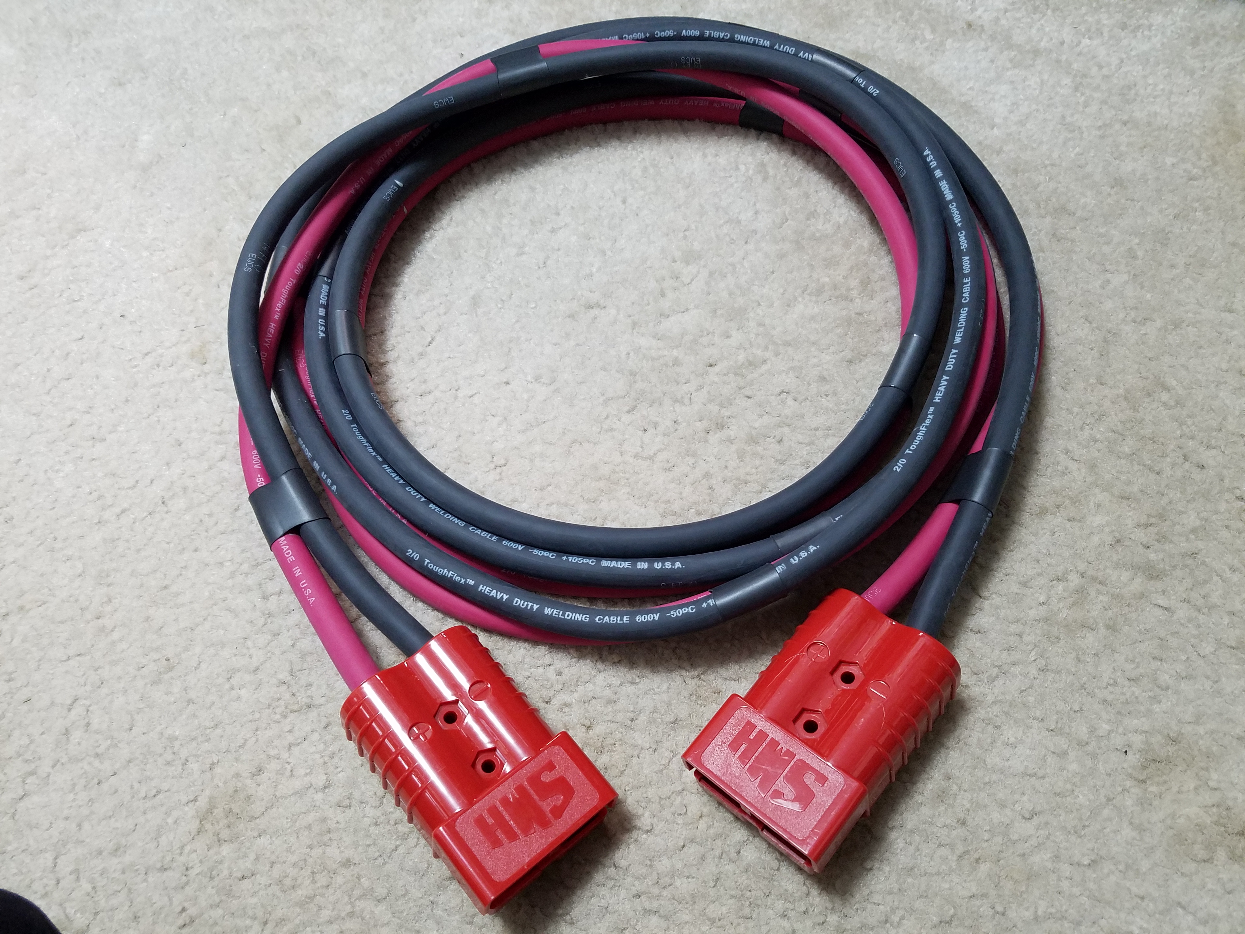

Oh, I also made a beefy power extension cable for my hitch-mounted winch so I can winch from the front or rear since I have receivers on both ends. It's 2/0 gauge (not 2 gauge, much bigger than that) and 15ft long so it will reach from the battery connector under hood to the winch in the rear while going over the roof. It weighs 14 lbs.
