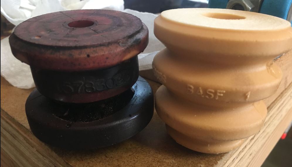

Do your bump stops do anything after cranking the torsion bars? I ask as I originally wanted to get the old Trail duty extended ones so they would reach but with the demise of Trail Duty, I ended up sourcing an eom part number that fit and was a 1/2 longer, though it may be slightly different on the the durameter scale.
Do you have a part number for the longer stop and how does the ride compare to the stock (shorter) stop?
svxr8dr
200
SW WA ST
GM Part #15153958....my old ones were rotted out so these were a 100% improvment especially under heavy braking, which while I try to avoid that when it happen these bump stops defintely work.
Here is a pic the original oem appears slightly taller because came apart and is in two peices with part one resting on the other.
