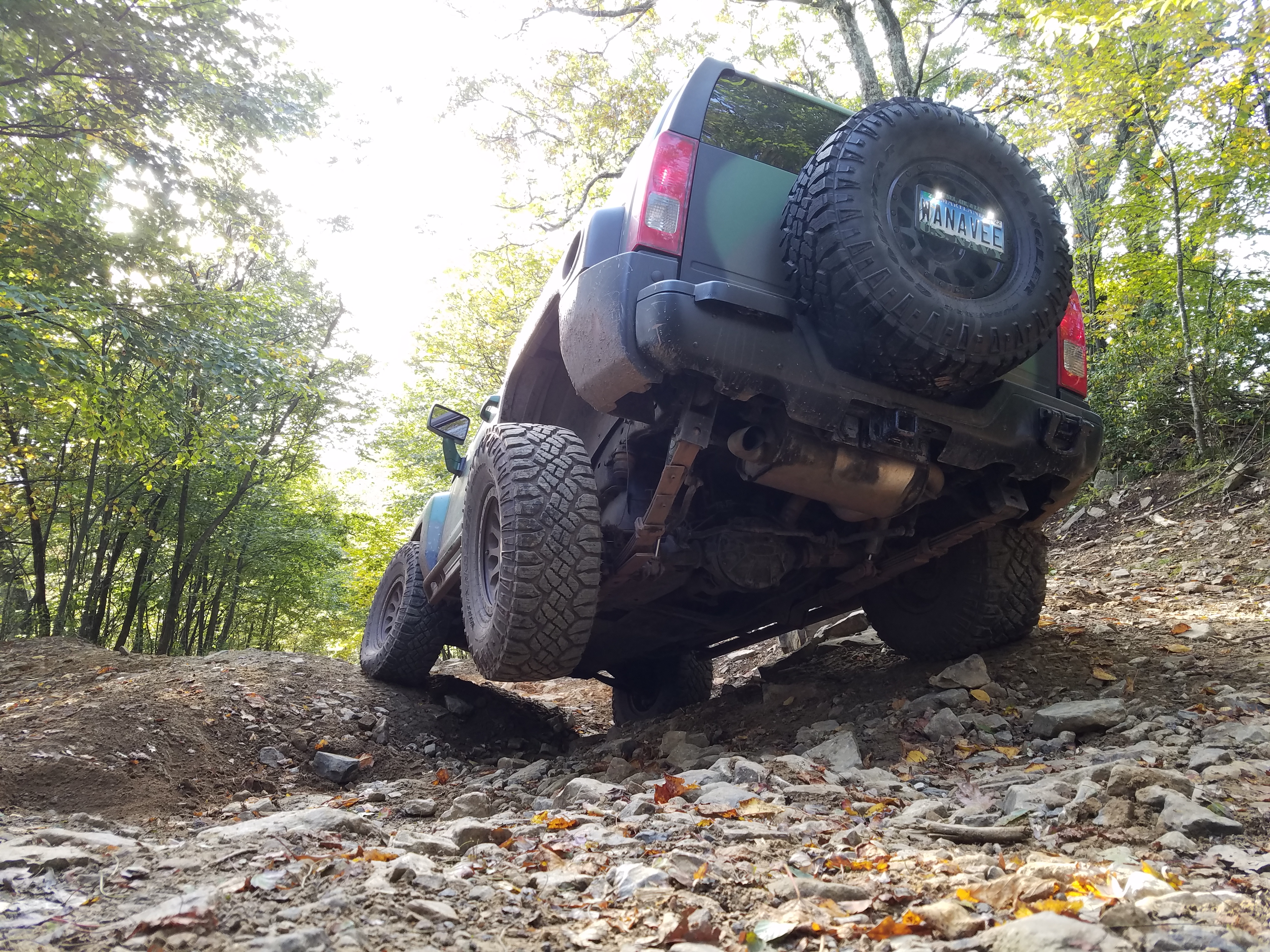

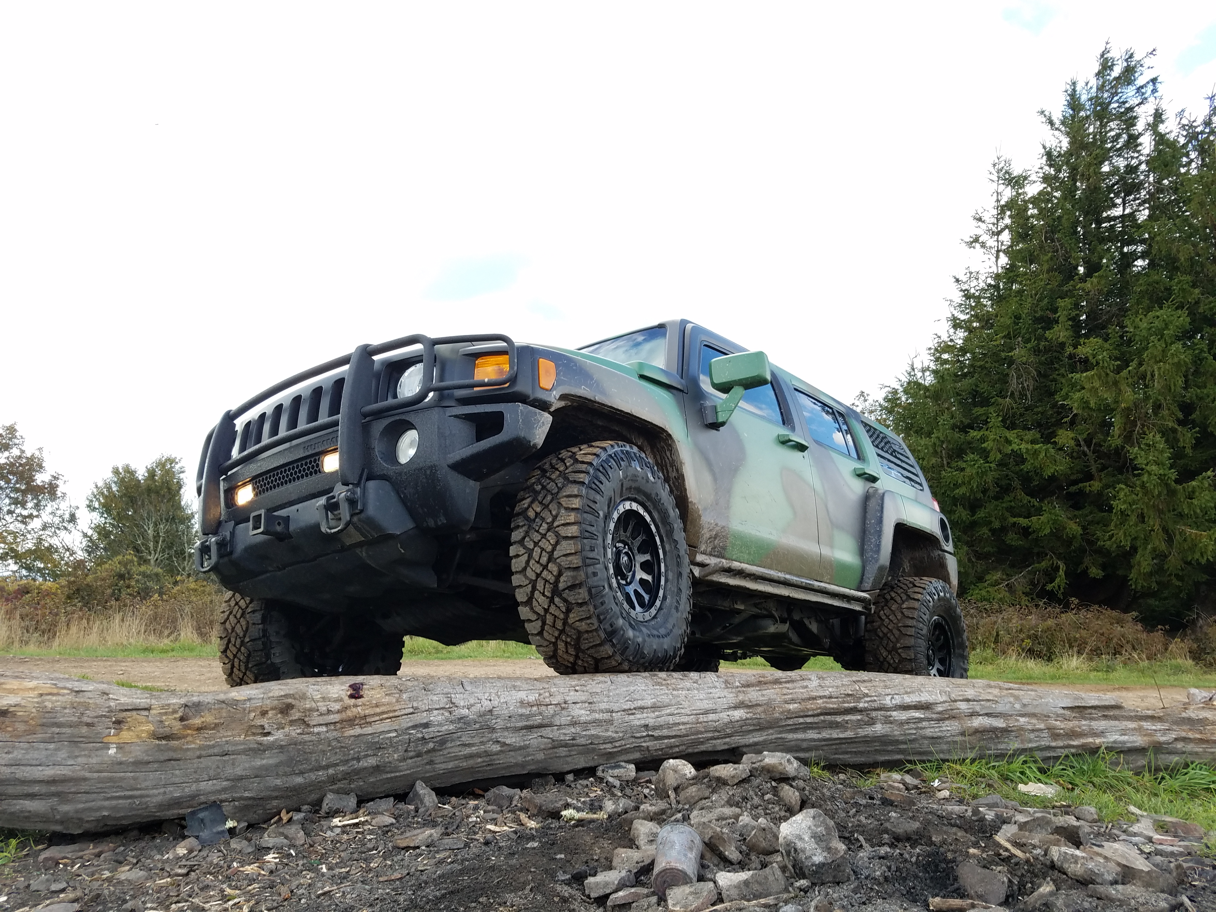

On Day 2 (Sunday) there were just 4 of us in the group (3 Wranglers and an H3), all decently modded so we wanted to go on pretty much all blue trails. Paul led again but I was 3rd in line this time because the 2nd guy didn't have a CB and Paul wanted us other two to be behind him. #2 was the only one who wasn't in the group the previous day (he had to work).
I used 4LO and rear locker almost exclusively and front locker judiciously this time. Much more challenging this day! Not just mild rock crawling or tight trees, but mild rock crawling through tight trees! Also, more mud (of course), hill climbs and descents, streams, and just general awesomeness. Of course we covered a lot less distance on day 2 because it was so much slower going.
All went well for the H3 except a couple minor problems cascading into a bigger one (still relatively minor). Twice when I went to start the engine, there was a no-crank. It wasn't caused by the Passkey system, because I bypassed that in the tune, and not caused by the battery because voltage stayed good. After less than a minute both times, it restarted like nothing had happened. (I'm thinking that it my be a starter relay going bad which would be super easy to fix but I haven't had time to troubleshoot this yet). After that I decided to leave it running the whole day to avoid the situation on the trails.
We were crawling up "Upper Anthracite", a hard-blue trail that follows a stream bed (uphill in this direction). After being sure that I broke WANAVEE in half (I didn't) on a large boulder from having to skinny-pedal it up out of the water then landing HARD on the new (used) DOI skid plate (it wouldn't crawl over that slippery mess of an off-camber rock and no way around it), I then got to another moderate obstacle and for some reason the engine died. It did this a couple times at the event last summer in 4LO too, and I'm not sure why (maybe cleaning the TB will help). That wasn't a big deal, but then it wouldn't start again. :roll: This time it took a while longer and I thought "Maybe it won't start in 4LO" so I put it back into 4HI (unlocked). Still no start, but it finally did after another minute or so. Now here's where *I* screwed up. I forgot to put it back into 4LO, and I was so focused on the rocks and suspension that I didn't even realize it! That V8 does have some good torque down low now, but I still should have realized it was 4x less than moments earlier! So after a few more obstacles (still uphill), I glanced at the trans temp on the Scangauge as I had been doing regularly, and I saw 265*! SON OF A.... I immediately put it into park (and left it running) and the temp kept creeping up. I grabbed a water bottle and dumped it onto the trans cooler through the grill and then another partial one before one of the guys mentioned that I was parked over an icy-cold stream. LOL So I started refilling the bottle and soaking the cooler. It reached 275* before it started coming back down. Someone then found a small bucket on the side of the trail that was quicker to fill and dump (perfect!). It still took several more minutes but I brought it back down to the ~170* temp that it had been running all weekend, then we started again. The temp started coming up again before I realized I was still in 4HI! DOH. I was working that torque converter HARD! I put it back into 4LO and we finished that trail and carried on (and I didn't have a single issue for the rest of the trip). When we stopped for lunch I apologized to everyone for holding them up but I didn't want to fry my brand new ~$5000 (installed) built transmission! (No one minded). The trans is still perfectly fine but the fluid will get changed before I drive it again.
Regardless of the issues, I don't want to do Upper Anthracite again (at least in those conditions). It was satisfying to make it all the way through, but the painful solid bangs and hard scrapes were not enjoyable! Nothing seemed to get damaged other than the UCP though, and it looks like only the stock oil pan skid plate needs to be banged back out a little. The mildly reinforced DOI steel held up admirably. That thing is a beast! I might want to replace the stock gas tank skid though, it looks a little worse for the wear.
The other blue trails we did were awesome! There were some intense moments that weren't caught on camera, but it was all a lot of fun! Everyone was impressed with WANAVEE (including me). No haters that weekend!
