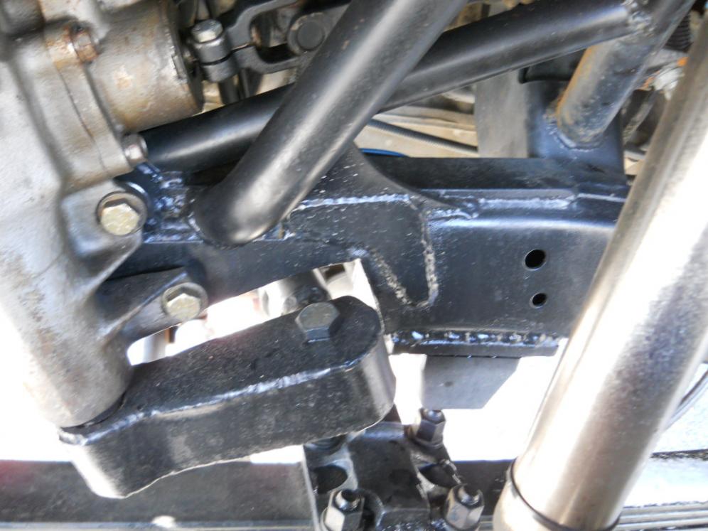

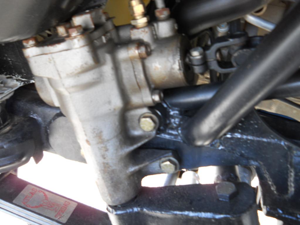

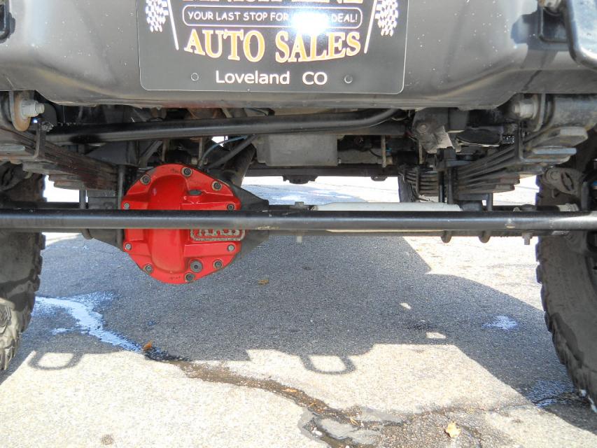

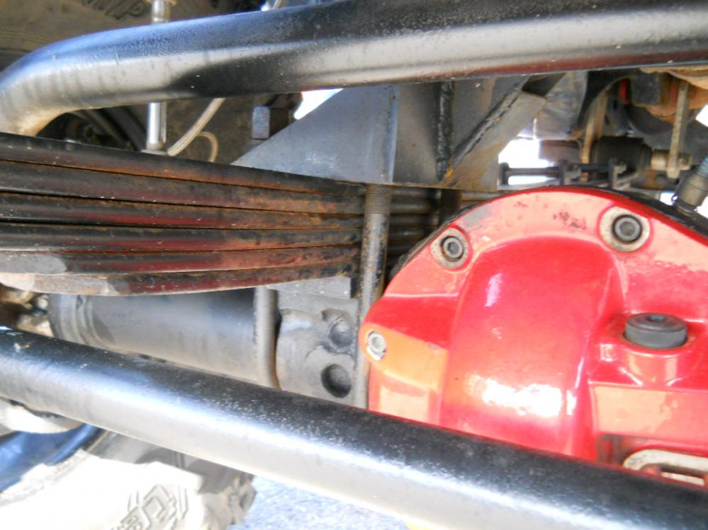

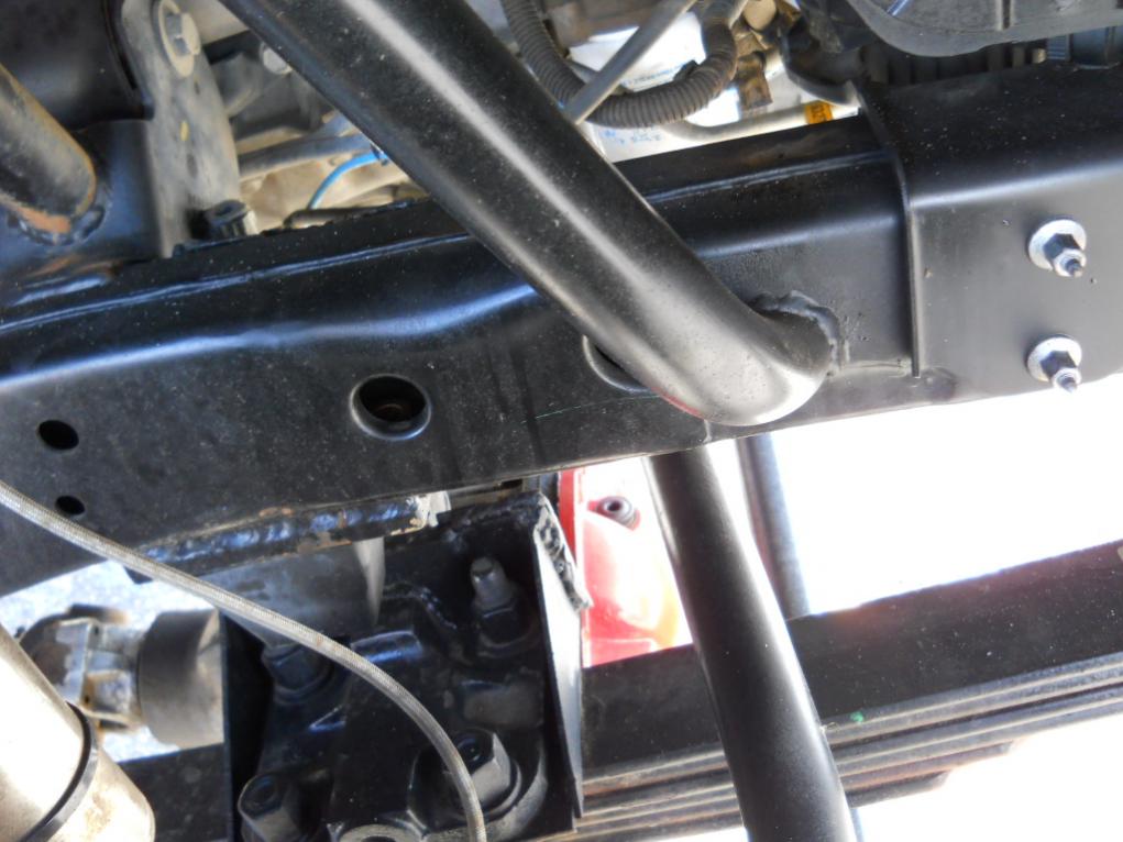

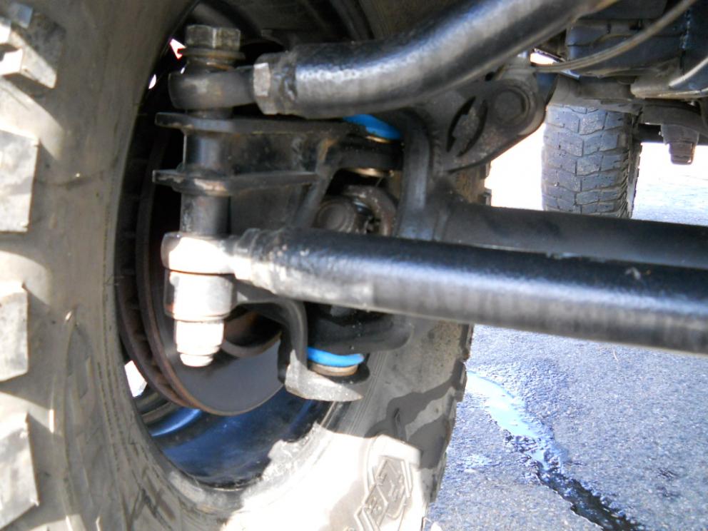

Got a reply and some pictures:
Dirk,
I am back at work today, we got power. I have taken some pics of the Hummer and hopefully these will help you. If not,tell me exactly what you want to see. The last two pics are of the rear suspension.
The frame has been altered to fit the steering box. I had a shop align it and they had to take the tie rod off three times and adjust the ends to get it right. It is "almost" perfect now. We put new ball joints on the front
and rotated the tires front to back. The Hummer can drive straight down the road at 75 mph. It does have bump steer from time to time. The steering wheel is straight and the alignmnet is very good. The tires helped because the fronts have way better tread than the rears do. The spare is new so to make it perfect you could buy one tire. The rims are a 7" wide and for a 325 size tire they honestly need to be 10" wide and that would eliminate any wobble problems and the bump steer. Like I said you can drive it down the hwy at 75 but it could be better with new rims. The 4x4 works, the "high" mode is actually the low mode and with hubs locked in it crawls. I took it out back to a big dirt mound and messed with it to make sure all was working ok. It does have an ARB but for some reason it doesn't work. It is not getting power to the compressor. In my experience with ARB's it is probably a selonoid or fuse issue but I dont know for sure. I am trying to be as up front as I can about this rig. I can't think of anything else. The body is super clean, the rocksliders look like they have never seen a rock and it is very clean inside and out. The tranny shifts perfect and the motor is good! Let me know what else you need.
thanks,
Mike
