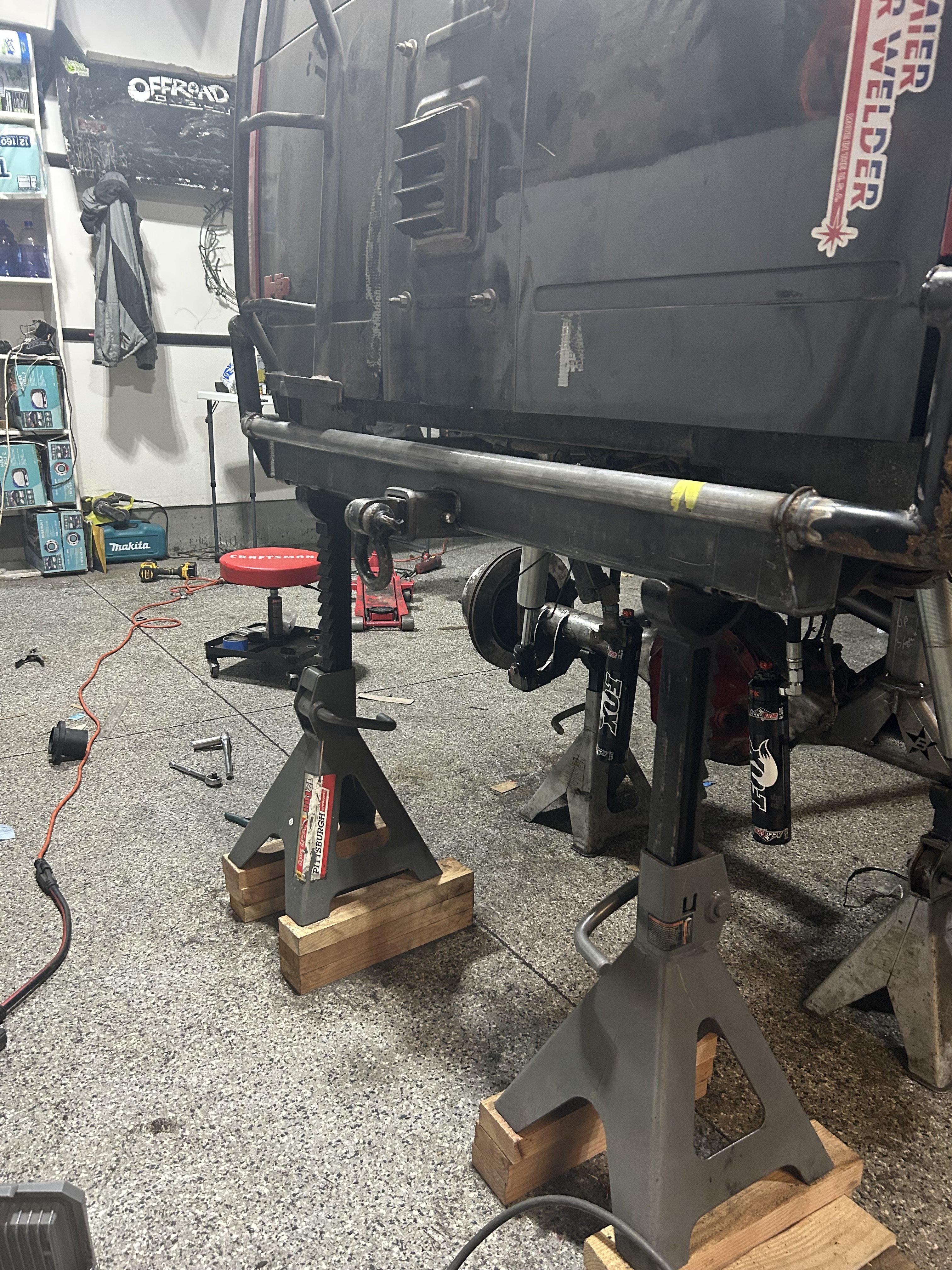

First project was make a bumper to keep everything square. I don’t run a spare anymore so I wanted something that tucked up tight. My old bumper protected the spare but lost departure angle. If I run a spare I’ll use a hitch extension as the tire protector.
The picture shows some suspension work so ignore that. He’s a finished pic with bumper and tube tie in.

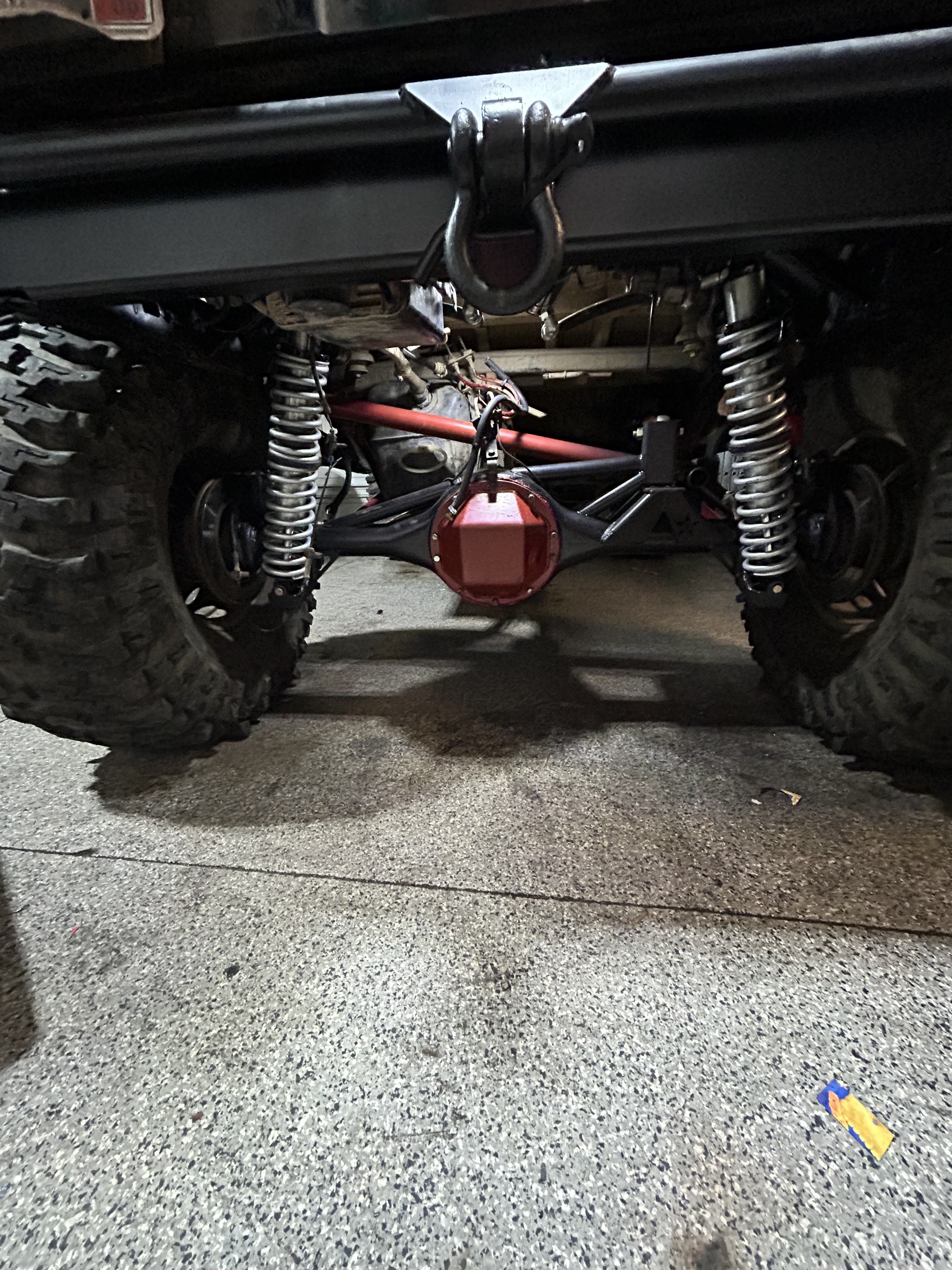

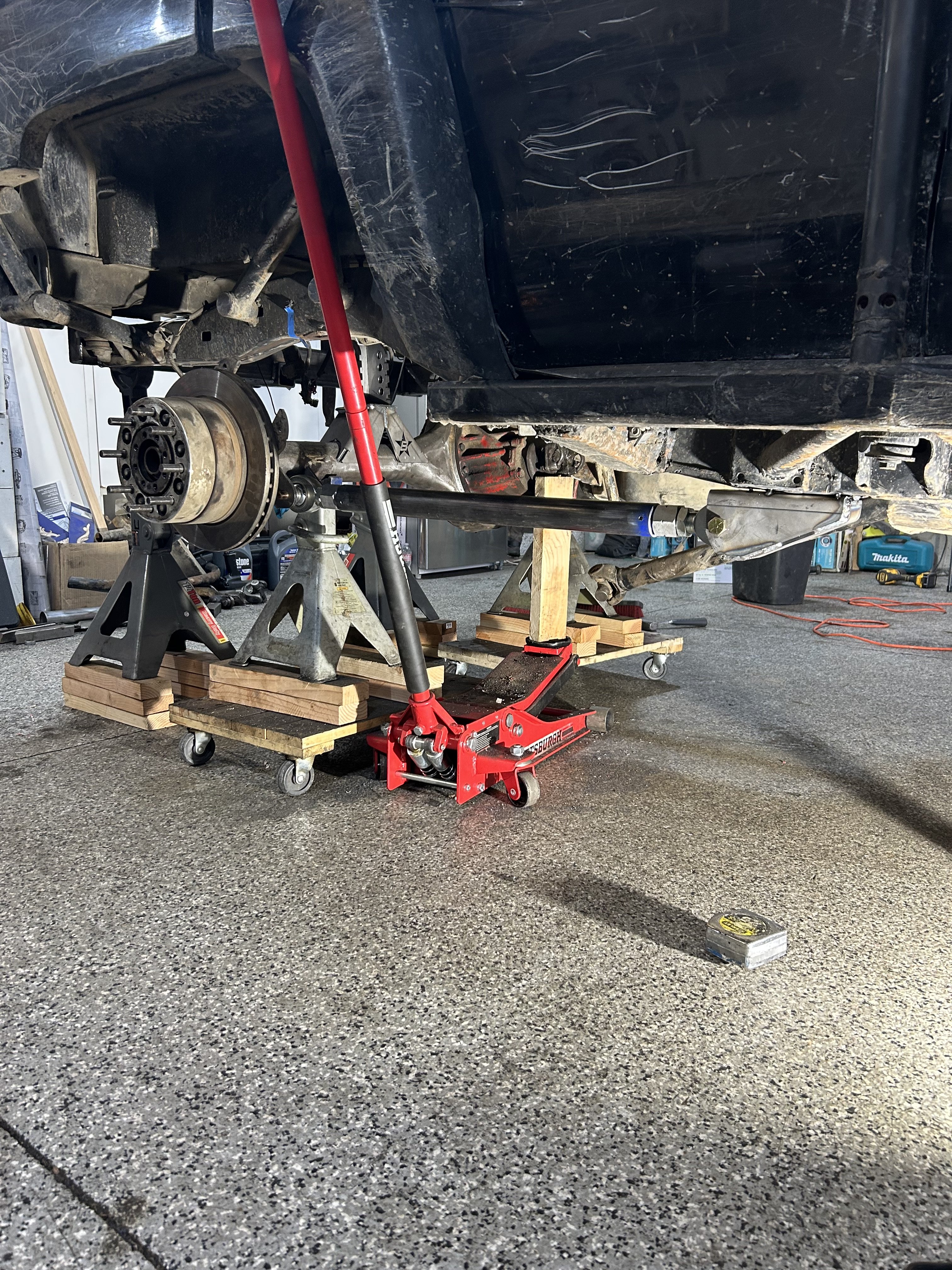

Next was figure out 3 link or triangulated 4 link, which would require a new fuel tank. We figured out how to make a 3 link work

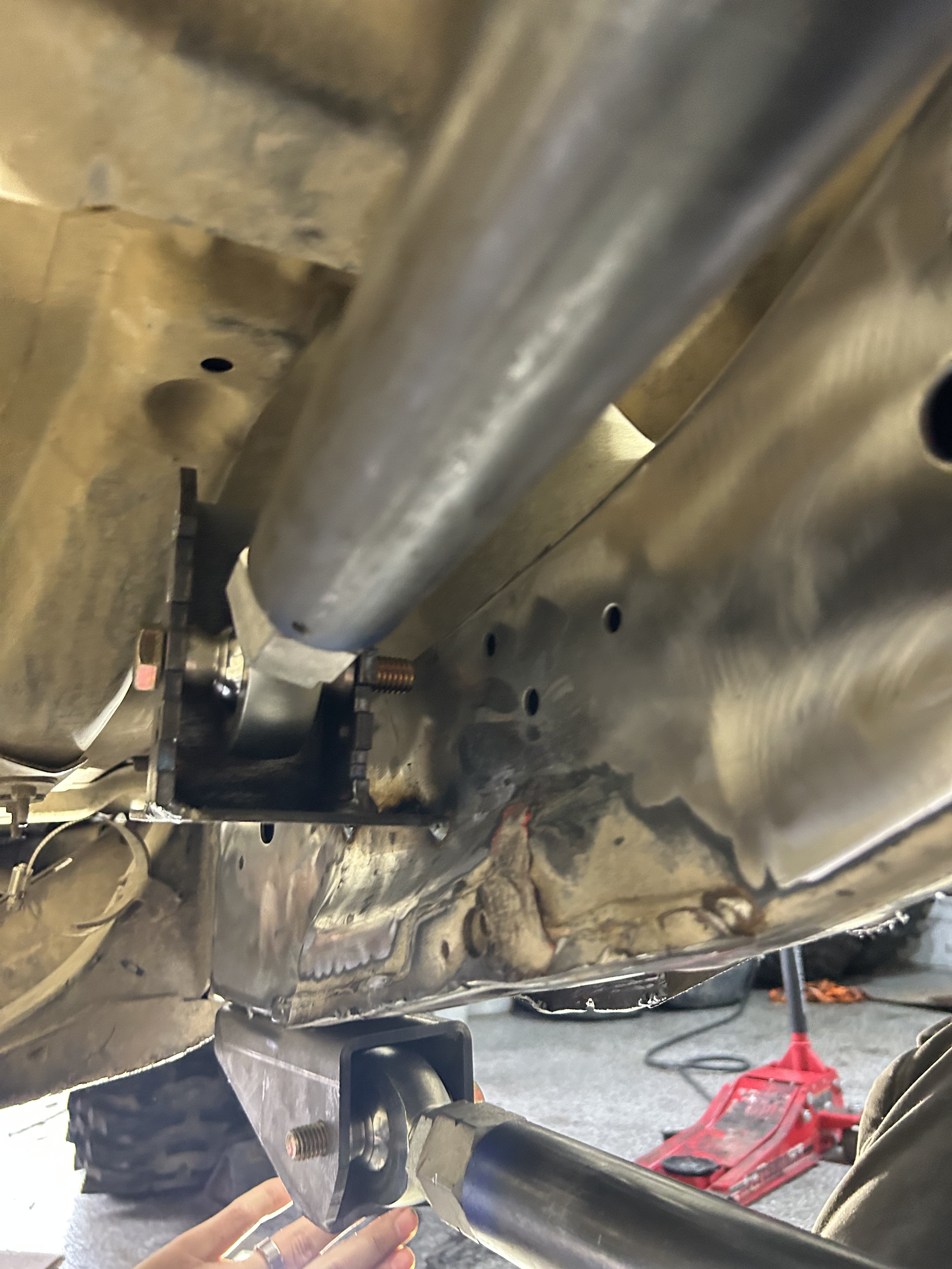

Tacking on the lowers and the upper link to start cycling

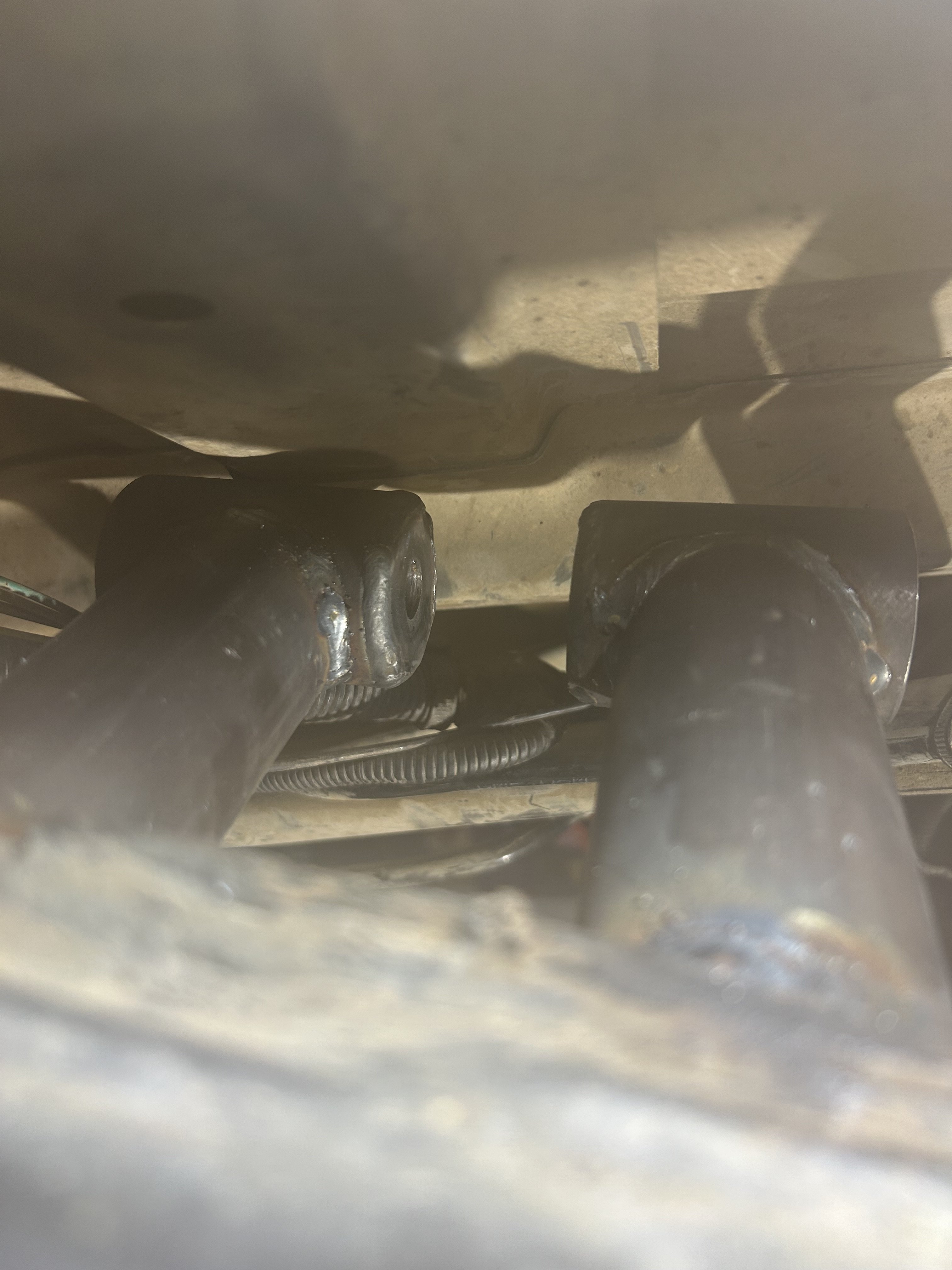

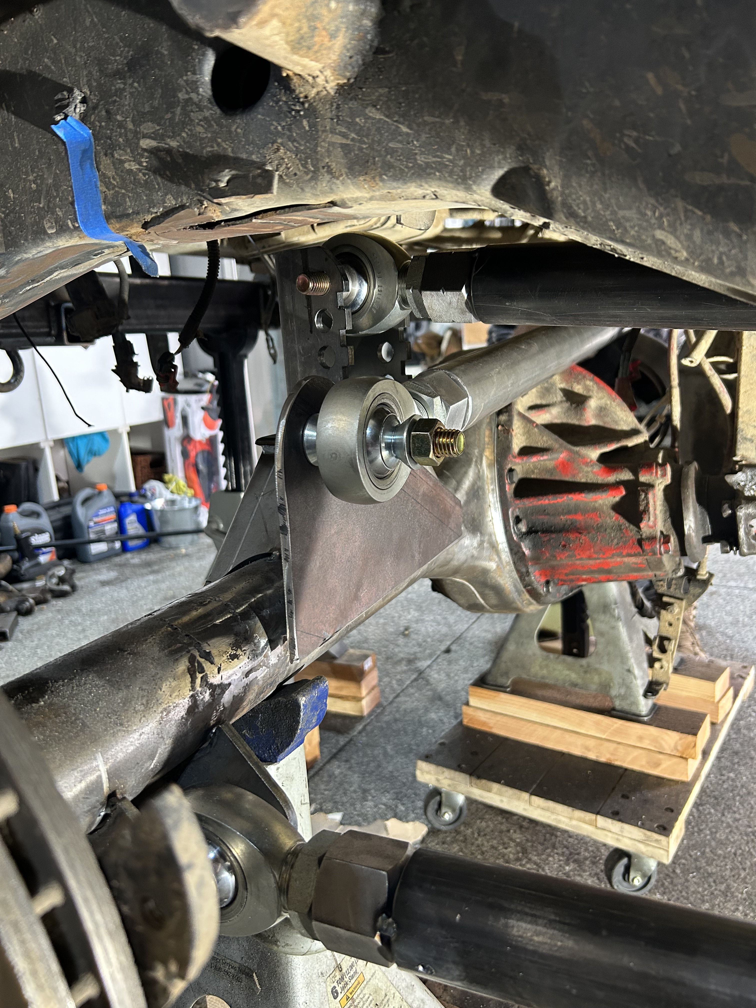

The 3rd link bracket is cool, it’s a cut up Barnes truss and an off the shelf 4 link hole bracket you can see it above the lower links. We made sure to get a ton of separation to less then load on the 3 link.

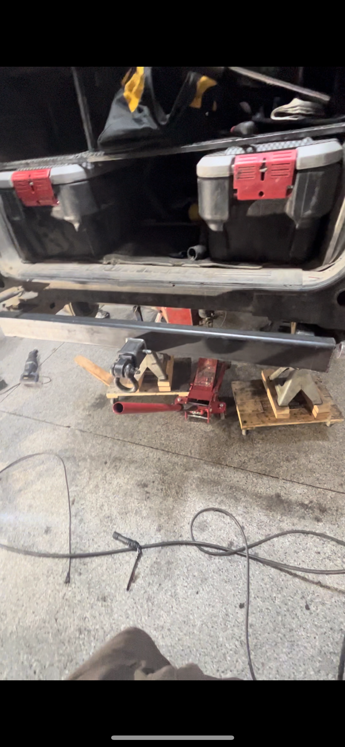

Here is the mock up of the track bar. Not a ton of room so it goes behind the axle and snakes between the upper link and 3rd. It will be double sheer but for mock-up and cycling the suspension we wait.
Getting the upper link way up there for proper anti squat numbers. More bracing to be has obviously
9,493

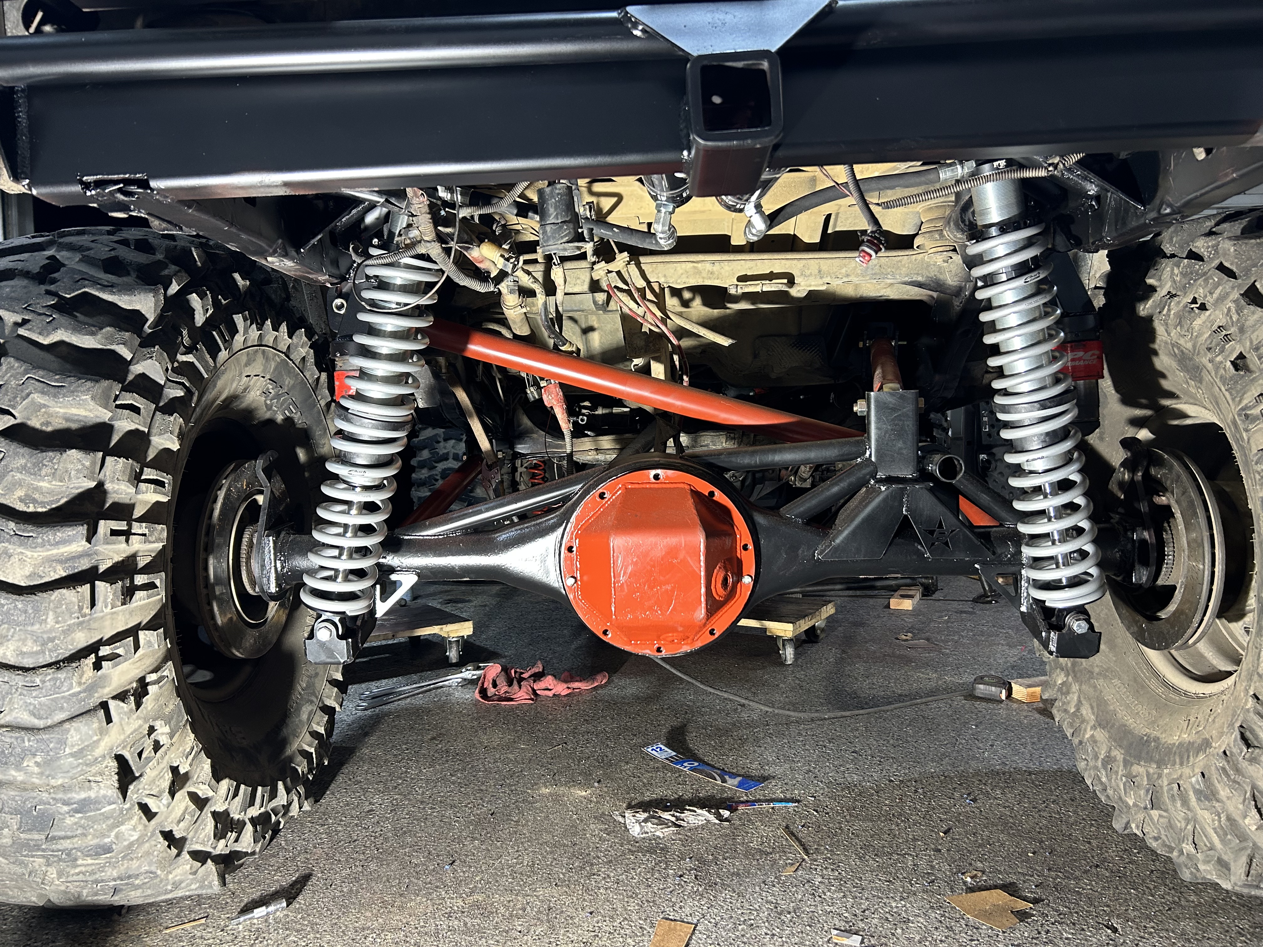

From there we started bracing things. Track bar ended up being 41in
That ain’t going anywhere

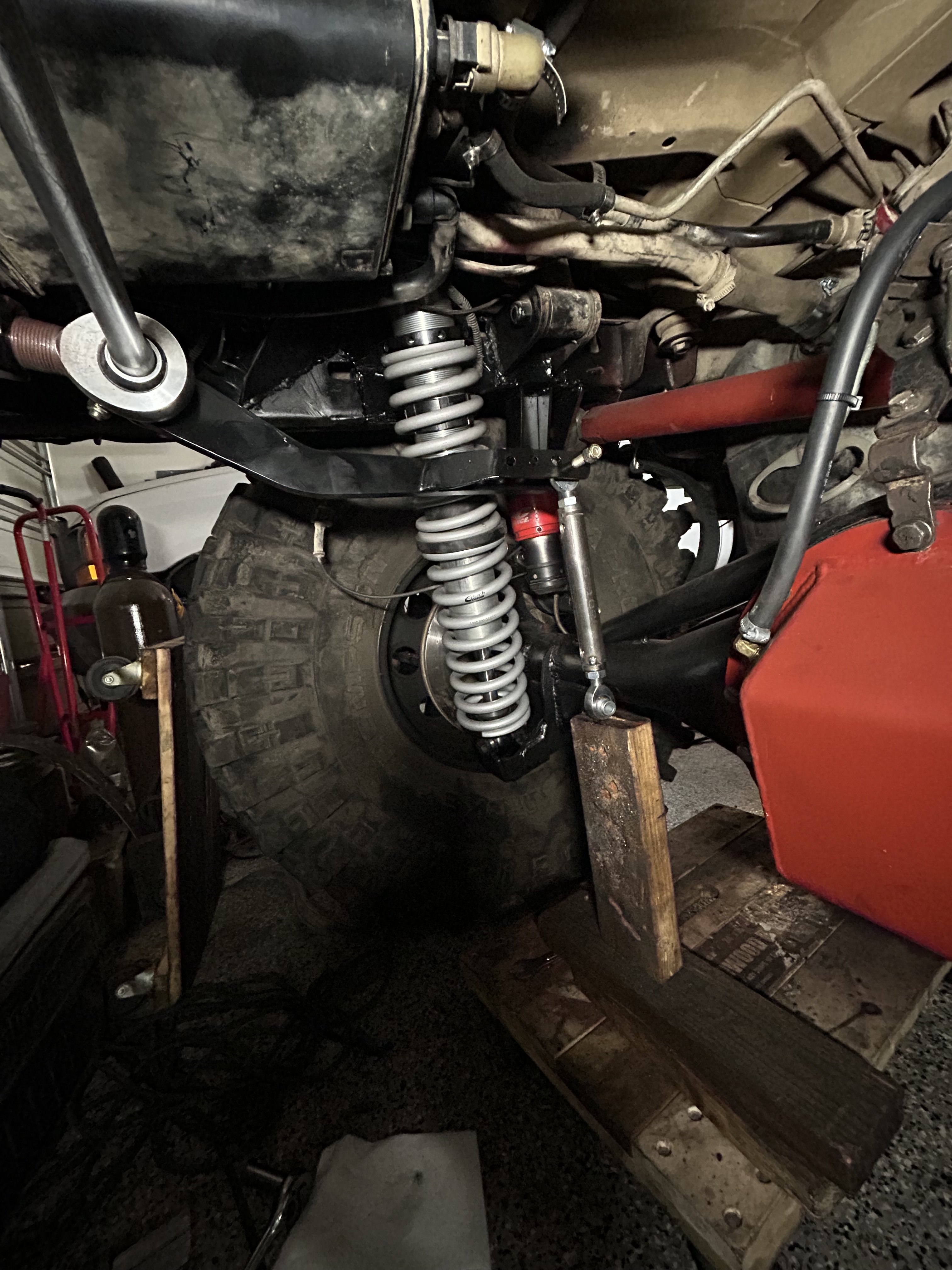

Frame notched for coilovers
Going backwards a bit but coilover mounts
9,493
We got good bracing and cross tubes for the coilover mounts.
Pic of the link mount to coilover mount transition.
Resi mounts
It’s sitting way too tall, gotta swap out springs so keep that in mind when looking at track bar angles at the finished product

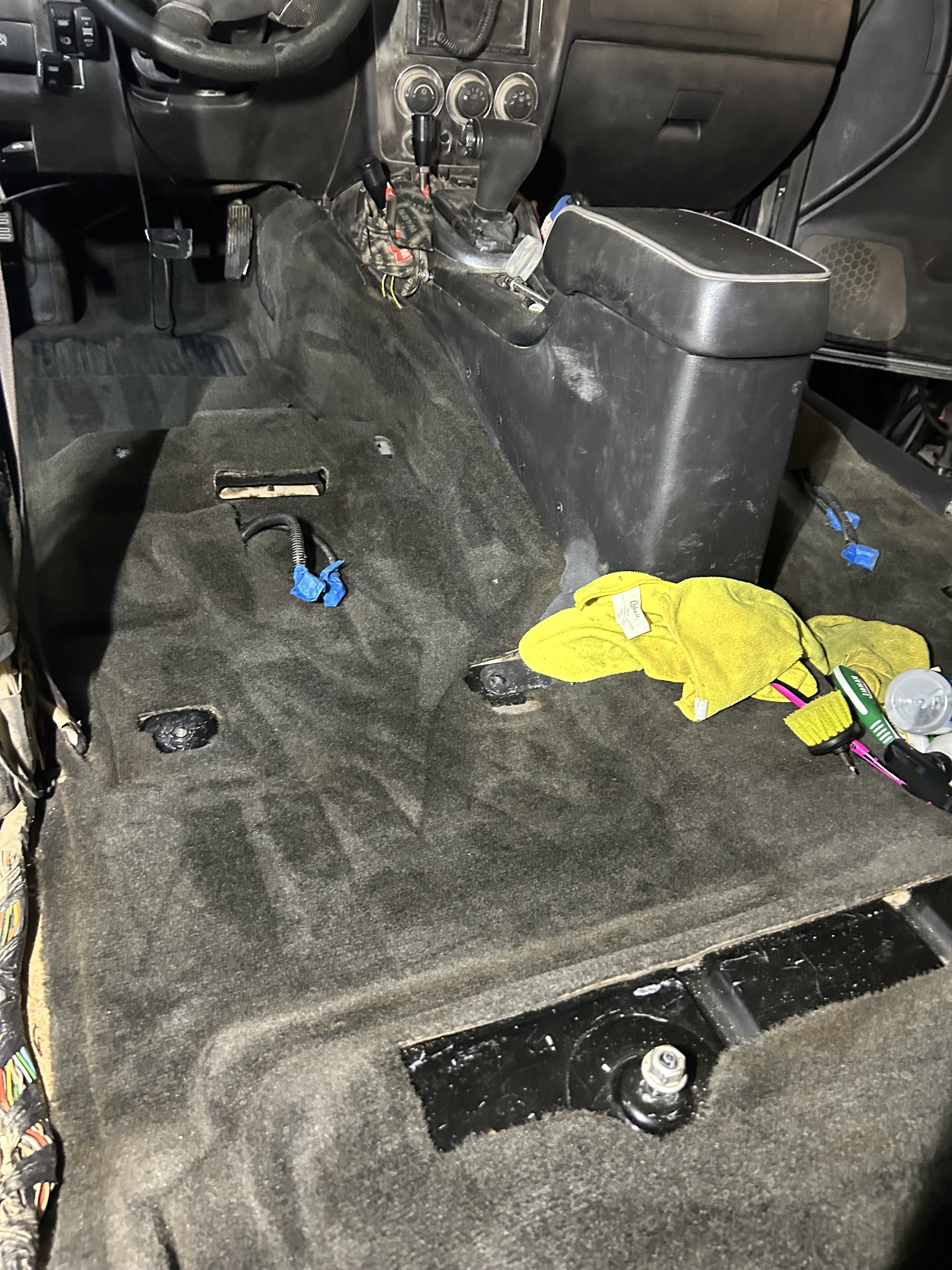

The interior is thoroughly cleaned. My sister spent 4-5 hours a day after work for 5 days. Literally over 20 hours of work in cleaning the interior. We removed the seats and basically had a bare cabin. It hasn't been this clean in over a decade. She had a bucket of water from shampooing the carpet and it was just 100% brown water from all the dust and dirt.

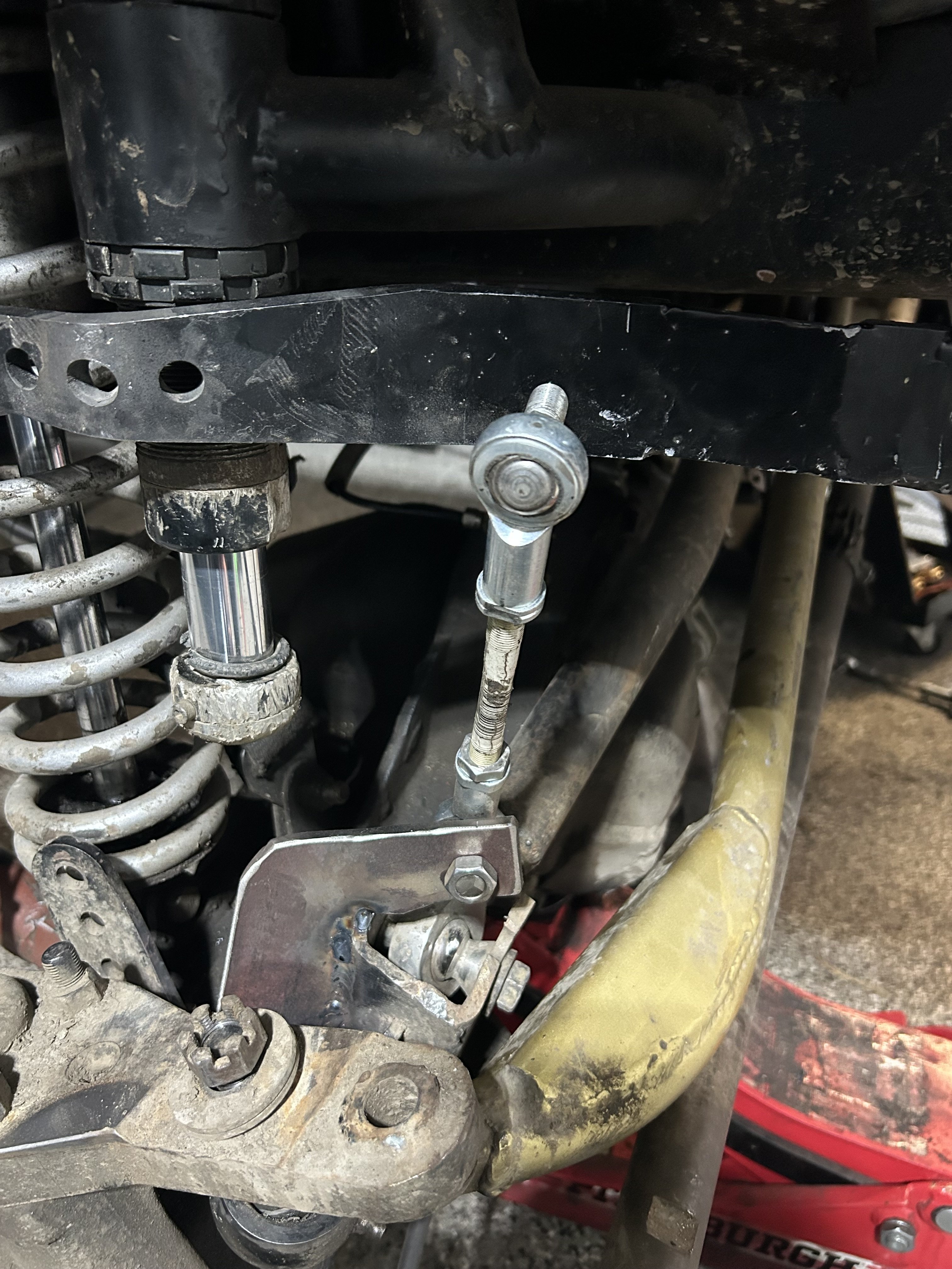

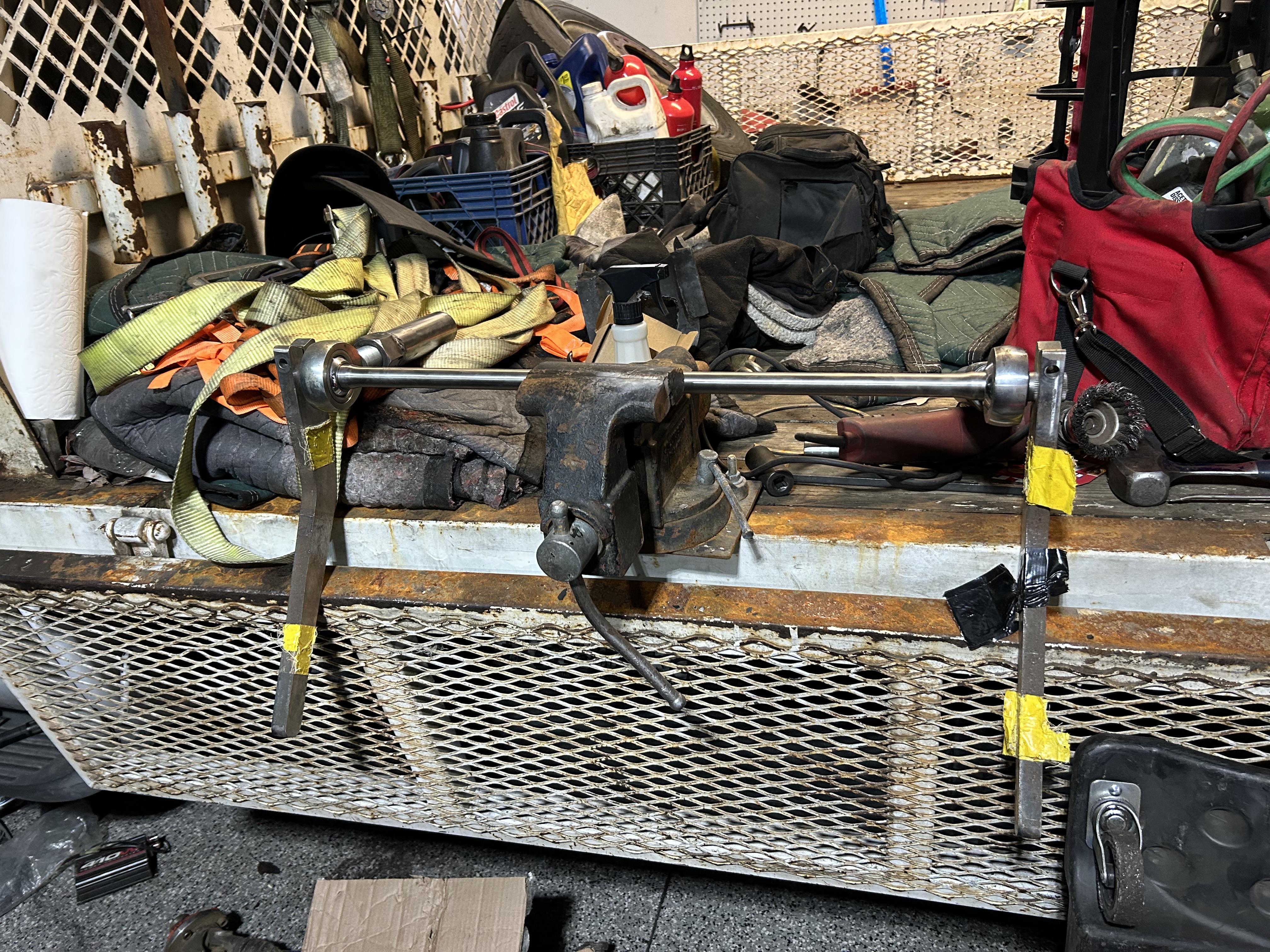

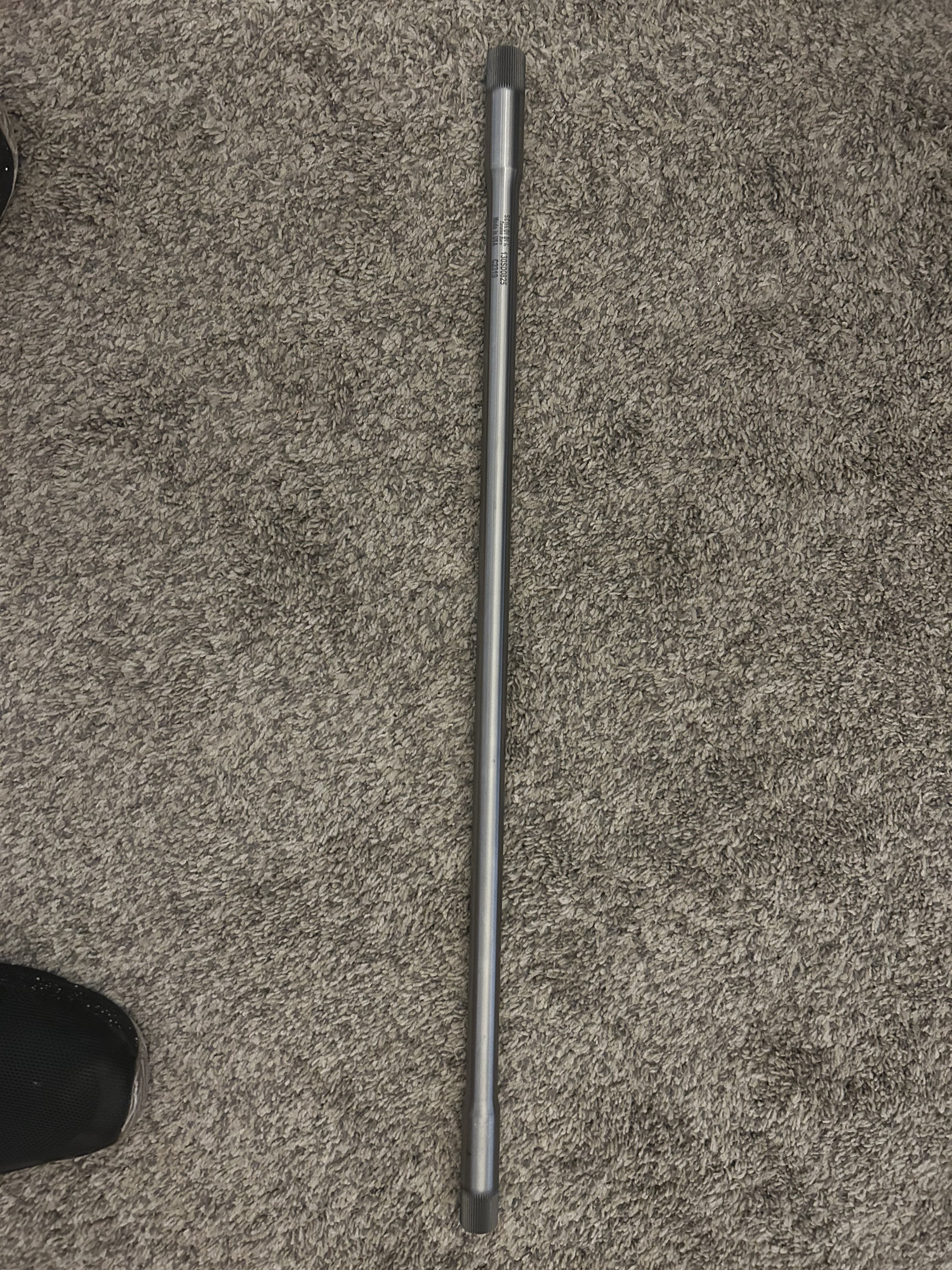

On a hummer note, Schroeder sway bar showed up before going to the hospital. 1in OD, 30in, .825 active diameter, solid bar, 48 spline.
I also bought Currie anti rock bushings since they are listed as 1in ID. They aren’t. So I need to return them.
So a friend suggested I try some old 1 1/4 heims I had laying around. I actually loved that idea. I also had some old control arms laying around I cut up.
I like this idea, I can shift the sway bar forward or back to help maintain sway bar link angle if I play with sway bar arm length and they can be spares if I ever run across someone with a failed 1 1/4 joint (most rock crawlers run this size joint whether it’s a Johnny joint, heim or bushing)
Arms showed up and Barnes heims showed up while we were at the hospital.
The arms are beefy as hell being 1in thick. Probably a waste on weight but cheap beef. I’ll drill out 3-4 holes and make it double sheer on the arms and the axle end.

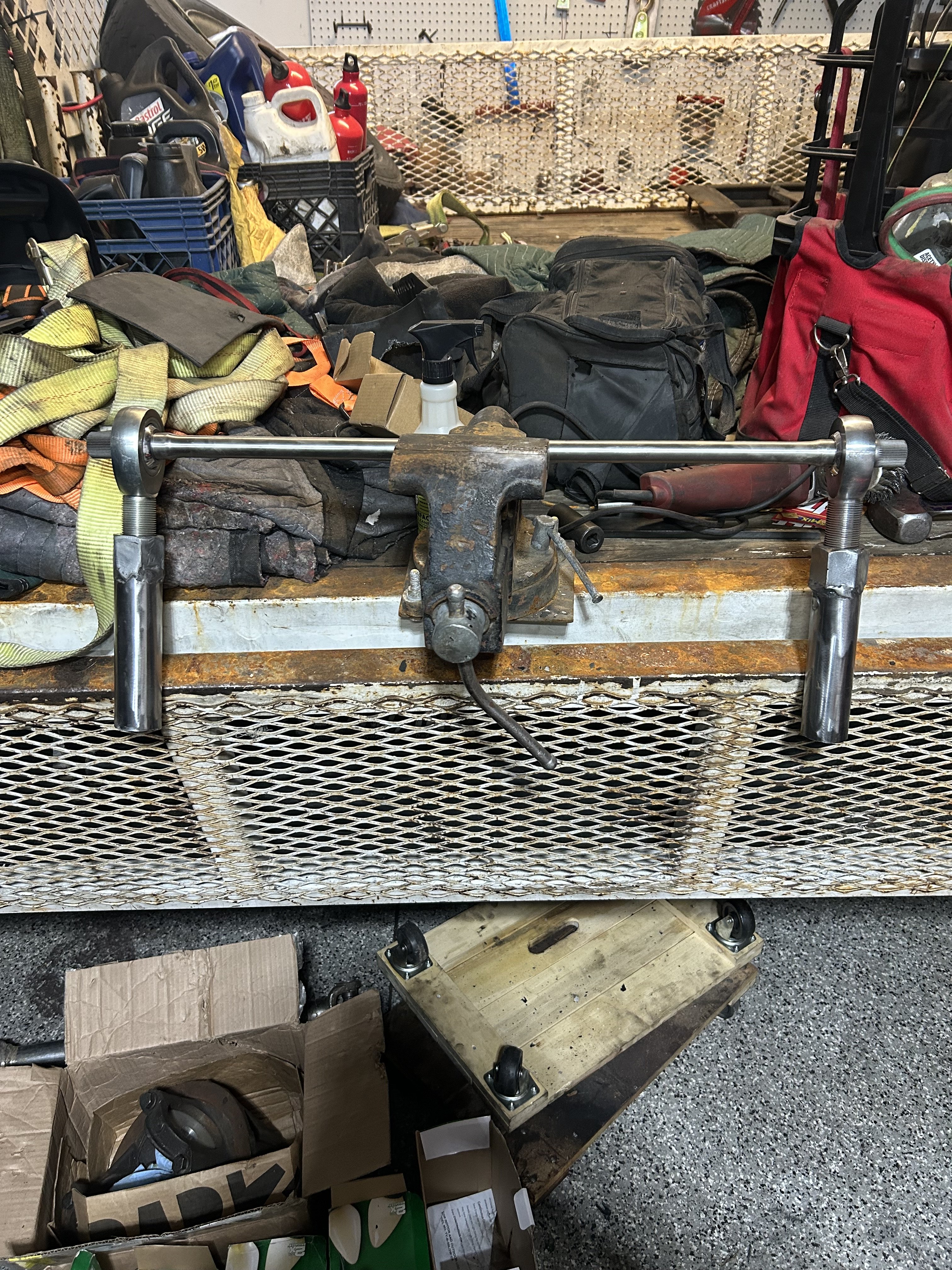

Back in January I started working on the sway bar setup. I have the mounts 100% complete. Not the most weight conscious setup but the Hummer is built around helping others on the trail, hell, I still carry D44 ball joints for traditional spindle d44s in the back. Anyways, I would really hate to do it, but if I had to cut off a 1 1/14 tube insert or rob a 1 1/4 heim to get someone off the trail I can. I initially bought bushings from Currie and they were not the ID they advertised. In the end, I doubt it’s not much more weight, it’s 2 short tubes with heims vs 1 long heavier piece of tube.

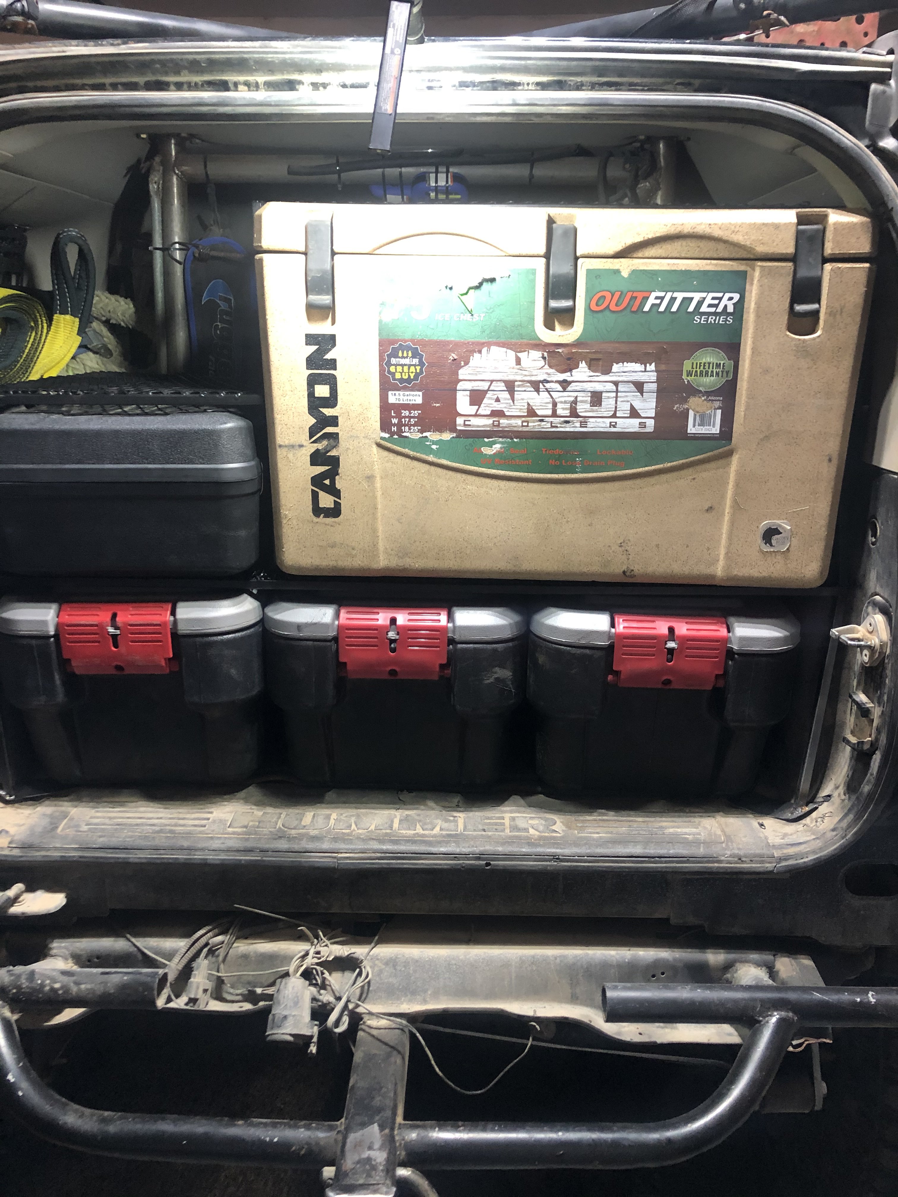

Here is the old setup. The vevor fridge freeze fits perfectly in there. I do lose about 27 quarts of storage compared to the canyon but I save on ice I guess

A few weeks later in Mid January I got the sway bar done, I took it out in the snow, it was so damn slippery out it’s tough to say how it feels because instead of hooking up and working the suspension it just spins but from what I can tell, it’s substantially improved.
I just had to pull the bottom springs and cycle it and make sure nothing collides, from my measurements and what I can tell, it won’t, but want to double check. I also need jamb nuts for my heim mounts on the sway bar setup. Other than that, it’s almost time to wheel it.

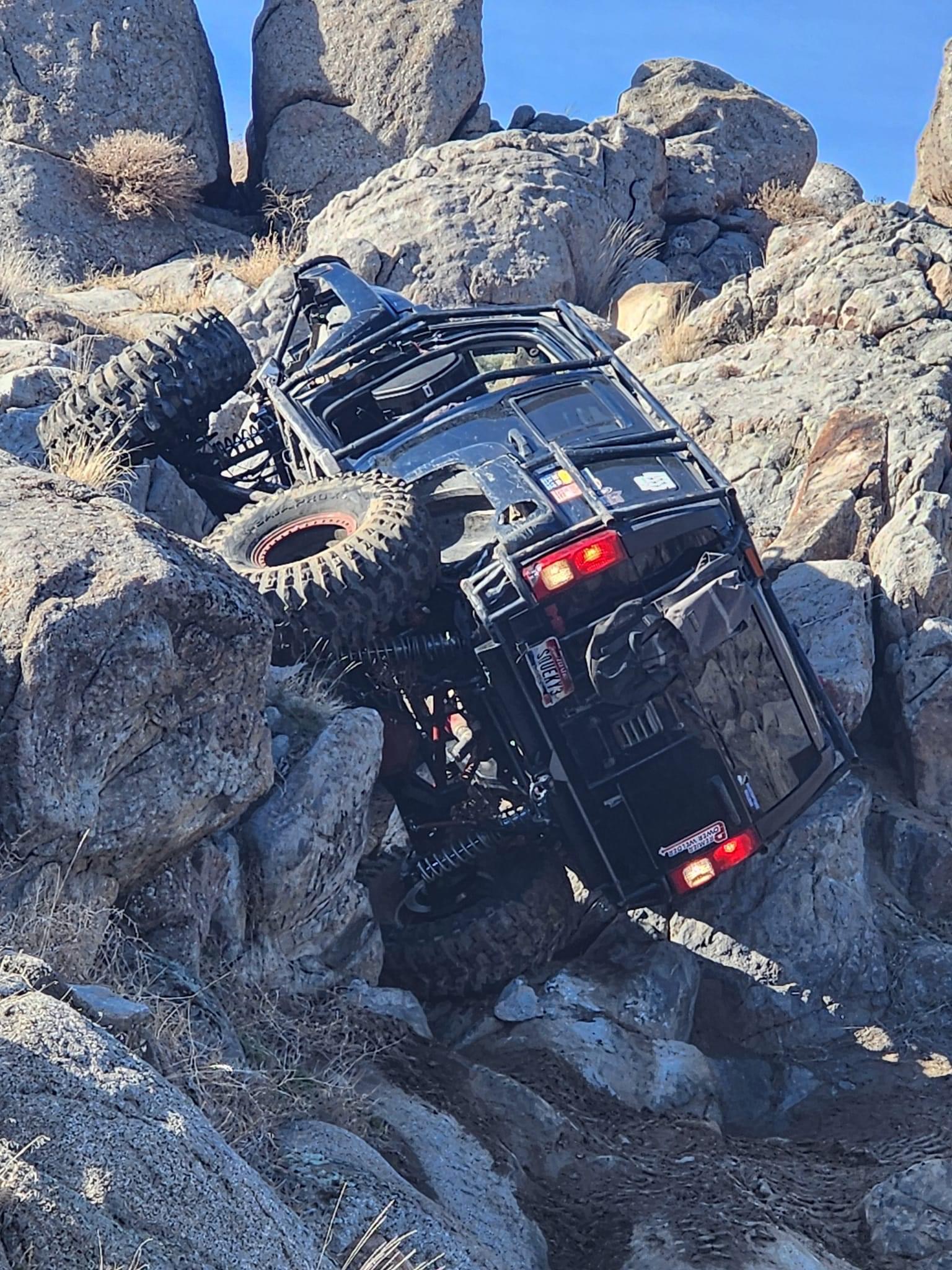

I fell in this crack. This was a new line I’ve
never done, pass rear tire slipped in the crack and it got weird. B pillar tube saved the day again

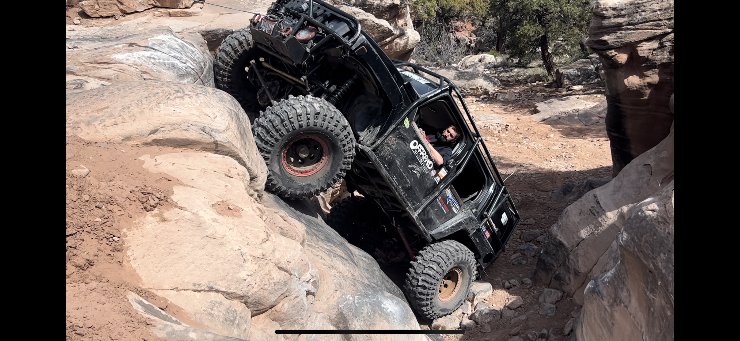

I am bummed I missed you guys in sand hollow this past week. I was in Moab and was trying to get over there, but plans got messed up and changed.
It was a trip that had me grinning ear to ear saying, holy fuck my rig kicks ass and then minutes later, my rig sucks.
This is my 8th (I think) Moab trip. I have been to Moab completely stock to my current rig today. We had different plans then normal. Normally we run the traditional trails. This time we added in a trip to area BFE and we got a permit for Coyote canyon. In total we ran Pritchett, Helldorado, Green day, Hells revenge, part of brittany spears and Coyote Canyon.
I hauled my rig to Moab which is just under 600 miles but once in Moab I drove it all over on the highway which was important to me. As per usual, right when I get something dialed, I make more changes and that takes time to get it all dialed. This is my 3rd trip on the 6l80e swap and 2nd time out wheeling the rear 3 link so I wanted some street time too.
I was not concerned one bit about coyote canyon or helldorado and green day, they are rock crawling trails and I am a rock crawler! I was concerned about the moab trails. I have always felt the hummer struggled on those type of trails even after the SAS and in the end it was quite the opposite!
As stated in previous posts I felt I was under sway bared. I felt unstable and like a boat in rough waters. I had a Schroder sway bar 30in length .825 diameter for about a spring rate of 74 at 14in of arm length. I ordered a .95 bar which they said would take 4-6 weeks since they are back logged. Moab was 7 weeks away. I was good right? Well, they said it was done the morning I was leaving. I had put the arm down to an 11in eye to eye to bring the rate up to 120ish but it was still a tad soft. Given Moab is a tippy place I wanted the bigger bar so I reluctantly spent $118 to overnight it to Moab. I got it and installed it there, set it to the 2nd hole which gives me a rate of 153 which was ON THE MONEY. Does it sway a little bit on road? Yes, but it returns to center and feels very stable now. I could up the rate by swapping around holes and go down to 120ish 180ish and up to 220ish. I may try 180 but 150 feels good.
So Day 1 we hit Pritchett, we drove to the start, dropped off the trailered rigs, and then we drove to the end, dropped off the tow rig and trailers and I drove them back to the start with the Hummer. It did well on the road and seemed happy minus a tire or driveline vibe.
Pritchett was fun and I quickly felt confident on its stability which was a huge plus because my first test run I felt a ton of instability.
Chewy hill was my first problem. Last time out I had gas pouring out of the evap canister and caused it to flood the engine and run like dog shit. I had a purge valve CEL and replaced the valve, the CEL light went away but on chewy hill it started doing that again. Run like shit from flooding the engine and at this point I winched because I needed steady throttle and it would only work with heavy throttle inputs. I ended up plugging one of the lines to the evap and that fixed it.
We continue to rocker knocker and I took a bad line, get sketchy and winched. I am so bummed because I literally took the wrong line. From there we hit axle hill and I got that, rockpile was FUCKED up. It was so dug out. The drive out was long but hit the highway and headed back to camp.

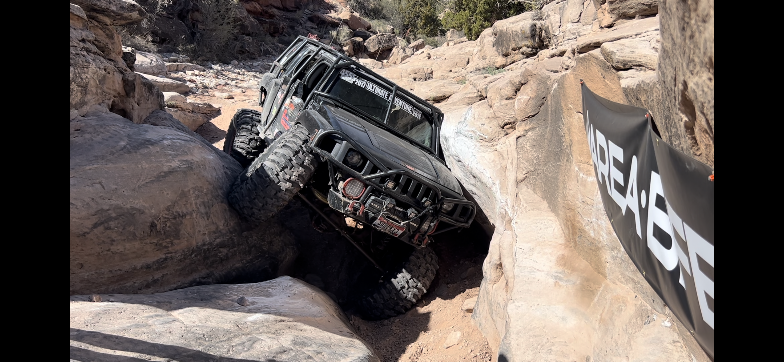

Day 2 we hit Area BFE and ran helldorado. Same thing, it was FUCKED up and dug out but it was cool to knock off a legendary trail on the bucket list. We ran Green day and had fun then headed to Hells Revenge.
The hybrid cage saving my bacon again.

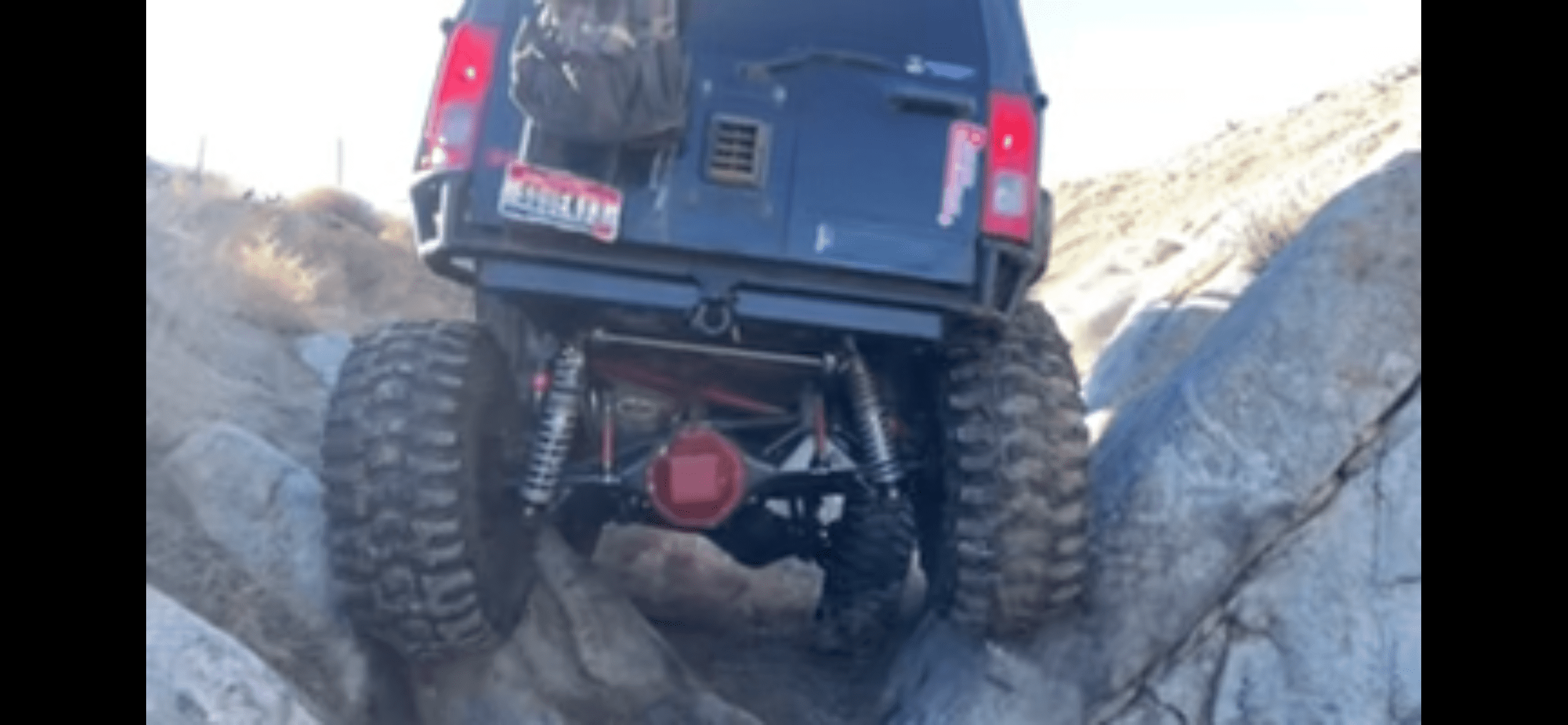

Hells Revenge was fun, its an easy trail so I did the entire main trail in 2wd as a challenge. Then we did hells gate, my buddy hit devils hot tub and made it which took big balls. I finally hit mickeys hot tub. After years and years of wanting to hit it, I finally did and got it. I also hit a big climb which historically I would lift because I am a bitch when it comes to commitment on ledges and climbs but the rear suspension didnt lift or squat too much, it felt stable and put the power to the ground. After hells revenge I was stoked!!!! This thing was doing stuff in Moab I struggled with in the past.
The video above is what I think shows my new suspension working, no hopping, or lifting not showing AS over 100%, it doesnt seem to squat so much it pulls the front to full droop. It seems to work nicely.
I took the wrong line, in the past it would be game over, get on the winch but I was able to ride my cage out and get on the right line. If I didnt have the cage Id have no window right now.
Going down escalator

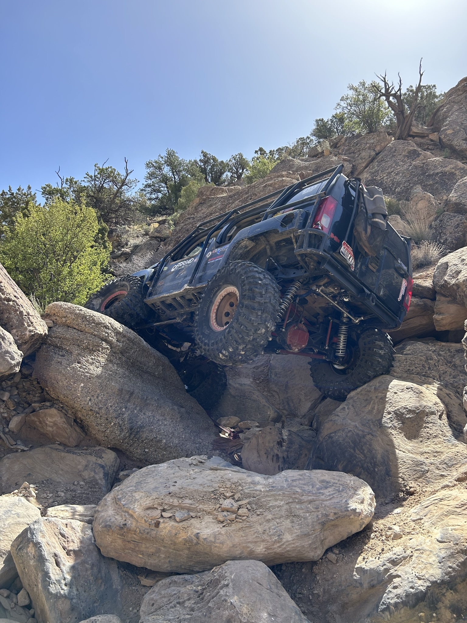

Day 3 we hit coyote canyon, this one was rough, I winched on the first obstacle everyone else got. On the one line I took I was hanging up on my frame side lower rear link mount, I don't think with leafs I would have. Another line I tried my buddy said I do not have the steering angle I needed (18in wide Mickey AG tires hurt steering angle.) From there, I was frustrated and drove like a fucking idiot. The left hand turn on coyote I was going to get, I just couldnt get my tires to steer. Shitty excuses, just like....if my aunt had balls, she'd be my uncle so enough with the excuses. I had moments of FUCK YEAH and moments of FUCKING POS.
In the traditional rock crawling trails I thought I would have hit my lower shock mounts more and surprisingly I didn't I'd say my lower control arm mounts were worse.
Overall, I had a fun trip with friends and got some seat time with the new changes.

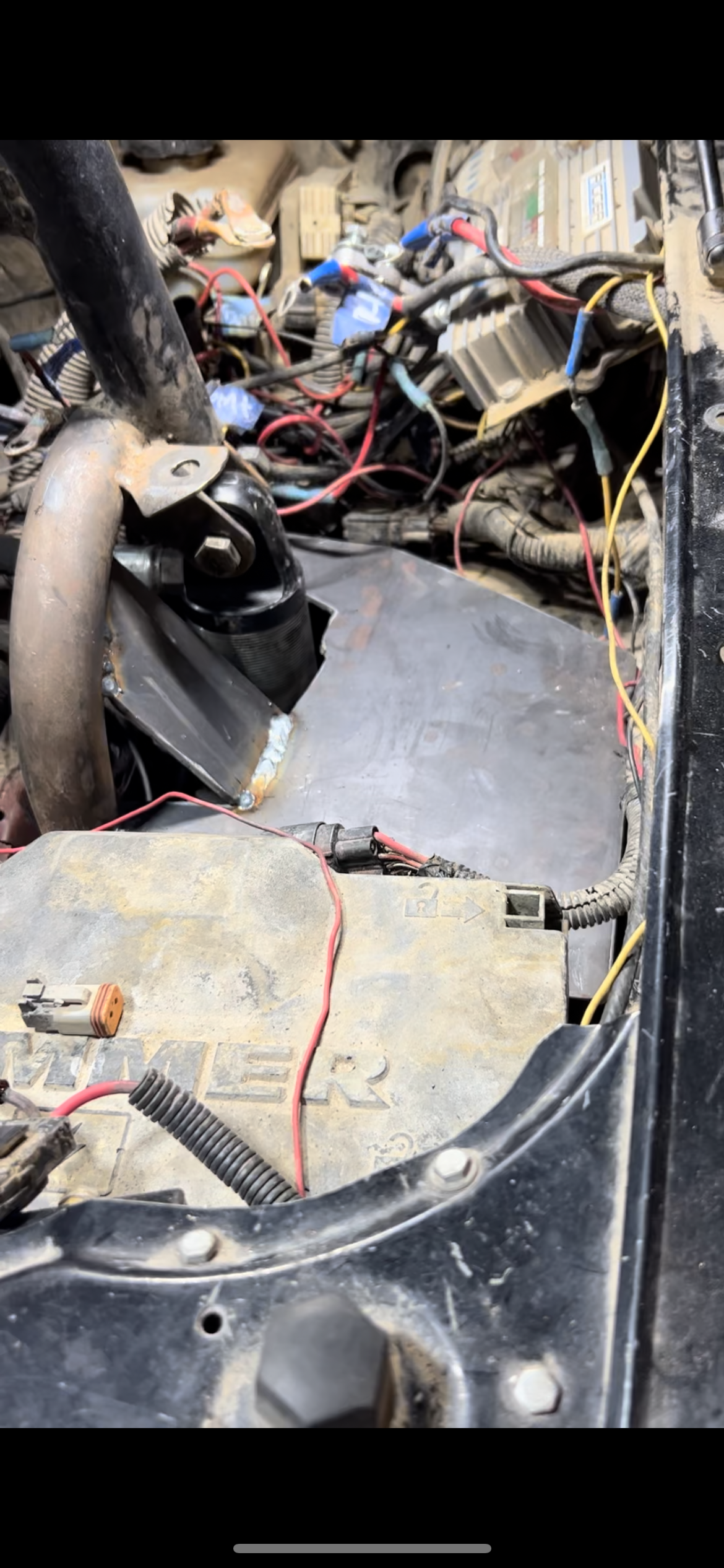

I also took the time to rethink my existing battery mounting. Before the coilovers I had a multi wall inner fender with all sorts of reinforcement for a battery box, it was the factory setup and worked. After the coilovers in 2019 and going in the engine bay, I had to change up the battery mount. It was single wall thin sheet metal inner fender and maybe allowed too much movement/vibration causing this explosion. So I worked on a new mount.
This is 3/16 plate that’s sitting about 1/4-1/2in above the inner fender. It’s welded to the coilover mount so it should see less vibration.
From there, I will rewire my rats nest of wiring….I have dual posts now which will help and probably allow me to avoid needing a junction block.

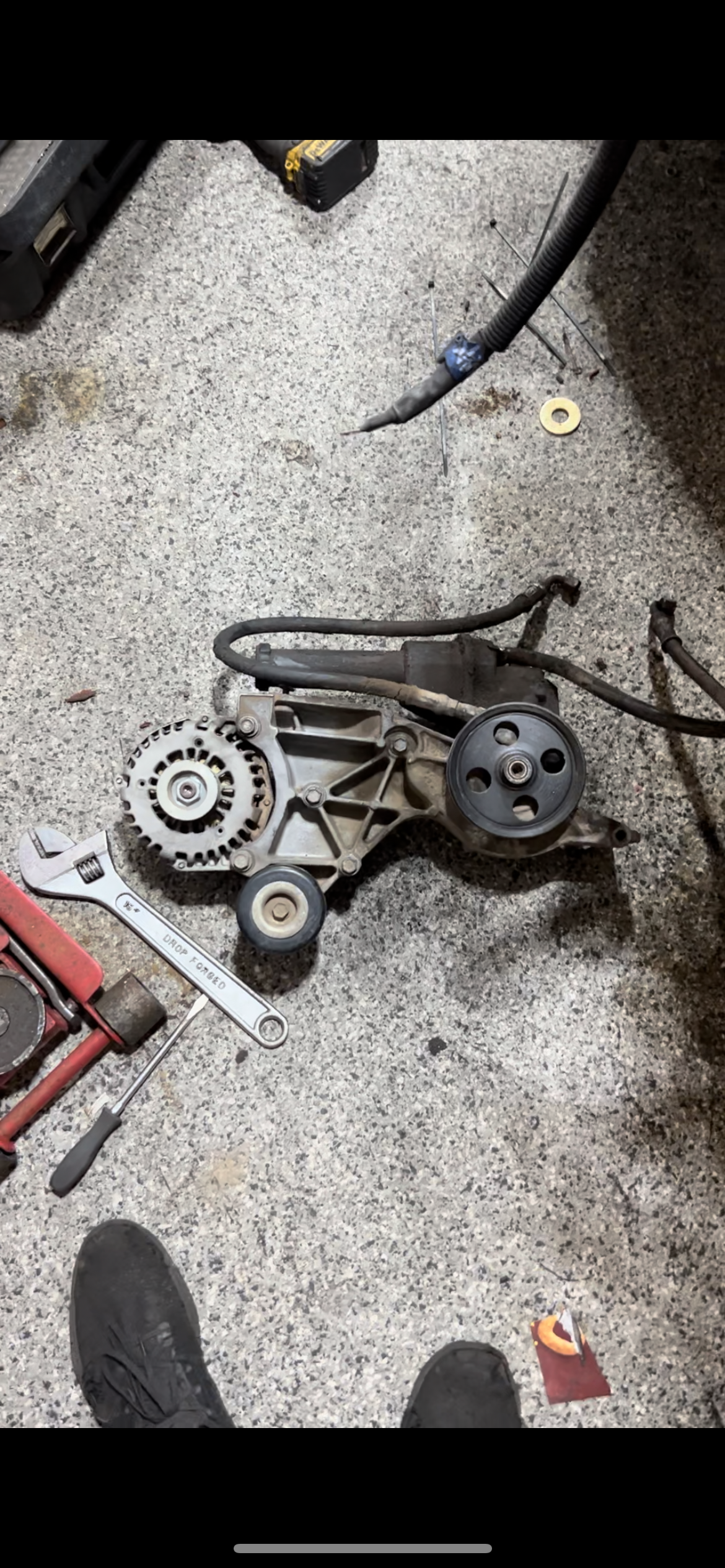

Now for steering. I have pondered the history of my steering. Historically, I have NEVER had steering issues, many friends with ram assist have suffered from slow steering, steering that wouldn’t steer when loaded, etc. I never had any of those issues unless I had hurt parts in the system.
Some interesting facts for you LS guys. PSC sells a 6in pulley, as an “upgrade” I think LS’s use a 6.5in pulley from my research. I have measured and have a 5.5in pulley, from an envoy Denali 5.3 maybe that’s why I have had no turning issues. Anyone feel free to correct me if I’m wrong on pulley sizes.
I also run no cooler. Never have, but that will change. I am not sold on those “heat sink” coolers that PSC recommends being better, can I just use one of these?
I also threw in a new fan clutch too. My current one was 8 years old and standard duty, I did a severe duty clutch so it engages more just for more cooling.

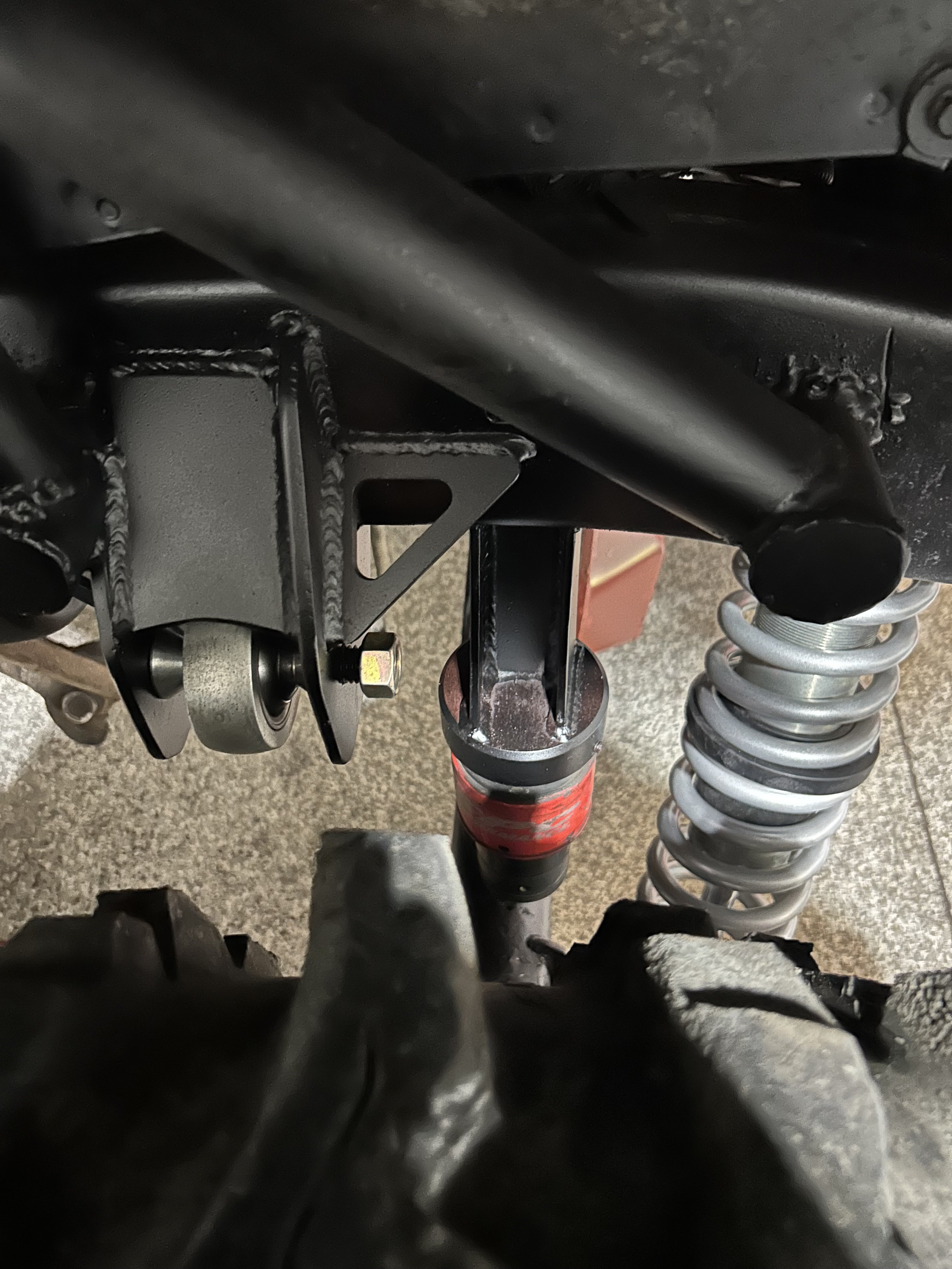

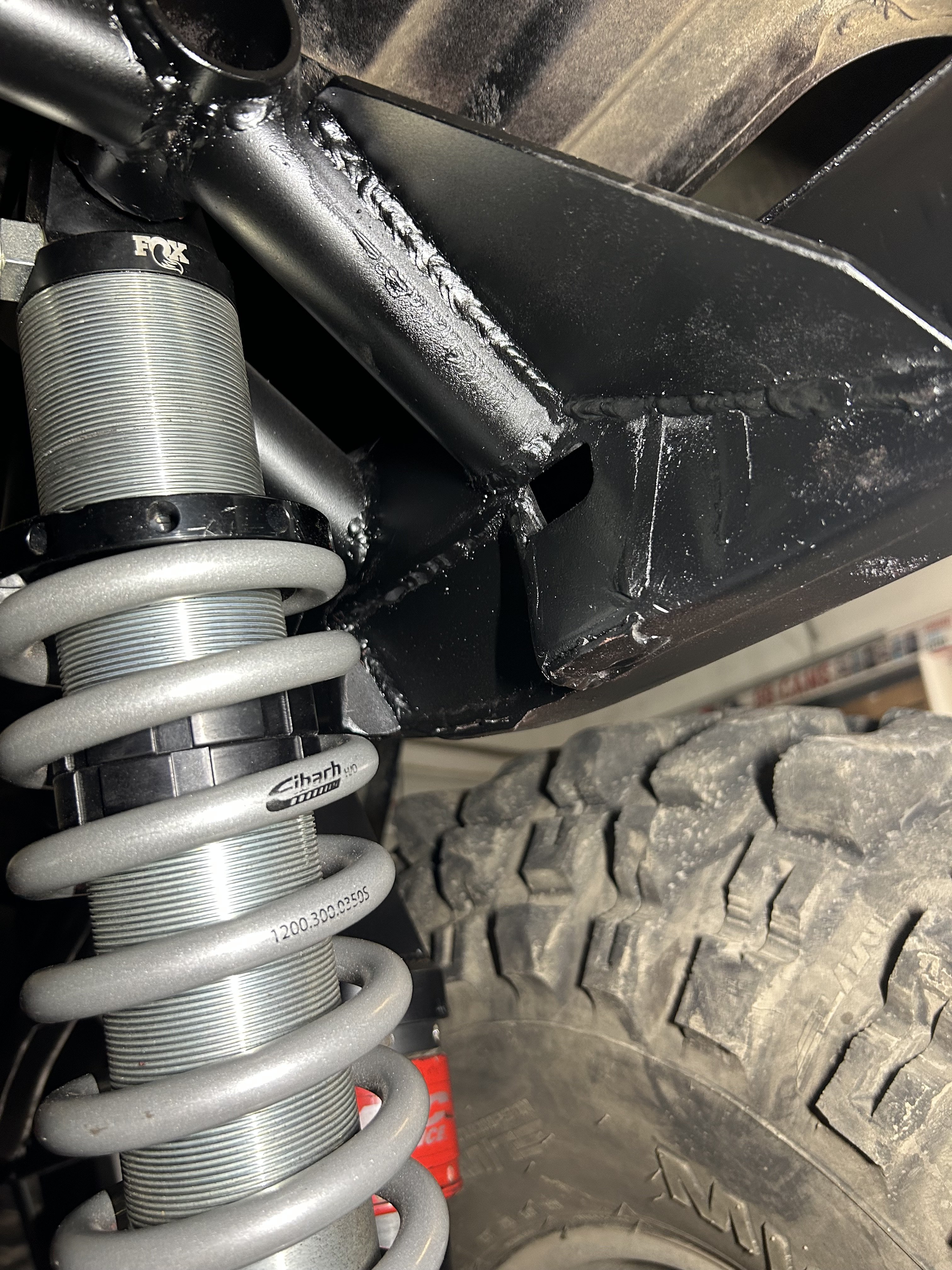

I knew the lower control arm mounts would hit more but they are hitting more than I like. To be honest I am not a fan of the brackets I bought. I feel they aren’t slippery and they are rock grabbers. The leafs were tucked up on a higher part of the frame and farther back.
I will get a better pic when I’m home but you can see how big the bracket is. There’s a decent sized lip on the front, then it protects the entire heim with room to spare. I actually would like a smaller lip and let the bottom of the heim sit below the bracket. I think the transition will be easier.
I won’t be going out to change it immediately but I figure long term change will happen.
