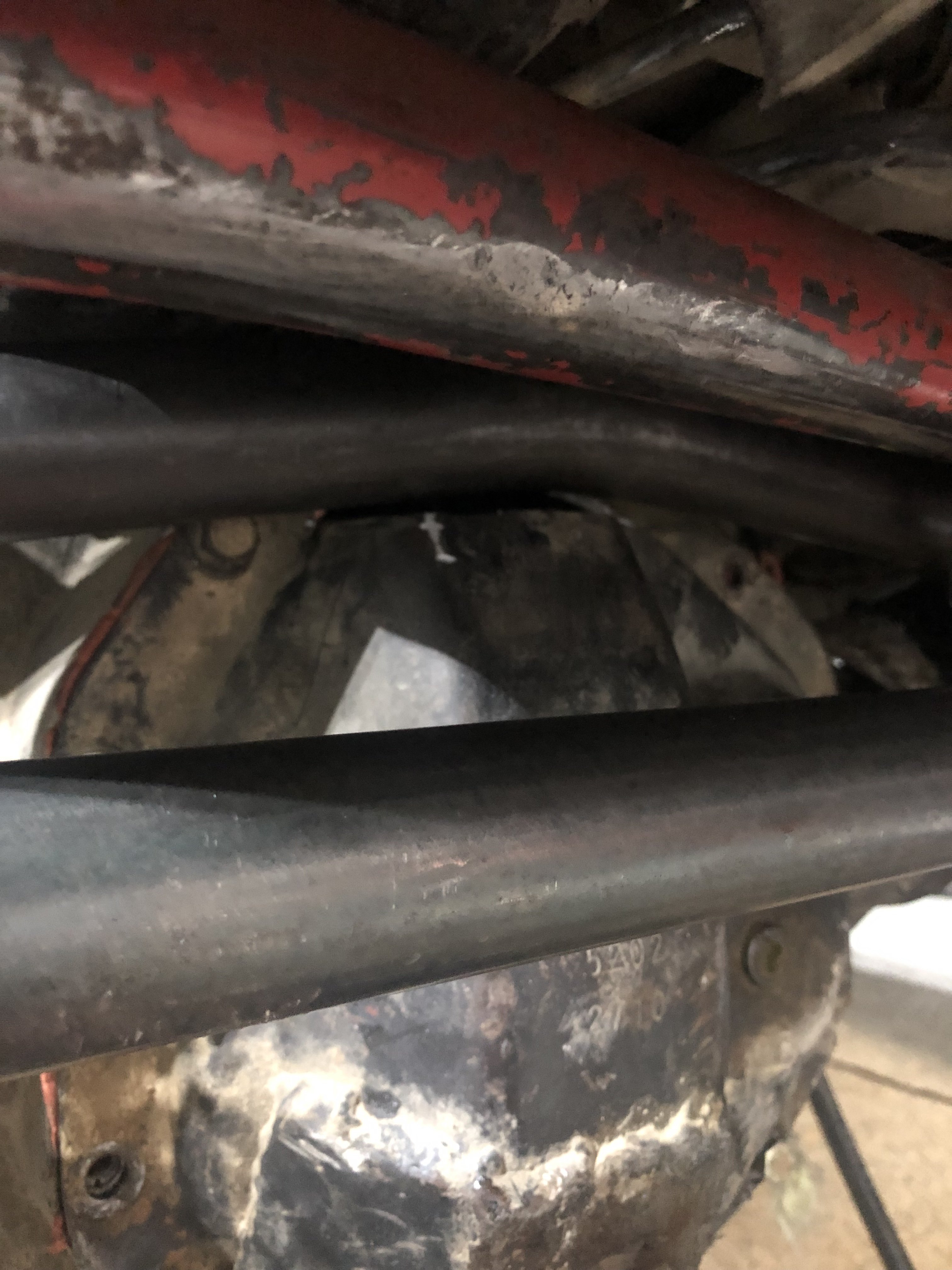

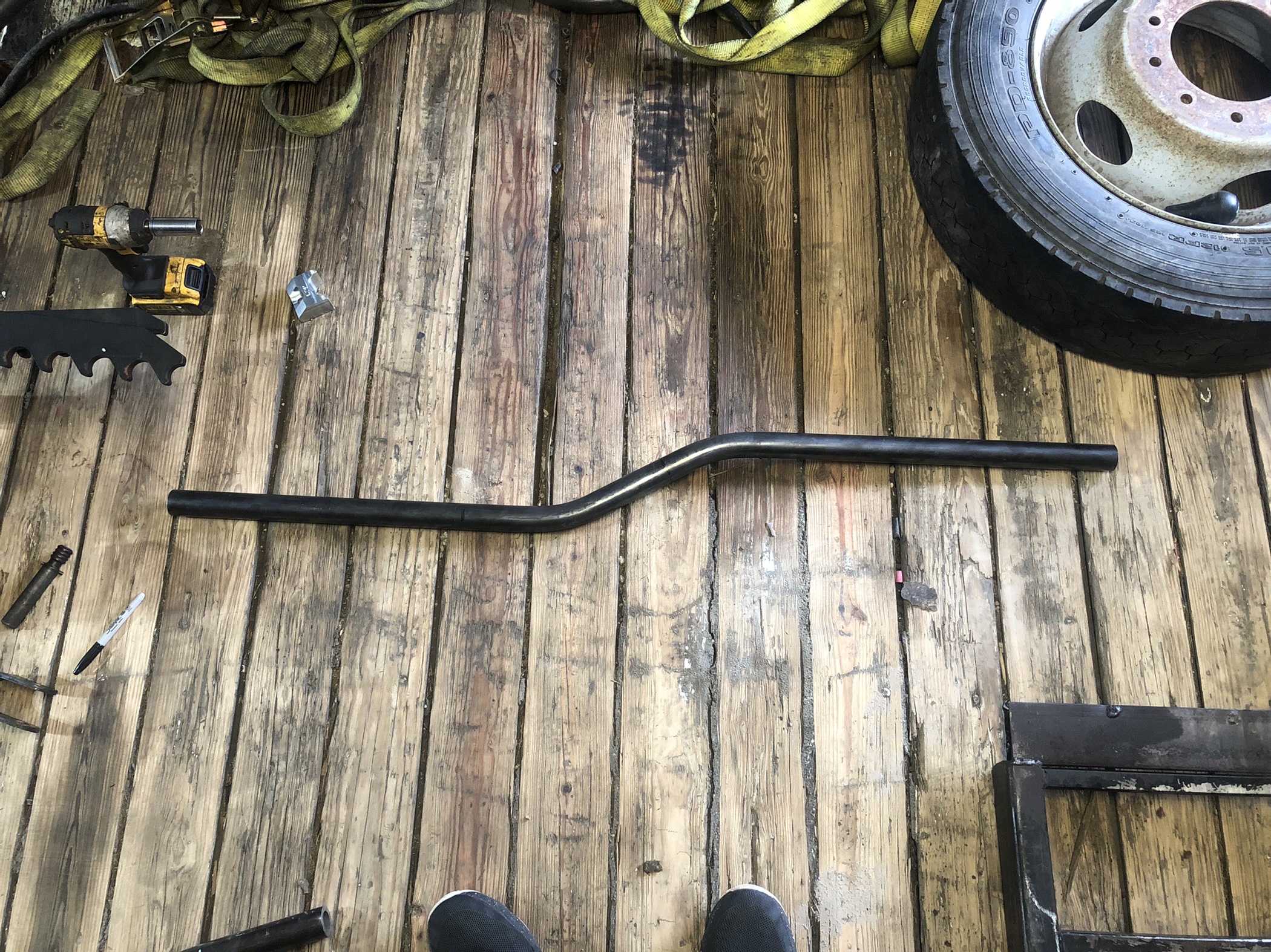

Now it’s time for some changes. I gotta change up my track bar. My drag link and track bar hit into each other. They both had bends in them and weren’t an issue but with the new tie rod clamp bracket (since I can’t weld a clamp on the new tie rod) the clamp hits the track bar near full bump which deflects it into the drag link. I wasn’t fond of them to begin with and now I gotta make the change.
I bent up some tube and am unsure if I will go this route or do 2 more bends to make it follow the “hump” of a differential.
3 goals, I want this behind the drag link so they can never physically touch each other vs them being in the same plane.
I also want to make sure it’s stronger then before. Im pretty sure I bent the 1.5in .25 wall track bar once before. It is tough to tell as it had a bend in it on purpose but I may have bent it. I did reinforce the existing track bar with 1/4in plate and it hasn’t bent since, so maybe I’m wasting my time and should just replicate this with 1.75 .25wall or .375 wall.
The other goal is to make it “anti wobble.” Because it has bends in it the jam nuts can come loose and allow it to swing. Since everything under my rig is like 10 lbs of shit in a 5lb box I want to find a uniball weld on cup so one end is fixed. I need it to fit in a 2in wide bracket which doesn’t seem to be as common.
From there I can work on the drag link redo

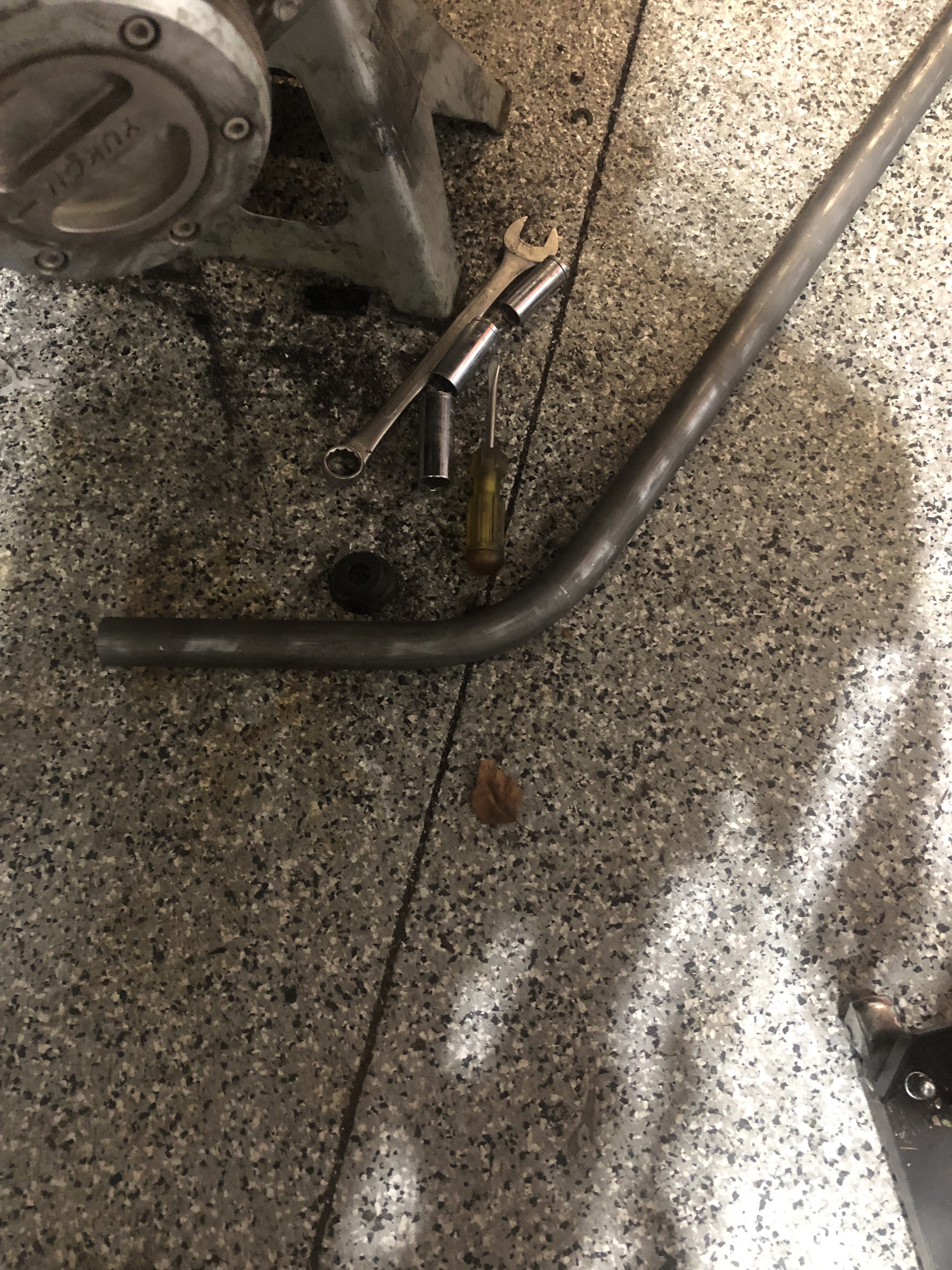

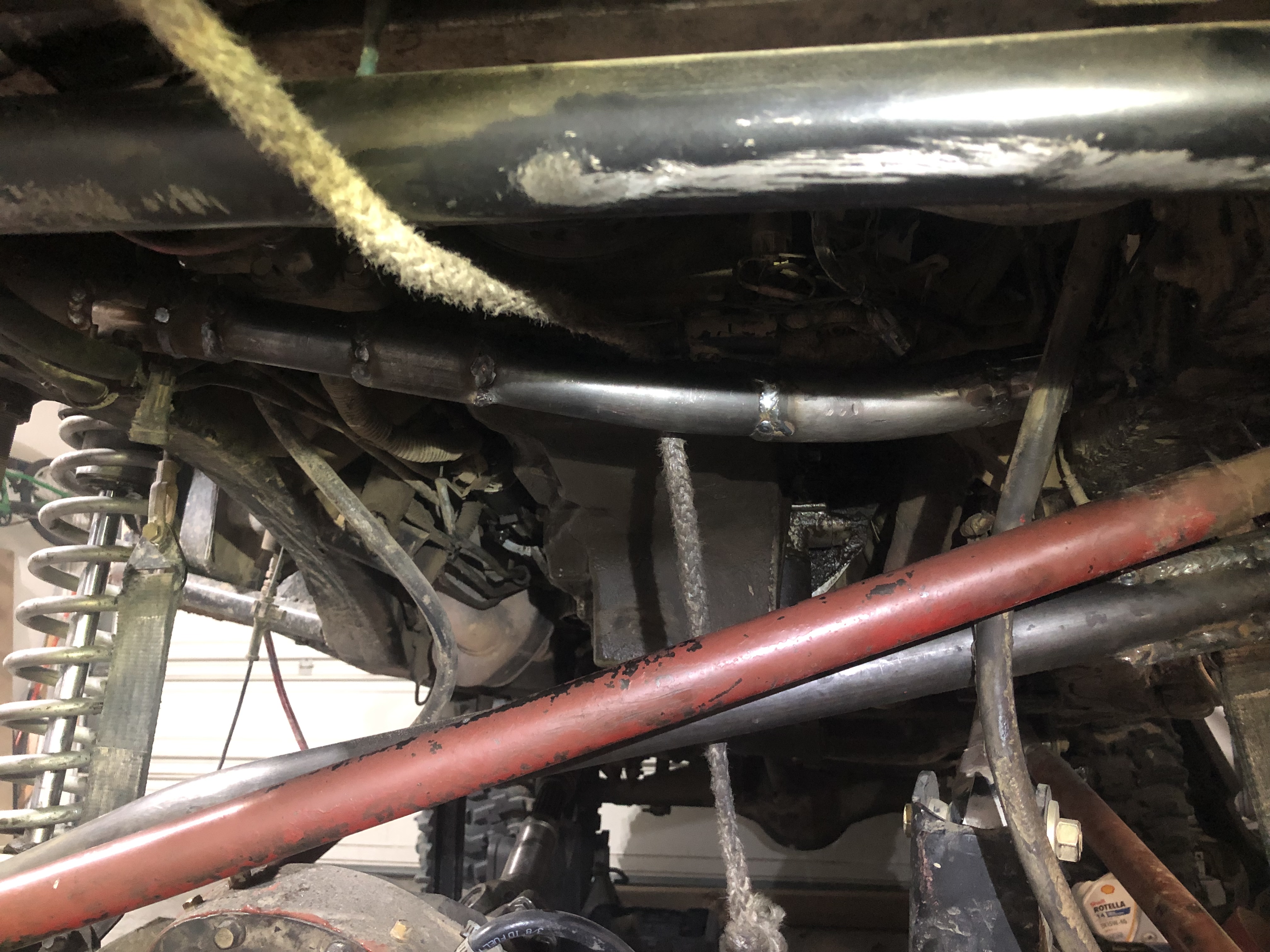

An update: I got the track bar done and the drag link. I was able to shoe horn a 1.75in .25 wall track bar in there but it required a lot of work. I had to move the track bar hole down 1 hole (1in) to avoid frame rail contact, then it hit the diff cover.

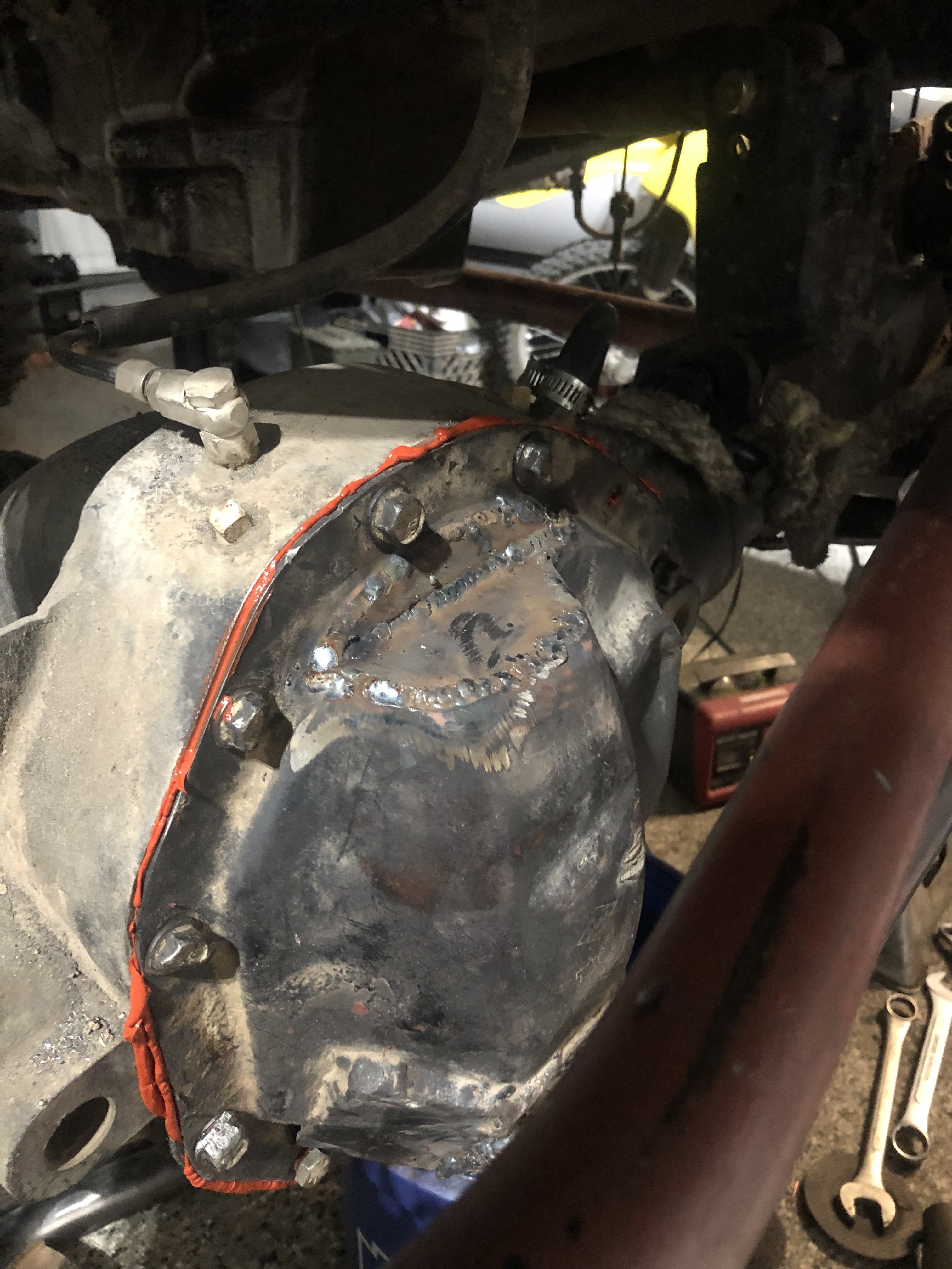

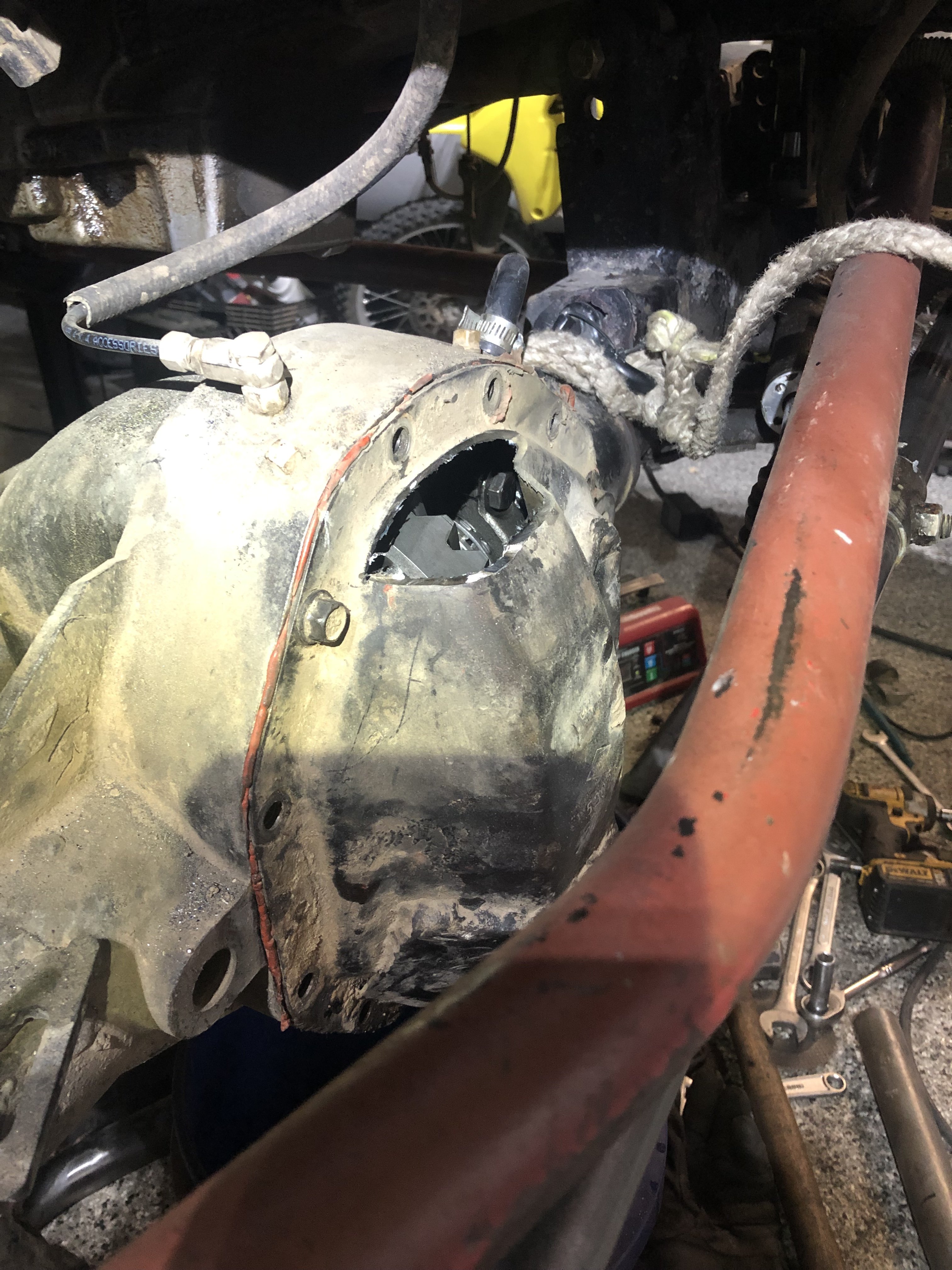

So the covers off cut it, test fit.
It cleared the ring gear and the track bar. So welded it up. Gale banks wouldn’t like the fluid dynamics here but it’s a front diff with locking hubs….
I also went with a fixed end on the frame side (1.25in uniball) so it can’t wobble. It needs to be oriented a very specific way and jam nuts coming loose and be an issue. I am also neurotic about the small weld surface on a fixed end so I wrapped it in 1in .25 flat bar. It was welded completely after this pic.
I flipped the drag link under the high steer arm, had to drill it out and put an insert in it to go under the arm.
I need to run the numbers again to make sure I have no bumpsteer but so far so good on road feel. drag link starts higher and ends higher, track bar is on a similar plane but lower. With the bends it looks off but drawing straight lines from pivot to pivot it looks close.

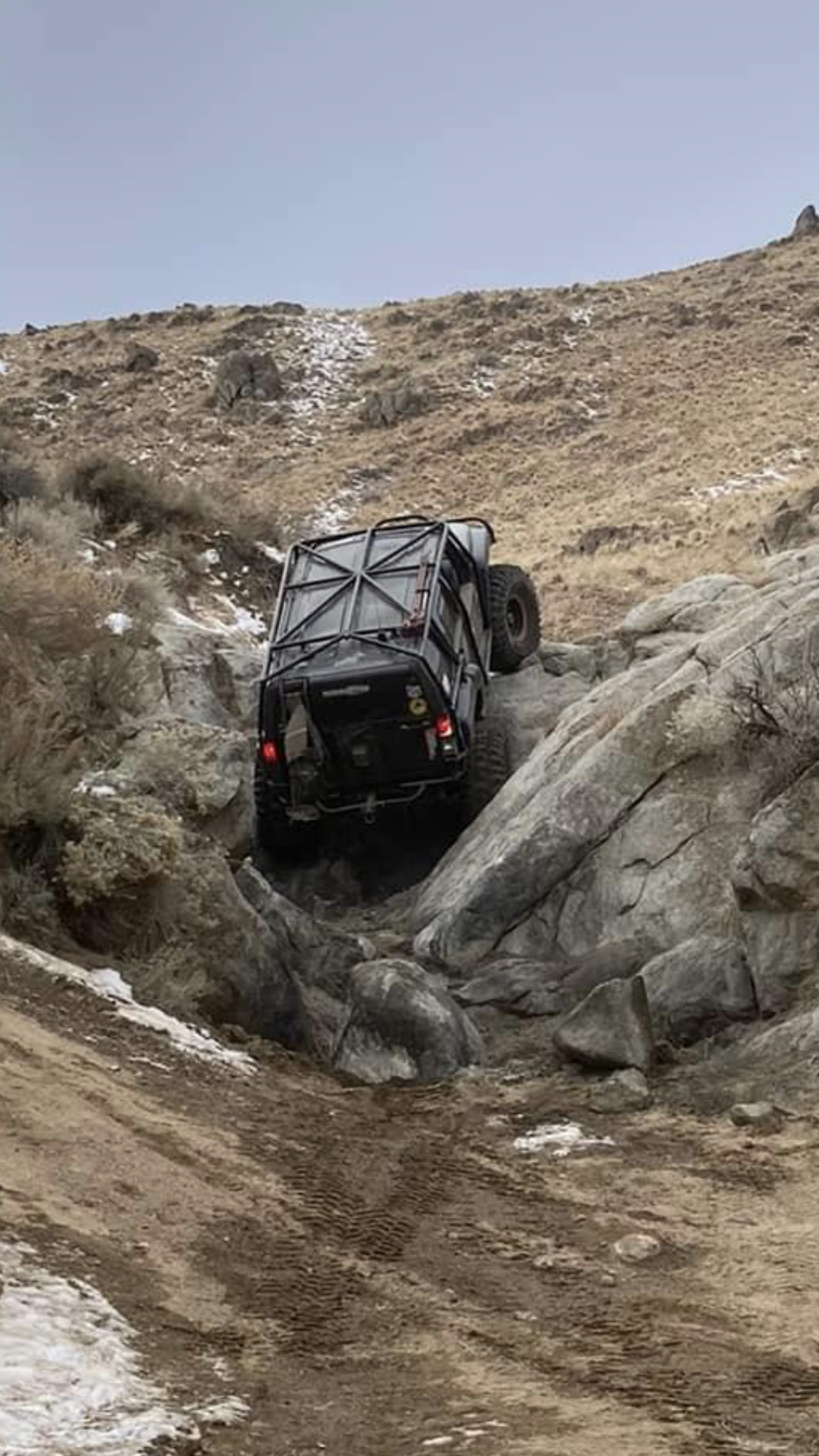

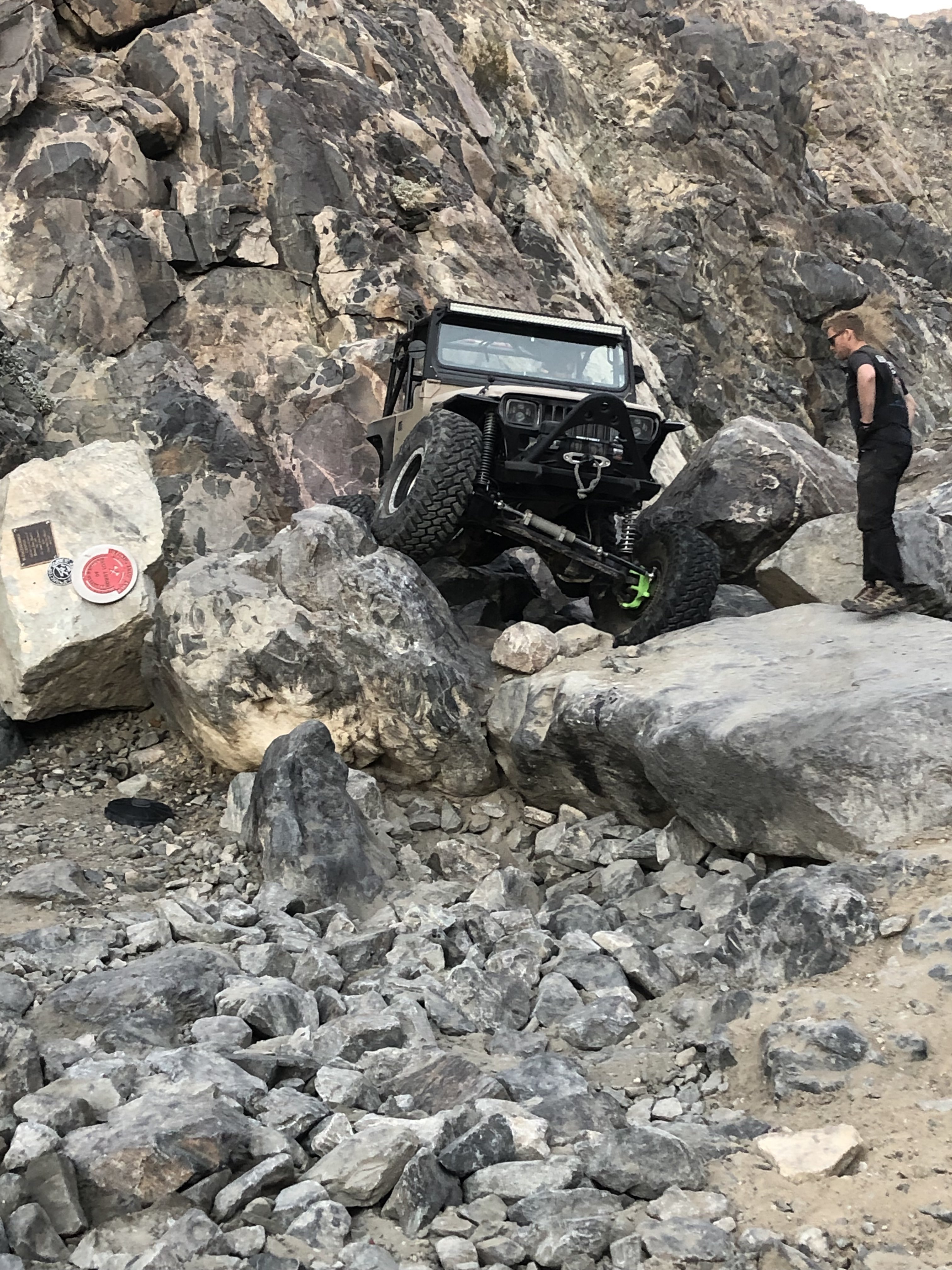

I had a near scare flop going down sledge but luckily it stopped before going any further.

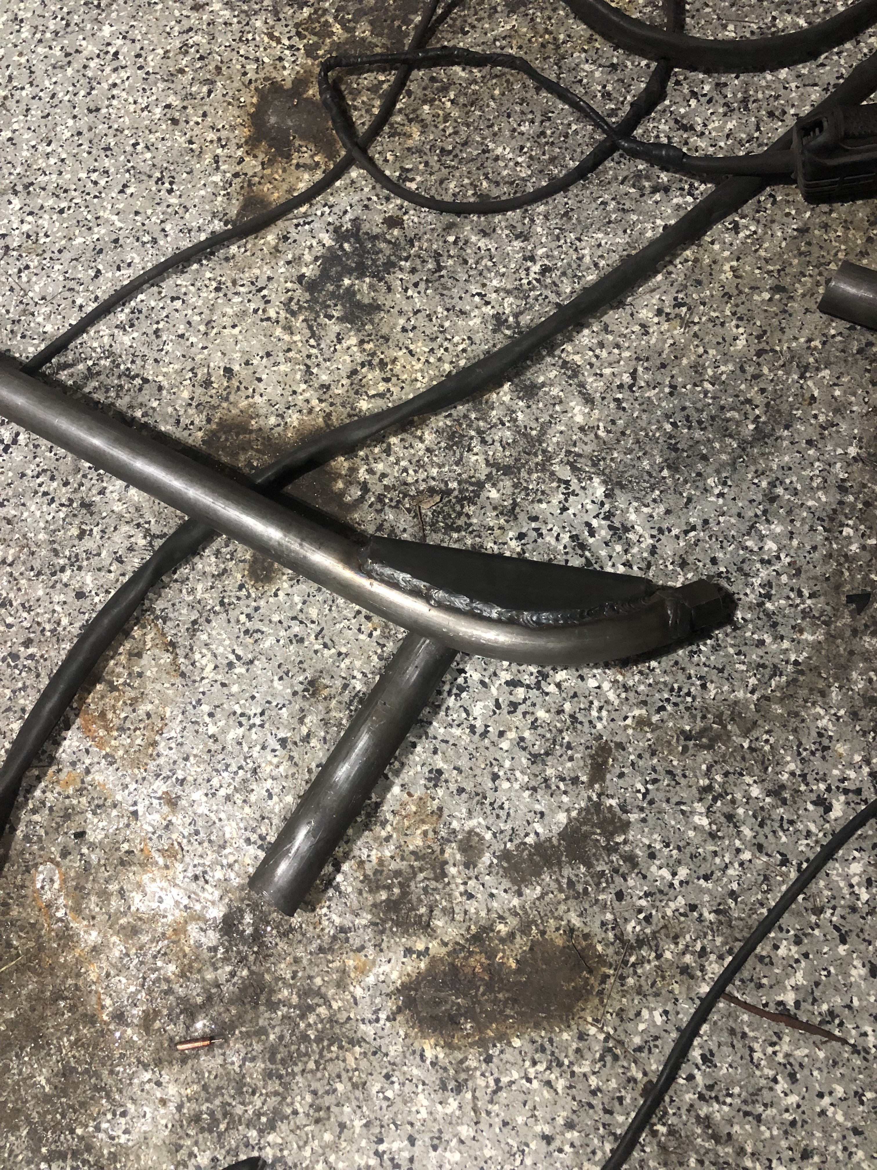

I got my steering capable of 34-35* again. I built a new drag link and beefed up it to avoid it failing at the bend
Here is how much bend I needed.
I cut out 3/16x 2x2 box tubing and cut one end off of it and made it follow the radius.
I also welded it a straight piece of plate at the center of the bend that butts up against the end of the 2x2 on the inside if that makes sense. So if it does try to bend it will transfer the load.
So now I have 34-35* of steering I just have to get other crap out of the way so my 43in tires don’t hit anything to actually get added angle.

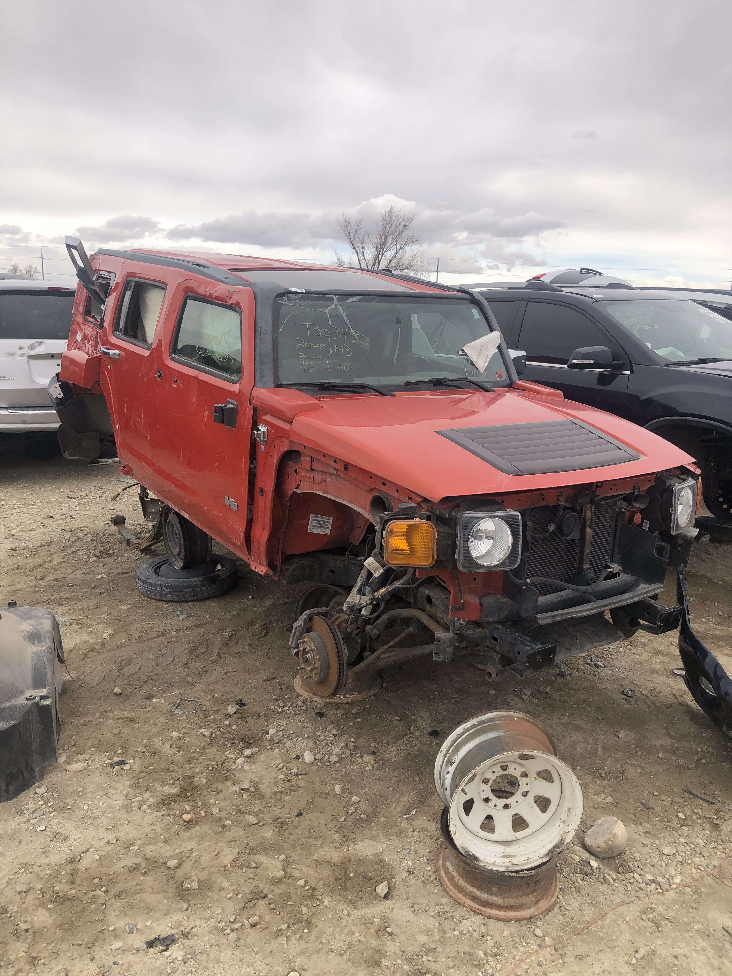

Then for the first time in my life I saw an H3 in the junkyard. I knew it was coming to the yard but didn’t know when, so I checked the inventory daily. I grabbed as much as a could. 3 fenders, abs module/brake booster/master combo. Those damn things are like $500-$900 depending on what brand. I got it for wayyyy cheaper then that. A bunch of interior trim, grabbed a BCM, ac condenser, compressor, lines, etc. I grabbed a ton of crap.
I hope to give the H3 a “2nd lease of life” from an aesthetic perspective. I’m still running my original fenders, they are all hammered and fucked beyond repair. This can give new life to it. From a drivetrain perspective it’s on its 10th life and running well but the looks need some help.
It was pretty complete until I showed up lol. I grabbed the headlight assemblies too.

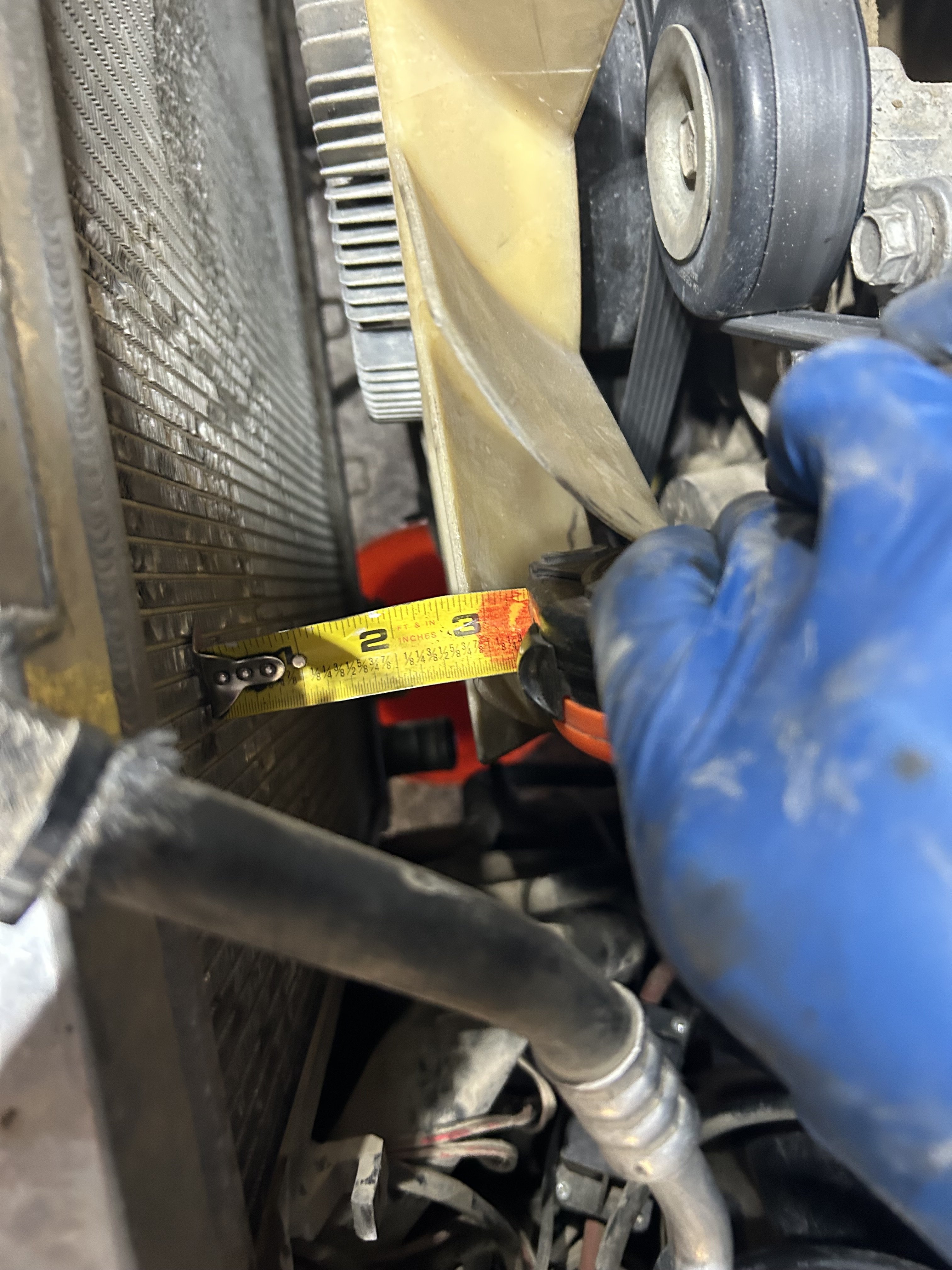

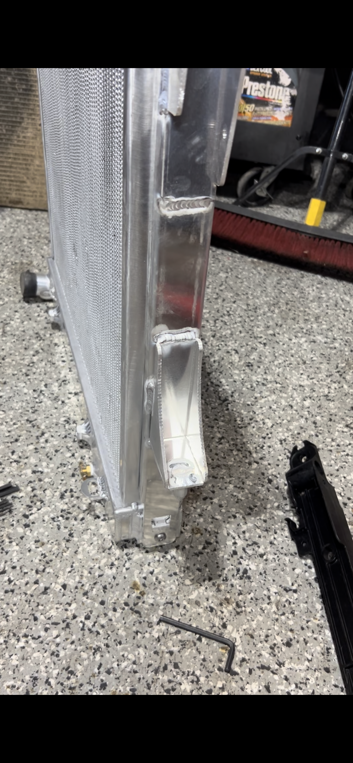

My radiator leaks and I’m going with an ECP radiator which is like double the capacity so it isn’t a bolt in deal unless you go with e fans. I like the fan clutch.
Factory sized radiator is 2 7/8 in between fan blade and rad.
New radiator is 1 3/4 inches away from the fan blade

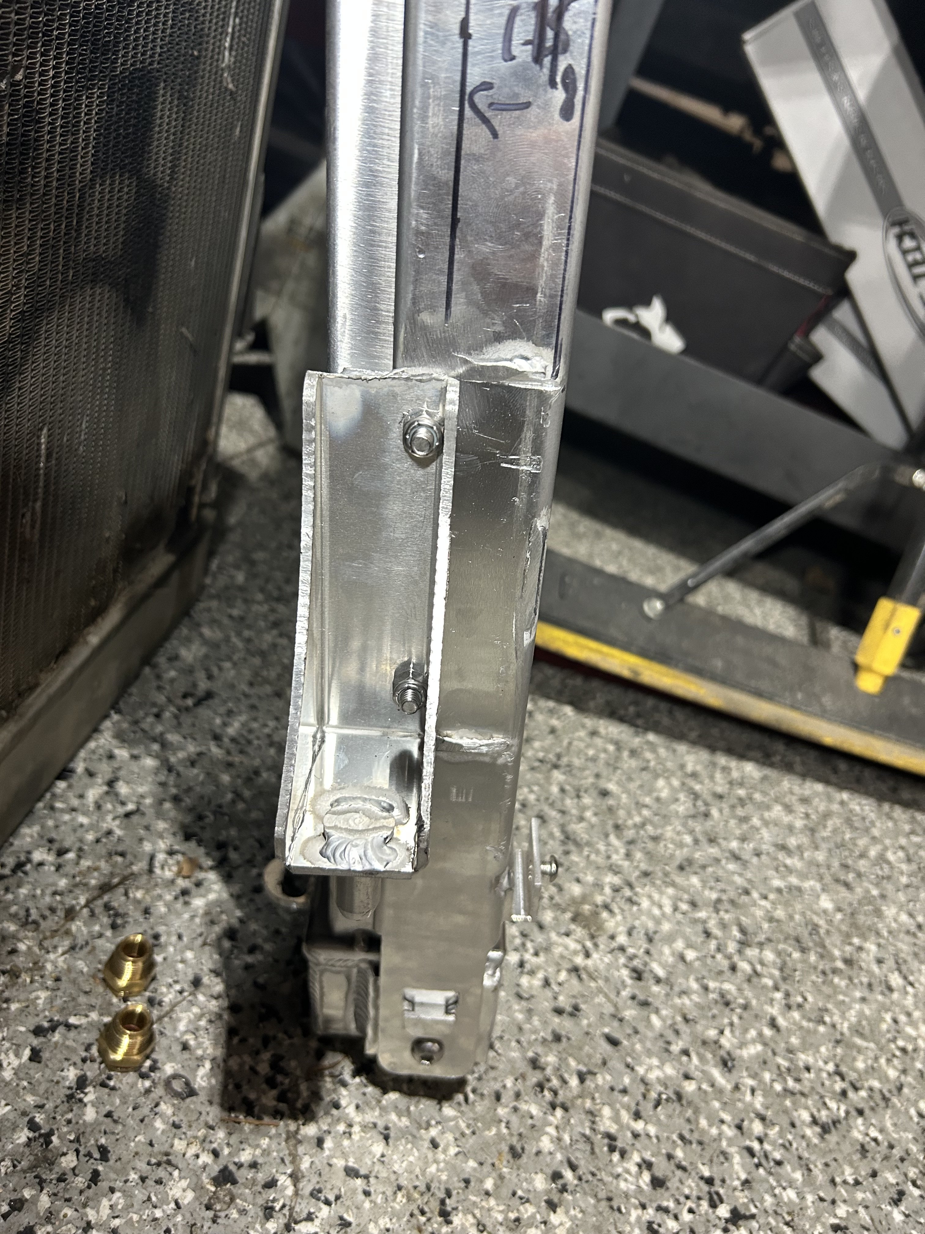

These end mounts are removable, I will unbolt them, cut it off the mounts and section them 1 1/4in offset to get the distance I need. Then I will cut into the core support to get some more room to section it forward. I am basically copying @jimmy p
I haven’t welded aluminum but will probably pick up a spool gun today and learn.

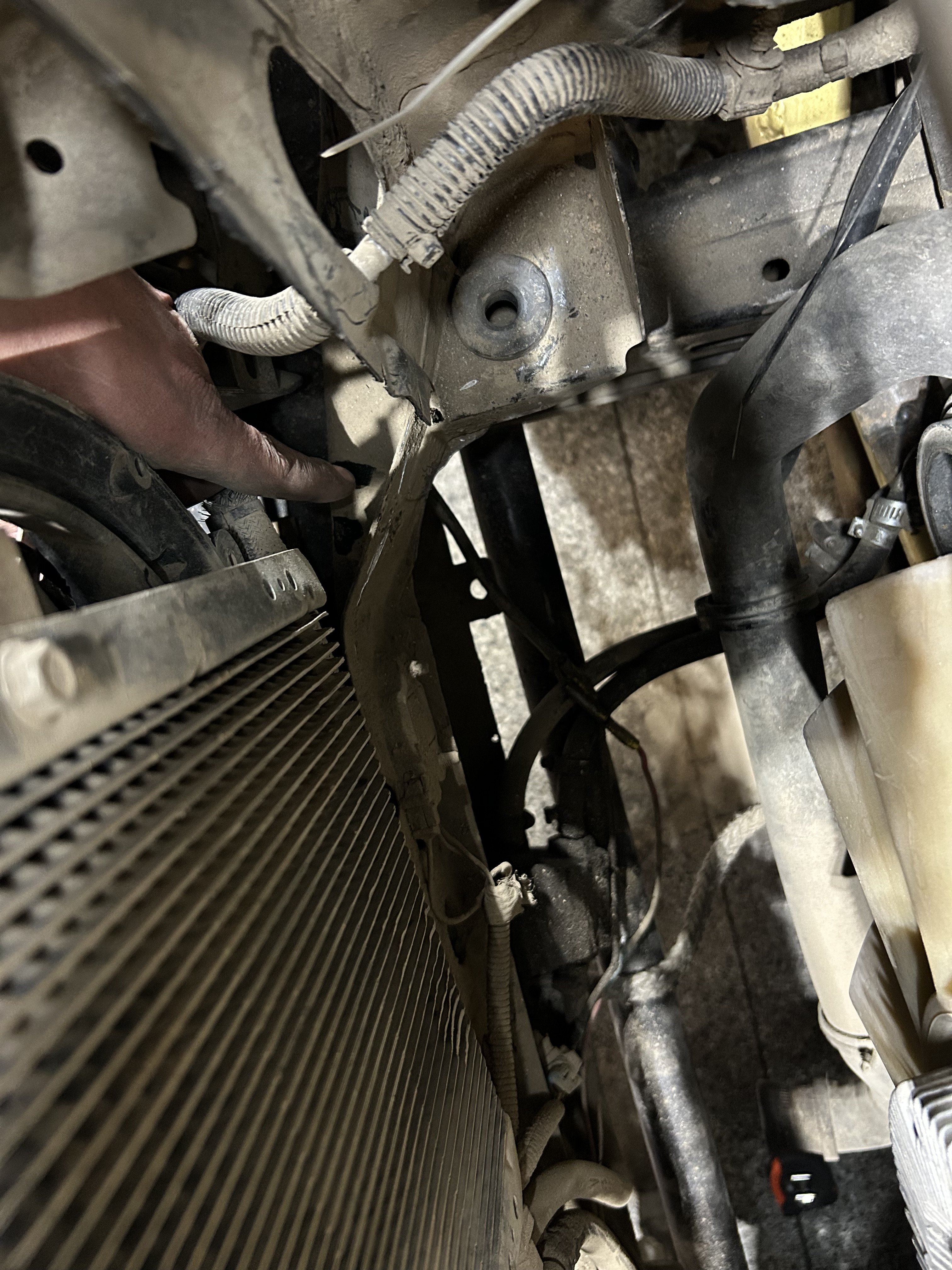

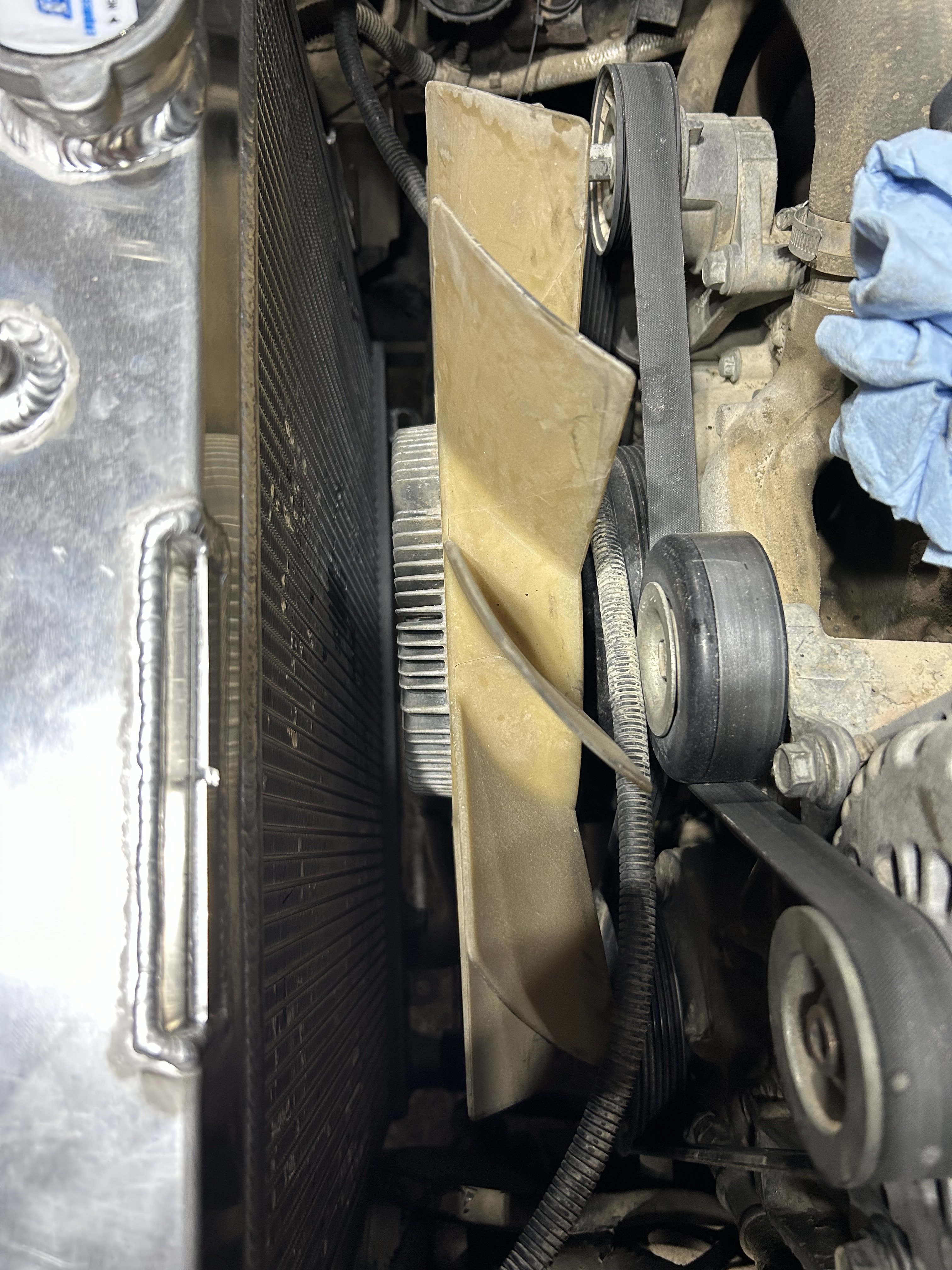

Worked on the radiator last night .
Long story short, the radiator used to have 2in between it and the fan clutch and 2 7/8 between it and the actual fan blades. After trimming the core support 1in and trimming in 2 other areas I have it to where it is 1 5/8 from the fan clutch and 2 1/2. I think that should be enough to keep the fan out of the radiator.
Now I have to trim one more section for the little reservoir on the ac condenser.
Cutting out that spot is going to be structurally detrimental unfortunately so I plan to take a piece of tube, cut it in half so I have a half circle and weld it into that spot to give it rigidity back. In the end I always have something to worry about and now core support strength can be my new worry
Here is the offset I’m using. I will weld it up. Used bolts for now if I had to change anything.
@jimmy p did you have to cut into the core support down below? I have had to do a decent amount down below and now even more for the AC condenser tube

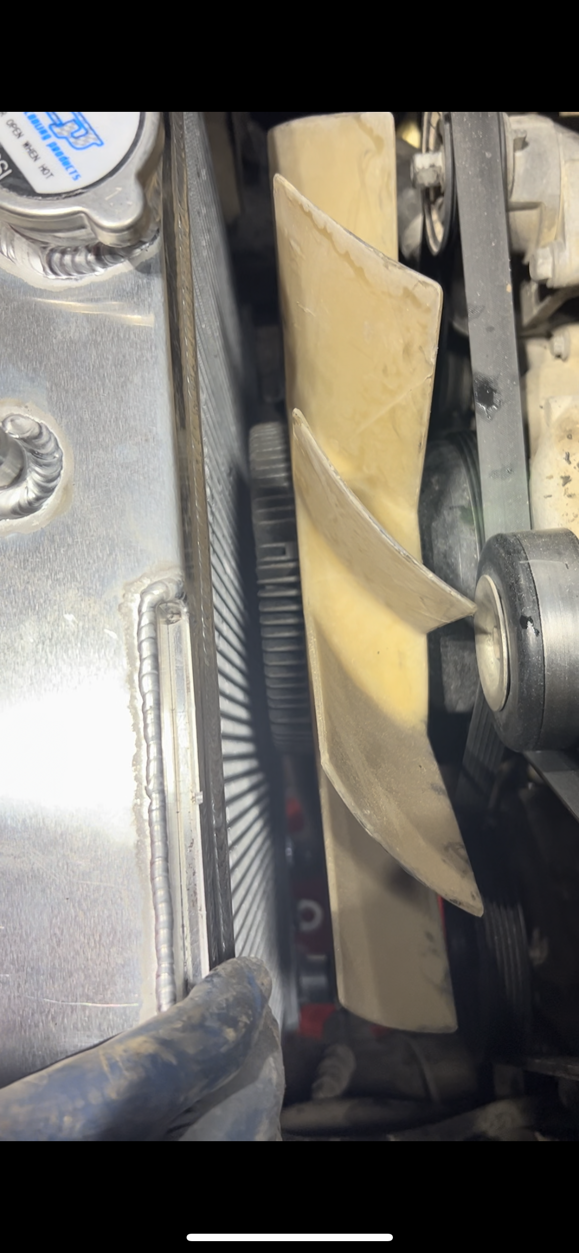

Worked on the hummer more this weekend.

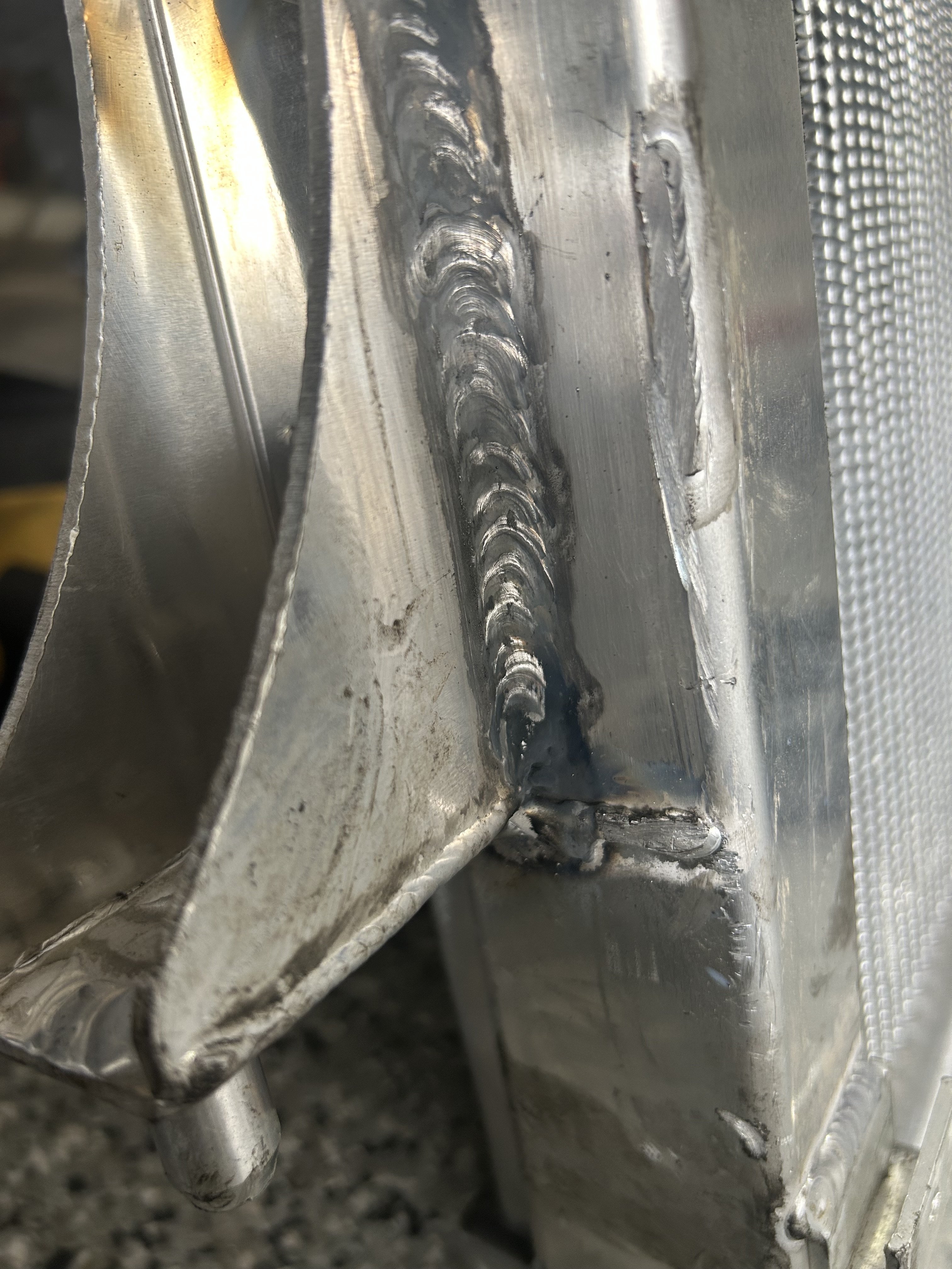

The radiator is in! I had to do more trimming, and more trimming and more trimming. Getting this big radiator in was a PITA but it’s basically done. All that I have left is the top mount. I’m going to take some 1x1 square tubing weld it to the core support and then tap it so the bolt will attach like factory. I still need to gusset the core support where I notched it but I need to gusset the front side so the bumper has to come off. I was going to take 1.75in tubing cut it in half and weld it in but there’s not enough room. It’s super thin material so I’ll just weld some 3/16 to it on the front side to give it strength back.
Photo won’t load on the radiator installed pic but I did do some aluminum welding on the side piece relocation. First time welding aluminum, it’s wayyyy different

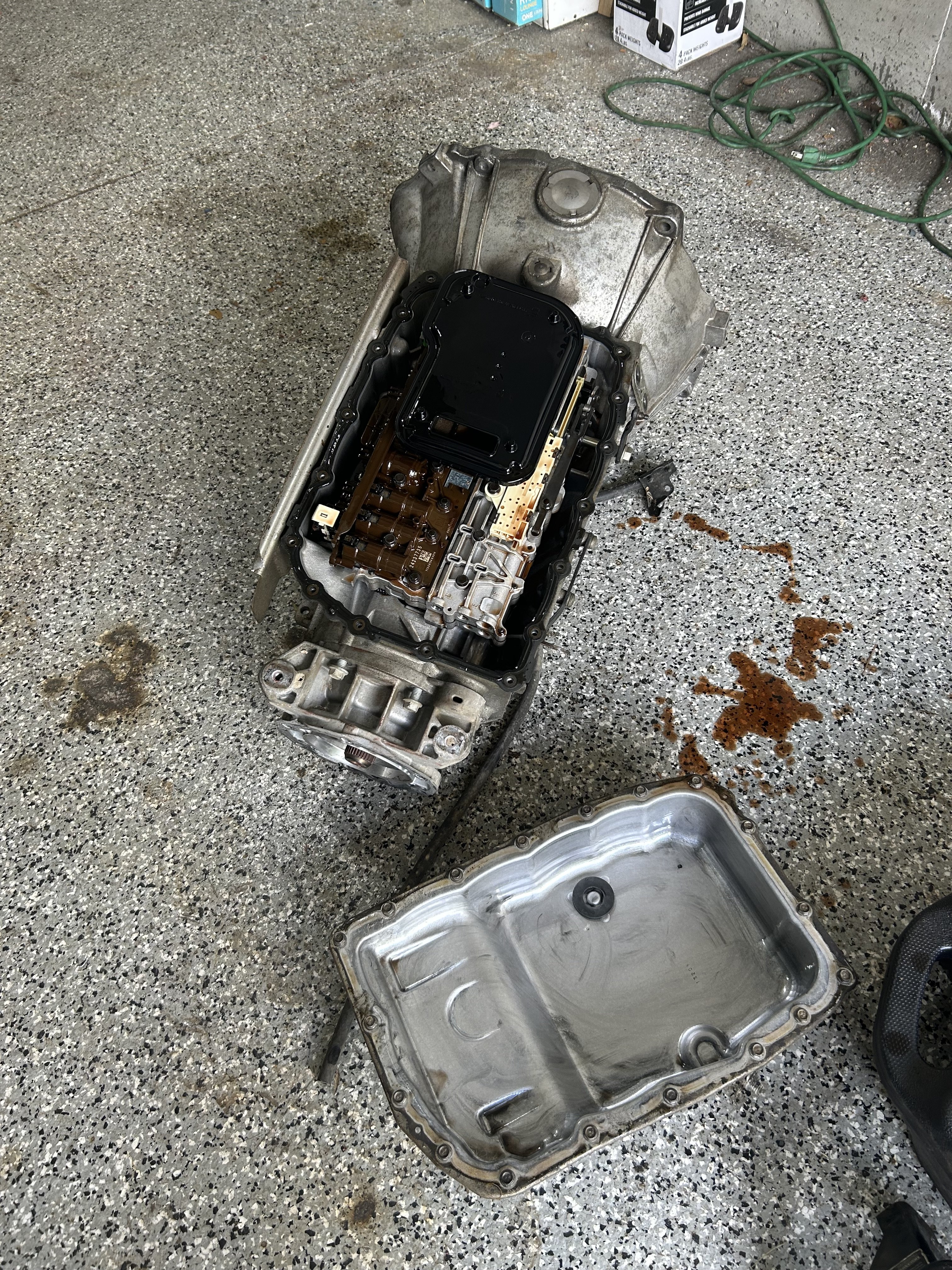

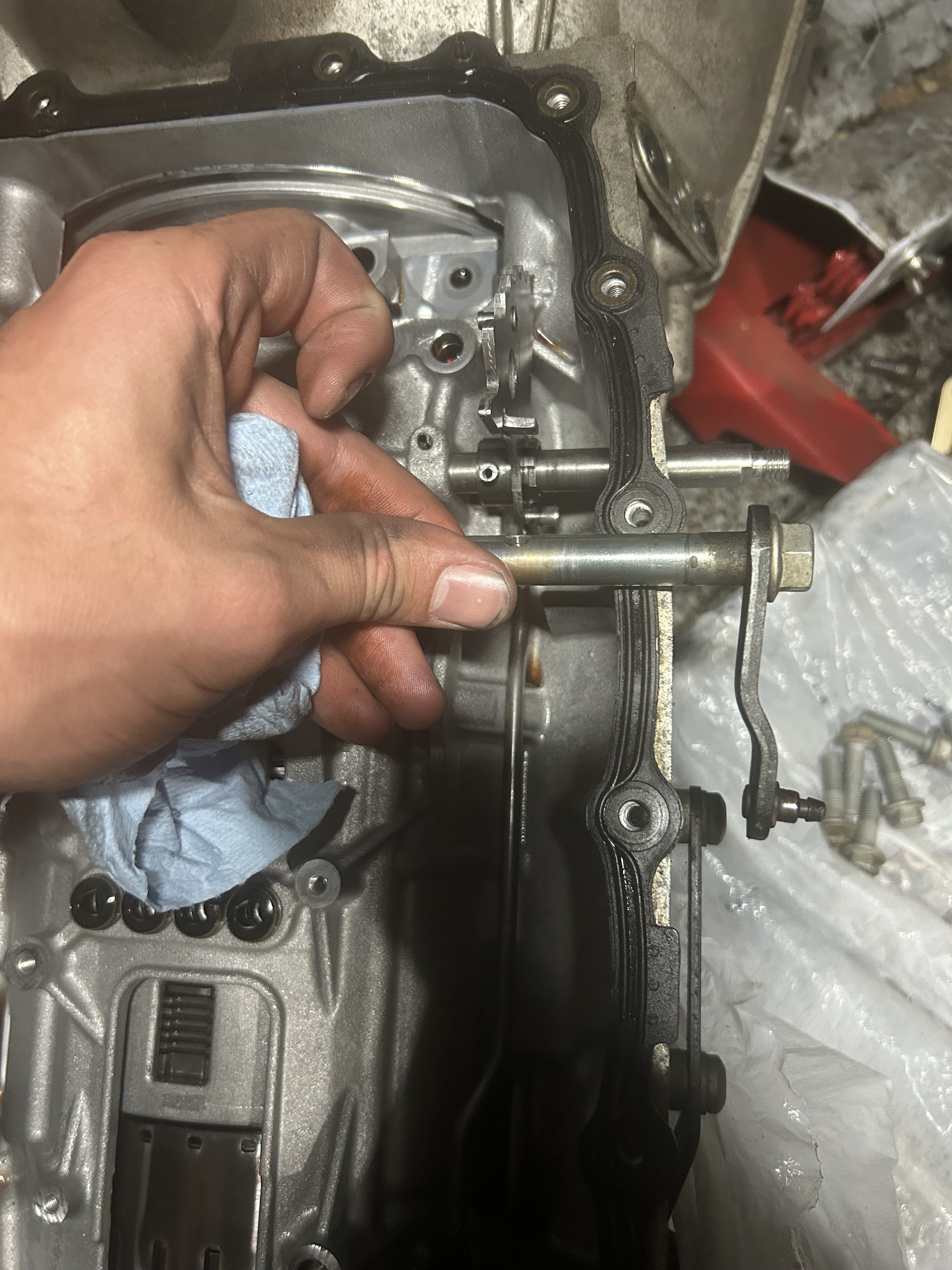

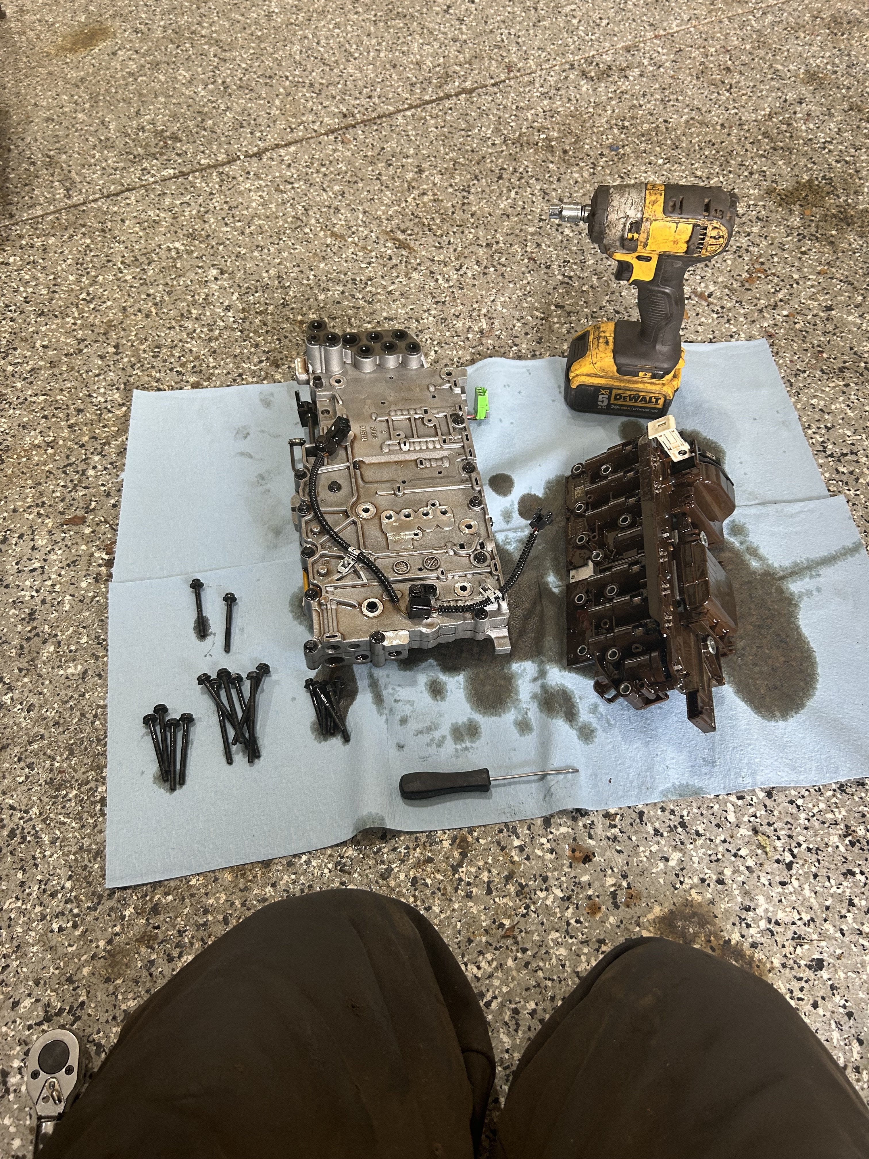

Then I worked on the 6L80E.
the seller told me there’s about 100k miles on the trans. The fluid wasn’t bright red but still red, just a little dark. No chunks or crap in the pan so I’d say it looks solid overall!
Next step is to pull the pan, filter and valve body.
Separated the valve body and tcm. Tomorrow I’ll ship out my PCM and TCM to the tuner so he get it all tuned up for the 6l80E.
Next weekend I’ll probably pull the t case and trans.

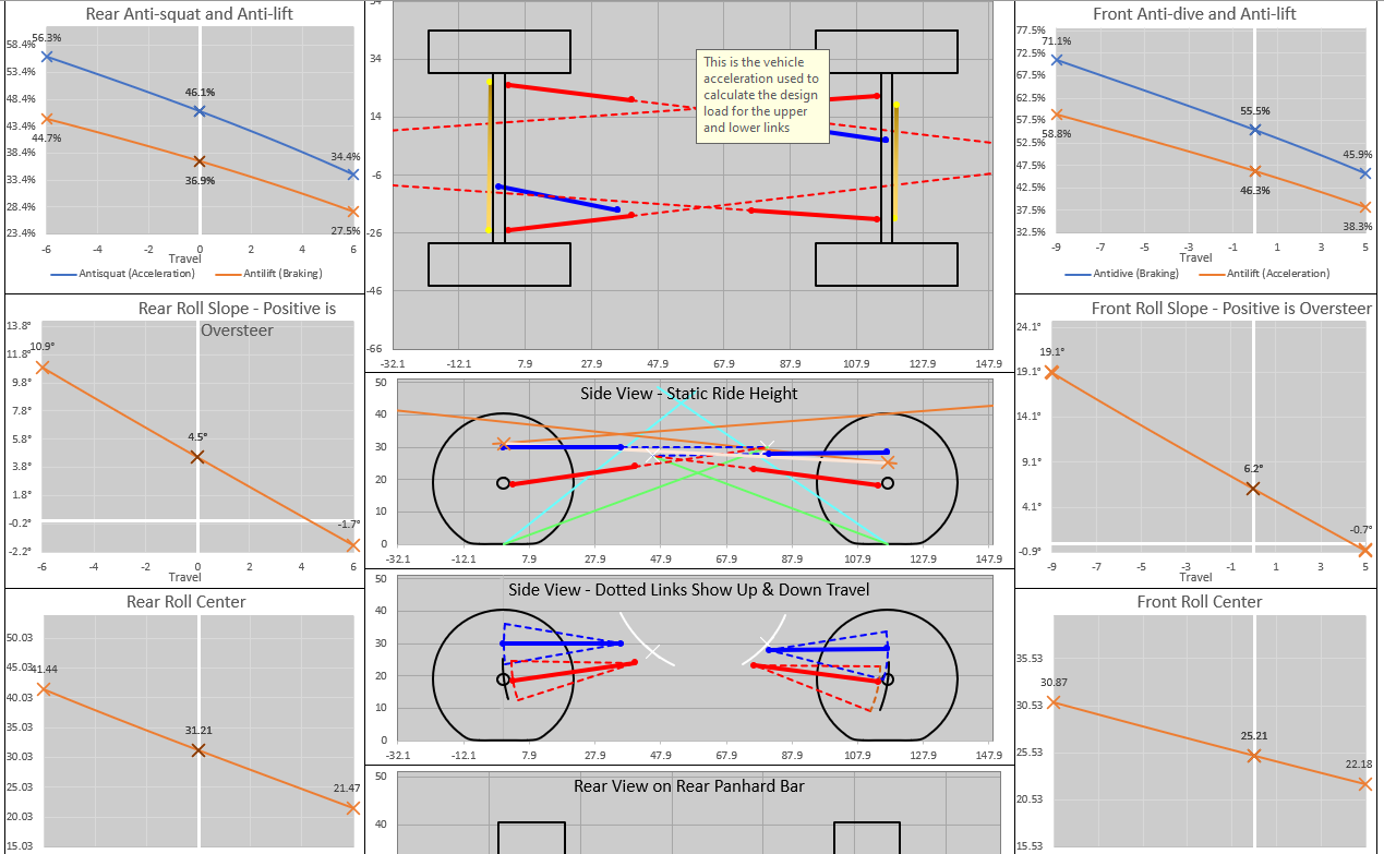

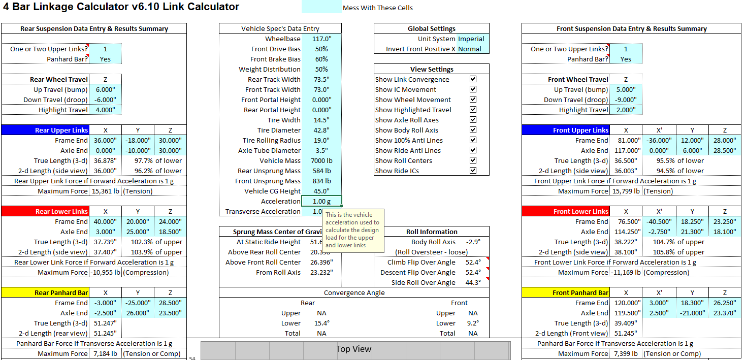

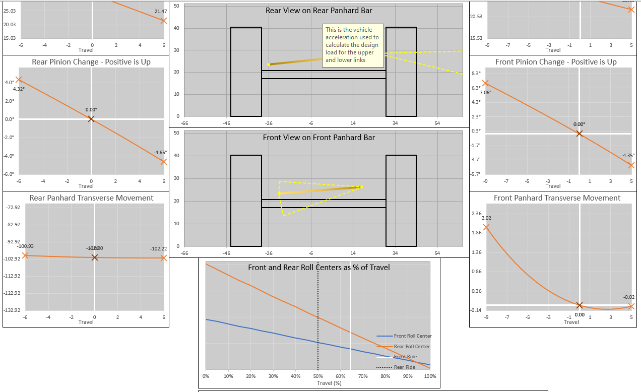

I have also been playing around with the new link calculator. It’s so cool I can see the load on the links. It’s helping me decide what I think I can get away with in terms of load and determine a 3 link or 4 link. That’s next, I’m trying to get the trans, bigger radiator and rear suspension projects done this year.

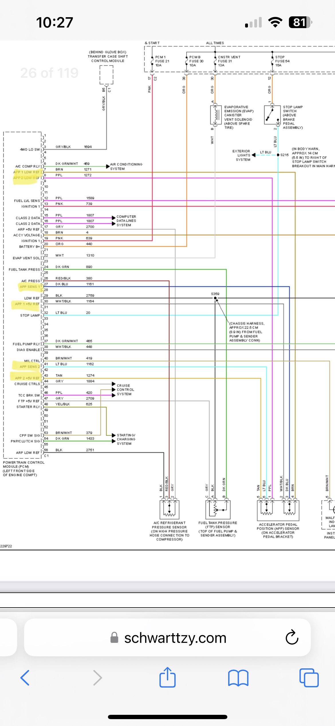

Lastly, I’m looking into how to get a high idle switch for my premier power welder. I’ve been using rocks or sticks between the pedals for years to adjust my idle when using the welder and I’m tired of that method, it’s a pain in the ass. I looked at a diagram and wonder if I can use a 0-5v potentiometer with off (0 volts) and then a dial that goes up to 5 volts. I assume the pedal position sends a 5 bolt reference to the pcm?
It’s just weird it’s got 2 5V references from the pedal. My buddy mentioned maybe it’s for a fail safe? If the pcm doesn’t read 2 identical inputs it goes into limp mode?

I think one signal goes from 0v to 5v and the other goes 5v to 0v as the pedal moves or something along those lines, as you mentioned as a failsafe. I think it is worth a shot but I expect you will get a pedal correlation code and probably limp mode. Buried in code somewhere are idle speed adjustments for ac on and ac off and a few other features not used on h3. It would be cool to hack those and be able to tap into it with a simple toggle switch. I expect the signal would need to come from a bcm though over the serial data line, probably not something the h3 bcm is capable of.

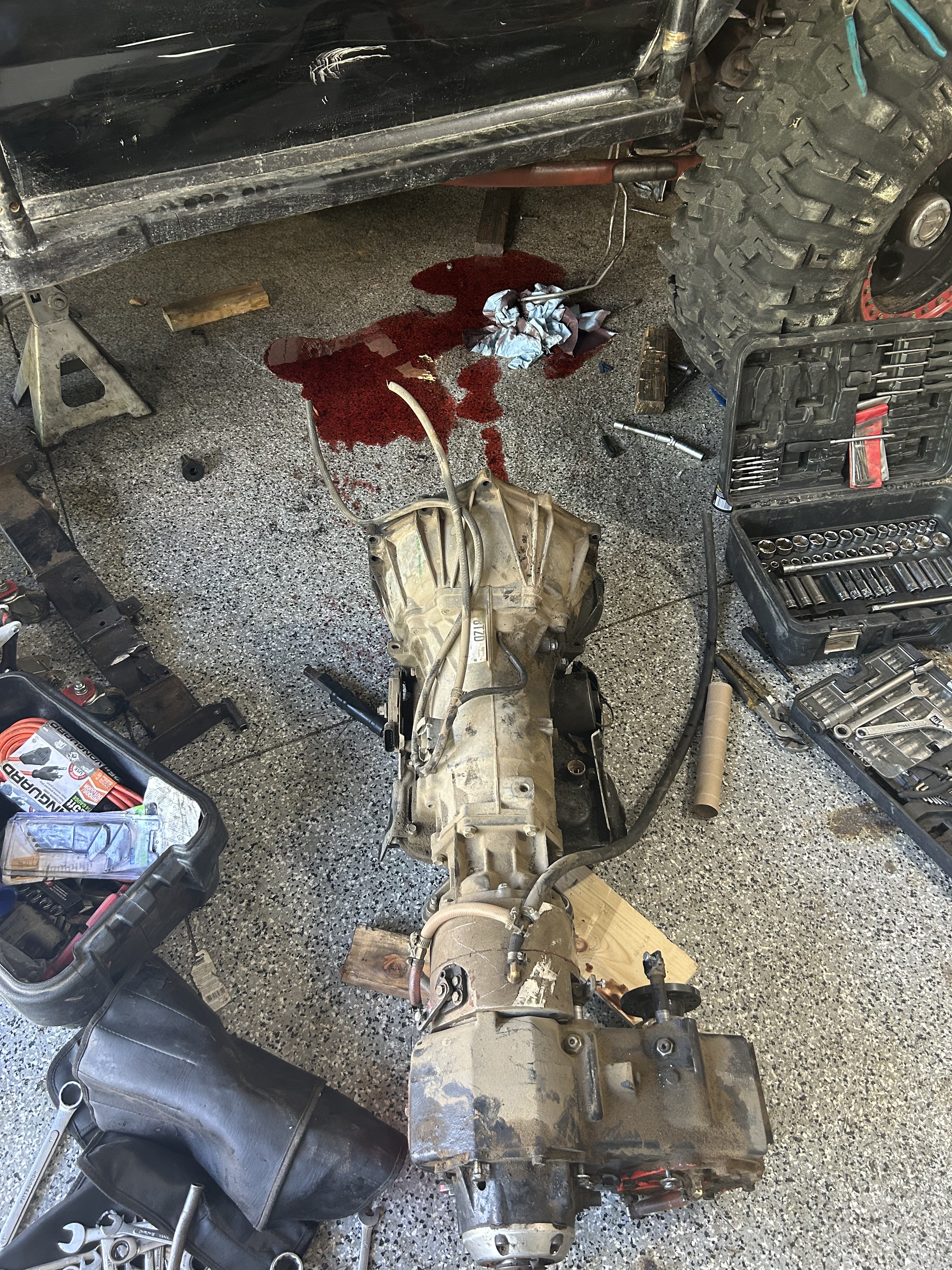

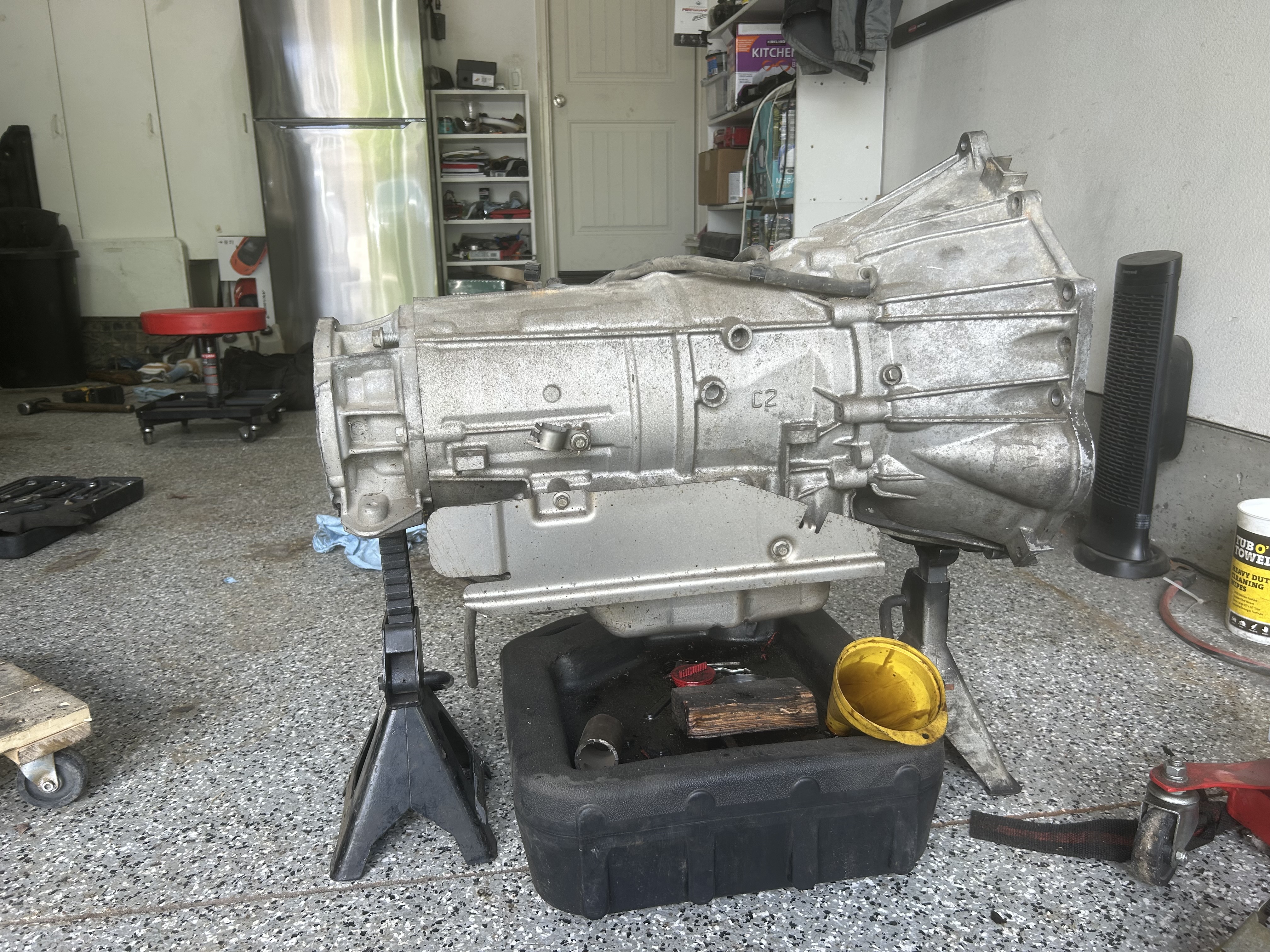

Got the trans and t case out last weekend.
Sent this picture to my parents and said don’t you miss these days? Lol
This weekend I probably won’t get much done, going to a concert and it’s my dads birthday but after 3 weeks of crazy travel I’ll have some time at home to work on this during week nights.
things to do is modify the harness for the 6L80E, swap inputs in the t case and change the rear main seal

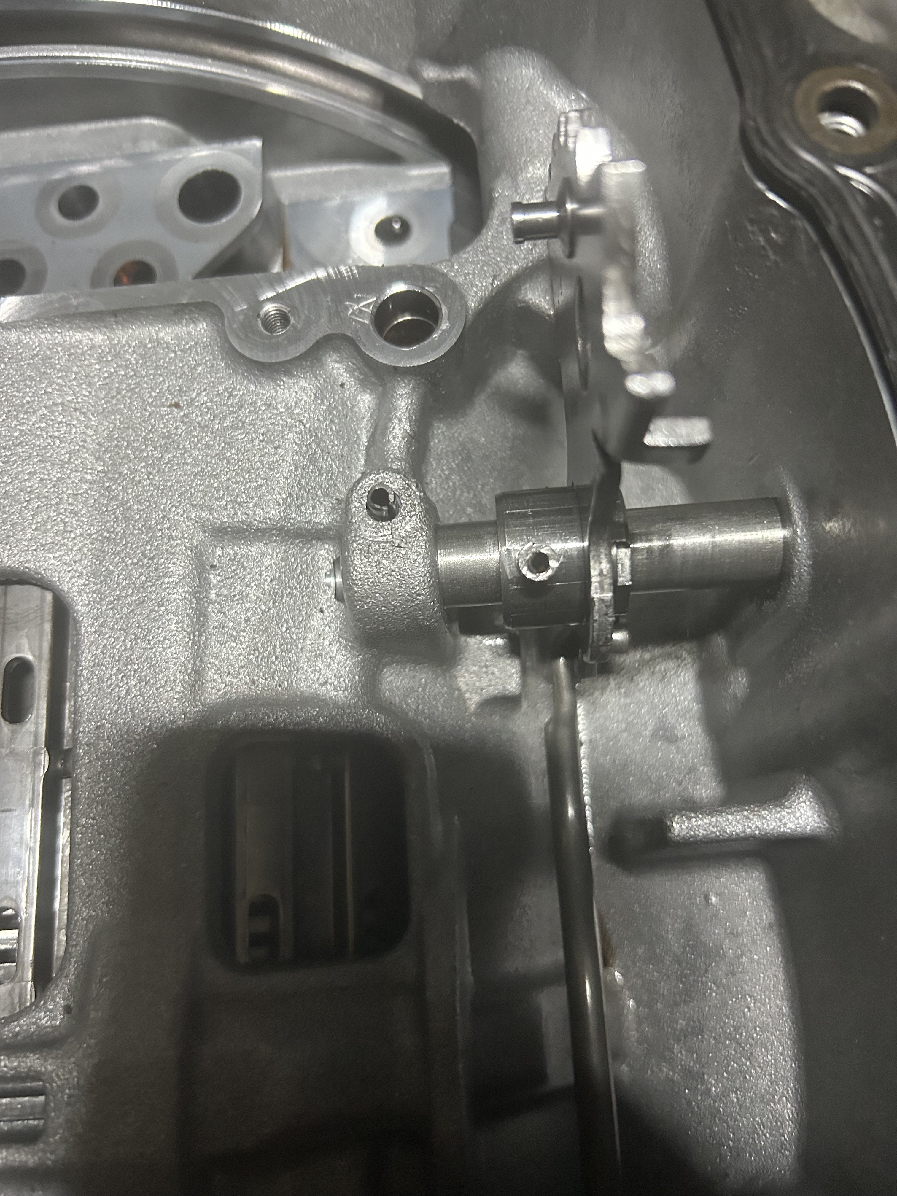

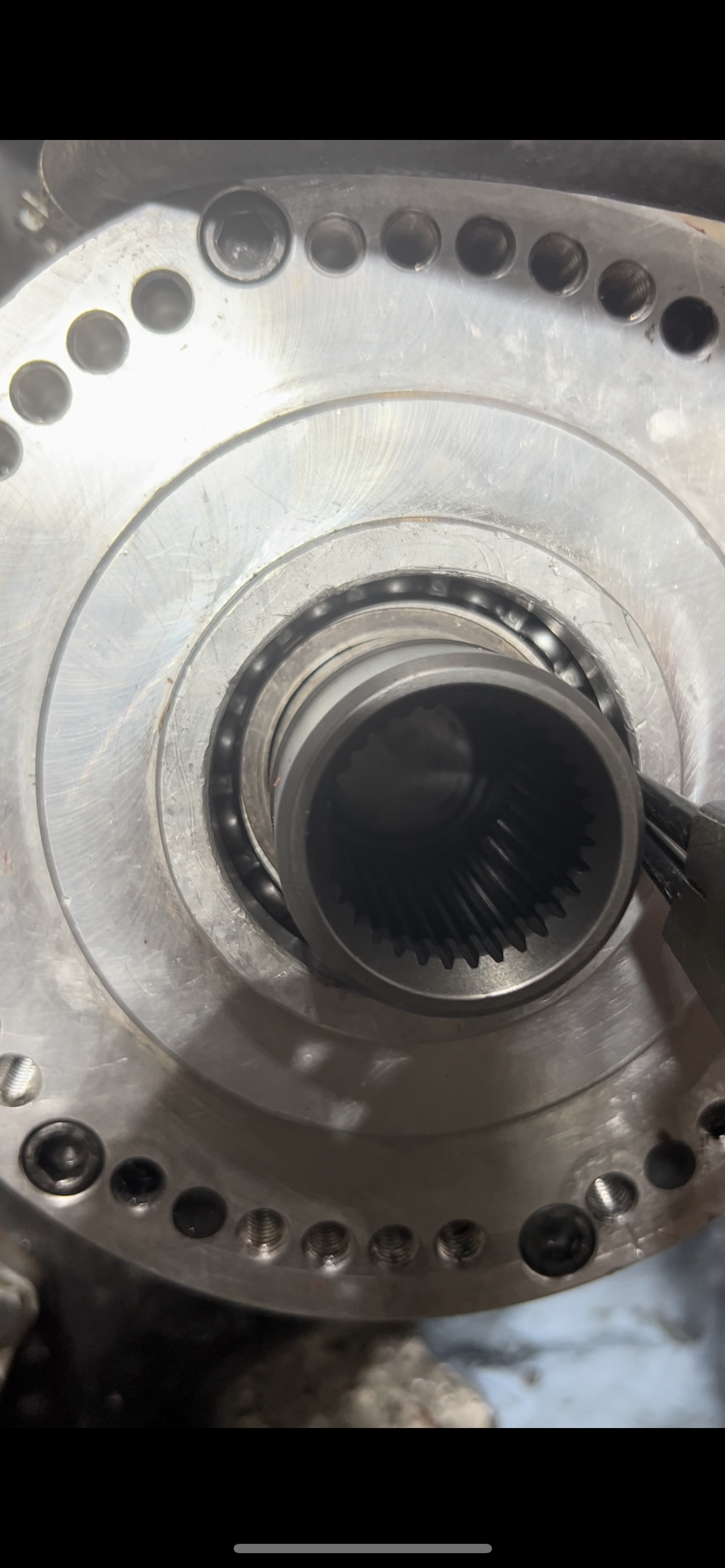

I got the right input with the correct bearing width so I put that back together. the input snap ring seems to have lost its spring pressure and is loose! :mad: I ordered a new one, I’d take my chances if it was something more accessible but given it would require pulling the driveshafts, t case, etc. it wasn’t worth it and I’m still waiting on parts.
You can see the small gap between the shaft and snap ring on the left.

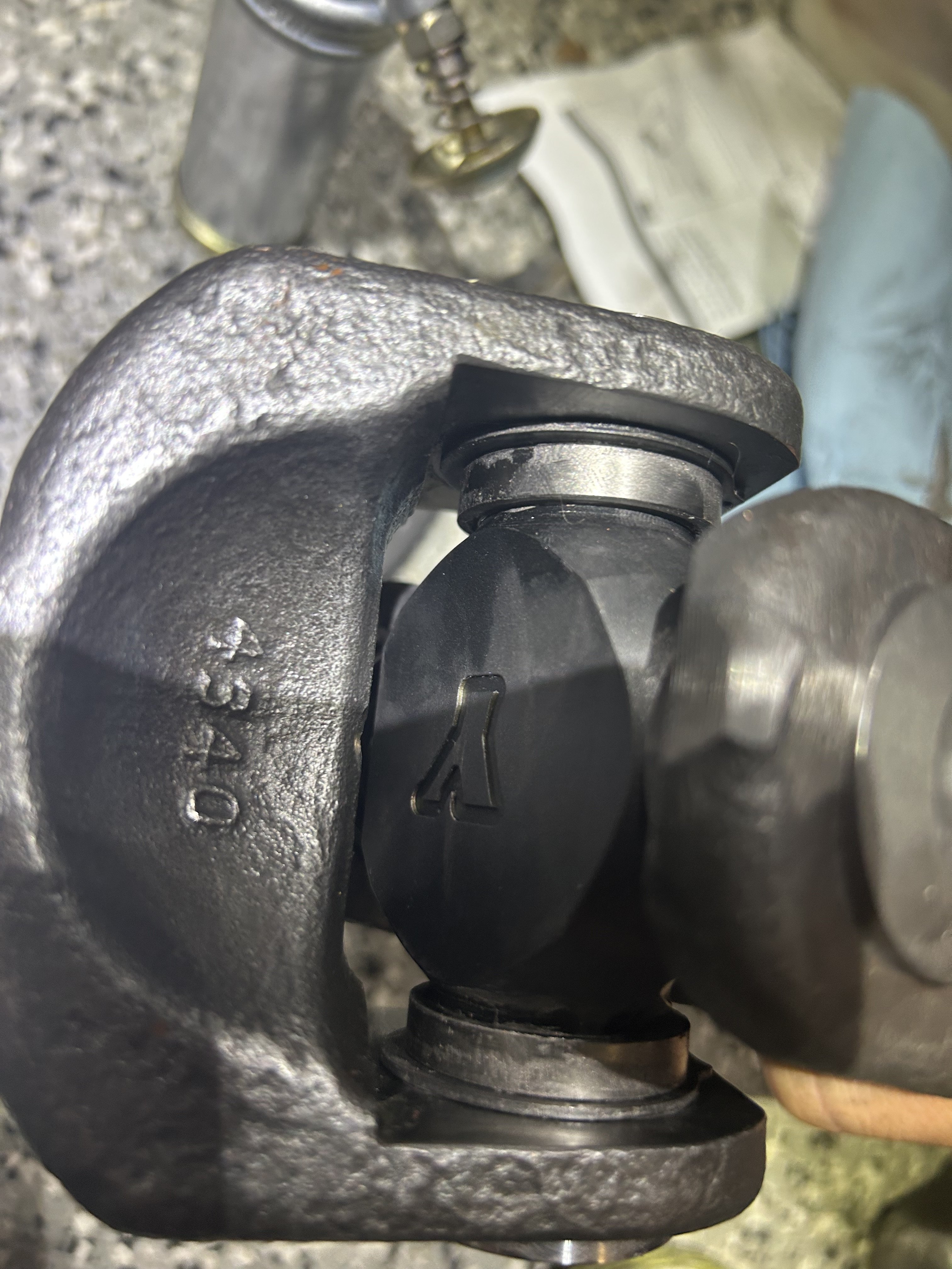

I assembled my Yukon super joints into the chromoly shafts.
I broke 1 u joint in 5 years which wiped out a factory 35 spline inner and 35 spline outer, I’m hoping this will hold up for much longer. The super joint deletes the needle bearings so the cross is larger and it’s made of a harder material. The shafts are chromoly. The one downside to super joints is that there are no needle bearings they are not maintenance free. They rely on grease as the “needle bearing” to resist wear on the cap. These are not full time 4wd friendly due to their maintenance interval. Luckily I have locking hubs and they even provided a little grease gun to grease them with ease.

I do a vin look up and sure enough the fucker I bought it from lied to me, not 90k on it, it’s got 160k on it. I bought it 2-3 years ago so there’s no tracking him down now. I also told him I need it to work with an 08. He said its 07 and 07-08 work together.
Well 07-08 was true, they do but in my case I got unlucky. it was an 07 but it was such an early 07 that it was built in 06 and for a short time they had tcms that were 06-07 specific, not 07-08. The tuner said he doesn’t like to do this but changed the vin in the tcm to a later model. He used an 09 vin. It accepted it and now my pcm and tcm are talking. His fear is that the 09 tcm controls may be different because there’s different hard parts or internal things that may not jive with an 06-07 trans and an 09 tcm.
I guess I can ask him to try an 08 vin but same potential problem. Maybe it won’t jive with an 06-07 trans. Does anyone have insight on year to year changes?

I finally got my new input snap ring and deal for the t case so the t case is 100% done!
