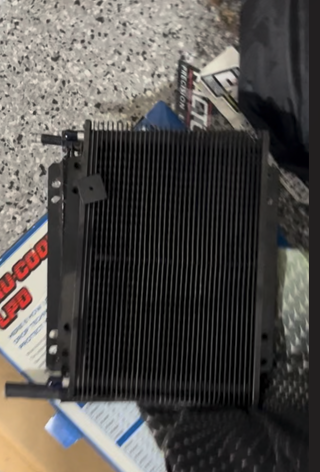

I forgot a couple pics. I used this cooler

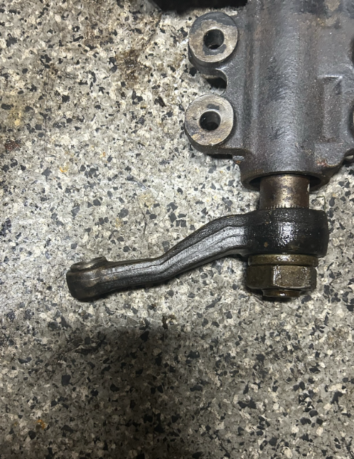

Also I forgot to post this pic and some of my other steering issues, with ram assist, the only time I had issues turning was in 2019 when my pump was basically dead. This was about 1.5 years after I probably torched my pump on UA2017 when it was 120* out.
Then 5 years later my pump was roached again. It wasn’t happy on the rubicon this past summer in 2023, it was making noises, I probably should have said, hmmm…let’s change it but I didn’t.
The only other change I can think of is throughout time I had swapped back and forth between steering arm holes. One closer, one farther from the kingpin centerline. Last year I went back to the closer hole which puts more stress on the box and ram but reacts quicker. I can’t imagine that being too drastic.
On my last trip I also had my ram leaking so I’m sure I lost power there, put more pressure on the box, with an already weak pump and did this to the factory Xterra pitman arm.
I also went back and studied they video where I lost steering, it appeared I would back up passenger then go forward driver, but it wouldn’t actually go driver, so I’d back up passenger again (more passenger since it didn’t go driver at all forward) then try forward driver and nothing and did it again
If I had just stopped I probably could have winched forward at an angle to help my steering and moved on. Instead I put myself in a spot where I was literally going to rip my knuckle off so hi lifting and winching simultaneously had to happen
Anyways, I have a fresh pump, fresh ram, fresh pitman arm and now a cooler to keep the pump happy. Hopefully I have many more happy years to come. I just need to maintain the system, once one component goes, it snow balls.

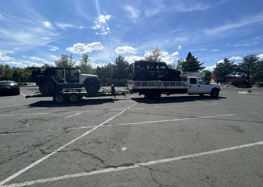

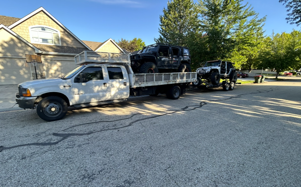

The heavy Hauler hauling out both rigs, no the axles weren't overloaded. The rear Dana S130 is rated for 14,706 lbs and I was around 14,500 lbs.

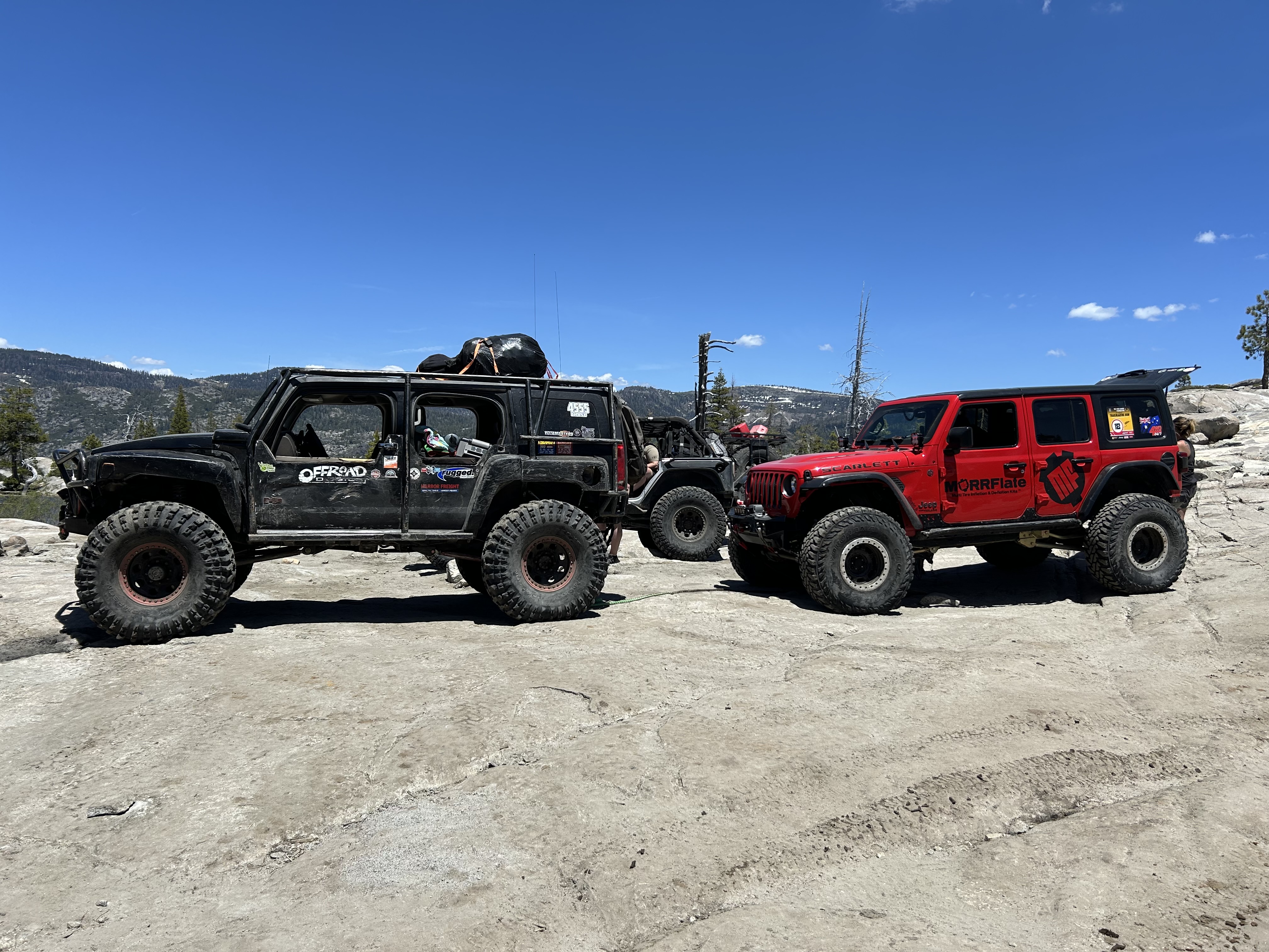

We had myself, my wife and my sister in the H3 and then my brother, his fiancé, my other sister and her boyfriend in his 1 ton JK on 40s.
We had tools, spare parts, fluids, one giant drink cooler, a tiny soft cooler, grill, a fridge freeze, all camp cooking supplies, clothes for us 3 and tents/sleeping pads in/on the H3.
JK had its spare parts, 2 small coolers, dry food, sleeping bags, camp chairs and clothes for their 4 people.
My brothers JK

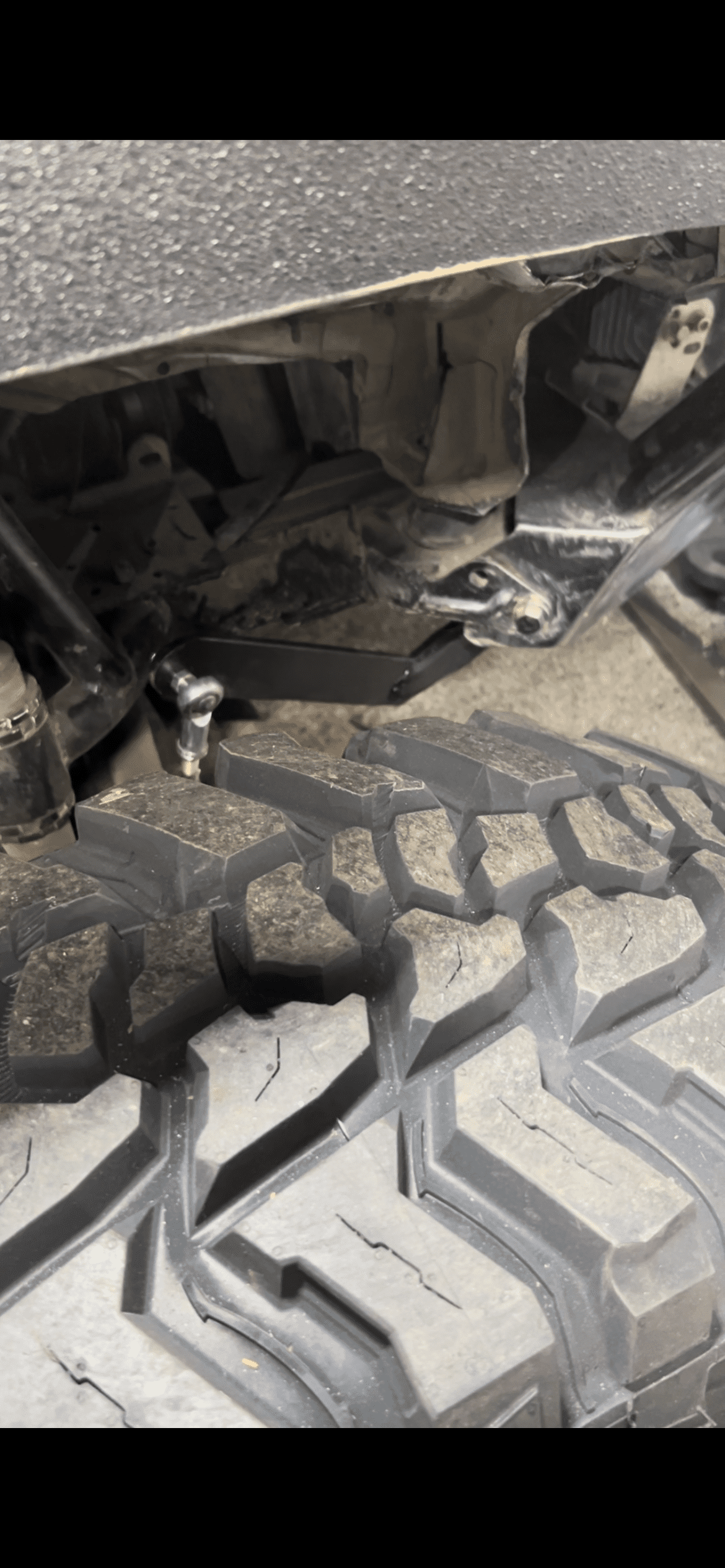

The hummer worked well but once again I feel the link mounts hit shit too much. I’ll figure out a solution. I was just so used to leafs being tucked up so high.

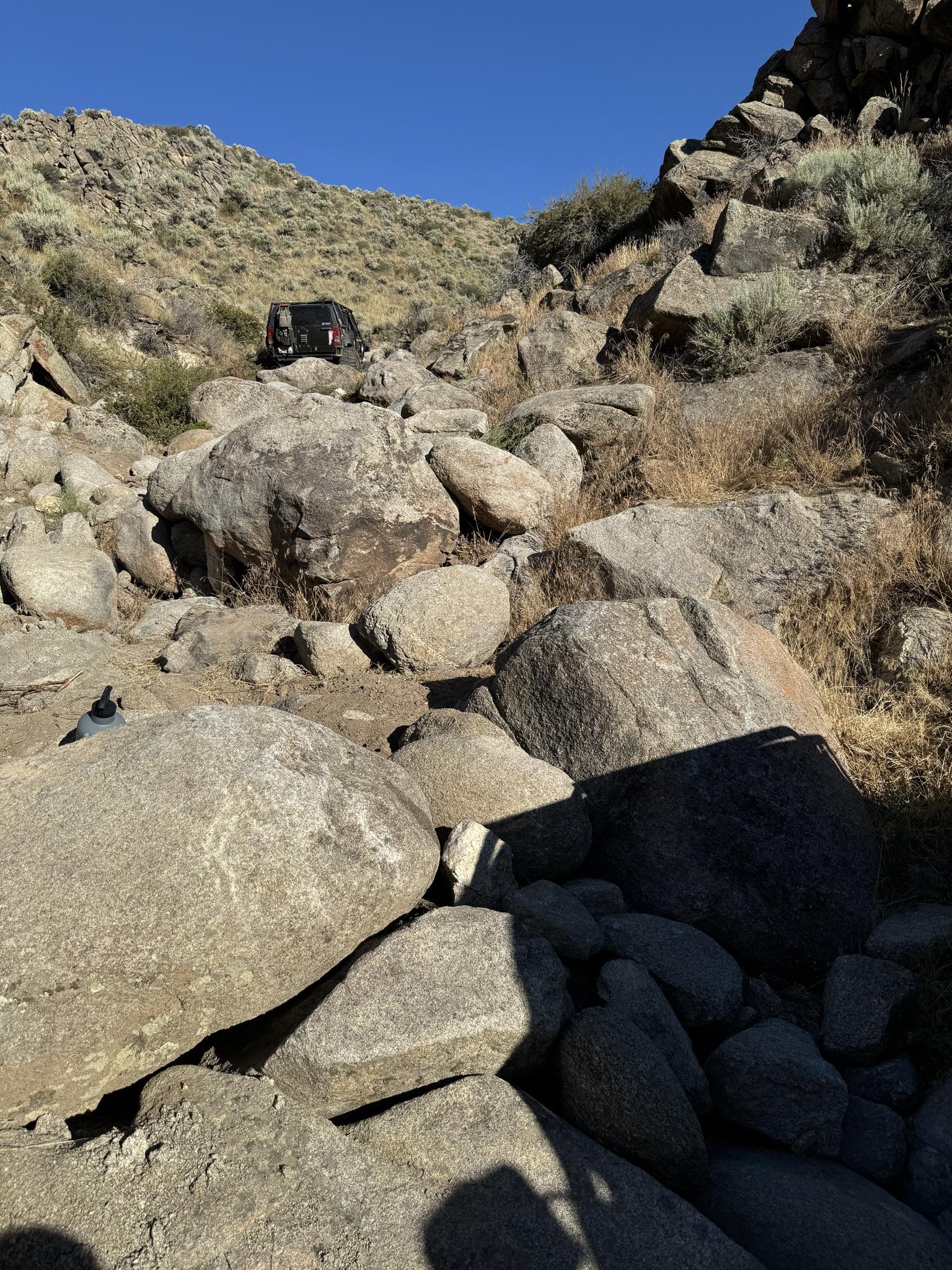

The only thing that got spooky was going up the slabs. The hummer felt stable going down the slabs and everywhere else on day 1 and 2. I had tents and crap on the roof but it felt fine. Once I put a heavy extremely full garbage bag on top things felt tippy going up the slabs and that spot right before Ellis creek heading out. I probably should have moved the sway bar in 1 hole for more rate.

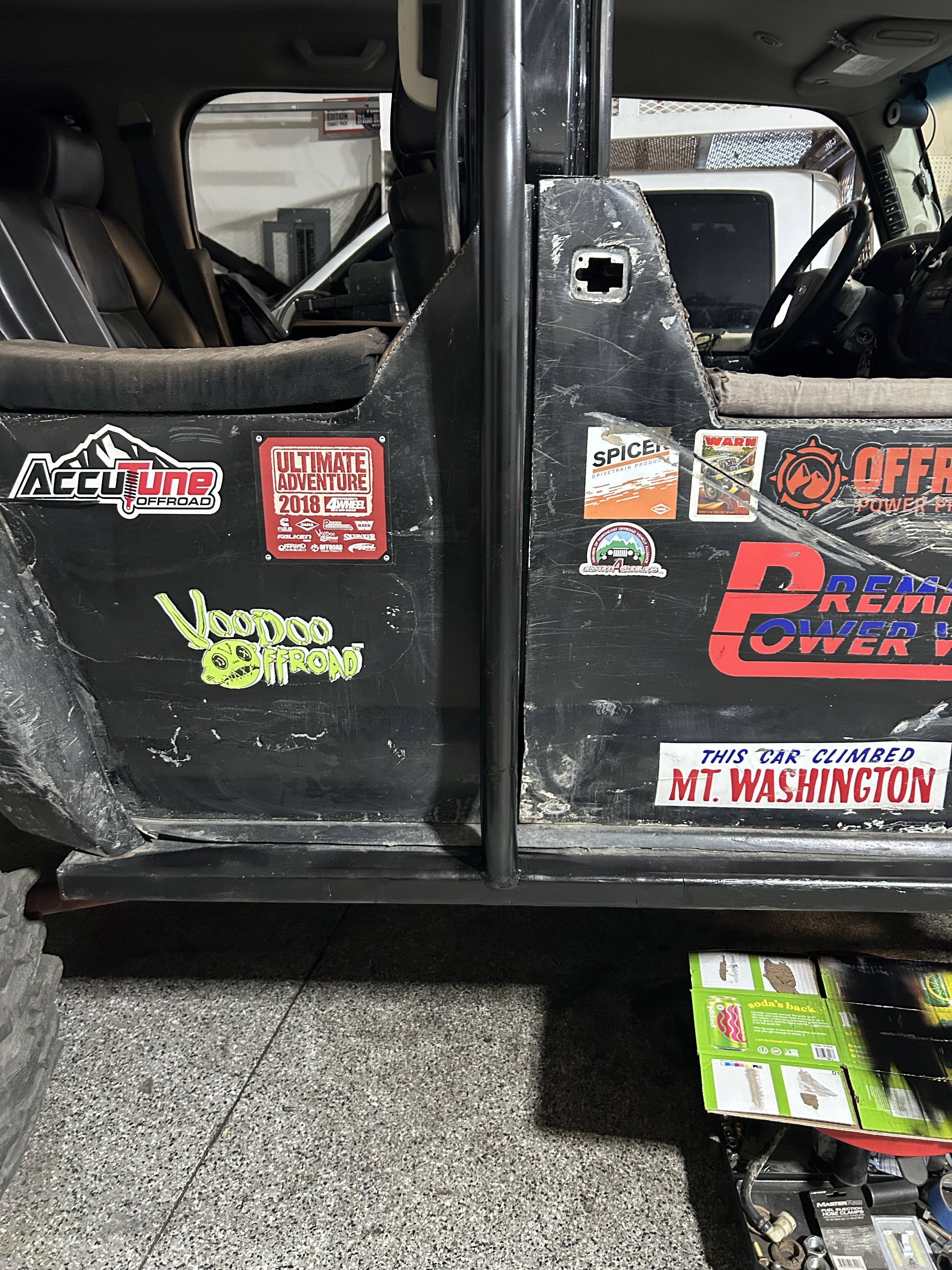

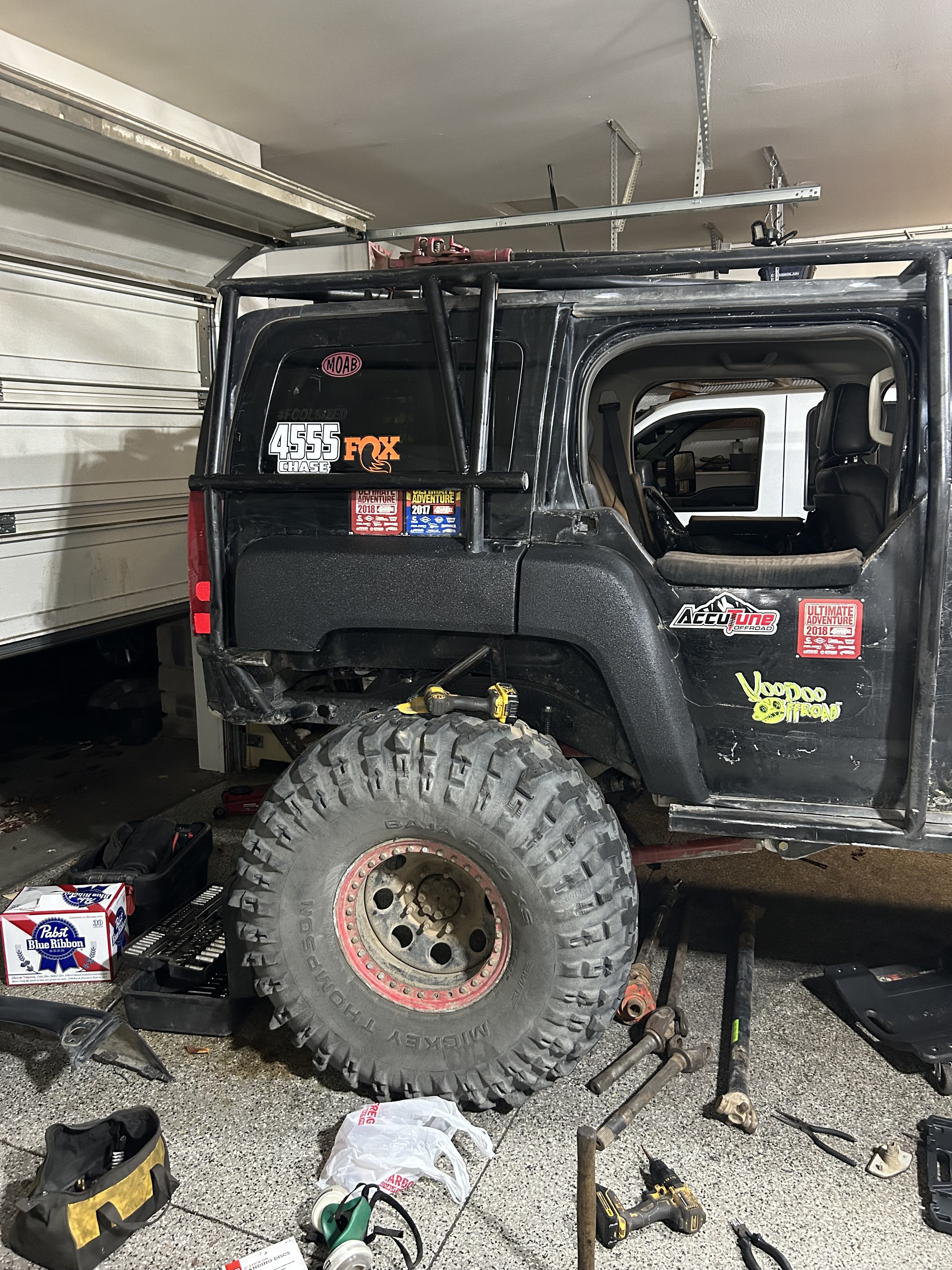

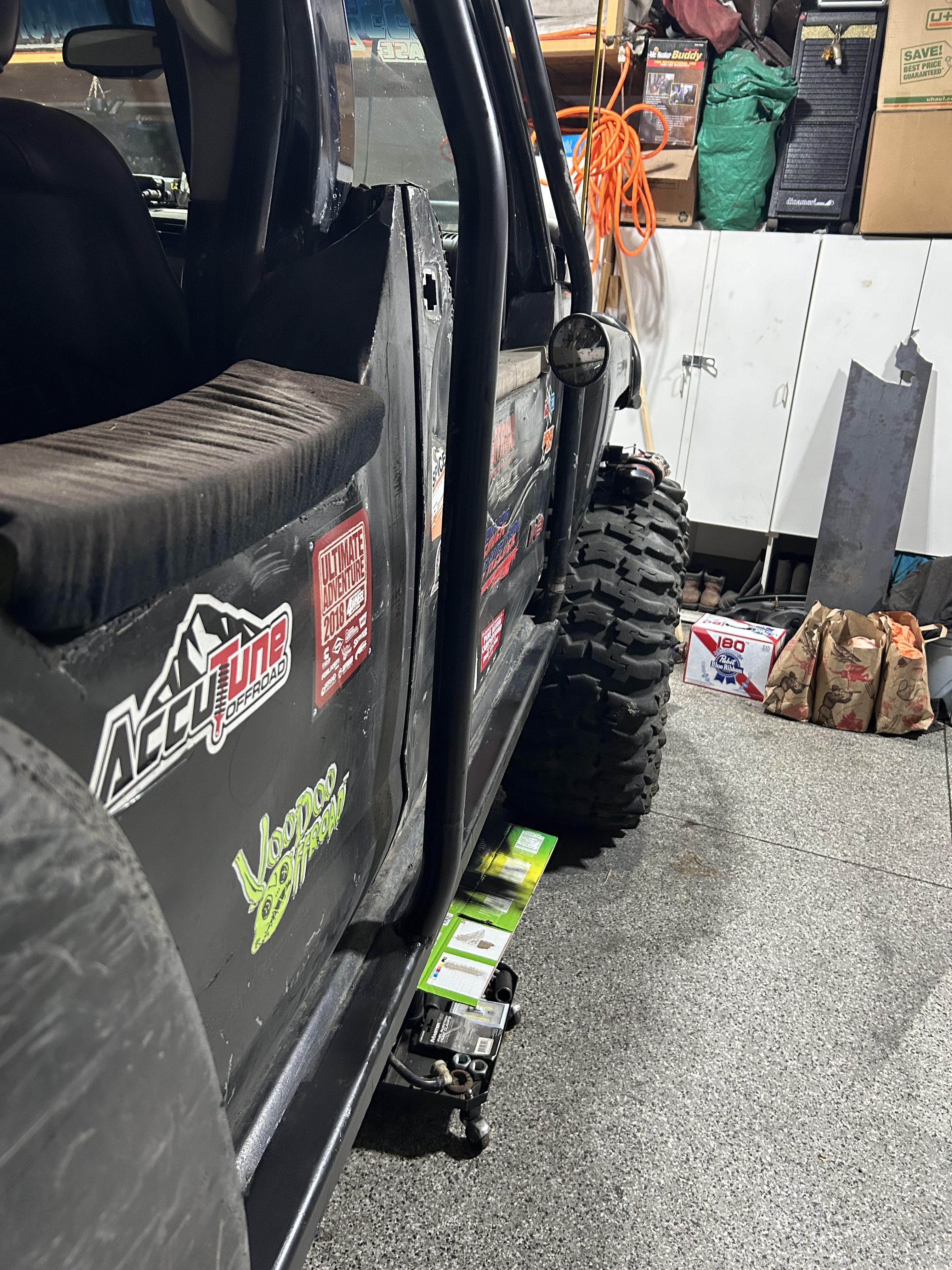

Since then, I cut off the B pillar mount and made a new one. I got hung up on it at the soup bowl and have been for years. Nothing a little skinny pedal can't fix but I got tired of it.
I cut out the stick out, then did a 21* bend to sweep it in on the slider.

Anyways, squeaky is looking a little rough these days. There is no doubt about it. It has been put in places no H3 belongs and I have the scars because of that. So I think it is time for a little refresh. I have spare fenders I got from a junkyard a year ago. While I decide on if I should get them professionally painted, or paint them myself, or do something else with them I decided to work on my old fenders to see what I should do.
My current fenders are cracked, scraped, and basically hammered. The only way I could see them coming back to life is something that can cover imperfections. Even with sanding, I have scrapes that are so deep to get a flat surface I’d probably sand through half the damn plastic.
I bought a plastic welder on Amazon, then I bought a kit of raptorliner. I am thoroughly impressed with raptorliner. I’ve used the spray can ones and haven’t been impressed. This kit comes with a “Shultz” gun that you hook up to air and spray. I am not sure if I can use thinner through the Shultz gun or if I need an HVLP gun to add thinner so I didn’t add any but I did bump the pressure up to about 80 psi to get less of a rough texture.

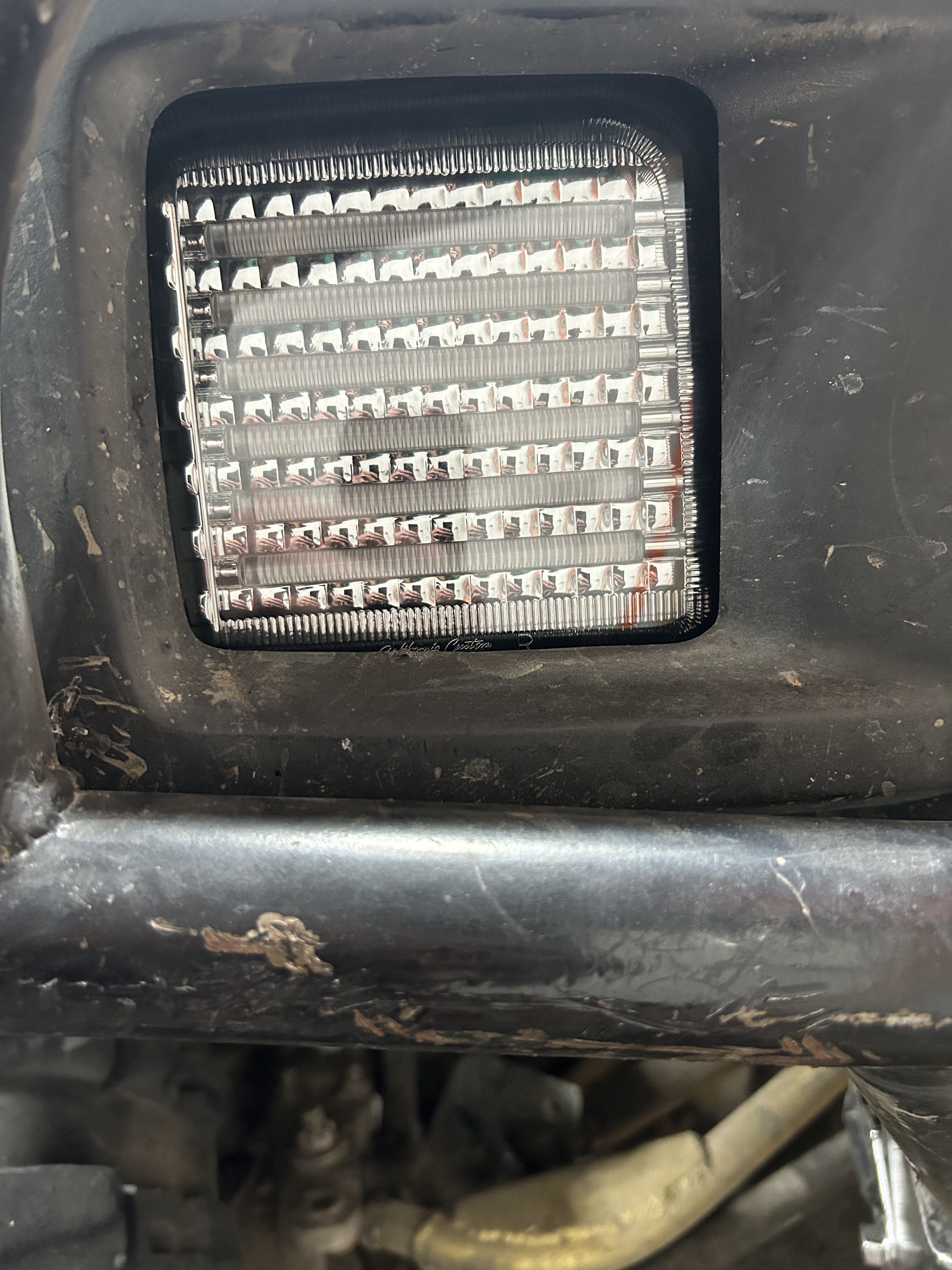

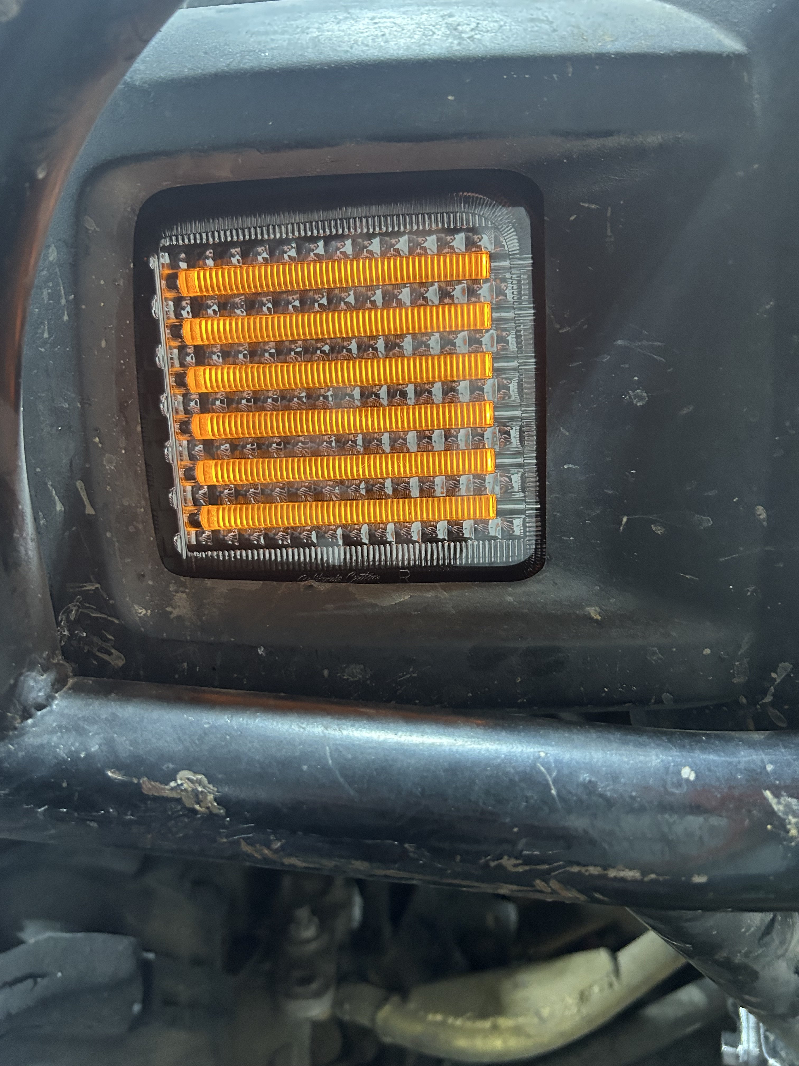

Another project was getting rid of the ugly mess of turn signal holes. I needed a very specific turn signal that I didn’t think existed but I found them on a Japan website of all places. I think I will VHT night shade them to get rid of the bling factor. I have one mounted, still need to do the other side. The YouTube video tells the story.

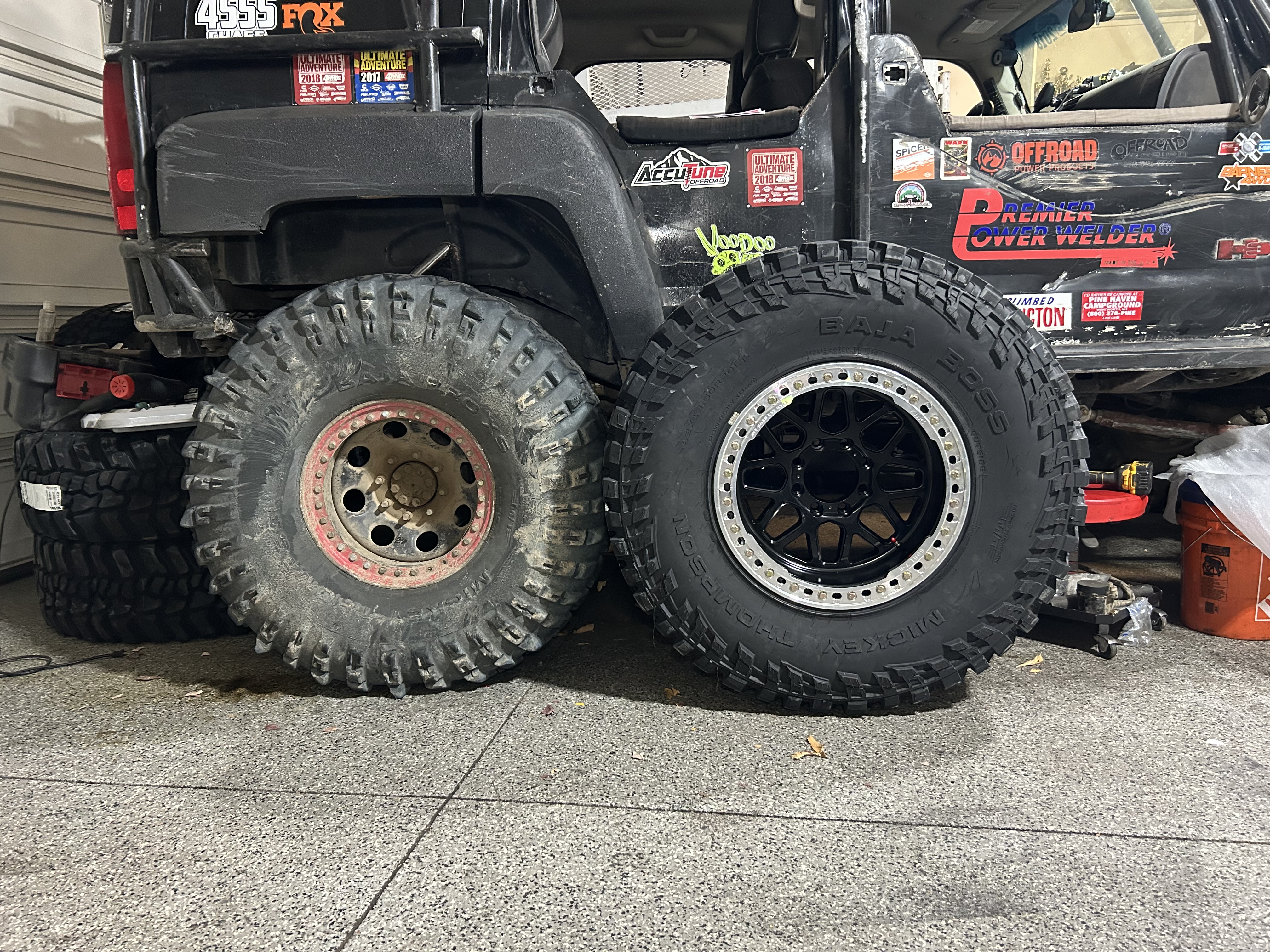

Lastly, I finally got my 42s! I will be keeping my 43in Mickey Baja Pro XS but I will have a “streetable” 42 and then my giant wide AG tires.
Please do not think the 42s are THAT much bigger. I think they will be but this is 18 psi on a heavy rig vs 20 psi with no weight on it and the 42 is closer in the picture which also throws things off but they are 42x13.5R20

You can see in the tire picture I already scraped the fenders. :mad: I just fixed them tonight, put on the full doors for winter and then raptor line'd the door part of the rear fenders (since I have a set for the half doors and the full doors) I also adjusted all the mounts so the fenders actually fit the properly again so they arent hanging off and all jacked up.

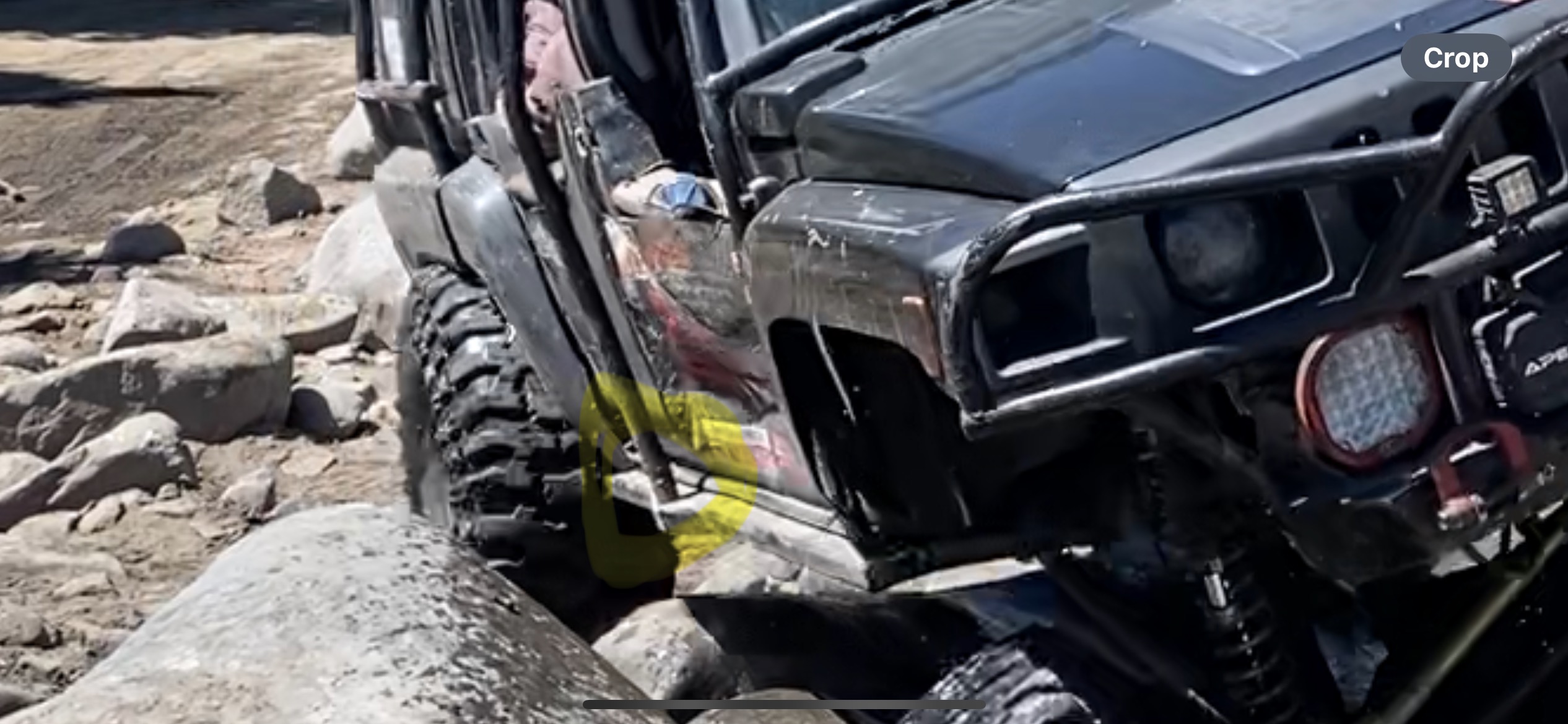

Here is a cool pic where it shows my old link mount would have been a huge hang up but instead the higher and tucked up links now slide (and sometimes miss) with ease.

We both had to winch at the top, it was so loose and soft up near the top that traction was tough to come by. After a full throttle assault and hitting a rock my front end was airborne it was truly time to say pull out the winch, it isn't worth dying. lol
When we got to the top we turned left towards an exit down near the blueberry area it wasnt blueberry but in that area) the side hill out was so sketchy, I tapped my brakes and the ass end would slide out and put me more off camber. In the end we had to winch myself down. We creatively ran my winch rope through my a pillar, b pillar bars to the D pillar where we then ran an extension to keep my ass end from sliding over. I am very unsatisfied with the performance of the hummer in this moment but I will get to that later.
We were able to get me down safely and it was because of great team work and creative thinking, I truly do value the group I wheel with because we stick together even when shit hits the fan.

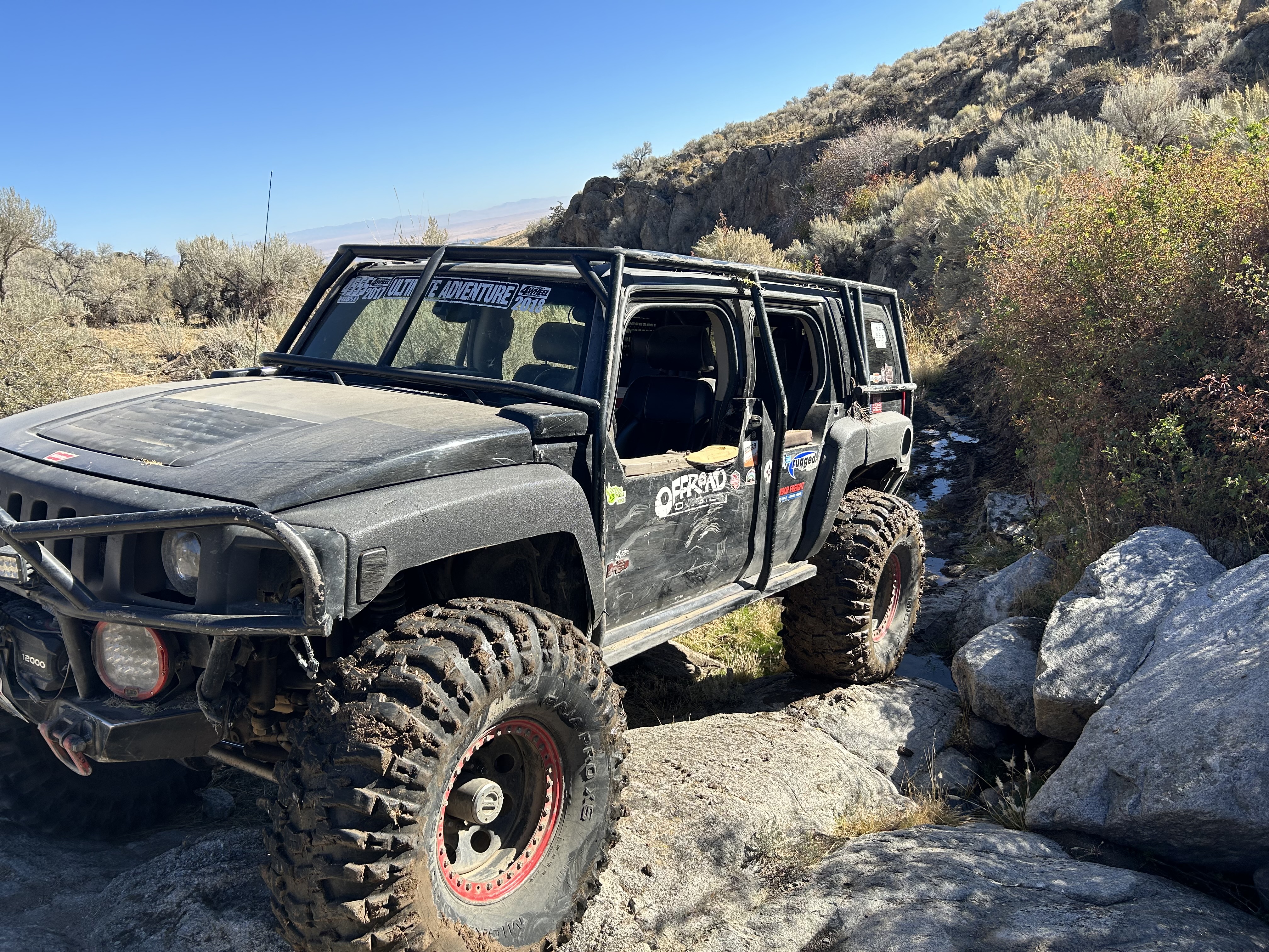

On the first obstacle I broke my front CV driveshaft, I have a toyota CV front driveshaft and I probably was crazy for thinking it would live as long as it did and it truly is what came first the chicken or the egg? I was so bound up and at one point fully drooped out I ripped my limit strap tab off the axle. It was welded to the cast pumpkin but it lasted 6 years. I didnt expect it to let go but it did. I knew my CV didnt bind even without a limit strap but did it over extend a tad? I mean the whole thing exploded into multiple pieces.
Here you can see I can't turn the wheel, I had to hi lift my wheel up to turn. I think I have out grown my single ended 1.5in ram. This is the 2nd time I couldn't turn no matter what I tried.
9,493
So we get myself back out and my friend runs back to camp while we start fixing. I changed my driveshaft to my well worn, out of balance 1410 single joint on both ends driveshaft and hit the obstacle again.
This time, with a new line I make it up the obstacle I broke on! What a great feeling. If I didn't have a poor line choice I probably wouldn't have broke but such is life. Could of, would of, should of, or whatever the saying is....

Well, steering has gotta get redone....the lack of steering put me in a bad spot. Assuming a 1600 psi pump, a 2.5in ram that the full hydro guys use puts out over 5k lbs of force. a 1.5in ram puts out 2800 one way and 2300 the other way. I wont go full hydro but I need to get the steering force up. One guy on irate has regular hydro assist with a 2.5 double ended ram and said its got power but is slow, I can do that or I can depower a box and do the setup that the 4500 guys use. I gotta figure that out.

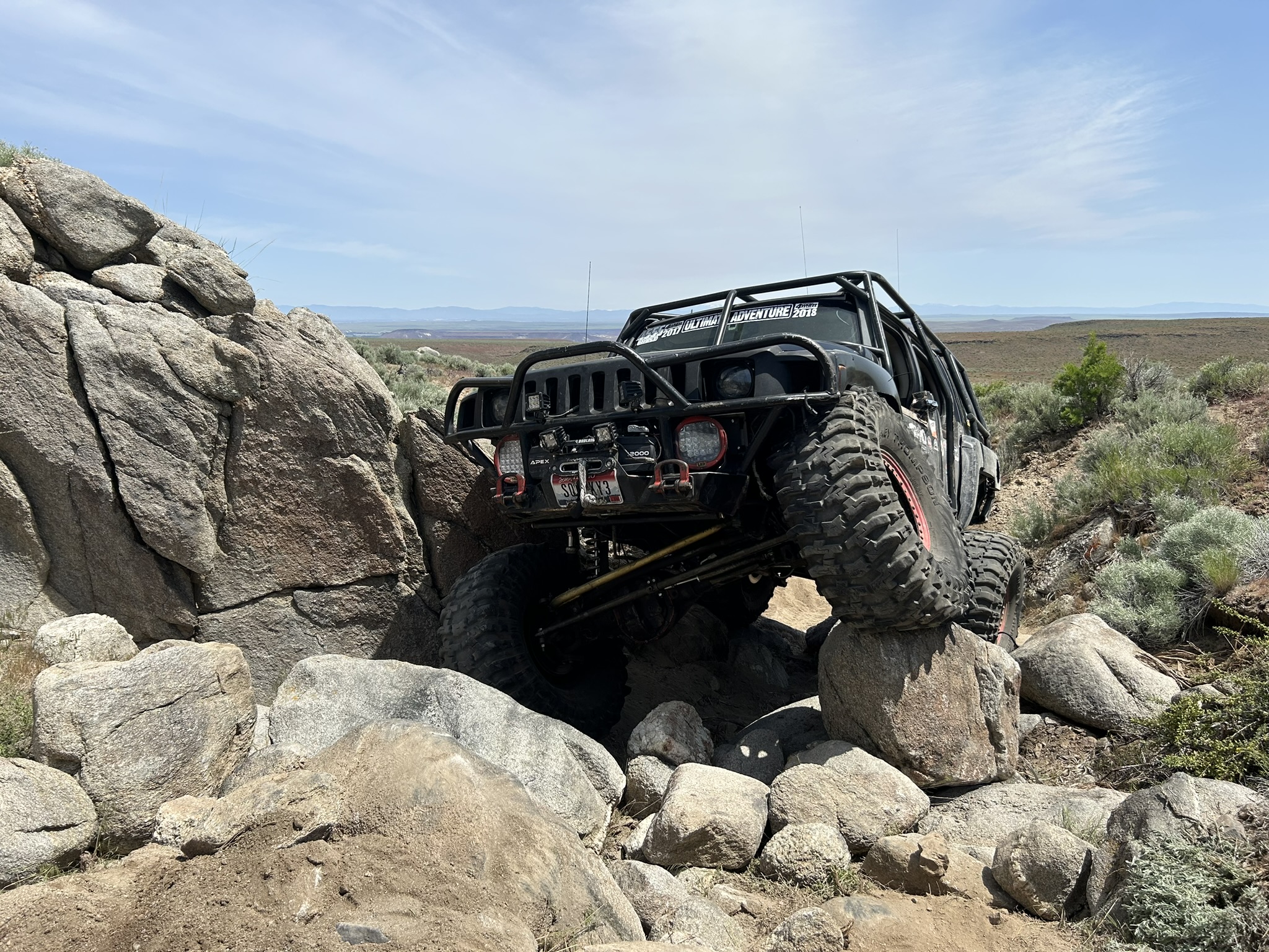

2nd thing I need to figure out/redo is my rear suspension. At off camber angles it is sketchy ONLY when the driver side is the high side. I am not sure why, I had this same feeling on the rubicon. When at the bottom of the slabs near the off camber straight section on the rubicon it is stable coming from the loon side. (pass side is the high side) but when coming back (the driver side on the high side) it is substantially more sketchy. It was never that way with leaf springs.
Is it preload? I assume I have 400 lbs more on the driver side (never corner scaled it but I know it is heavier on that side) so I have about 3/4-1in more preload on that side. Is that causing it? Is it the rear track bar angle? I am not sure but I need to figure it out because the shit on the SOS downhill cant happen again. It is irritating.
