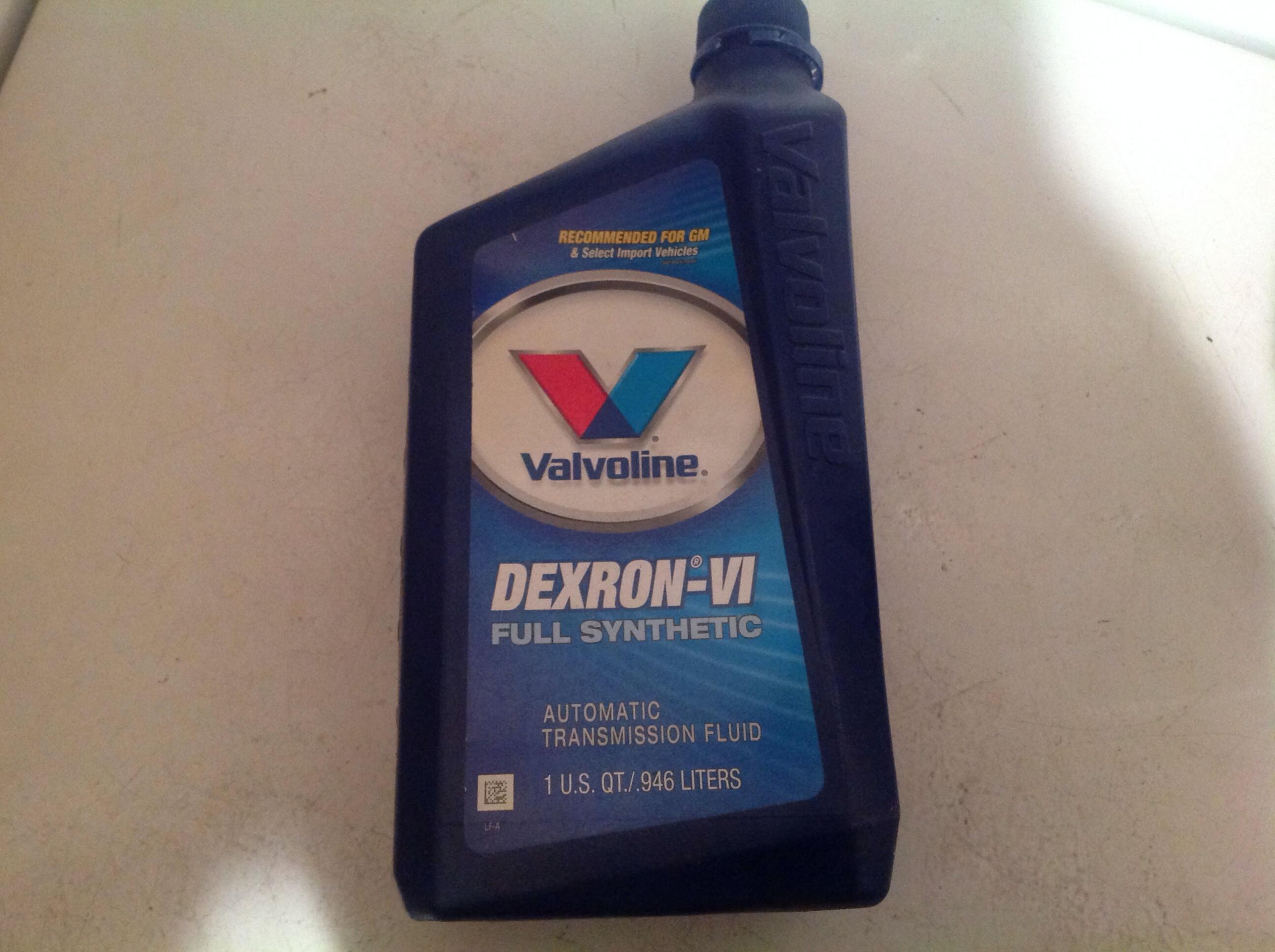

Panzer07
2,548
Ontario, CA
I agree with Dennis.
I been running this in my transfer case for about 8,000 miles and have got no problems yet...I was Wanting To Run Royal Purple Since I Know It Is A Good Brand And I Run It For My Motor Oil And Axels. But I Don't Think They Make one for vehicles requiring dexron Vl.
