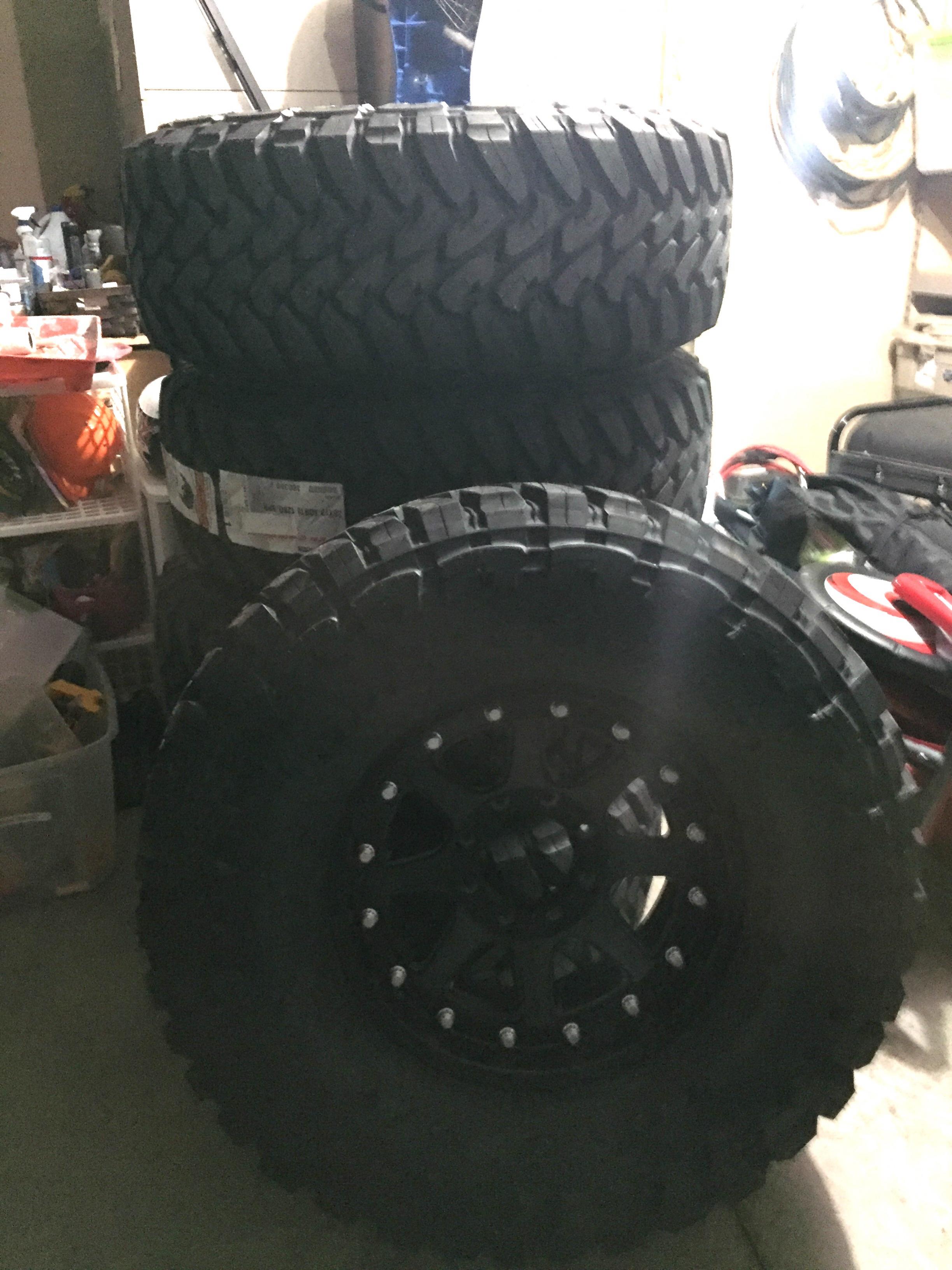

Just got a late shipment today! 38" Toyo Mts on 18x9 KMC XD Addict wheels. Crappy late night garage teaser pic until I can get them mounted this weekend.

Awesome, you'll love the extra height of the 38's. What's the backspacing and offset of the wheels?

I decided that 38s was about a far as I wanted to take the factory drive train, the backspace is 4.53" and the offset is -12mm. Decided to go with 4.53" backspace since the factory wheels were roughly about 5.56" and these toyos are 13.5" wide compared to the 12.5" wide MT/Rs I have now. That should set the wheels out just enough. I put the spare on late last night and I can tell the backspacing will be just right.

No rubbing unless at full lock and I mean just barely, way less than my 37s on oem wheels. I'm sure they'll rub when I stuffed them good in the fender off road, so that test is coming soon. I'll grab you a pic from front and back, but I think the offset is just right, sticks past the fender by maybe an inch or inch and a half. I might have even gotten away with more backspace instead of 4.5", but I really liked these wheels.
