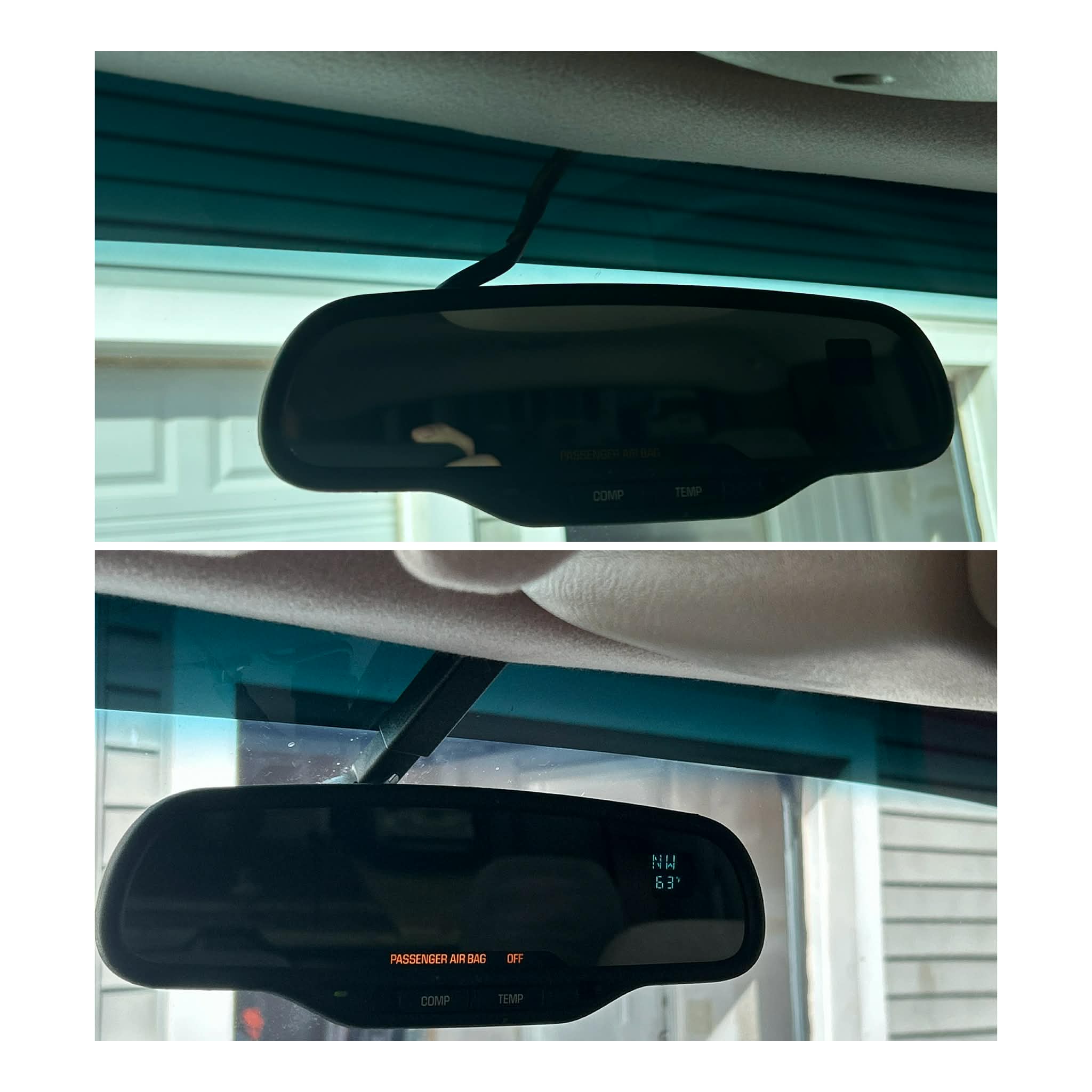

Repaired rear view mirror (GM#15176974) circuit board. A voltage regulator and 4R3 component had bad solder joints, failing to provide power to the compass and temp display. Re-soldered the joints. Display now works. Items circled in red are the voltage regulator and 4R3 component.

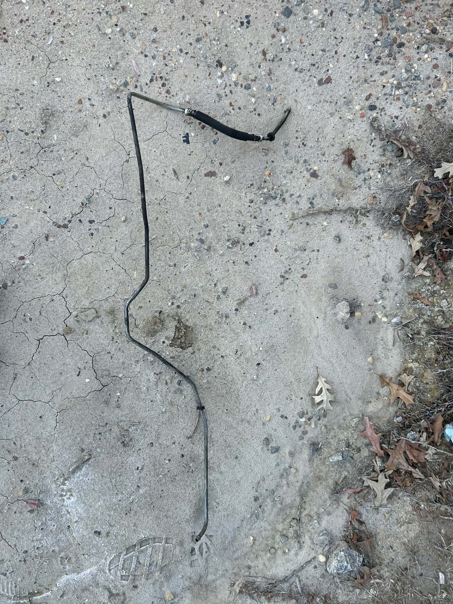

I forgot one.......the lower transmission oil cooler line likes to seep ATF at the flex hose crimp connection in cold weather....and well, it is almost Christmas. The line began to leak again, and in turn gave me another side mission. Replaced all 3 transmission oil cooler lines. Now this Tahoe is leak-free. :rolleyes: 🤞 I probably could have left it alone for a while, but I didn't want to give the truck an excuse to blow the line out...especially when I am going to put 3,000 miles on it in the next two weeks driving across the country to see family and friends.
-Replaced lower radiator to trans line (GM#15773661)
-Replaced upper radiator to aux cooler line (GM#15809058)
-Replaced aux cooler to trans line (GM#15809053)

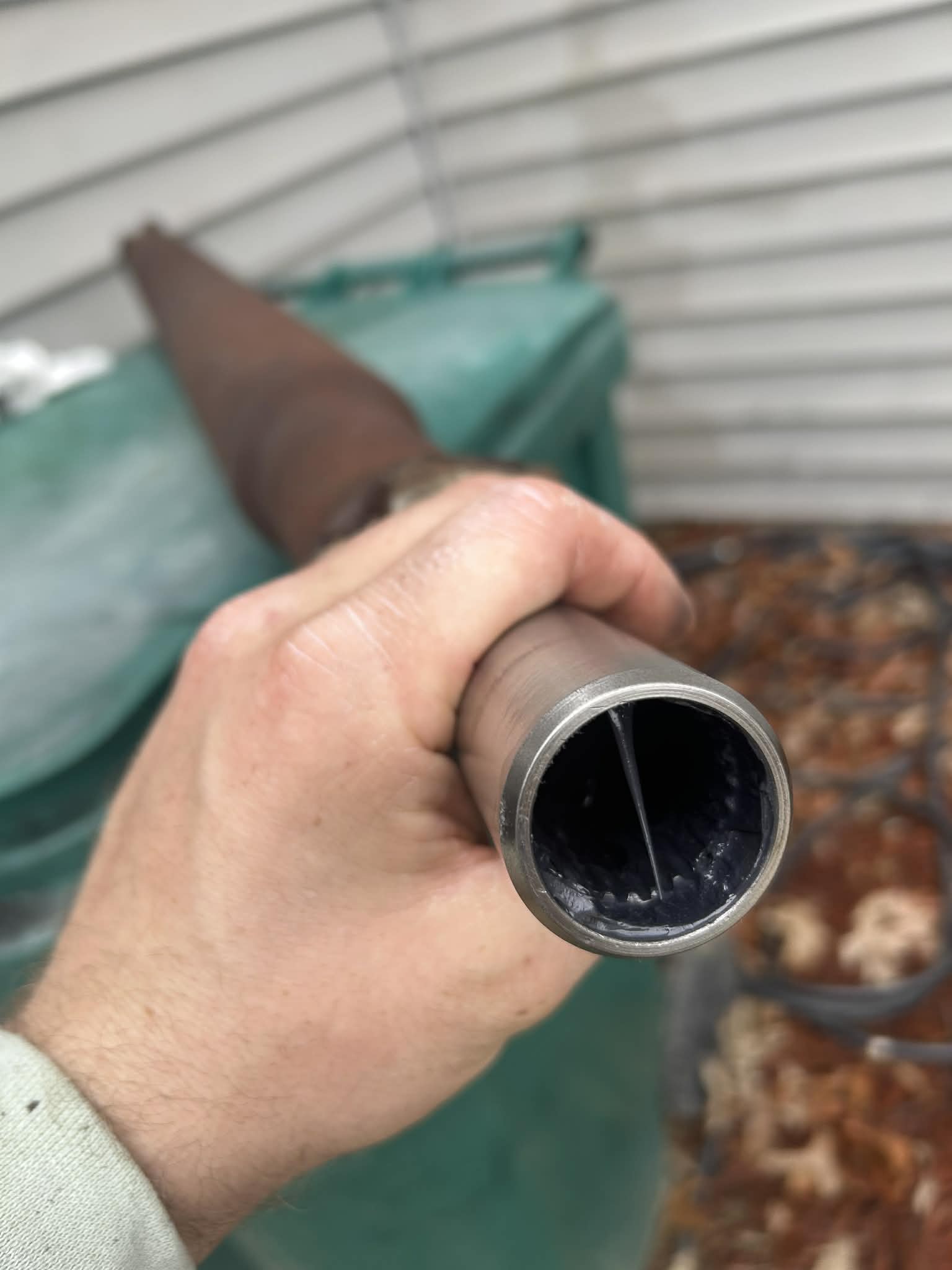

-For the last year or so I've been chasing an intermittent "rubbing/popping" sound under hard braking/accelerating from a stop and/or driving over speed bumps. Turns out the slip yolk on the driveshaft was running low on grease, so I repacked it with long life moly-fortified grease and the sound has disappeared!

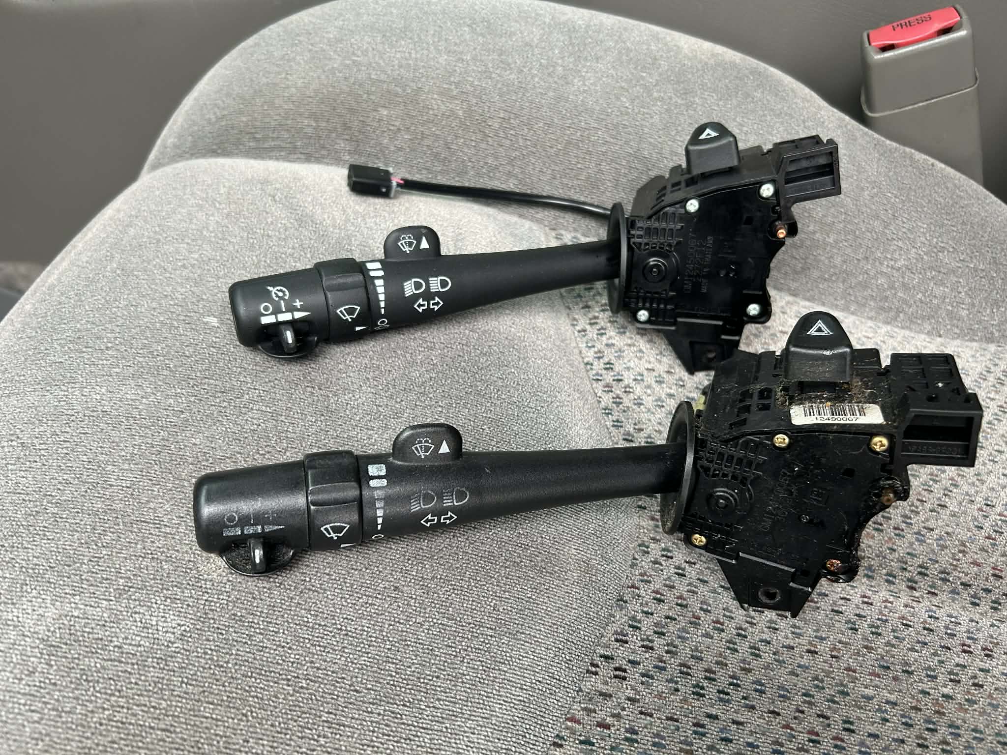

-Replaced gear selector (GM#26075107)-graphics worn-.
-Replaced multi function switch (GM#12450067)-graphics worn-.

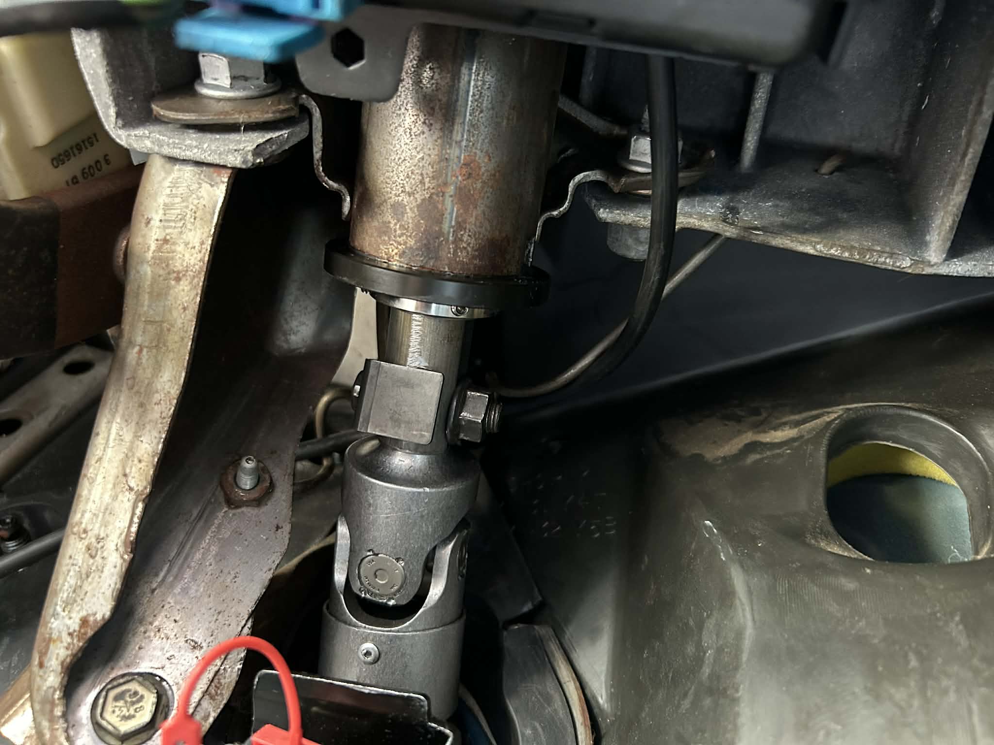

-Replaced lower steering column (GM#85104193)-U Joint was worn-
-Upgraded upper steering column to HD Borgeson unit (B#000937). The Borgeson unit is solid steel and weighs 2x as much as stock. Has a vibration dampener built in. Nice upgrade.

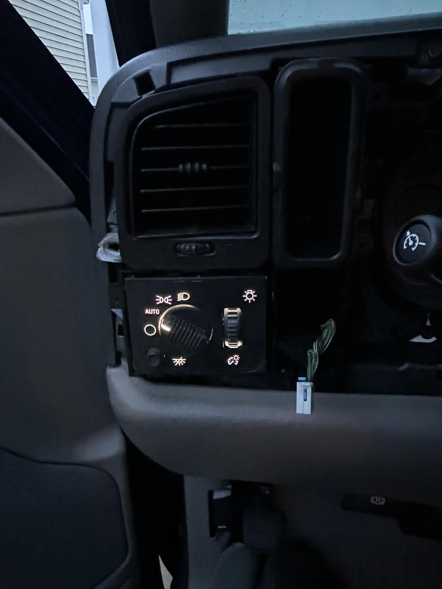

-Dimmer switch mounting bracket (GM#15034164) -broken-.

-Dimmer switch (GM#19381535-Fitts Cluster Repair) -burned out bulbs, upgraded to LED and added two extra bulbs for additional lighting-.

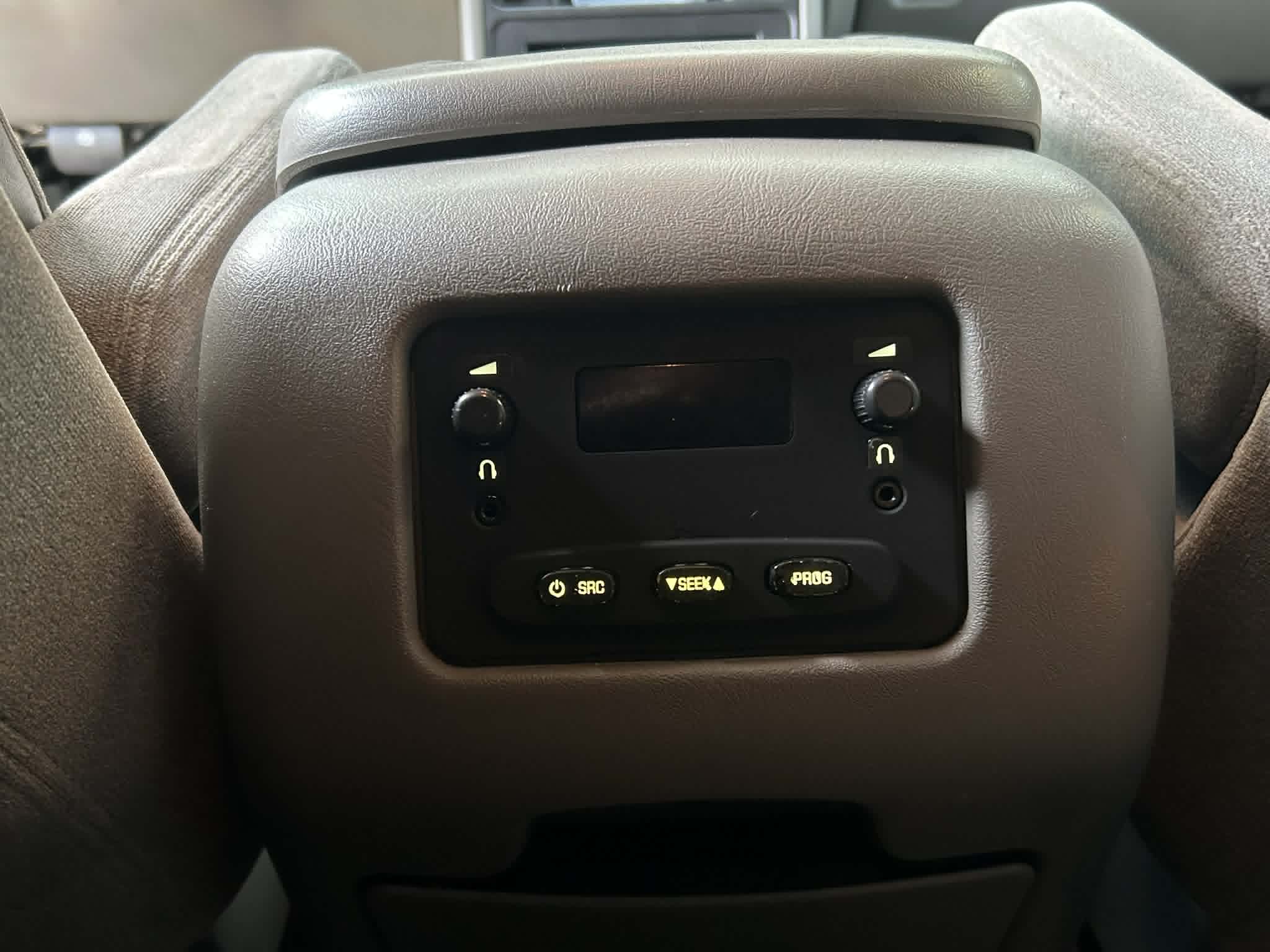

-Rear radio control module (GM#10358082-Fitts Cluster Repair)-burned out bulbs-.

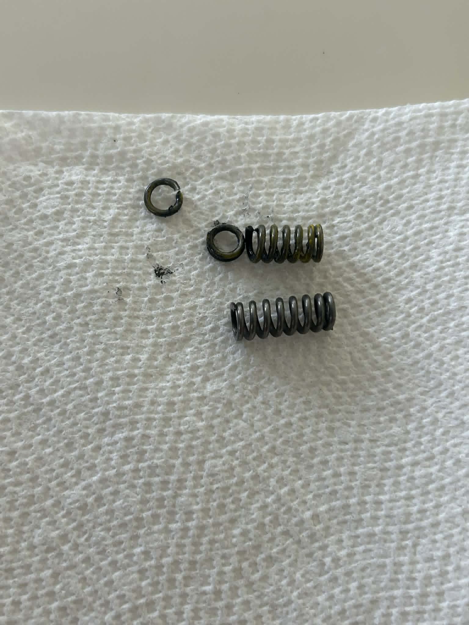

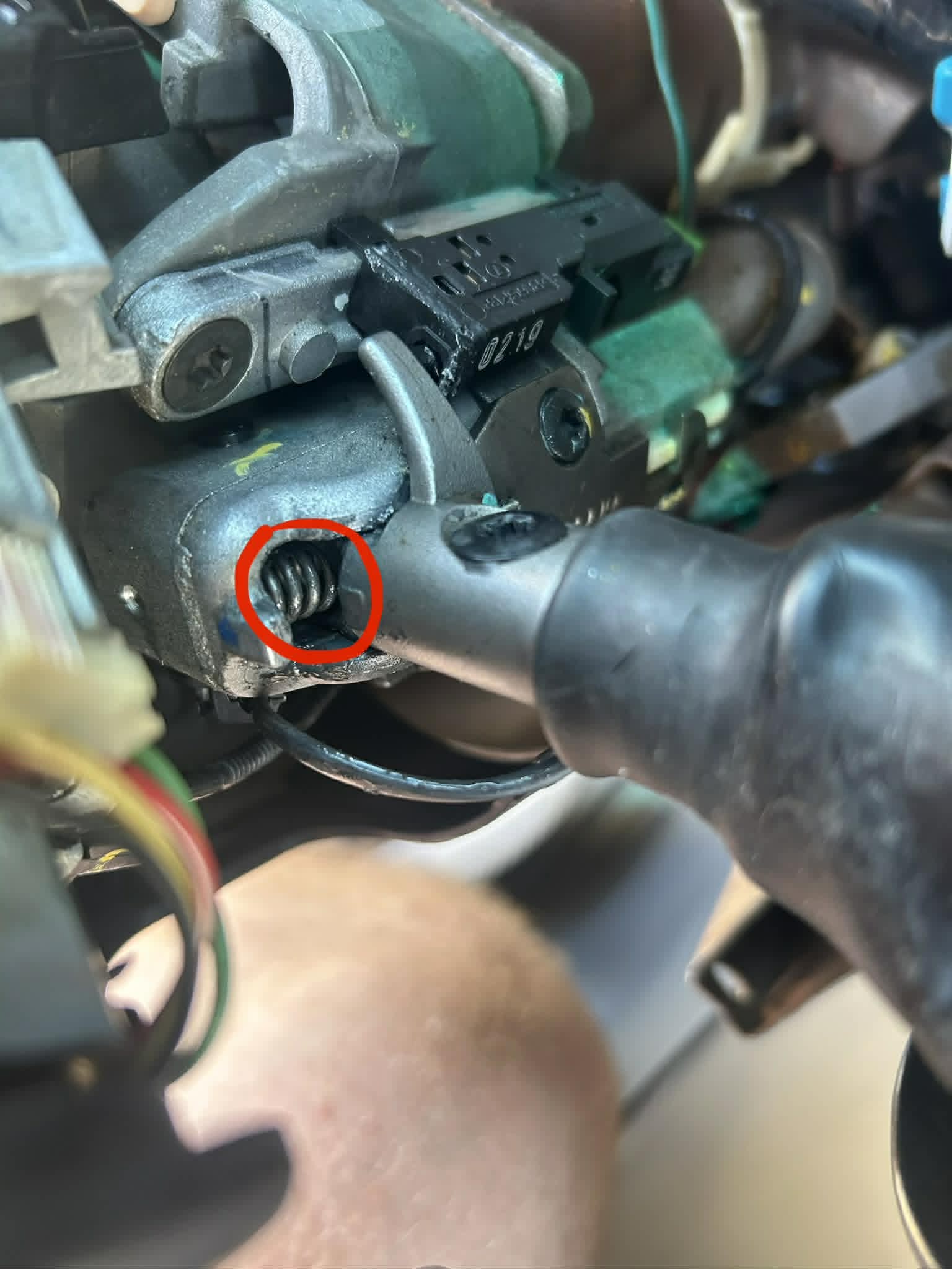

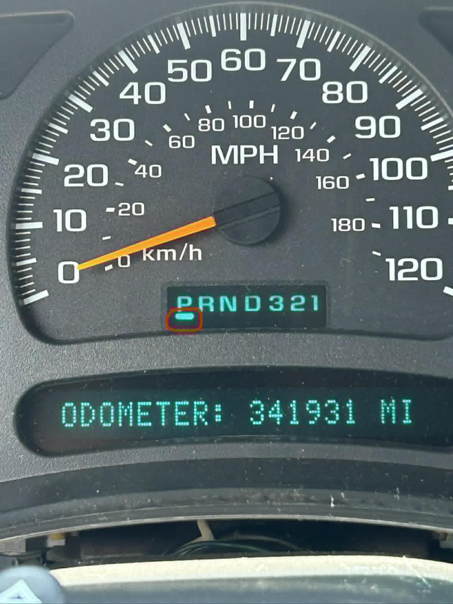

-Replaced gear selector return spring (GM#22833055). Vehicle was not displaying gear in DIC. As a result, an intermittent no-crank, no-start and unresponsive lock fault would occur.

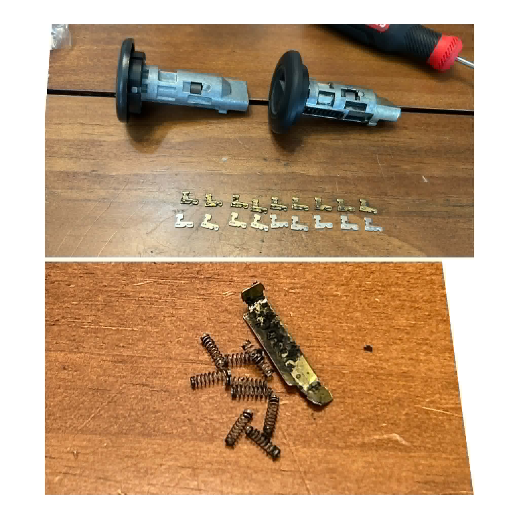

-Ignition lock cylinder (GM#19208680). The keys and springs became so caked with carbon that the ignition lock cylinder was failing to unlock consistently.

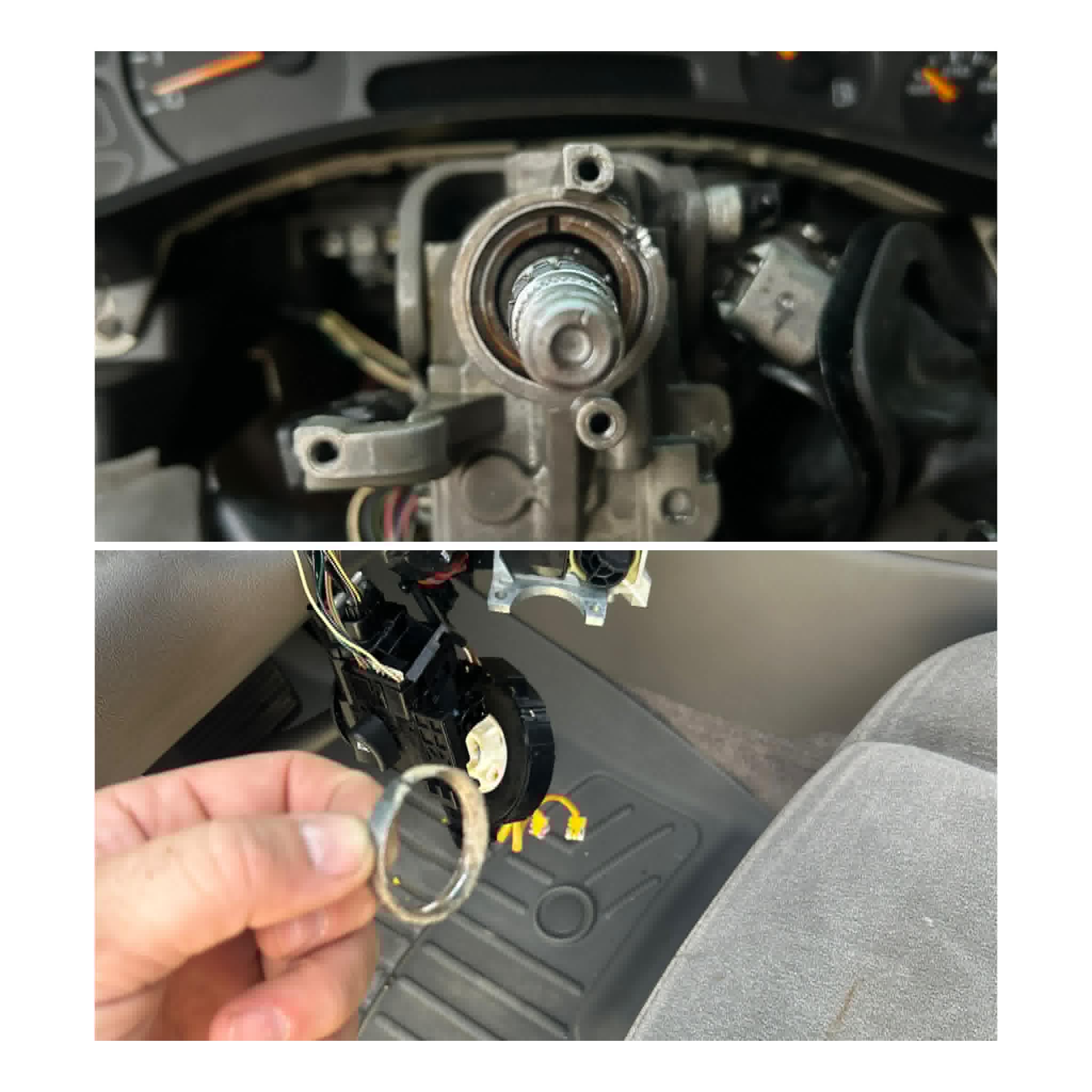

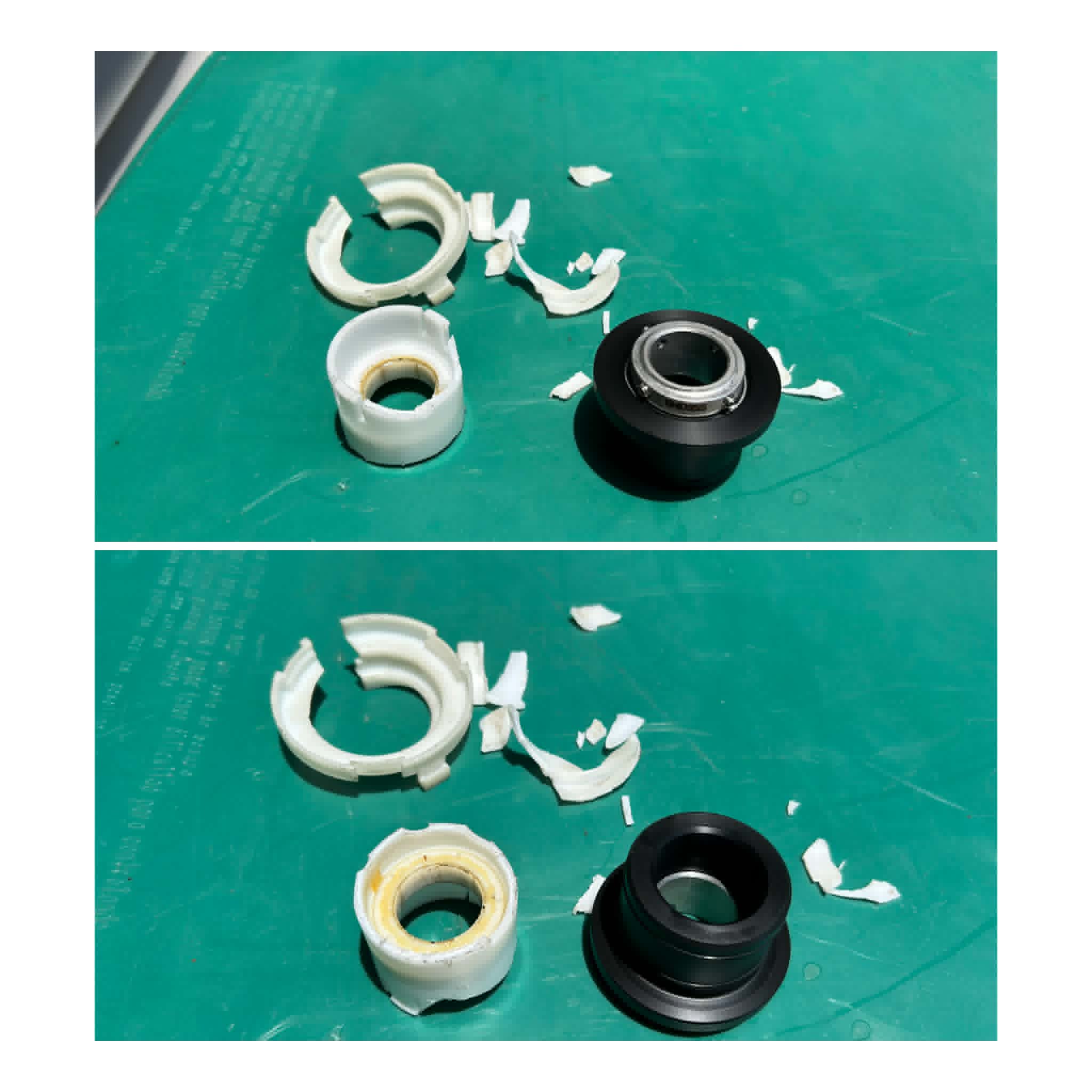

-Upper steering column housing bearing (GM#26001827). Steering wheel would rattle/grumble at low speeds. The old bearing race kicked my ass a little. Ended up using a dremel to cut it out. Thankfully the steering column comes with a notch pre-cut in a perfect spot for this. A blind bearing puller would have been perfect for this job but I was too stubborn to get a special tool.
-Lower steering shaft bearing (WE#GM109SS). Steering wheel would rattle/grumble at low speeds. Installed upgraded Wolff Engineering unit. Whoever thought a bearing race made out of plastic at GM was a good idea should be slapped.

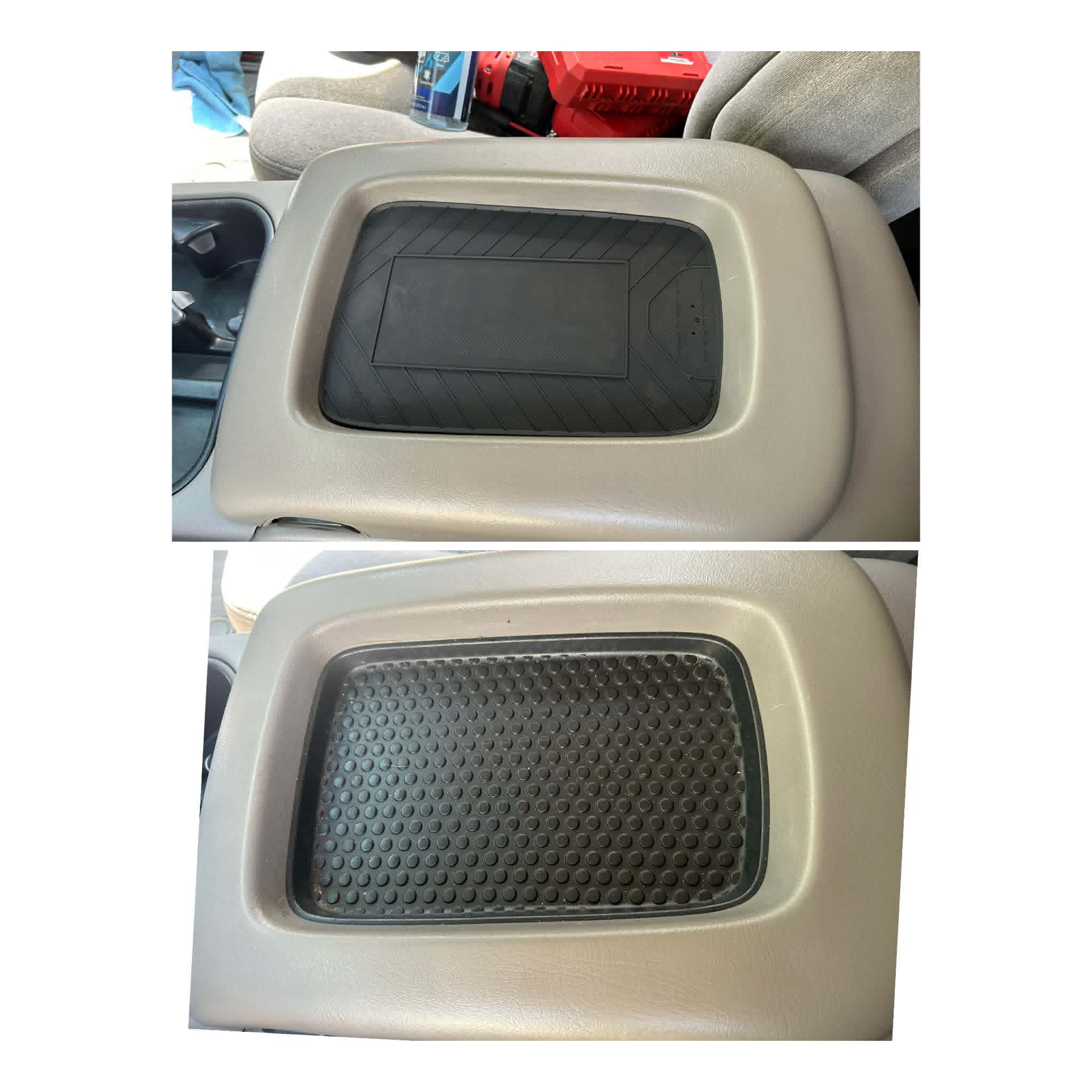

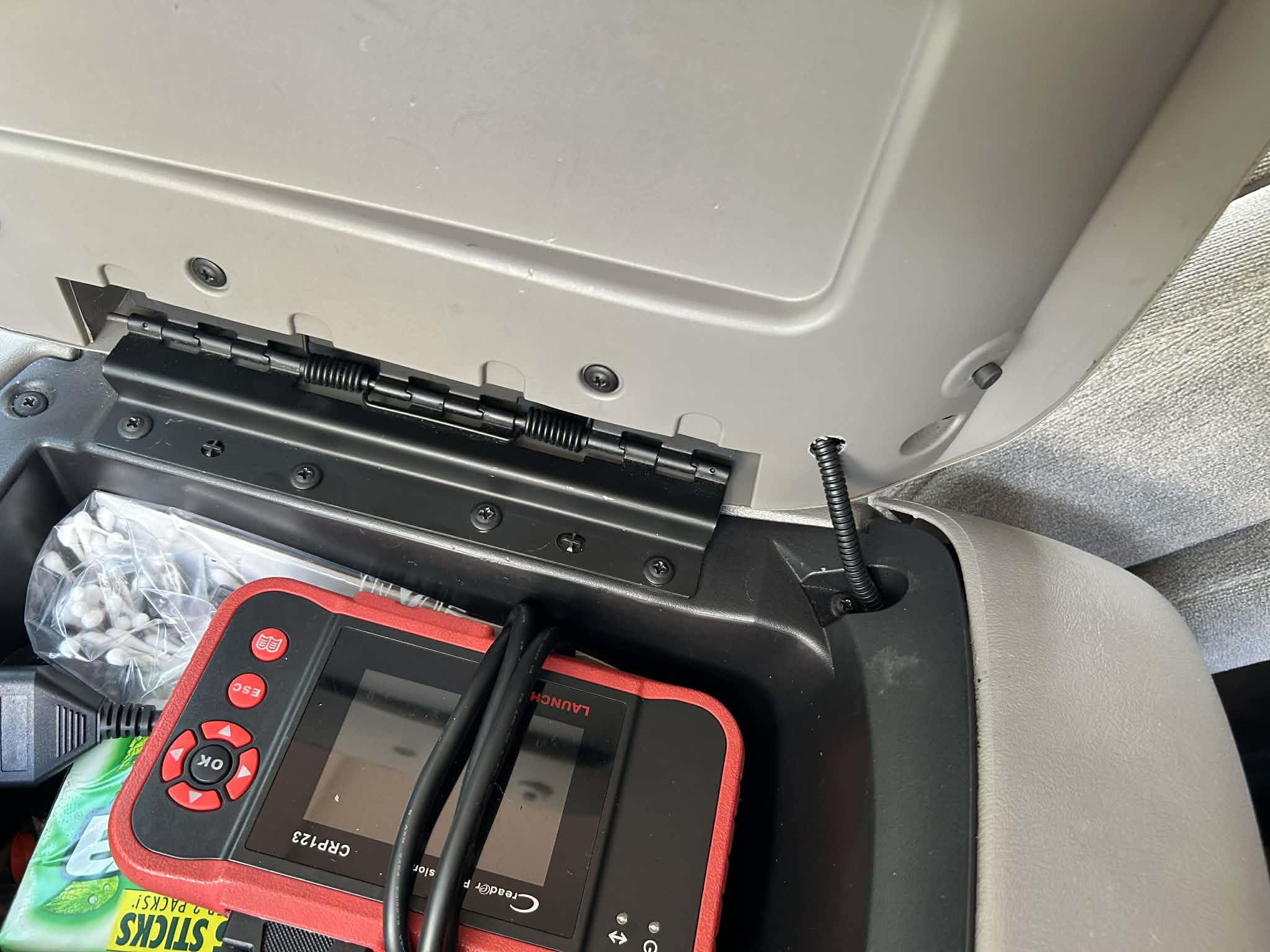

-Boost Audio wireless phone charger (BA#9906KIT). Replaces the OEM center console lid mat (GM#15070483). Pretty cool upgrade....plug and play wire harness, minimal actual modification.
