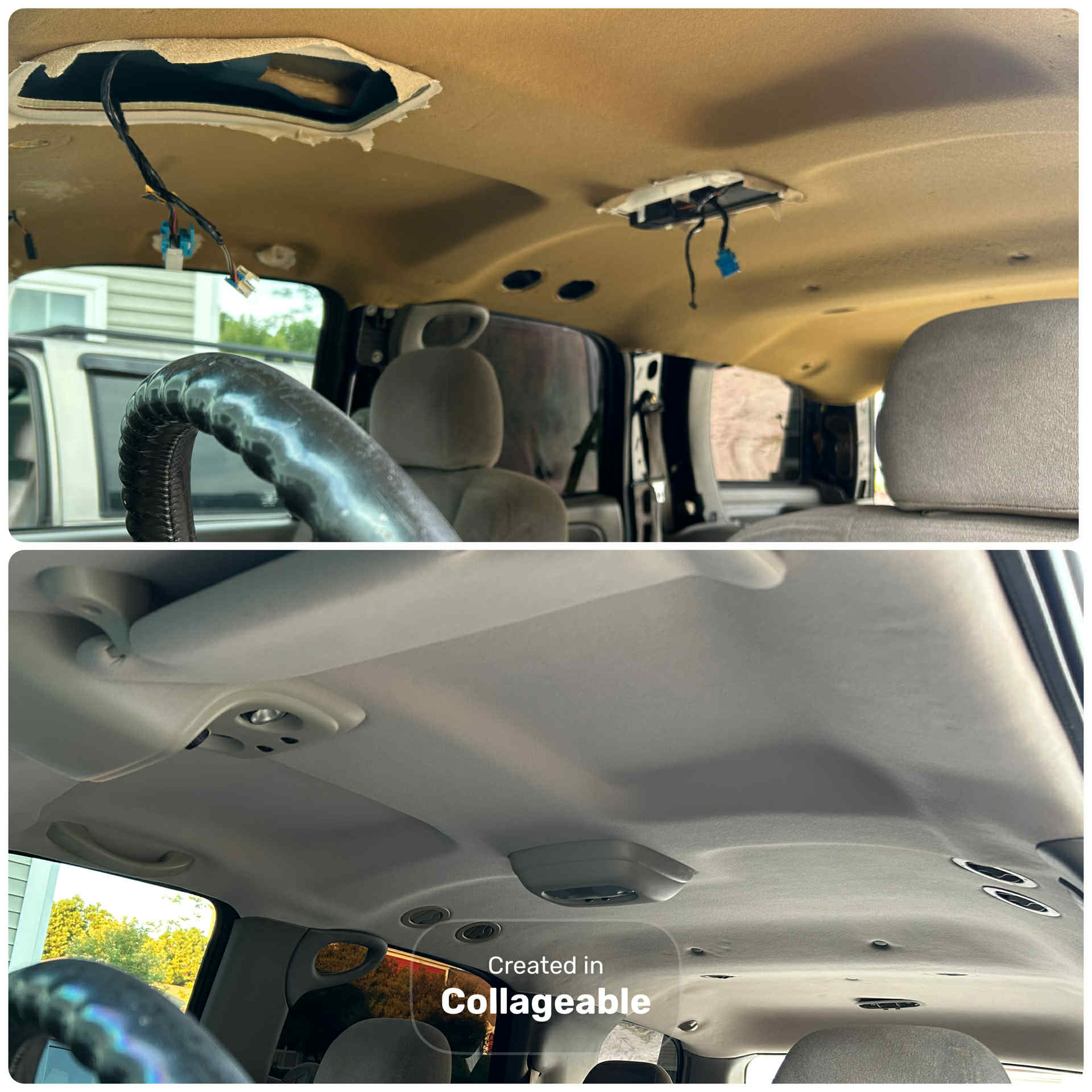

Had headliner and sun visors re-covered in material similar to OEM. Much better. Hopefully after a few days in the Georgia heat the foam will expand all the way and all the small depressions will go away. I broke the cargo bay dome light lens upon re-installation. Parts are on order :(

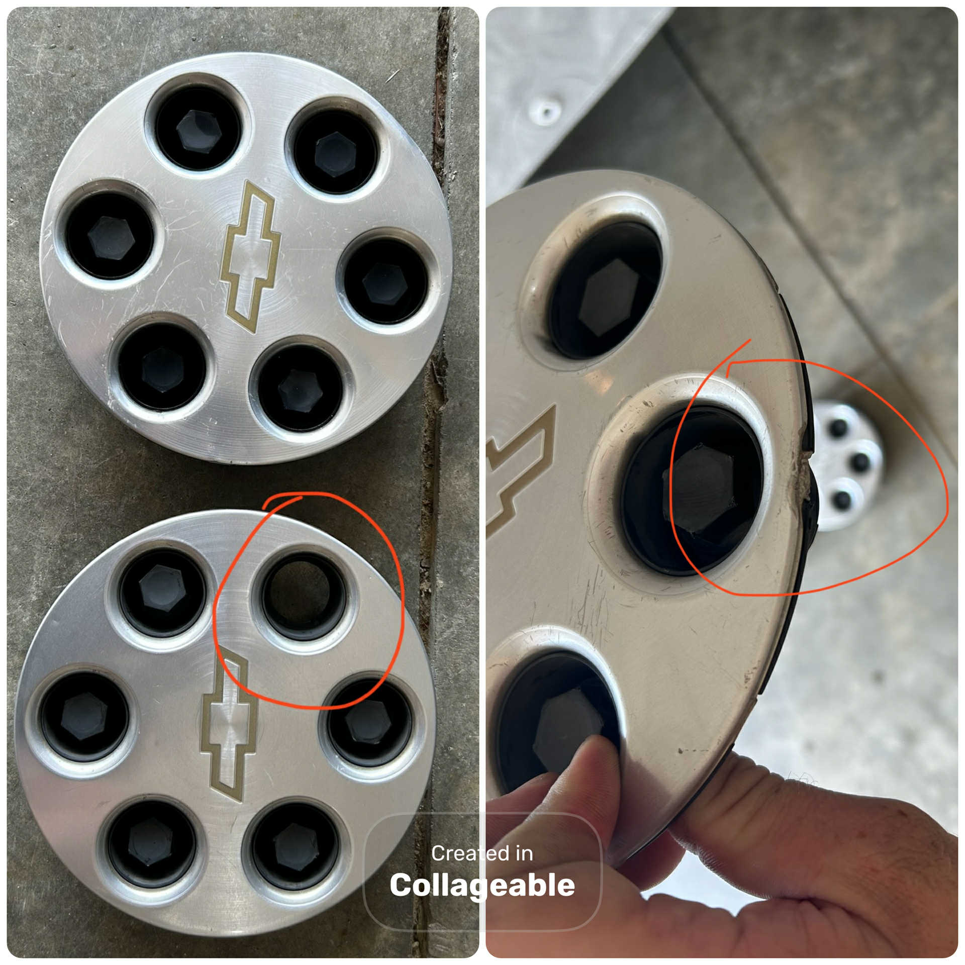

Replaced:
-damaged hubcaps x2 (GM#15004143) [Discount Tire damaged two when I took it in for a rotate and balance :(]

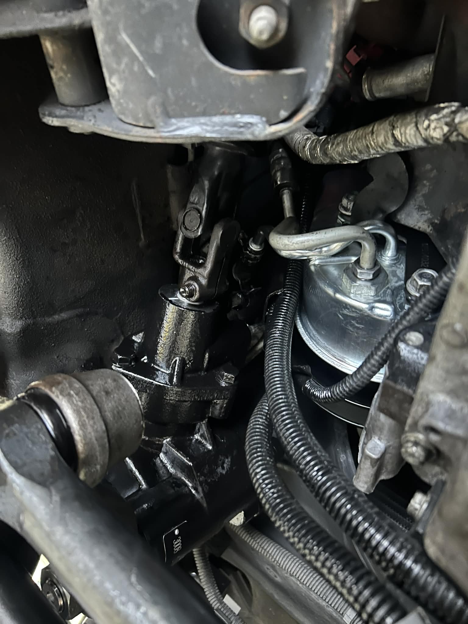

Current Mileage: 332,776
-Replaced power steering pump -making noise- (GM#19420681). When cold starting the vehicle, the pump would randomly make a buzzer like sound for 2 seconds within ther first 60 seconds of run time. Odd. Similar to this
-Replaced power steering pump pulley (GM#19421487).
-Replaced steering gear low pressure return port stem -leaking- (GM#23251100).
-Replaced steering gear -leaking- (Edlemann #E3008) and pump to gear line o-rings.

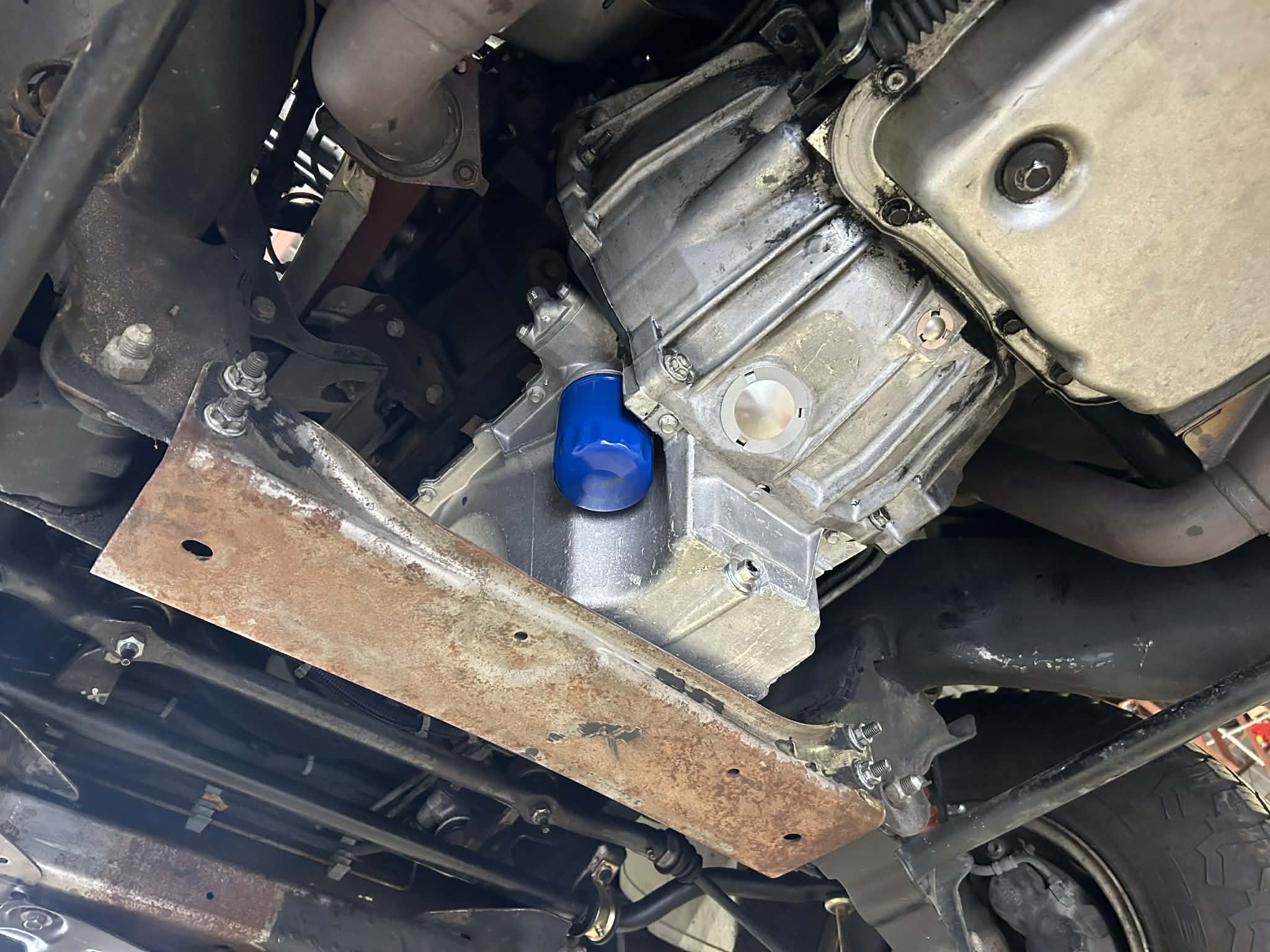

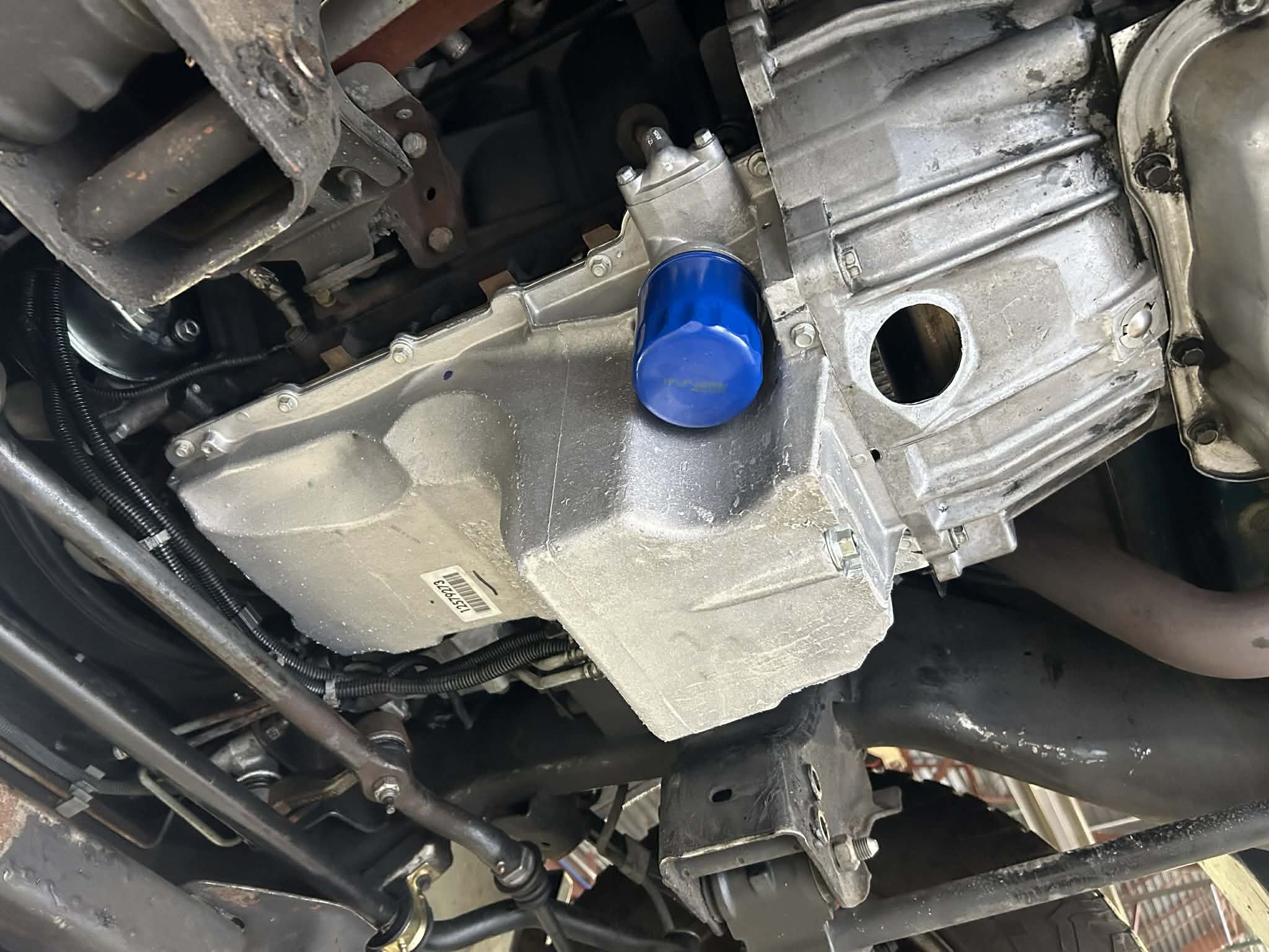

-Replaced engine oil pan -seepage- (GM#12577396).
-Replaced engine oil pan gasket -leaking...added extra sealant around front and rear engine cover mating points- (GM#12612350).
-Replaced engine oil level sensor -PMCS- (GM#12603782).

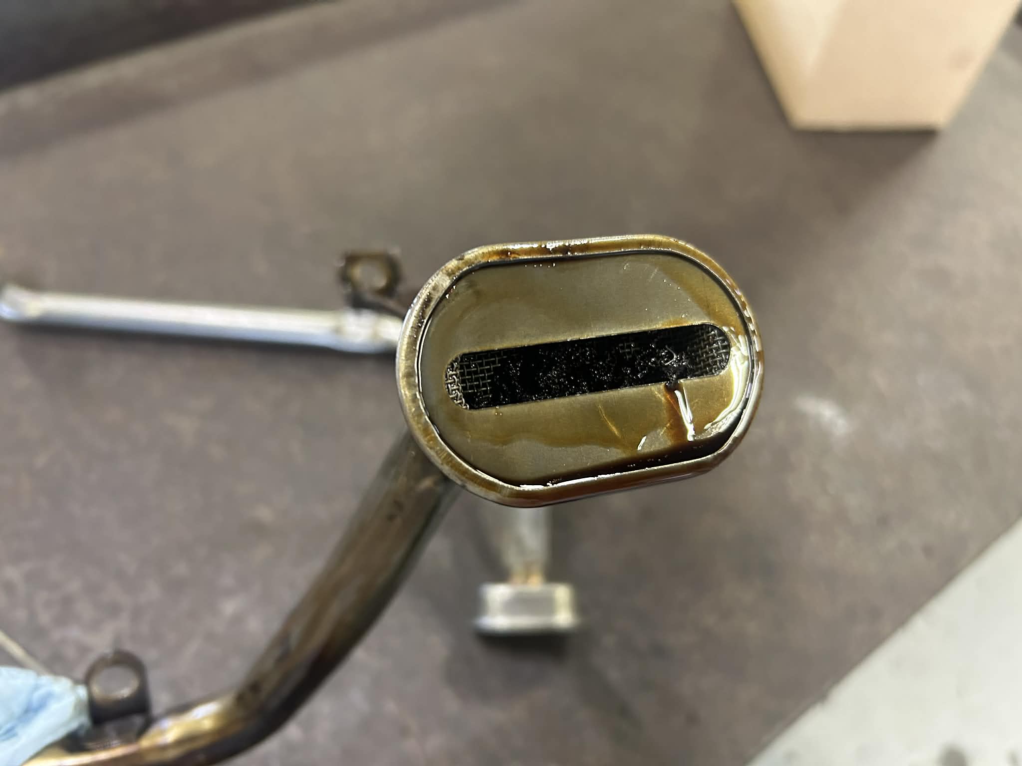

-Replaced engine oil pickup tube -PMCS- (GM#12563961). When I replaced the old pick up tube I noticed contaminants in the intake screen. Appears to either be filter media or a piece of paper towel that somehow made it's way into the engine. Will have to keep an eye on that.
-Repaired engine oil level sensor wire harness.
-Changed engine oil (Mobil 1 FSEP 5w30 and filter (GM#12737094).
-Replaced transmission mount -PMCS- (GM#15820075).
-Tightened body mounts -PMCS-.
-Vehicle is 100% leak free now.

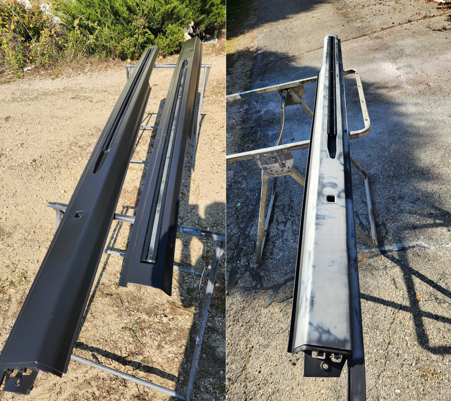

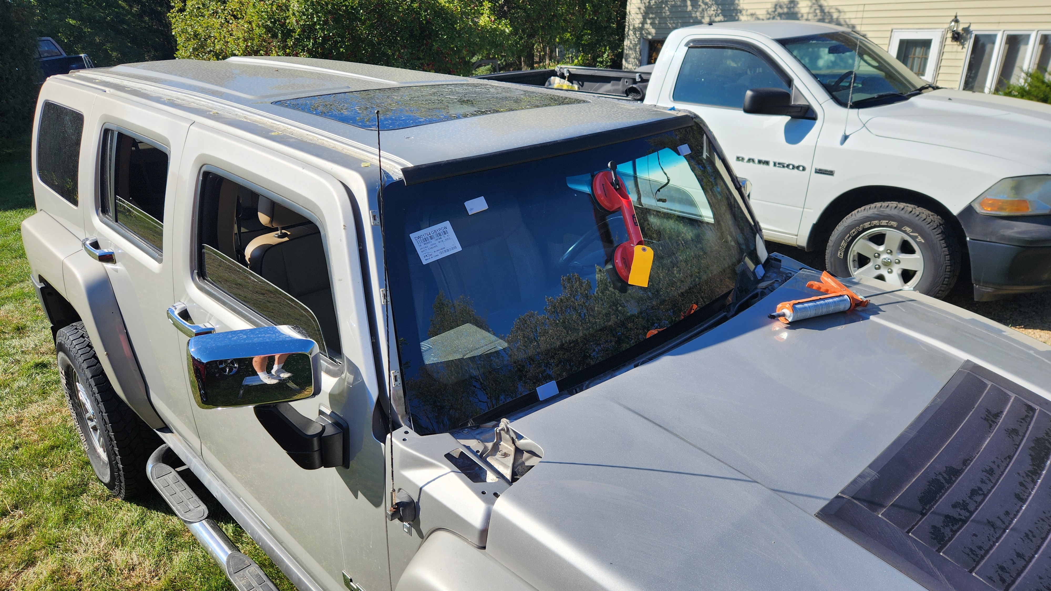

Wow! You've done a thing or three on the ole Tahoe! There certainly are a lot of die-hard Tahoe fans out there. Those were great yrs. Before they started putting a lot of nonsense nannies on vehicles.
Where did you get your seat cover from? Was that avail from GM? Or aftermarket material. It matches pretty well. 330k is a lot but there are guys on the GMT400 forums who have some real high mileage rigs. My GMT400 pickup is knocking on the door of 300k and hasn't had much work at all. So, with continued good maintenance, you should get a bunch more out of your Tahoe. Next thing you ought to look at is getting the roof (at least the hood) repainted. The sides look good but the clear is age-degrading on the horizontal surfaces. Normal aging and breaking down from UV / heat exposure. Swing by Maaco one of these days. See what they say. Talking price can't hurt. Ought to be something they can do quick n dirty. I'd pull the roof rails back off if you have the roof repainted (can do a more thorough job).
I re-did the roof on my H3 last summer (degraded clear). Re-did the ugly-looking roof rails with base/clear. Put in a new windshield. New glass makes it like a new truck.
Love your project! Keep the pictures coming.
That's a lot of work! Paintwork is something I have not tried my hand at aside from a brush guard (or like product). It's on my list of things to learn how to do some day. Your rig looks good after the roof rehab!
I pulled the seat cover off of a wrecked Avalanche. Put a new seat cushion in.
Thanks! It should be reliable and easy to work on for a long time. Makes a decent daily.

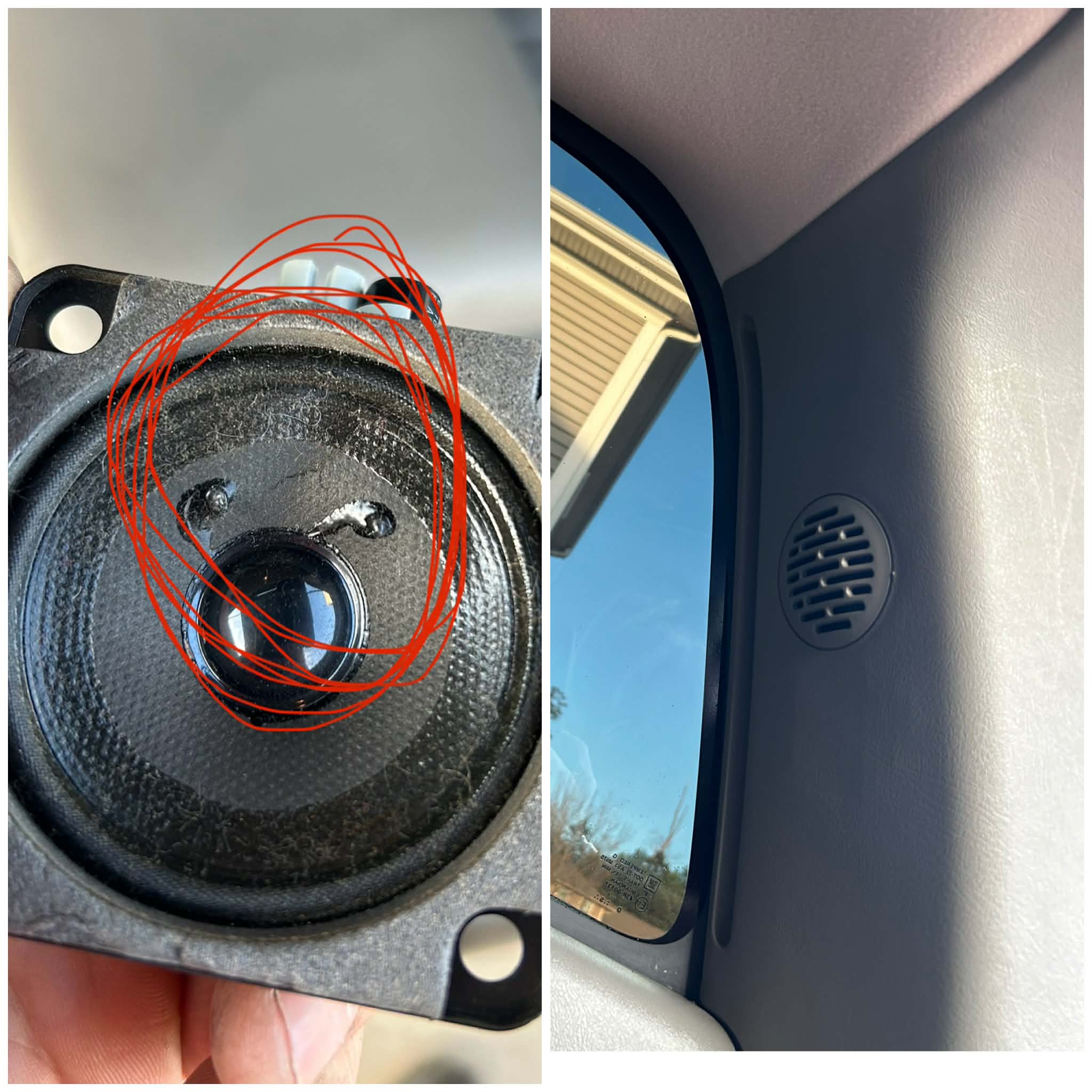

Current Mileage: 333,412

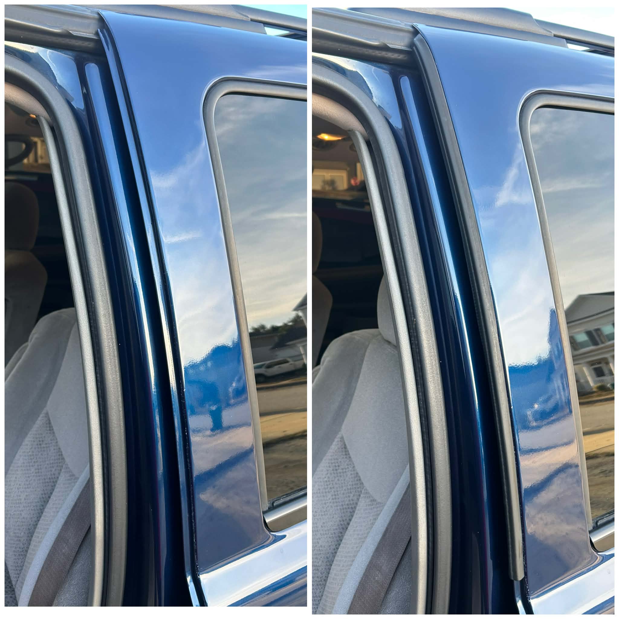

-Installed driver rear door weather stripping (GM#15766603). (missing)
-Replaced front passenger side sill plate (GM#10359432). (broken...my fault....LOL)
-Replaced right rear cargo bay speaker (GM#15053683). (broken....see small tear)

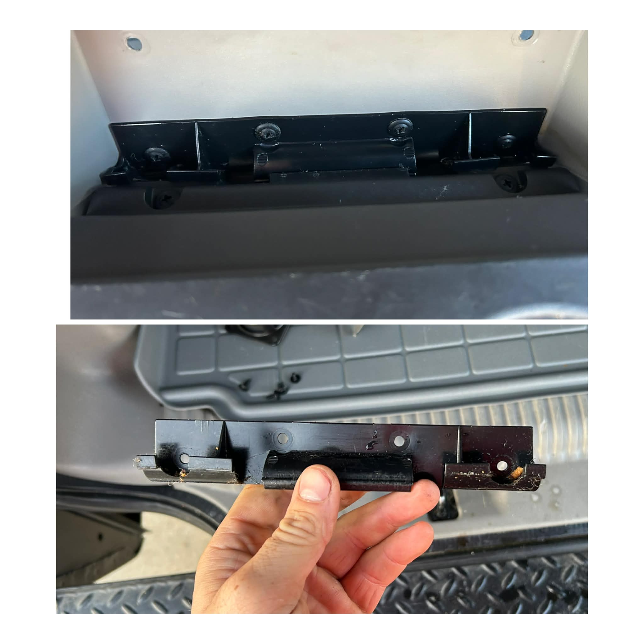

-Replaced center console rear cup holder support bracket (GM# NLA). (detail guy accidentally killed it)
-Replaced center console rear cup holder retainer latch (GM#NLA). (broken) Cup holder now opens and closes as it should.
