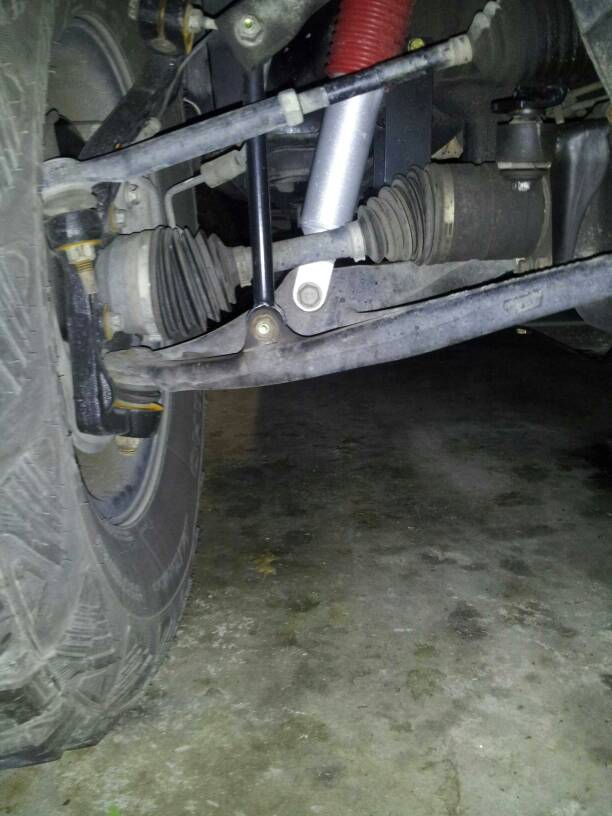

Here are my half shaft angles. My lift was installed by a mechanic who worked for the Hummer dealership in Memphis a few years ago. He said the angles should not be a problem and even he couldn't believe the ride after it was finished.

Well guys got the truck on jacks and tried to adjust the keys to bring the front end up and I literally could not get the bolts to budge.. They seemed to be maxed out.. Looks like I'm stuck with a little forward lean.. Lol maybe when that backend starts to sag it will level out lmao!!!

Check the T-bars, from the factory they swap my bars and I couldn't get my front end any higher until I seen the bars was flipped. They should have a blue stick on them that say "L" and "R", from the inside of you truck is the way to tell left and right.

So if this is backwards I have to turn counter clockwise to raise the front??? Right??

No clue what that red arrow is pointing at (never been under a lifted 3) (***after a closer look I now know what it is, with the control arms lowered you need an new part to link that T-bars to the control arms without selling new t-bars. They look to be in the right spots.***) but if you can read the tag that the blue arrow is pointing at is what I'm talking about. That's the T-bar it self and has to be on the correct side to rise up your front end higher. Real simple to swap, remove the t-bar bolt and key and hit the lower control arm with WD-40 that the t-bar sides into. You may need someone to hit the lower control arm with a big hammer or it will just pop out.

The keys are fine. Your drop brackets (the cast pieces that plug into your A-arms) are backwards. You can clearly see the "R" and "L" in the photos...and your's are installed backwards. Take it back to the alleged mechanic and tell him to swap them so the "R" is on the right and the "L" is on the left. Speak slowly and clearly...he might be retarded. I seriously don't know what Rancho could have done to make it more obvious. You should be careful letting people work on your truck.
:giggle:
Also, the t-bars themselves are indexed differently for RH and LH sides AND ALSO FOR FRONT/REAR ENDS. They can be installed backwards and/or flipped....but they will only be correct if they are installed one way.

It all F$#@$ clicks now!!!!!! I knew something was swap, sorry I didn't see that sooner.
