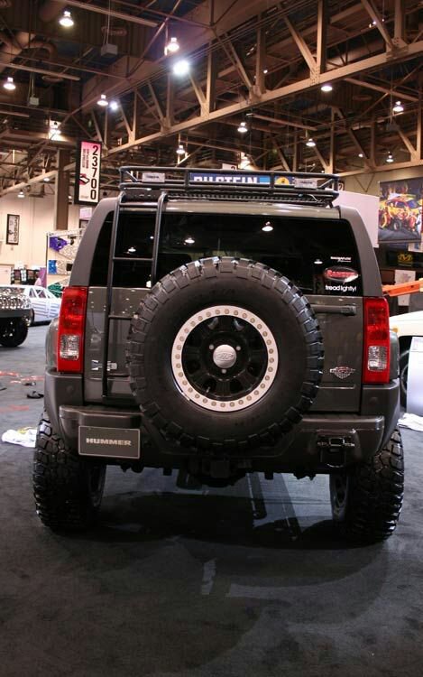

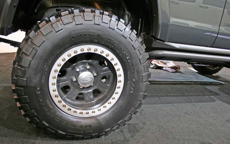

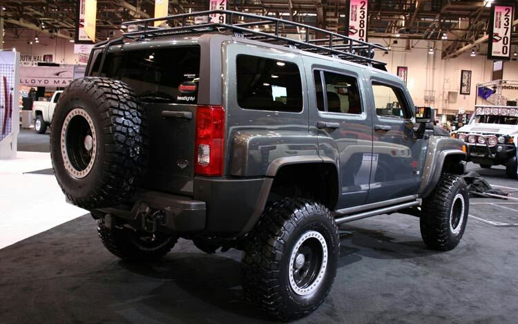

No they are full beadlock wheels under Racelines Competition Beadlocks and there is nothing tricky or special to running beadlock wheels. They are not CTIS like the H1 or something. You can just order them up like any other wheel. You just have to know how to bolt them down and maintain them correctly for your safety as a driver as well as others. These Raceline beadlocks are very nice ones with a machined in lip to seat the tire bead centered instead of trying to center it by eye like many of the 2 part welded beadlocks.
