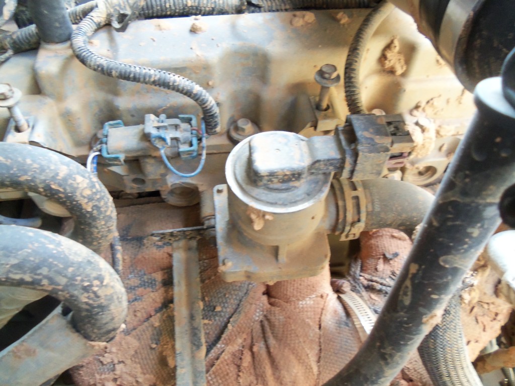

I heat wrap my heard 2"X100' and lord I will never do that again with the head still bolted to the block!!!!
Thats why I will gladly pay for the workshop doing the exhaust to also wrap the headers, my massive hands wont be able to fit in there at all :wink:
