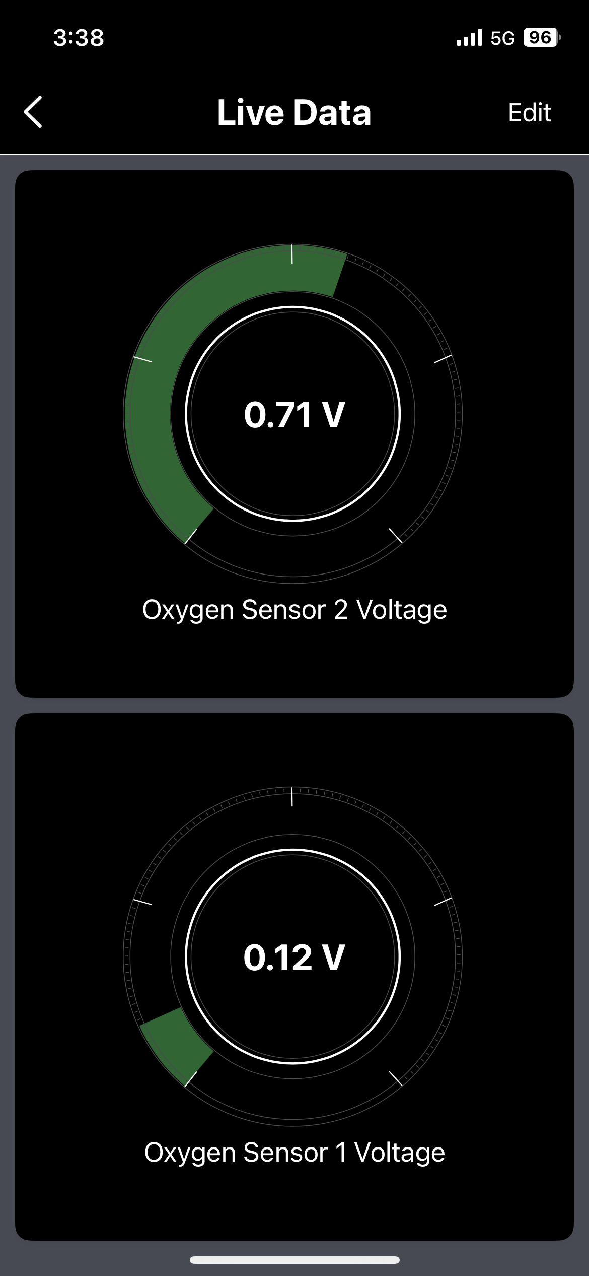

Went for a quick ride and found sensor 1 jumps from 0.12V to .8V constantly. I am assuming this is the issue. My guess would be to replace the remaining 3 sensors to avoid further issues.
Any other suggestions?
2,848
I believe the upstream is supposed to cycle. You might need more than 100 miles to clear a stored code. Not sure the the number but I think there needs to be a certain start up shut down cycles too.
