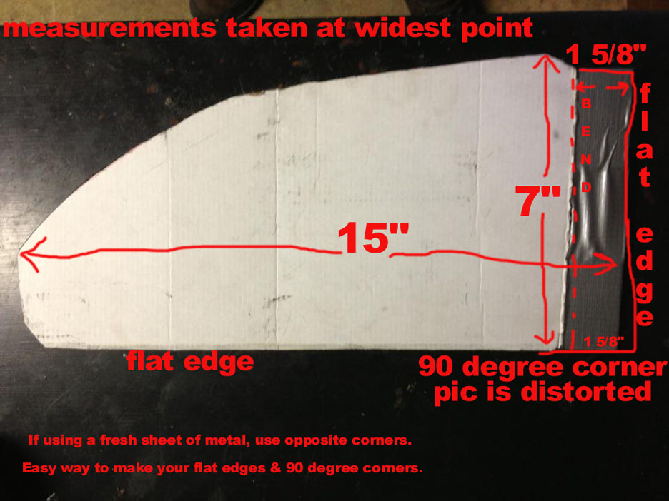

Here's my measurements, before anyone starts cutting

When this hits production I'm in no doubt. I didn't remove as much material as r-code but I can cut more no problem.
