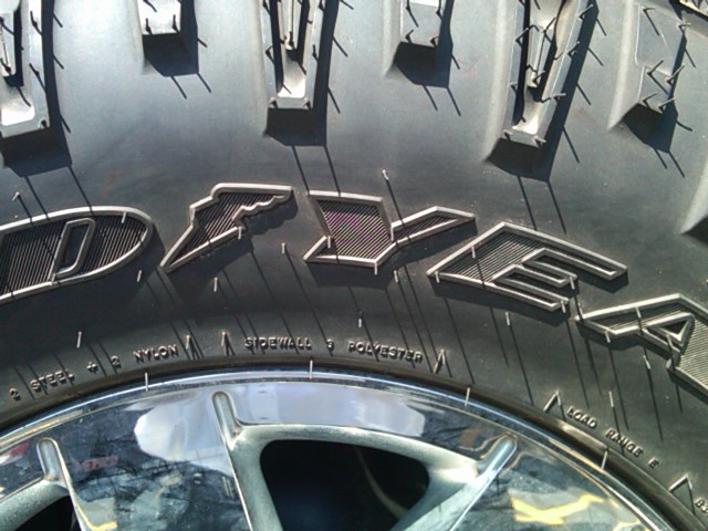

I run 33" (285x75x16) Duratracs. Load range E. 3 ply sidewalls. 16mpg at 75mph with the air on. I run 45 psi on road and 20 psi off raod. Nice quiet tire on road with aggressive appearance. Large lug voids on the edges. Rim guard design. If I were to spend a lot of time in sand then I would opt for the 305x70x16 - 33's. They are excellant in snow. Good in water, mud, rock, tree roots.
My slate blue and the white H3 are both running 33" duratracs in the below photos.
