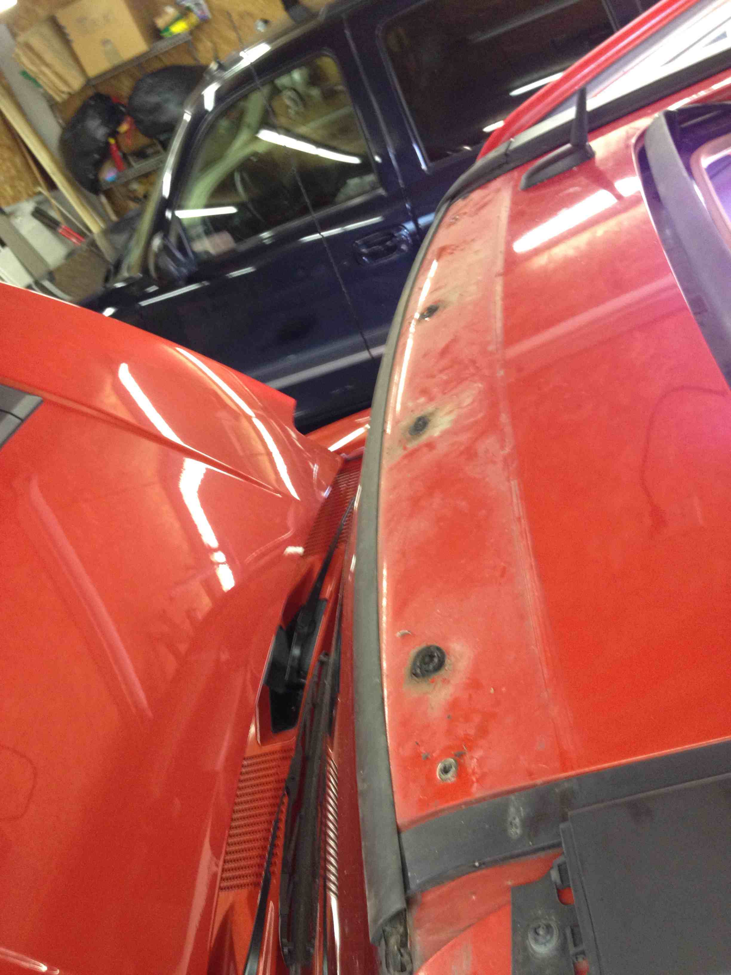

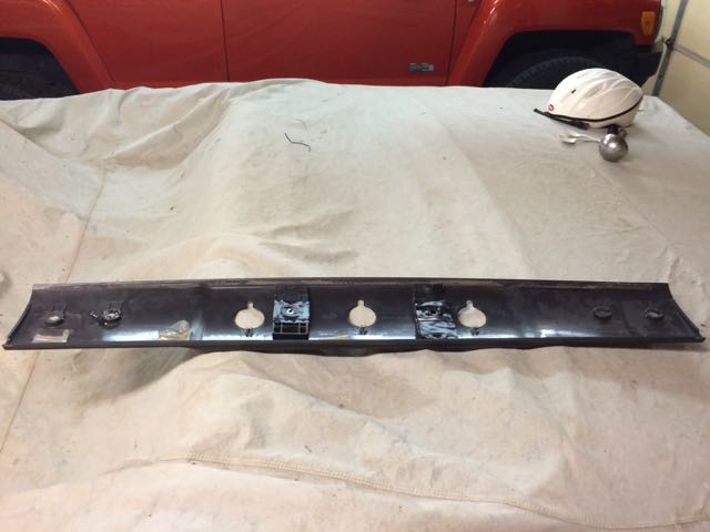

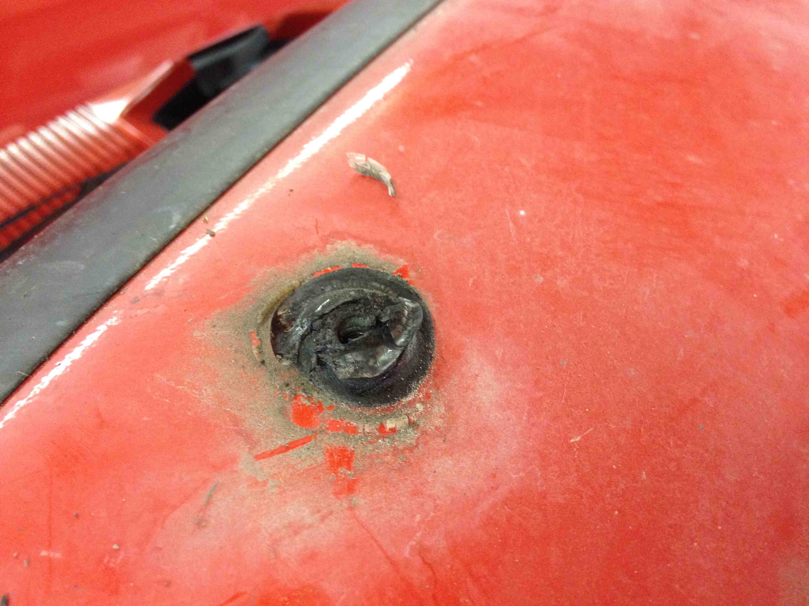

OK, I have a few minutes, so first I'll add more detail on the repair to the marker lights, since others had a similar problem. The sort of rivnuts that GM uses to mount these accessories come loose. As a result, when someone changes the windshield, if they don't care, they don't put the fasteners back on correctly. If you hear a rattle - FIX IT. I didn't, and one day while cruising down the interstate the valence tore loose. Fortunately, one end held, so I was able to hang onto most of it. When I got home, I damaged the valence further trying to remove it while those nuts kept turning.
Finally, I took the time to repair the valence and repair the nuts. I asked a local body shop to spot-weld. They did a pretty nice job - put a bid of body filler around their weld spots. I then spray painted with a color matched rattle can (not really necessary, since it's under the valence, but I had the paint, so ...).
I had to repair the valence. I used Epoxy to put back together the fastener anchors that tore loose, and used some 3M vinyl mastic to build up a support to replace one of the two supports that blew away the day the valence tore off.
Once that was complete, I used some black RTV for better sealing, some matching metric thread bolts, and re-attached the valence to the now-secure nuts. Unfortunately, I lost some caps and others didn't fit after my repair job, so I used some 3M vinyl mastic to cover over the bolt heads. I did notice that the original installation was poor. The holes aren't positioned correctly, so that the passenger side is about 1/8" forward of the driver's side. Unfortunately, so good way to fix that.
