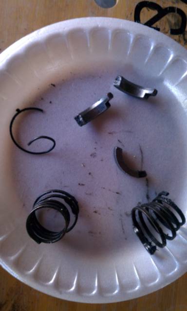

I took my winch apart (not entirely on purpose... I sure didn't mean to take THESE parts out...) in order to tap the threads on the drum. But when I took the drum out, these parts came out and I wasn't able to tell how to put them back together. These parts don't even show on the rebuild parts list here on milemarker.com. (I did put it back together without these parts (just to keep it contained) and it's still fully functional without them, but would rather put it back together right.)
Anyone know how to put this sucker back together? :) Specifically: just those small parts in teh picture below. I got the basics but these seemed to pop out befor eI got a good look at how.

Here's my extra parts: they go in the right side (clutch housing?) but I'm not sure how.

My best guess is that it looks to me like Part#8 blow'ded up on ya! 76-50151-08 Brake/Shaft Assembly. The 3 pieces are the broken retainer for the spring. Look in the diagram and you will see the retainer with a 3 pronged "thingy" holding it in. Remove the drum again and the brake shoes and you may see what I'm talking about. Not sure what the "rubber seal" looking thing is. Is it plastic, steel or rubber (upper left in your plate picture)?

Yep, part 8 blowed up on me real good! These parts though are from in the housing... there are 3 springs, and then 3 prong things (all steel), but their diameter is larger than what I remember them coming (flying) out of. But shoot, maybe I remember wrong and they came off of the left end of #8? Shoot...

Ok, I called MileMarker: those guys are great. They said I've got a shattered brake assembly and are selling me a new brake assembly. I'll be able to slap that bad boy right in there and be good to go-- no guesswork involved. Will post some pics when I get the parts but I expect it to be a week or so.
