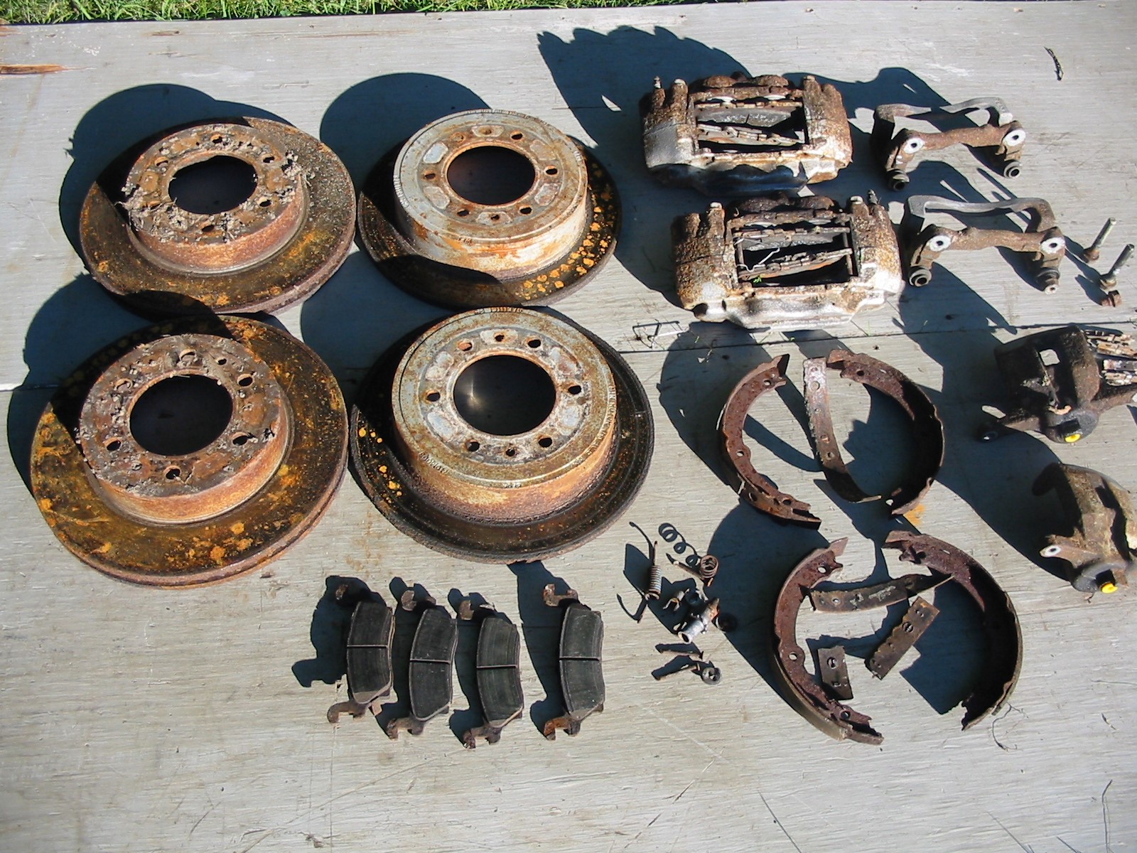

Trash can brake job.
Since I bought the Hummer I knew the brakes needed some attention.
Removed the wheels, unbolted the calipers and removed the pads. Front caliper bracket bolts were rust welded in place and I ended up breaking two caliper bolts off. Removing the rotors was just as bad. PB Blaster didn't work. Couldn't use my BFH. Couldn't use my very BFH. Ended up using a combination of a very large puller and bolts screwed into the calipers. When the rotors finely broke loose it sounded like a gunshot. The parking brakes were also a mess. Looks like they have been sticking. The shoes came off in pieces. Got out the trash can and threw everything away. Installed new actuators, parking brake shoes and hardware, new front pads/rotors and new rear pads/rotors. I used GM/AC Delco parts. Buttoned it up and took it out to burnish the brakes.
This was one of the toughest brake jobs I've ever done. It looks like the previous owner{s} couldn't get the rotors off so they just installed new pads. Once, twice, who knows. The brakes are now back to factory fresh and the Hummer has better get up and go.

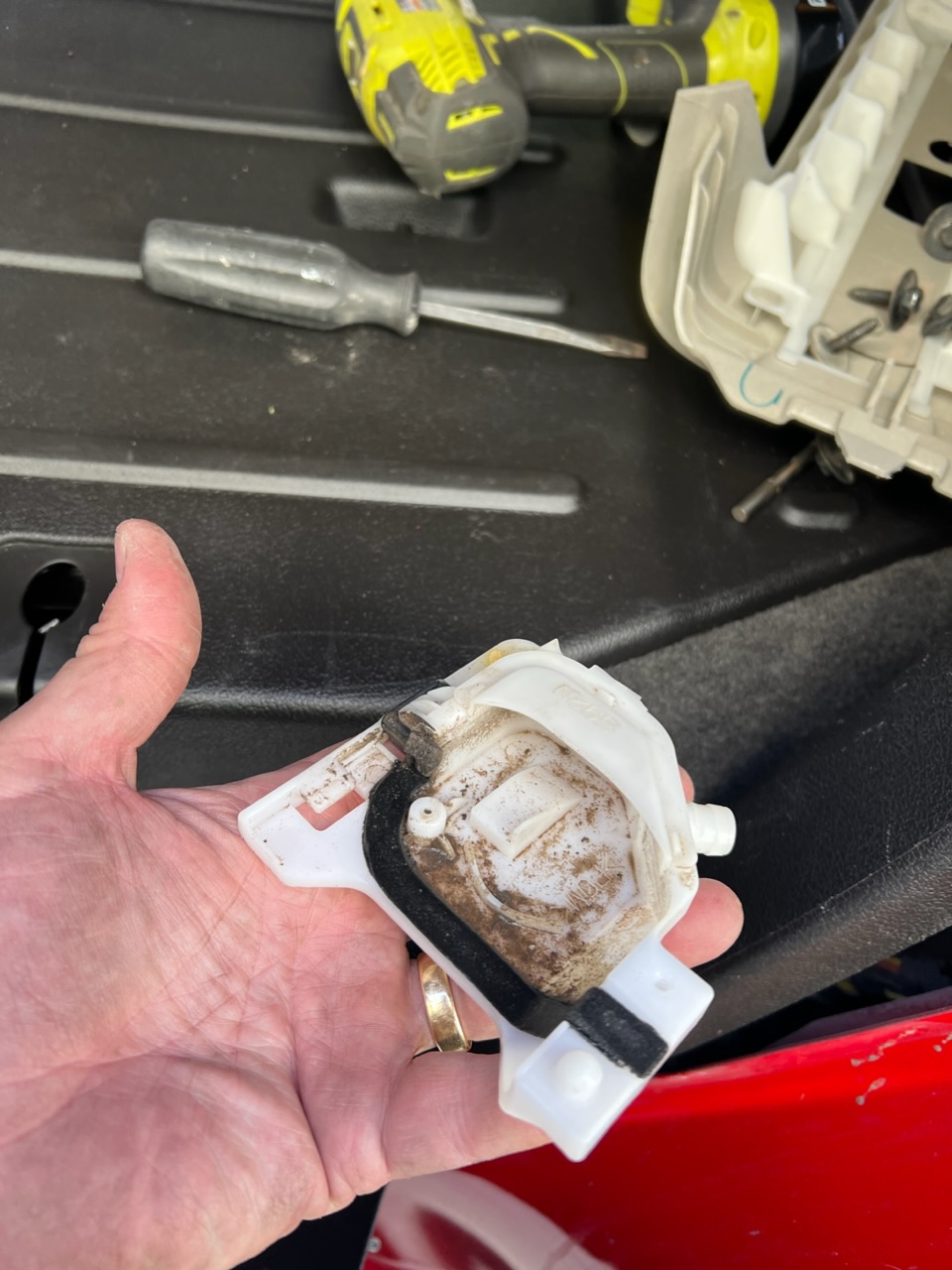

Noticed some moisture underneath my floor mats and some mild mold. Come to find out the carpet was soaked underneath on the passenger side.
First time sunroof drains have clogged, not very excited to pull the carpet to dry it out. Been doing some dusty trail lately, paired with all the rain AZ has been seeing must’ve been the perfect scenario for them to clog. Oh well.
SAME!!! Sunroof leaks In AZ too! Detail shop supposedly cleared them twice. Fronts test drained fine, rears immediately over flowed.
Pulled down the headliner, and pulled the rear wheel wells. driver side drain plug at the wheel well wasn’t pushed all the way through and was punched shut. Pulled it out opened it up more and snaked it with a long camel bak brush; tons of stinky black muck came out. Obviously not recent muck. Same on passenger side.
Took off the rear drain trays where the tube connects to the sunroof tray.
Total garbage design with a 2 sided tape foam seal destined to leak. Still dripped so I removed them and silicone sealed them. They come off with 1 Phillips head screw on top (PITA) and slide back. No leaks. Flows great and even gets a siphon going.

Wow! I don't think I've ever seen brakes in that bad of condition. Amazing that it even moved (or stopped). Glad I live in sunny SoCal (although we've got blizzard conditions currently).

I looked at the high performance parts but went with GM/ACDelco parts instead. After I burnished the brakes I had a small white car pull out in front of me. I stood on the brakes and thank goodness no paint was swapped. I'm sure the small car had to have the seats cleaned but I'm happy with the brake performance.
OEM vs. High Performance? It would be interesting to see how they compare against each other. Side by side, real world stuff. Not numbers on a piece of paper.
Hello 650Hawk,
Surprisingly the brakes were good. The brake pedal didn't sink or fade. The Hummer pulled slightly to the left but still had decent stopping power. It wasn't until I changed them that that I found out what a mess they were.

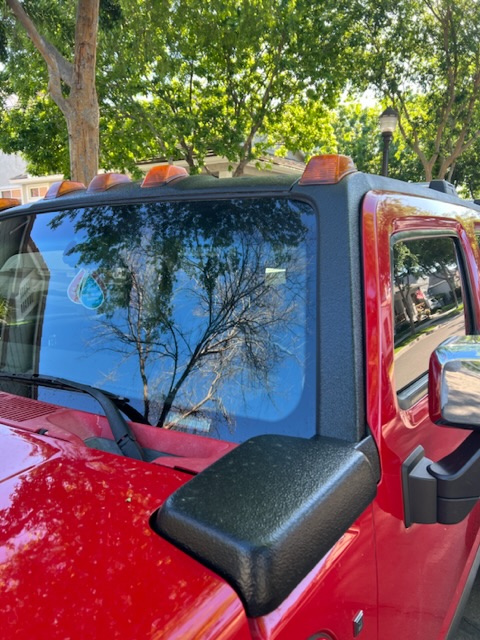

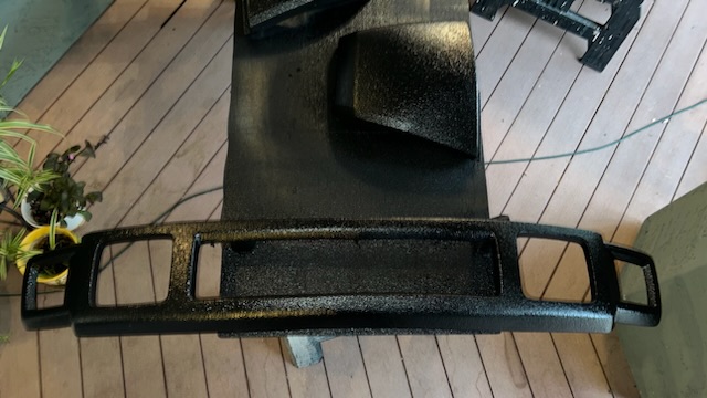

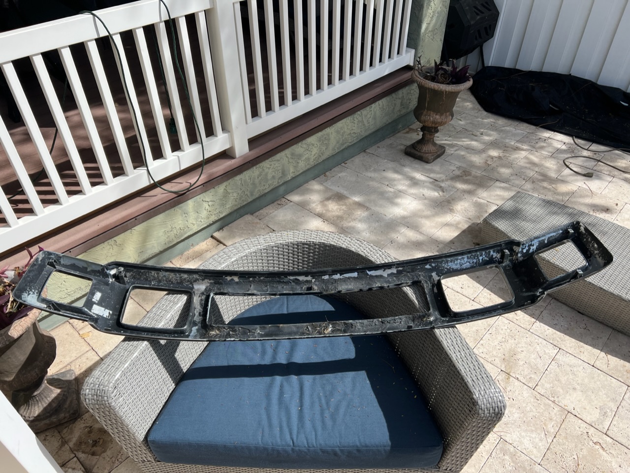

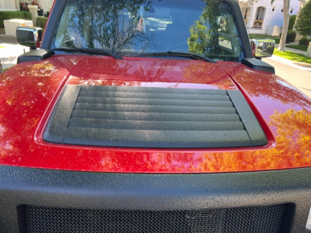

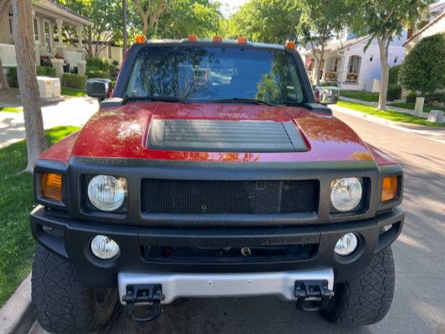

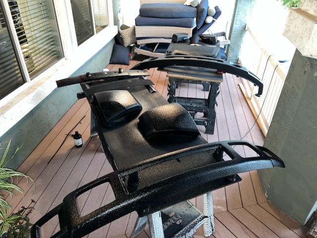

Freshening up the trim. The youngest boy wanted to do this. Raptor Bed Liner for everything.
Custom grill was peeling pretty bad so we ground out the bad spots and re-faired it nice and smooth.
Hood louvers were a Pita stupid design fixed with urethane windshield glue. Epoxied all the original fasteners back in place. Have the glue too.
Did the fake air intakes, Roof brow and A-pillar trim, rear bumper outer trim, and gas’s fill tub. Lots and lots of prep work!!! Looks really good. Need a new key for the roof rack to get the rest off and finish the job. Putting it back on in the AM.
Had to move them to the porch because it threatened to sprinkle. Sprayed them I the rocks out back.

Raptor Bed Liner
This is the stuff we used. Test sprayed the back sides to get the technique and distances right. Lots of very careful prep work. The kit came from Amazon, came with the sprayer we used it at about 60 psi. It’s pretty much just a cheap undercoating Gun. Per the videos you can reduce it 20% and use an HVLP sprayer for a smoother look. I think you can clear coat over it as well.
One of the main reasons we did this was to toughen up those trim panels. They were getting really sun damaged and brittle. I figure this stuff will help them live a bit longer.
Really it went on pretty easy. We think the textured look came out really well.
Good luck!!!
Matt

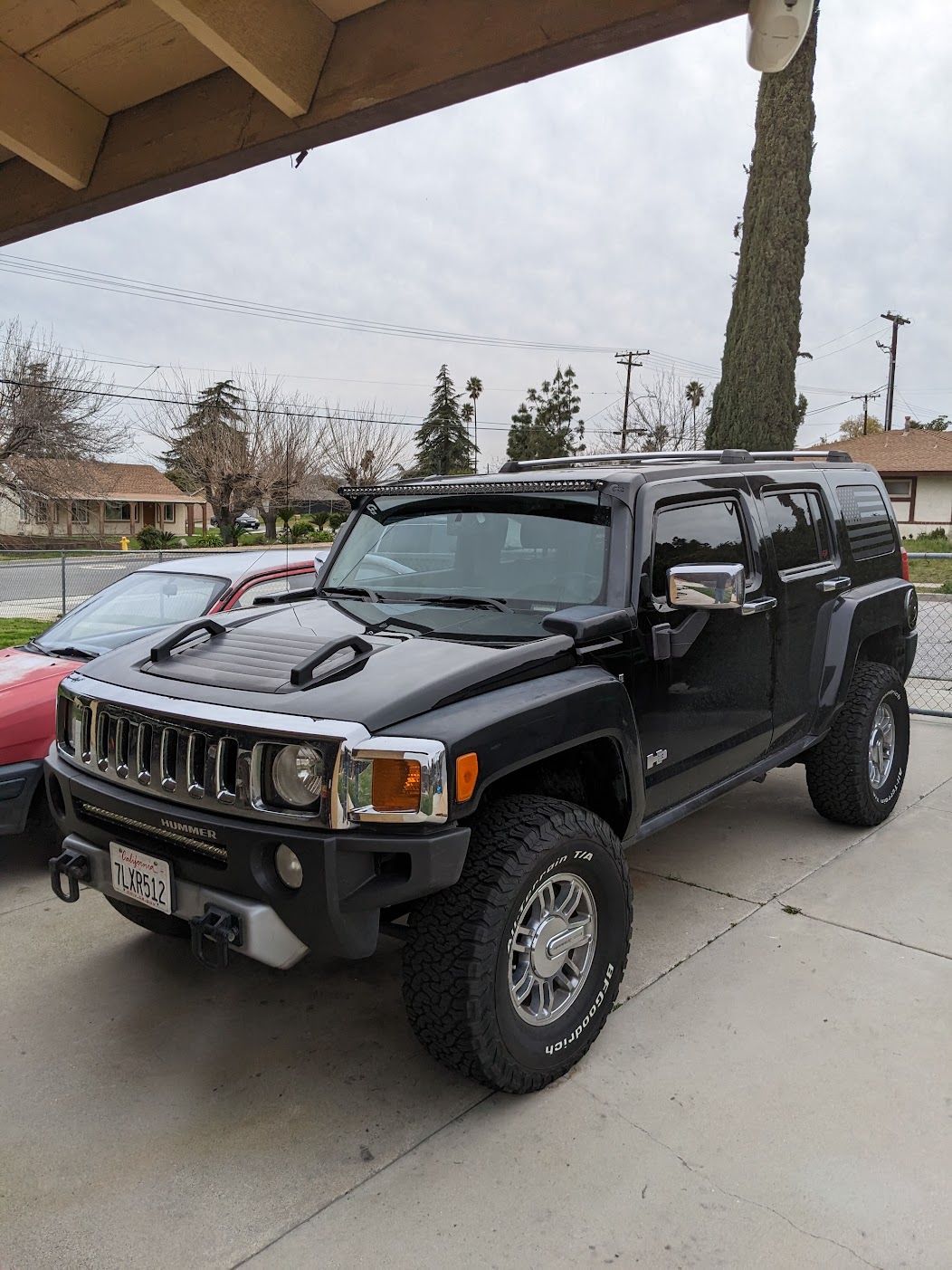

Mine are the same H2s with puck spacers under the hood vent so it's a nice solid mount. I'm vertically challenged and the H3 is taller than it used to be. I use them to pull myself up to clean the windshield on a regular basis.

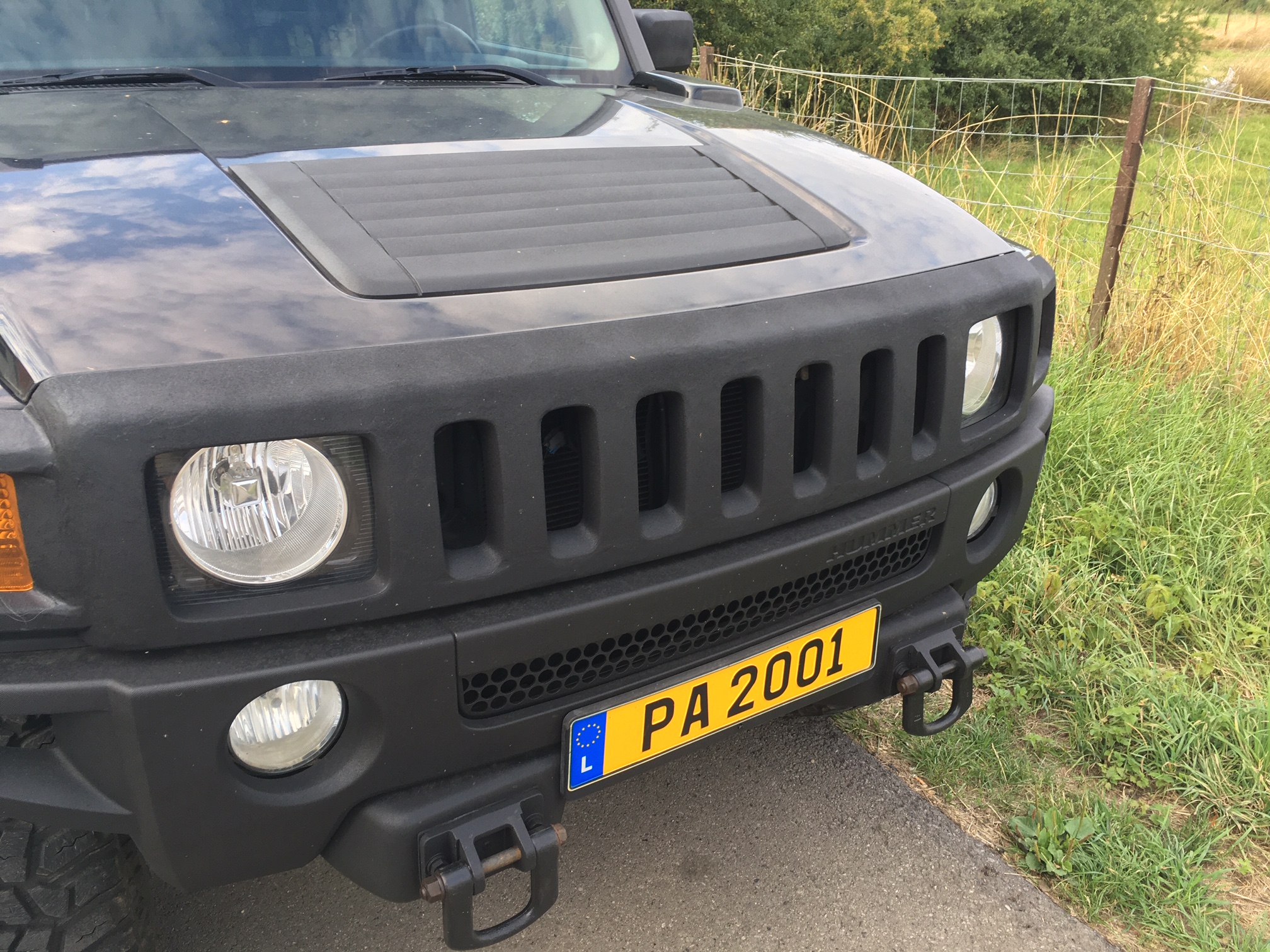

Looks like the PO cut out the vertical rungs, fiberglass backed the voids, skim coated, and sanded it fair. Then rattle canned it. Pretty good for an amateur.
lfootmatt
164
AZ

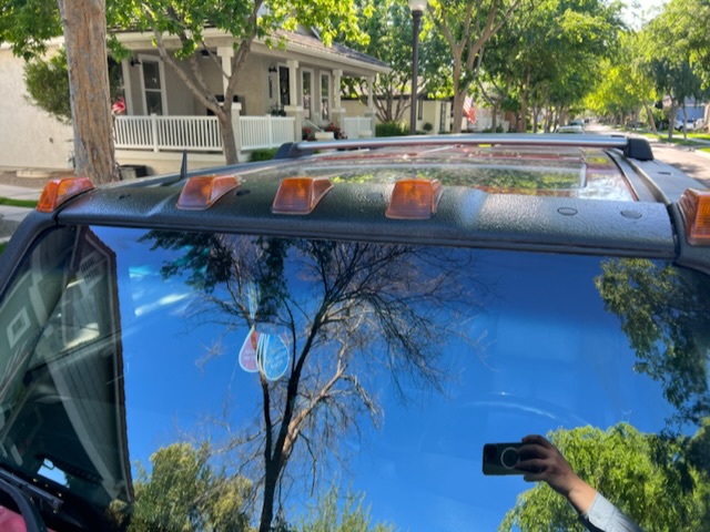

Some mostly finished pics. Need more hole plugs for the top roof brow panel. We like it. Need to find the right metal mesh to match the grill and bumper openings. Seems like the side plastics on the roof have shrunk and pulled rearward cracking the front attachment points. The AZ sun is brutal on plastics. More work in the following weeks.

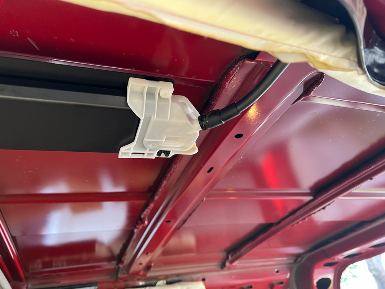

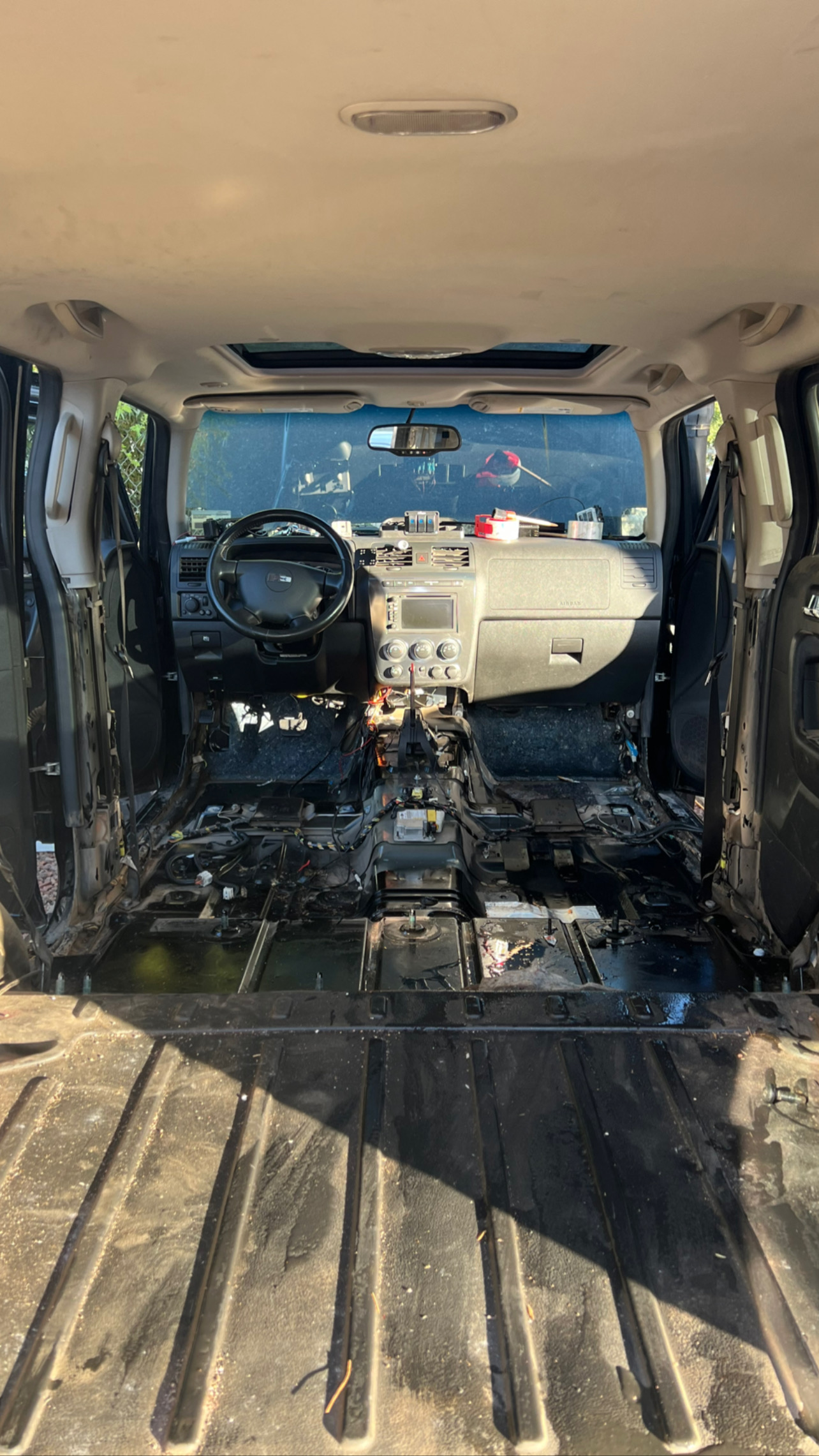

Interior tear down and carpet removal. Cleared out all 4 sunroof drains and now time to wash the carpet and get it smelling not so musty. Also found the dealership keychain tag that was sold with the h3 back in 07’
Sunroof seal on order, Az was hard on the original. But can’t complain after 16 years of use
