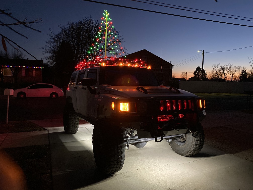

That's awesome! I did something similar years ago. Was quickly surrounded by two city cops and a sheriff's deputy. Got a big lecture about illegal use of colored lights and how I was probably confusing all the other motorists by impersonating a police car. Geez...someone had no Christmas spirit that year.
