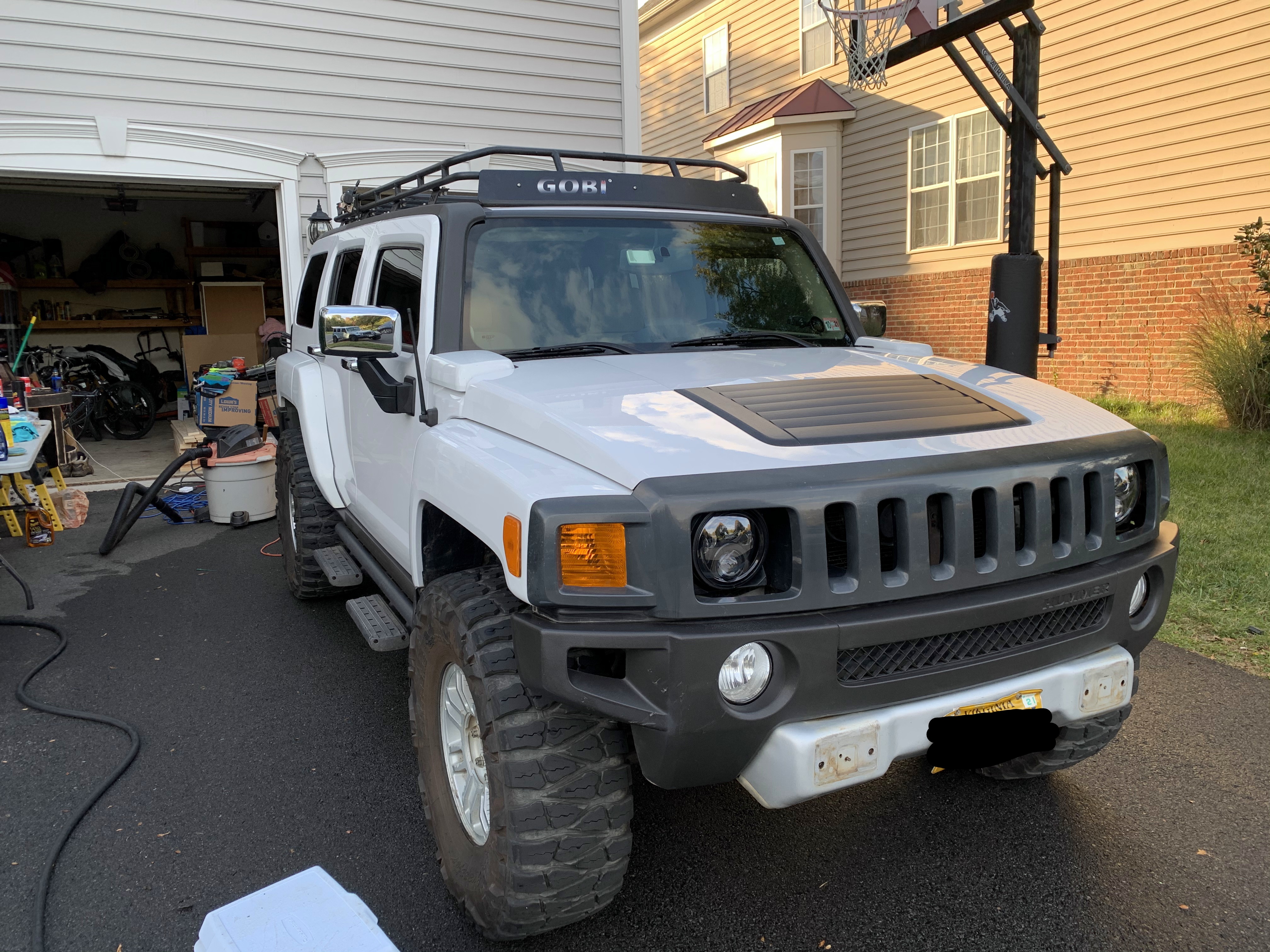

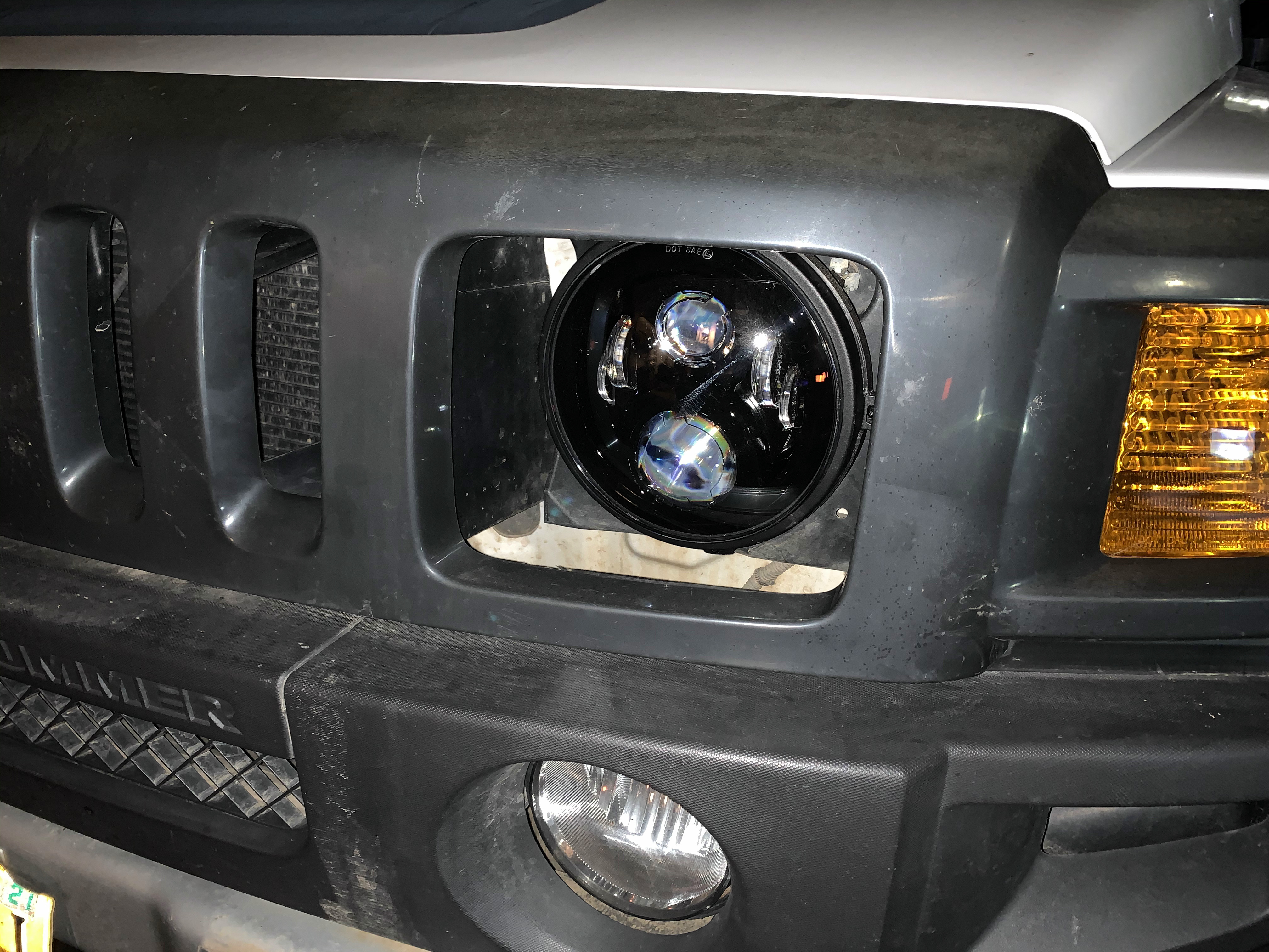

Finally got around to installing new headlights with the Lased Designs adapter kit for Jeep headlights. Took a bit longer than I expected, but I suppose most of that was due to me running back and forth to the store for things I needed and did not have.
I also took car of the rattling A pillar trim with some foam tape, seems pretty snug now. The stock foam tape was damn near brittle and about half the size it was from factory it seemed. After these two tasks, went ahead and used some 303 Protectant for the trim pieces to bring back that darkness and it worked pretty damn well. Washed the outside and engine bay for quite a while, gave up before I got to the interior. Next step is to get some bedliner on the grill and some new terminals since mine are cracked. Thank you Bowser-II (for the recommendation, not breaking them). Once that is done, I'll hopefully carve out some time to update my build thread that has laid dormant since before Pepperidge Farm can remember :shame:

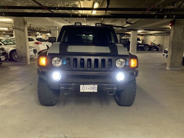

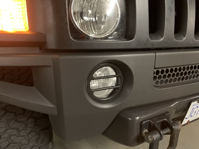

Foglight guards
I installed some foglight guards. They’re ok, no measurable decrease in light output, and It looks a little tougher.
