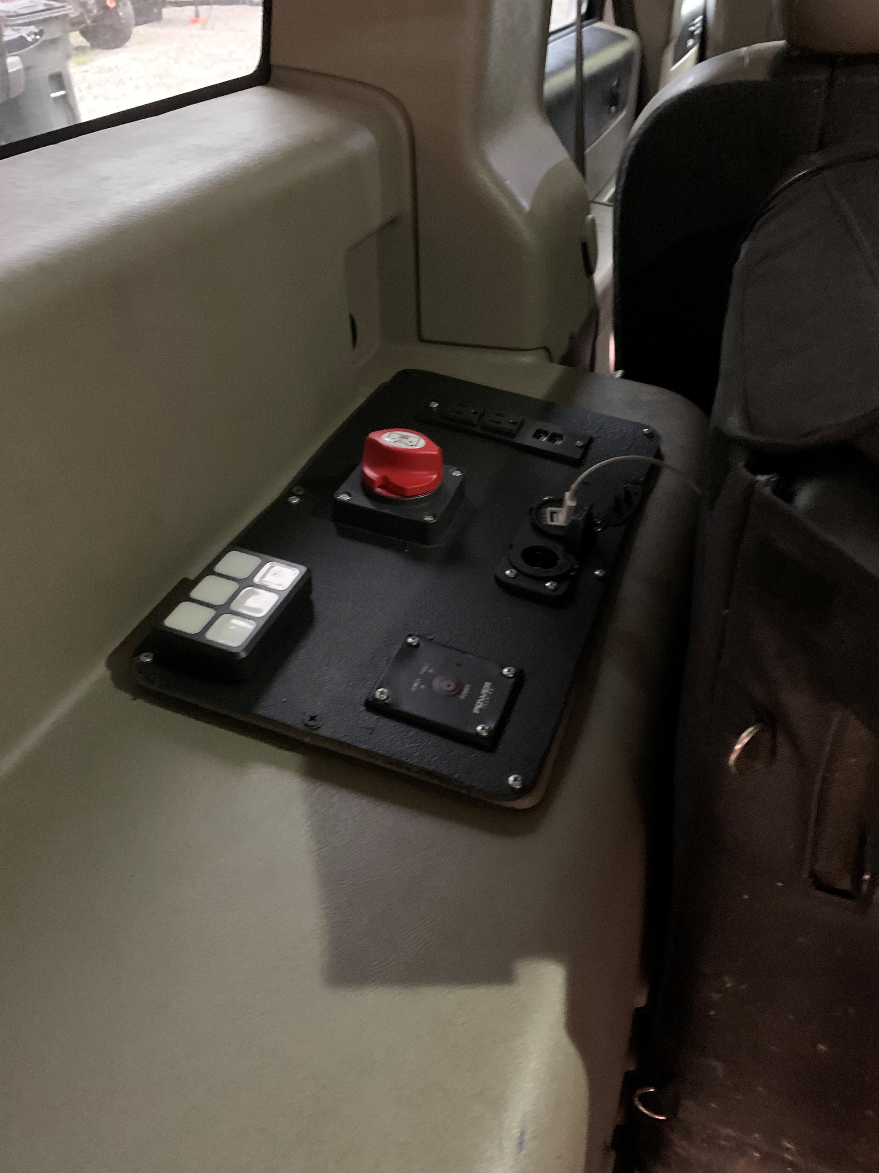

Finished my Aux battery install, I used the CTEK 250SA DC to DC charger which feeds my 100 AH battery. This feeds the 3000 Watt inverter, a Switch bank for aux components, and a 12V and USB charge points located on the control panel. I still need to improve the control panel as I feel the plastic was to thin for my needs. I added the battery blue tooth sensor with app but I will prob remove it as my battery went down over 20% since it was installed. I will see how it works when I add the solar panel to the CTEK later in the week.

I ended up mounting it using the old compressor mount, I fabricated a hold-down bracket and installed a PowerPoint for easy access for the wires, mainly because once that battery is up there its very hard to get to the connections and I couldn't put it in a battery box as its too tall so before it went up I plastic dipped all the connections on the battery just in case something made its way up there.

Good use of the space and helps keep weight down low.
