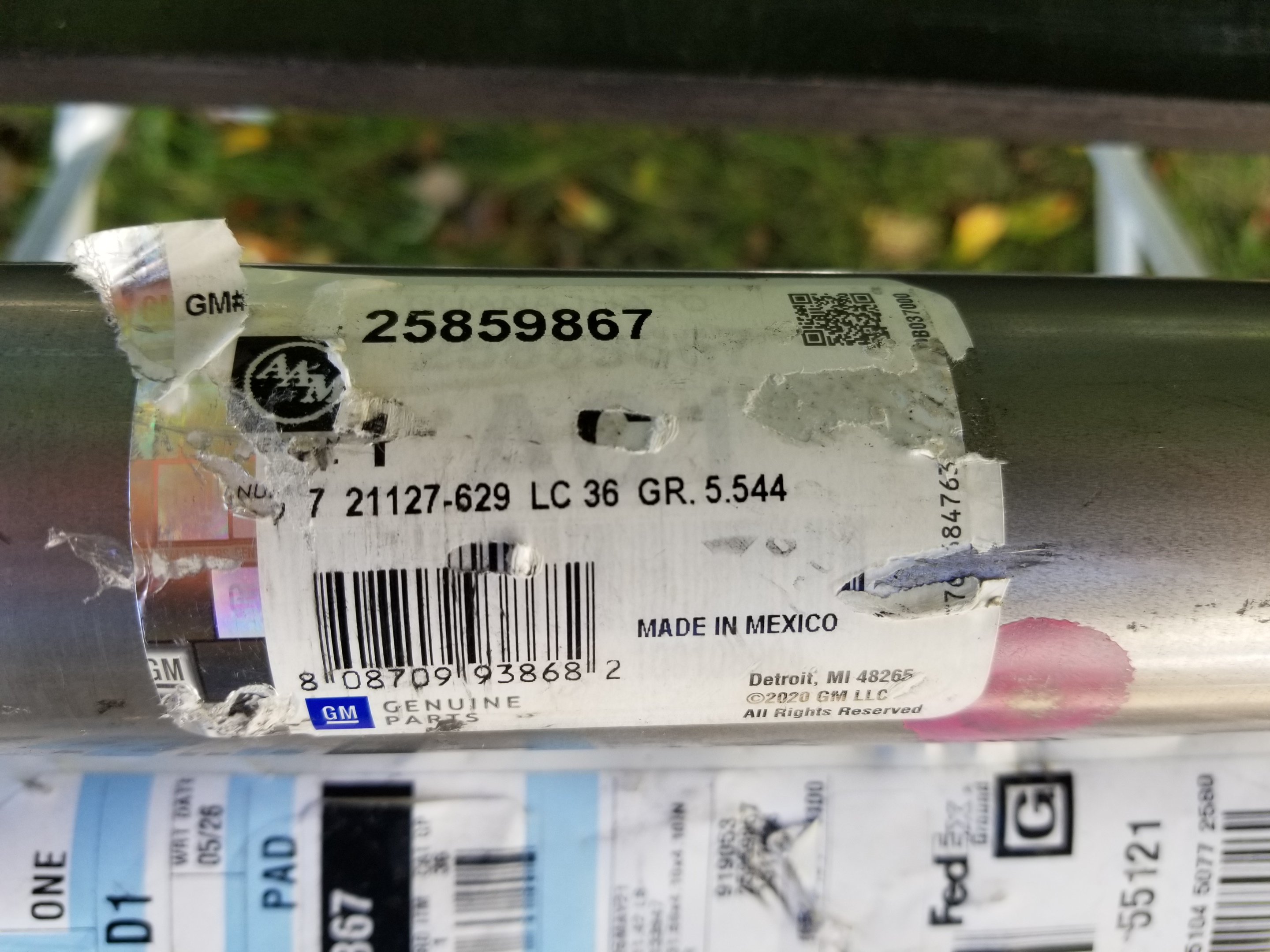

I bought an AC Delco F driveshaft last summer. It's made by AAM (original equipment). There was an AAM sticker under the AC Delco foil sticker. Seems to be good quality. (Rockauto.com). Everything I've read these last about as long or better than most. YMMV. If interested, get one before they discontinue them.
