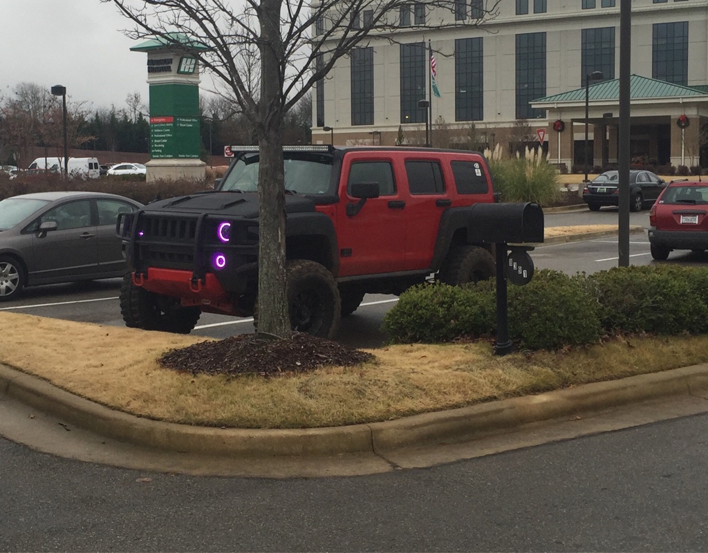

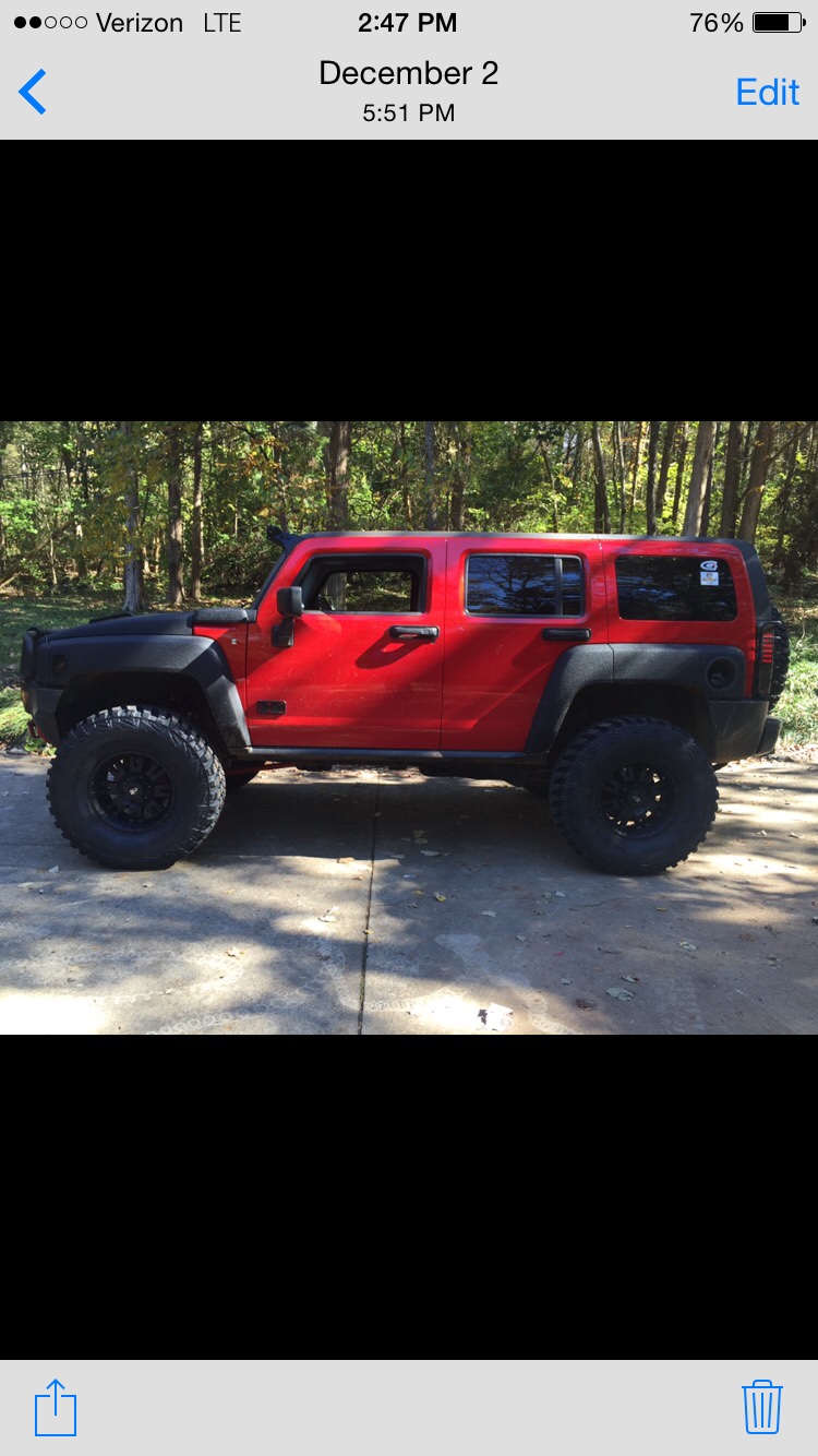

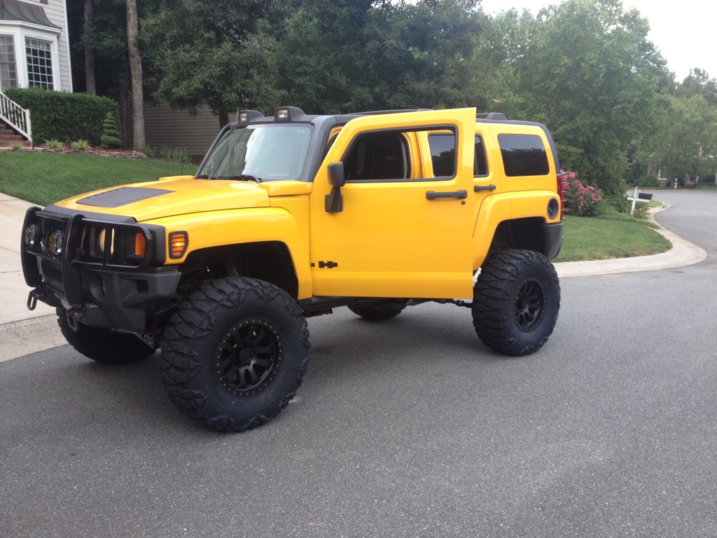

Go 40s!! Only posted pics cause I thought you have h3 and was showing what 37s would look like lol

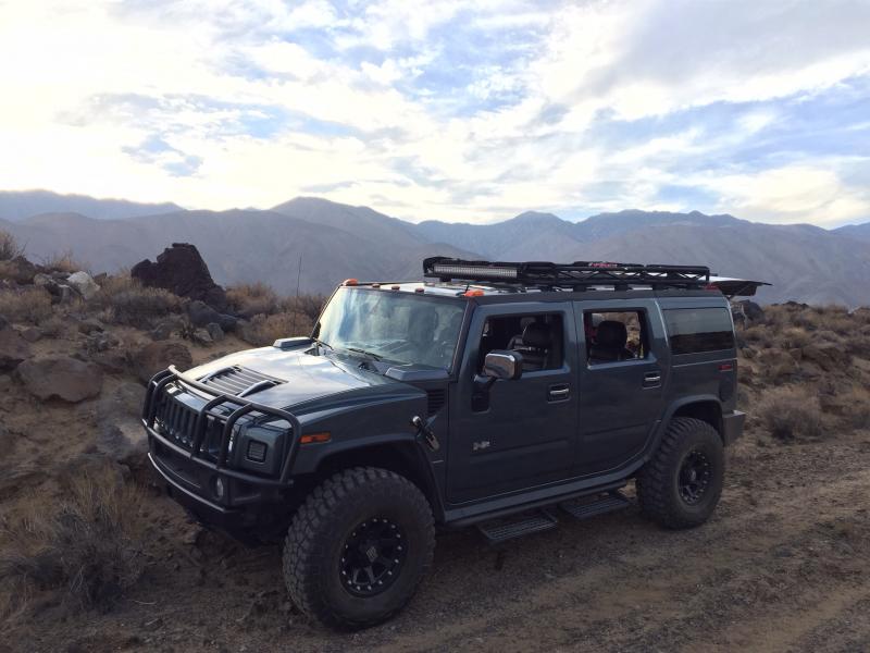

Here are a couple pics with 37's
Scarsman
1,561
Monroe, WA
I was planning on 37 x 12.50 nitto mud grapplers, so I should be fine. Scarsman, have your 37s ever bottomed out the wheel well?
No, I haven't. At absolute full stuff the rear will just barely rub the plastic wheel well liner in a couple spots. But not hard enough to wear. It wipes the dirt off but that's about it. In the front I've never noticed any rubbing at all. I'll try and find a couple pics of mine.
Fish
871
San Diego, CA
Nice looking rig man! Just wondering, where'd you get that grill guard?
I actually scored it on Craigslist for $75, I got it powder coated and it's like brand new. I forget who made it but its a popular supplier, someone here probably knows as they were fairly common but I'm just drawing a blank. Running 37's is not an issue at all, I have a little rub in the front at like 98% turning but that's it. I would definitely go for 37's if you are gonna get new tires. :cheers:
