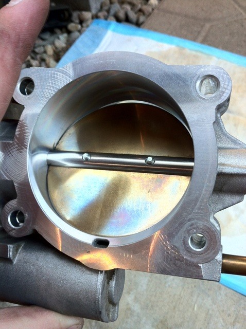

My throttle body was a tad bit dirty:
I think I found the source of the grime. Looks like a lot of oil has been reaching the vapor recovery tube.
I guess the steep hills have caused the engine to inhale a little oil. Maybe I am suffering from the same issue as Alex with the burning oil on extreme climbs. You can see more evidence in the AirDoc:
I spent some time with some cleaner and got it all prettied up. I even sprayed some cleaner on a rag to wipe out the inside of the intake manifold a bit.
After reassembly, I shot some MAF cleaner into the MAF and let it dry. Not to noticeable on the test drive afterwards. The computer was acting weird and kept the engine running at 2500 RPM until I came to a stop. After driving around for about fifteen minutes, the problem went away.

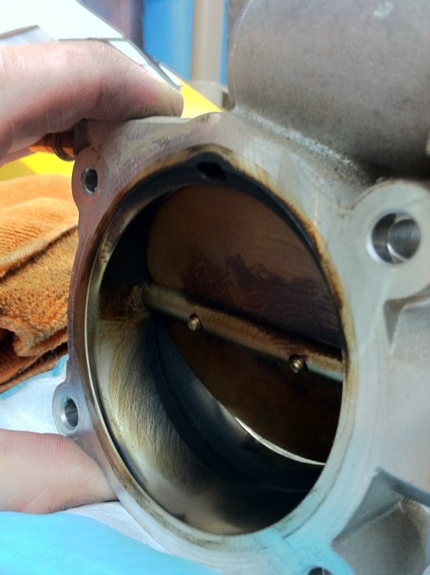

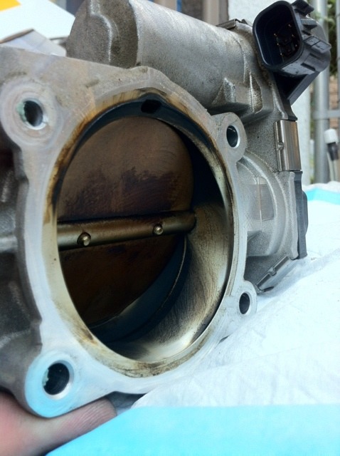

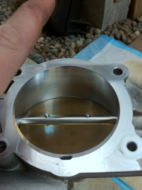

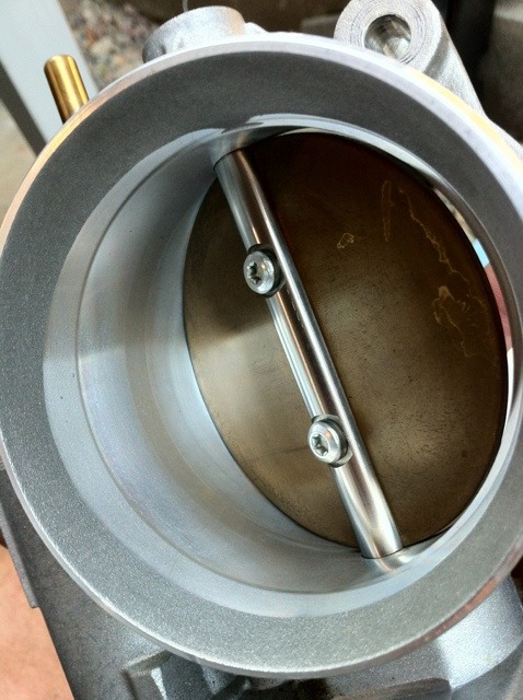

Huge Seat of the Pants difference Chris. Doubt mine was ever cleaned by prior owner(got it used at 26k mi from lease dealer) and just did my cleaning at 43k mi. Here are my pics(before/after). Don't forget to swap out your air filterImageUploadedByTapatalk1349289798.253193.jpgImageUploadedByTapatalk1349289820.307041.jpgImageUploadedByTapatalk1349289839.984539.jpgImageUploadedByTapatalk1349289870.491949.jpgImageUploadedByTapatalk1349289889.755925.jpg
