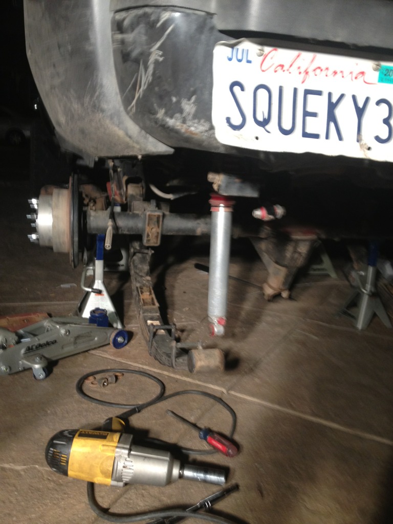

New neighbors in 5 houses of the 13 on my street right now there are about 30 kids running around so I'm making less noise but I'm stopping for the night my friends leaving for school this week and were all going to hang out one last time for the summer axle is ready to be taken out and welded up tomorrow! Hans I haven't forgotten about the deavers...sorry I've not had a chance to pm u yet. ImageUploadedByTapatalk1344141066.400814.jpg

Chopping hangers...They hang up too much on rocks. With the new ones I will gain about 4 inches of clearance!
