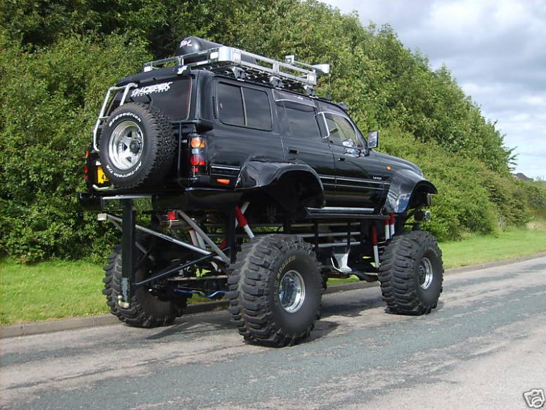

Here's a sneak
.Don't know if i should get bigger tires or a smaller lift:whaa:
