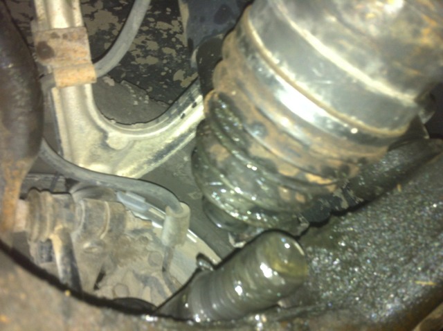

For those of you that were part of the fun at Wipeout Hill this April when I seemed to be doing most everything right, but *BOOM* my half shaft snapped like a twig - I have confirmed the conclusion of some that the part was an inferior aftermarket CV axle assembly. I was convinced I was giving her too much gas / driving with less finesse than needed to make it up (after watching the previous attempt be successful with far more tire spin). This weekend, while not pushing it nearly as hard, I snapped another on the same side. Fortunately I have an honest mechanic that admitted that the part they sourced isn't as good as OEM and it would be fine if all I did was drive to the grocery store and back, but it's not made to stand up to what I do to it (even though they sold it to me knowing what I was going to do to it - which they fortunately also remember and are acknowledging was a poor recommendation). At first I got the "Your SUV isn't supposed to be doing the things you're doing to it" story, but I pointed out that they recommended the part as a replacement for a 'failing' (was starting to pop occasionally) original axle that I wheeled on for 63k mi before being replace with their NAPA part. One month after installation in Moab, I snapped that one. They replaced it under warranty for free. This past Saturday, I snapped the second replacement on a less steep climb, front wheels perfectly straight and no tire spin. My left front is still the original axle and it's still fine after 76kmi of use with scattered wheeling. They checked my front diff mounts, the steering rack, the tie rod and anything else that could be failing or bent to potentially contribute to a repeated failure of the part they're using. There is nothing wrong except another snapped half shaft. Conclusion: I've broken two NAPA axles with what I now realize was not unreasonable driving or climbing in less than 13k mi (over the span of only three wheeling trips, that's two snapped CVs). I'm covered - my mechanic is refunding the original NAPA axle, I already ordered an EMPI replacement and the mechanic is going to install it for free (I'm very impressed with their willingness to be reasonable). The moral of this post is ... don't accept anything less than GM (if you wheel heavily without lockers - even EMPI are weaker). You will regret it and likely end up broken at some point wondering 'what did I do wrong?' to which the answer will be 'You did nothing wrong, you had a weak half shaft'.

Pics? Did the shaft actually snap? (or just the CV-joint).

I just finished fixing myself. Mechanic wasn't going to get to it till next week and I'm getting the boat out tomorrow. My left is still original at 103,000 mi. The right was swapped with the napa part because it was 'making noise' when 'scoped'. It never actually 'failed'. The GM part is very pricey, though.

The shop claims they sourced the EMPI axle from Napa. When I get on Napa's website, I can't find the part, but I saw the actual invoice from the original replacement from my auto mechanic and the part number he sourced is the same as the EMPI. I'm honestly not sure what to think other than keep my trail spare handy and be sure to have my newly purchased Milwaukee Cordless Impact and appropriate impact sockets and be ready to swap when you hear a snap. All I know is I used to not have this issue with the stock GM axle - either that or I have hit the limit of what my rig is capable of.
