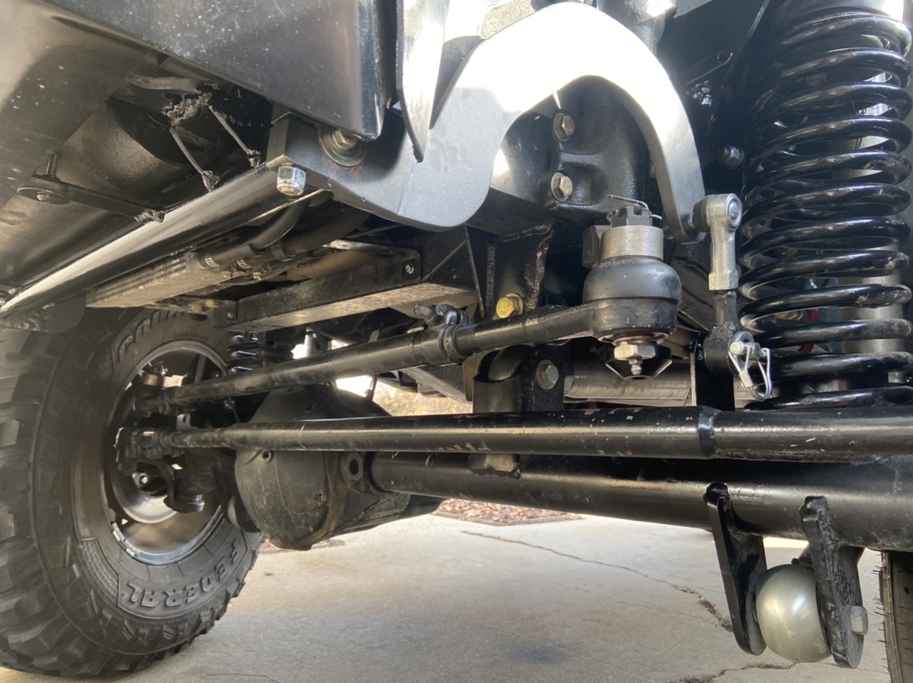

Unconventional looking but I modified a universal Currie sway bar kit with some 1/2” thick arms that should clear up travel to bottomed out bump stops and 6” droop for on-road use and swing out of the way for trails. Still have to fab up the disconnect link and axle side bracket for the passenger side before I’m able to test but I’m excited and hope this changes the road manners a bit. Next is a new drag link with the pitman arm from 4 Speed that could eliminate impact points completely. A work in progress.

genius idea on the sway bar, did you make that?
Thanks, coming from someone like you who’s seen so much, that means a lot. I mocked it up with different wire and cardboard templates until I was comfortable enough to go for it. I used the spline section off the universal Currie/Rock Jock kit welded to my patterns I cut out of 1/2” plate with an eBay special plasma cutter. I put a slight bend in it to clear the steering box with a modified Harbor Freight 20T press brake. I may make some changes to get the links more vertical. Weather and work permitting, I hope to get a road test in the next week or two.

[FONT=&amp]I used Currie CE-9906-21. It’s 50” kit which seems to be the perfect width.[/FONT]
I've finished the install and put some miles on the setup. Having no experience with anti-rock sway bars, I don’t know exactly what kind of performance to expect, but I’d say I have about 50% of the factory stability back which is not what I hoped for but I’ll take it. If I went back to the drawing board I’d extend the arms a bit and design home location for longer links. Part of my issue could be coil spring choice. We used Pro Comp 55617 springs for a JK which aren’t a great match for the weight of the V8, let alone the weight of the THORPARTS bumper and steel cable winch. I’ve got a set of coil springs for a Bronco that 4-speed recommend (shoulda listened) that I may put on that’ll require some mounting modifications to fit. I’m also looking into some Toyota 80 series springs that l think could work with no mods. Identifying what size of those has me nervous on pulling the trigger on any.

In the 50” kit is the torsion bar actually 50” long? That would put it too close to tires when turning. Looks like 40” would be perfect length.

You are right, sorry. I just spit out numbers off the original link that I used but I just measured and I went with the 36"option.

I've gotten a lot more seat time with the front sway bar setup and notice it plenty as I hit familiar turns. I'll probably leave it as is unless I have the sway bar flip on me because the short links. I don't see that happening under normal road conditions but I'll redesign for longer links if it does.
