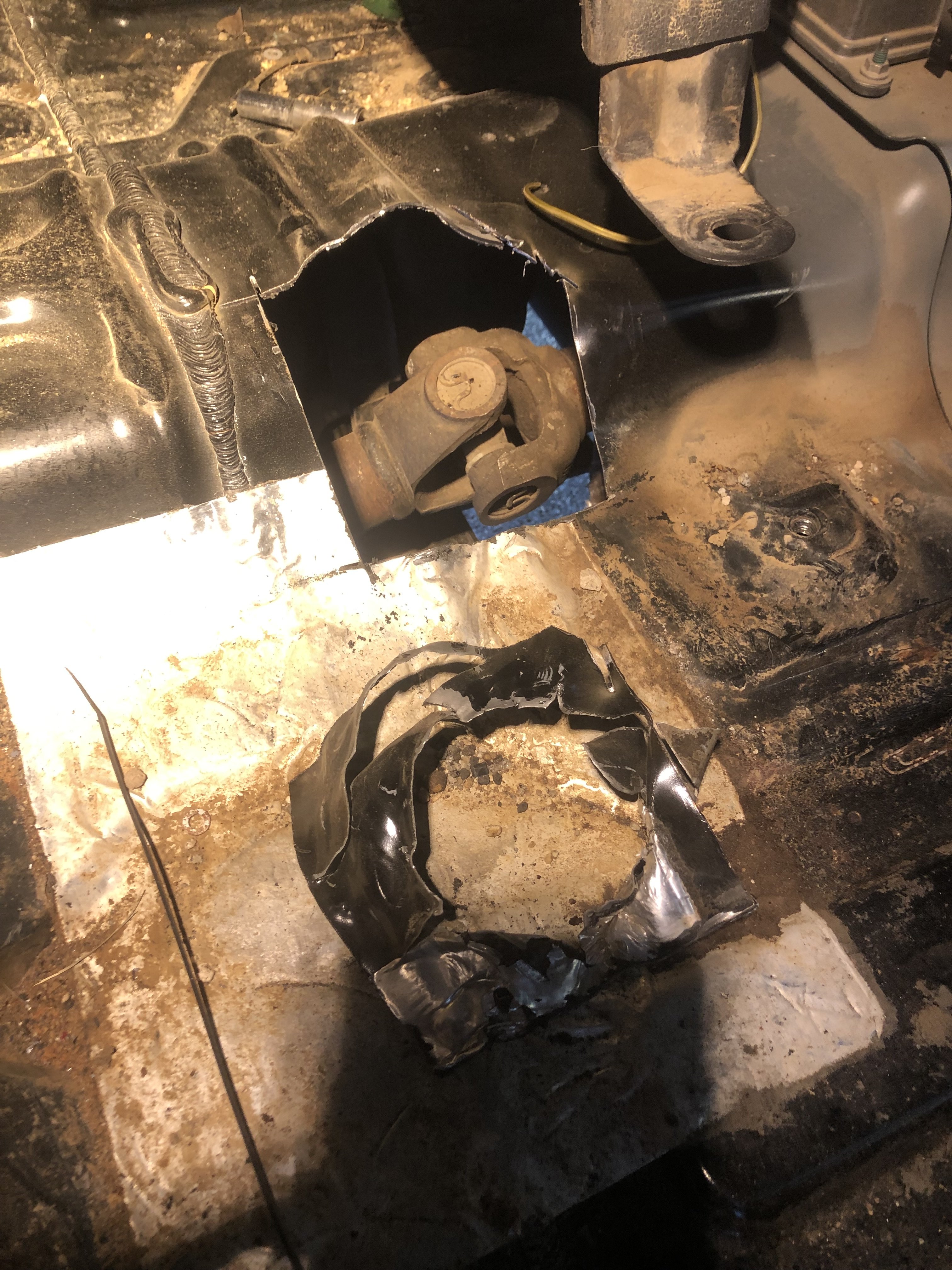

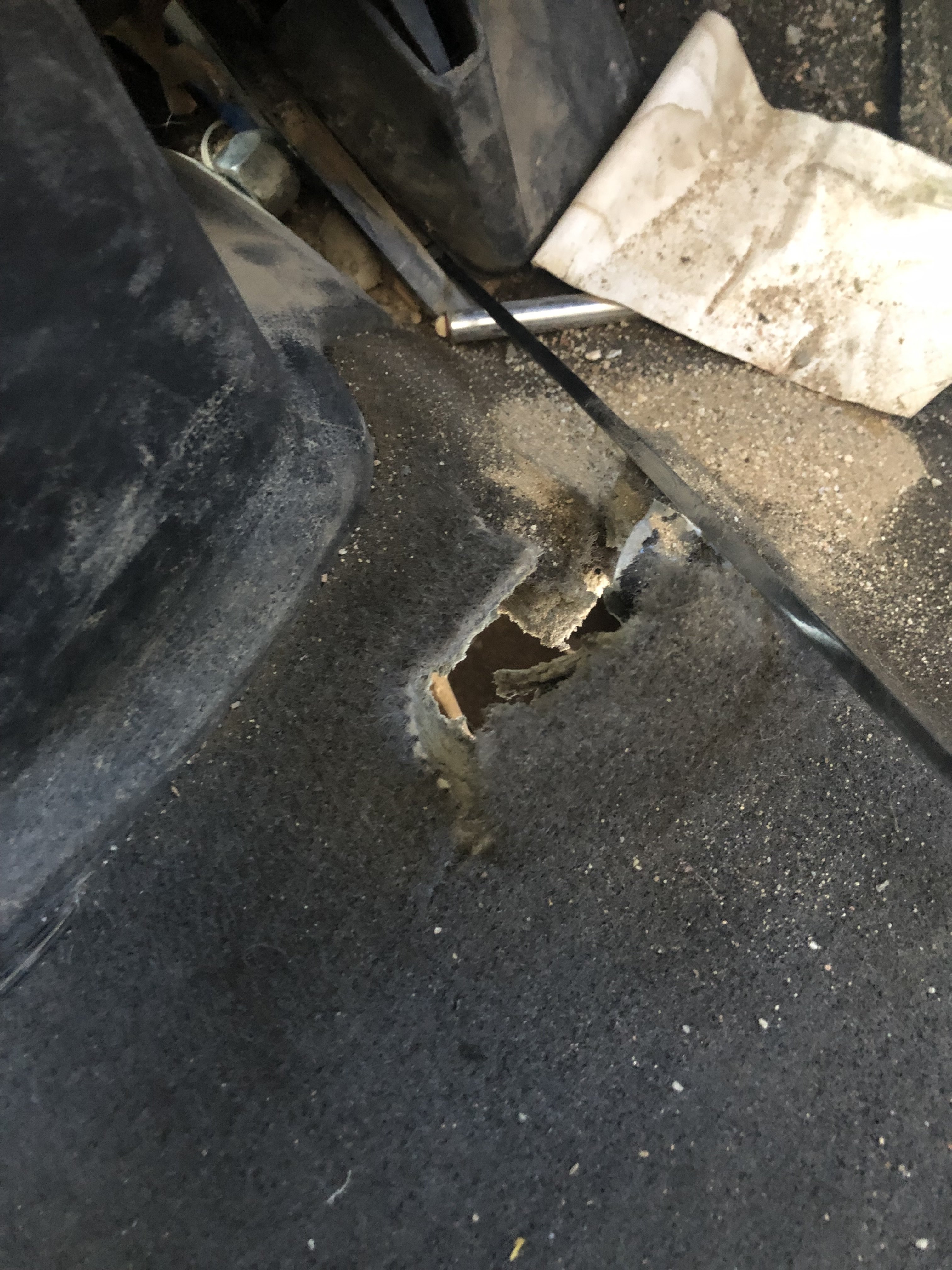

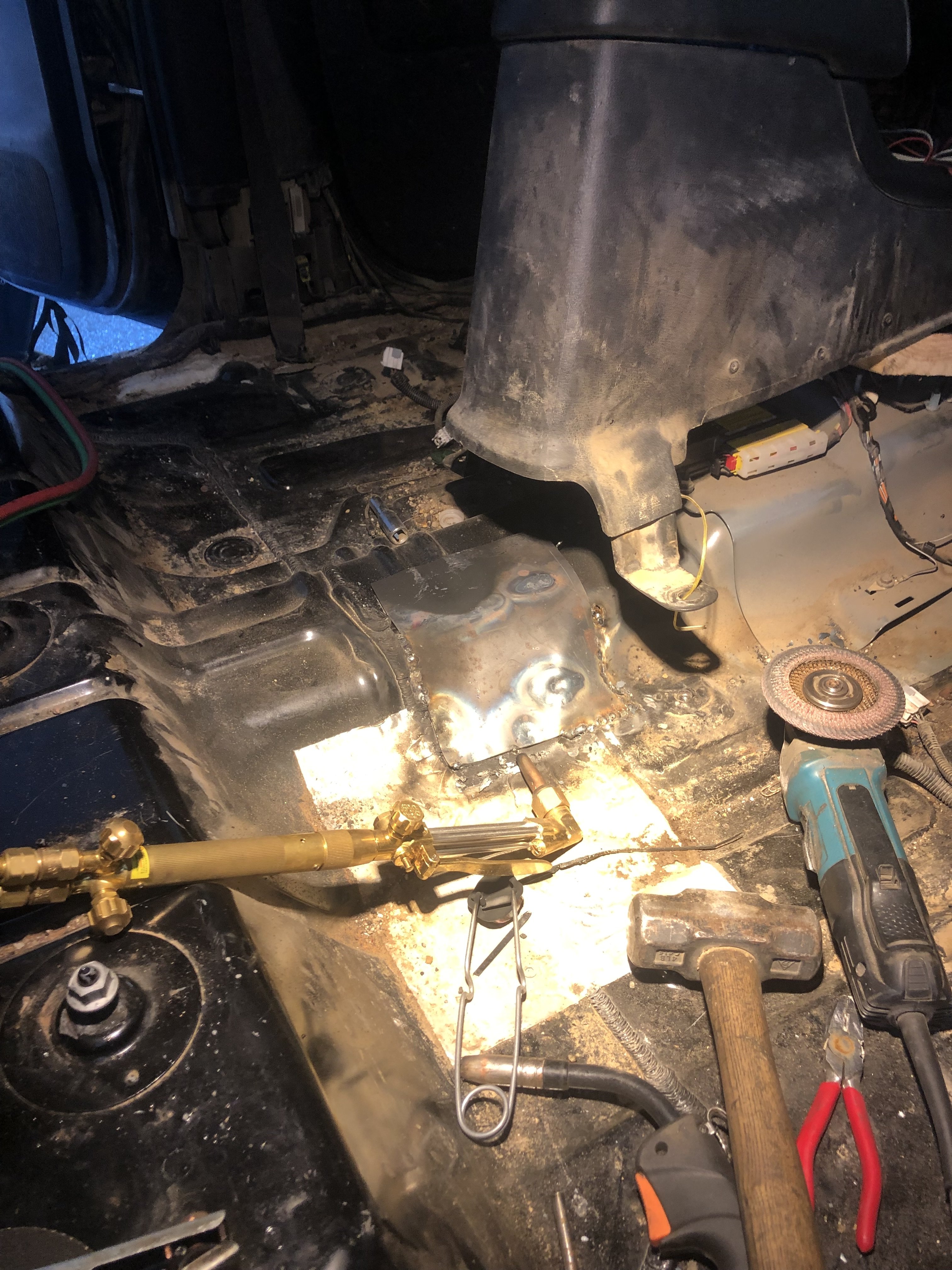

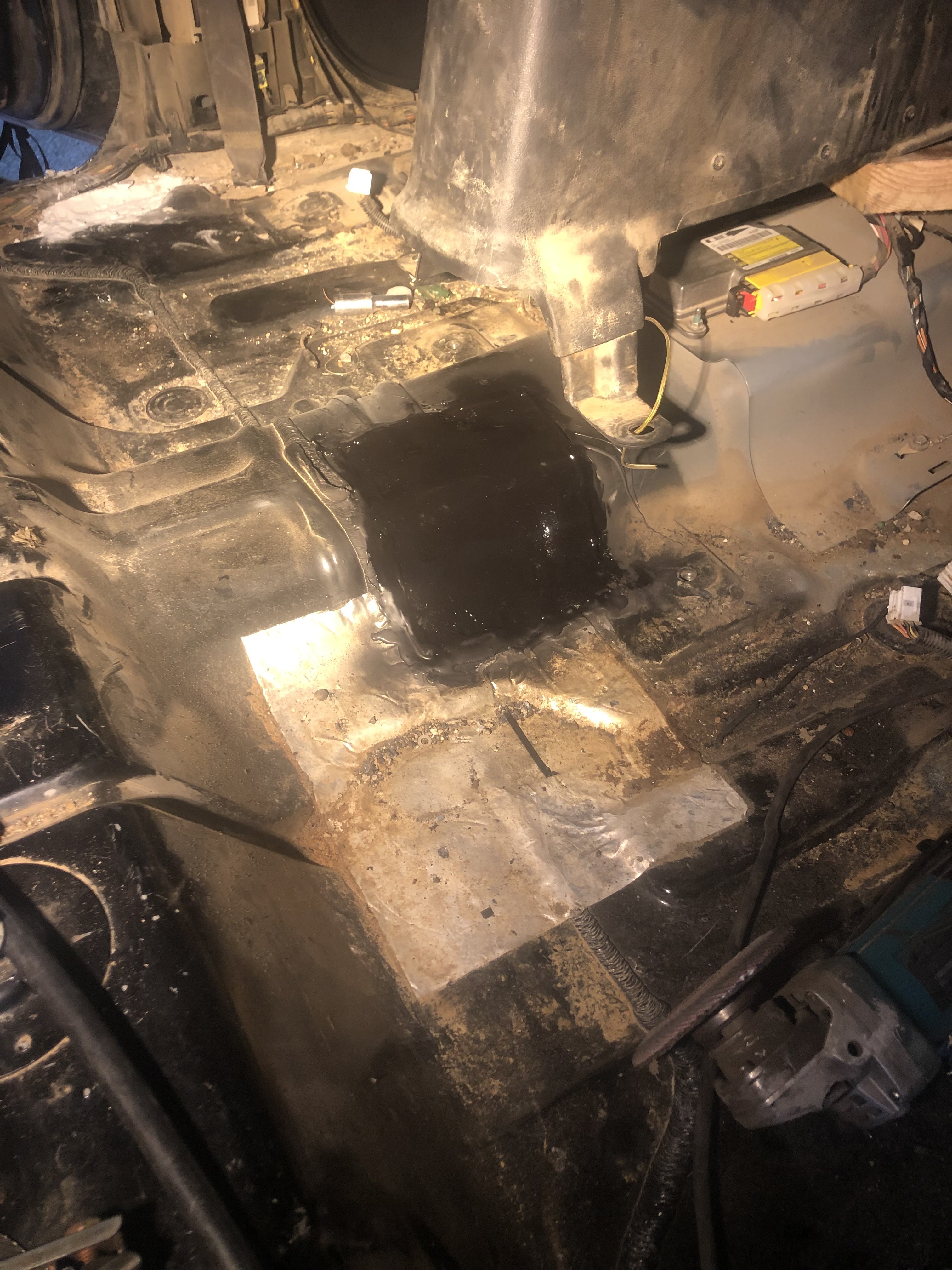

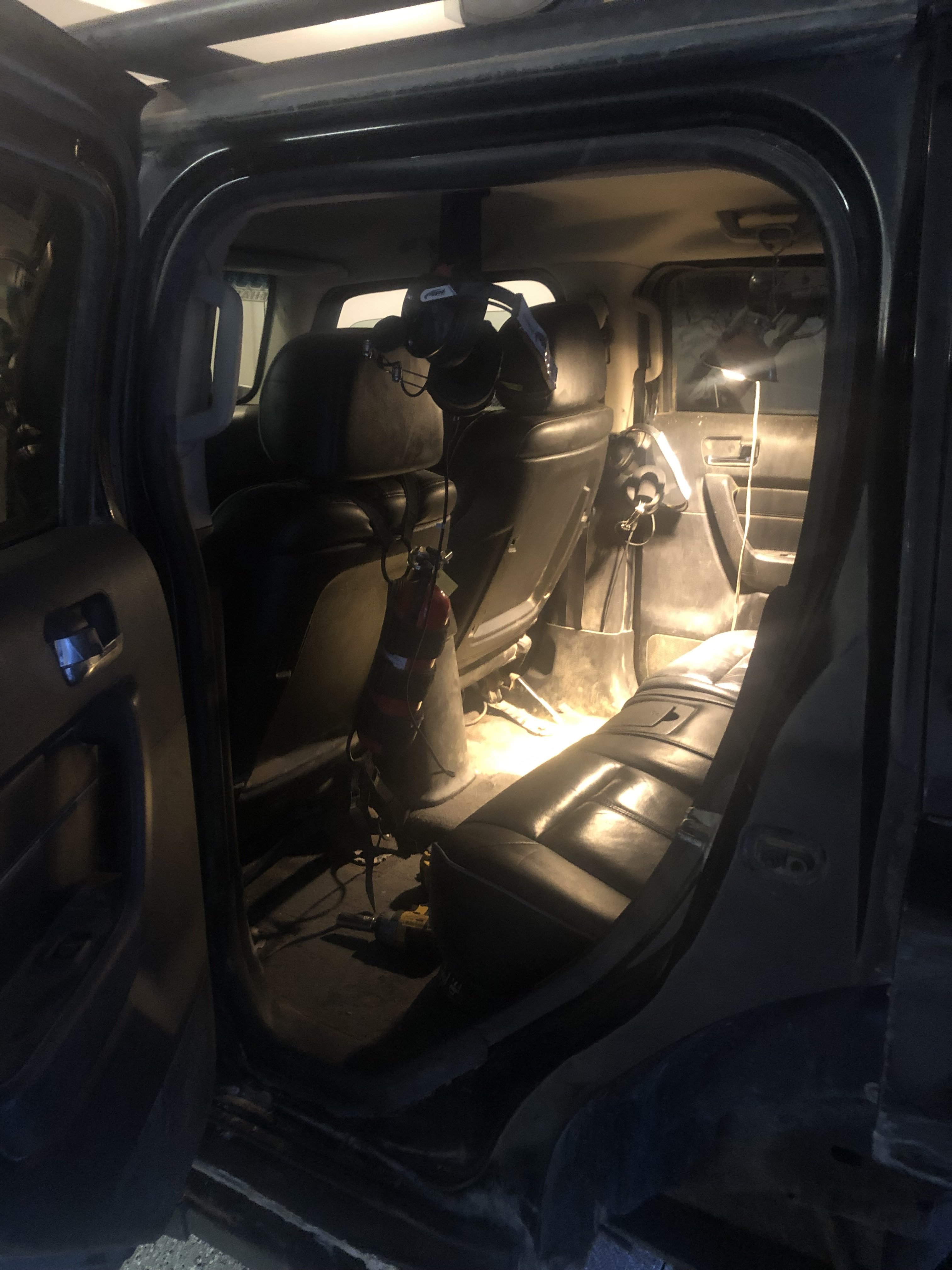

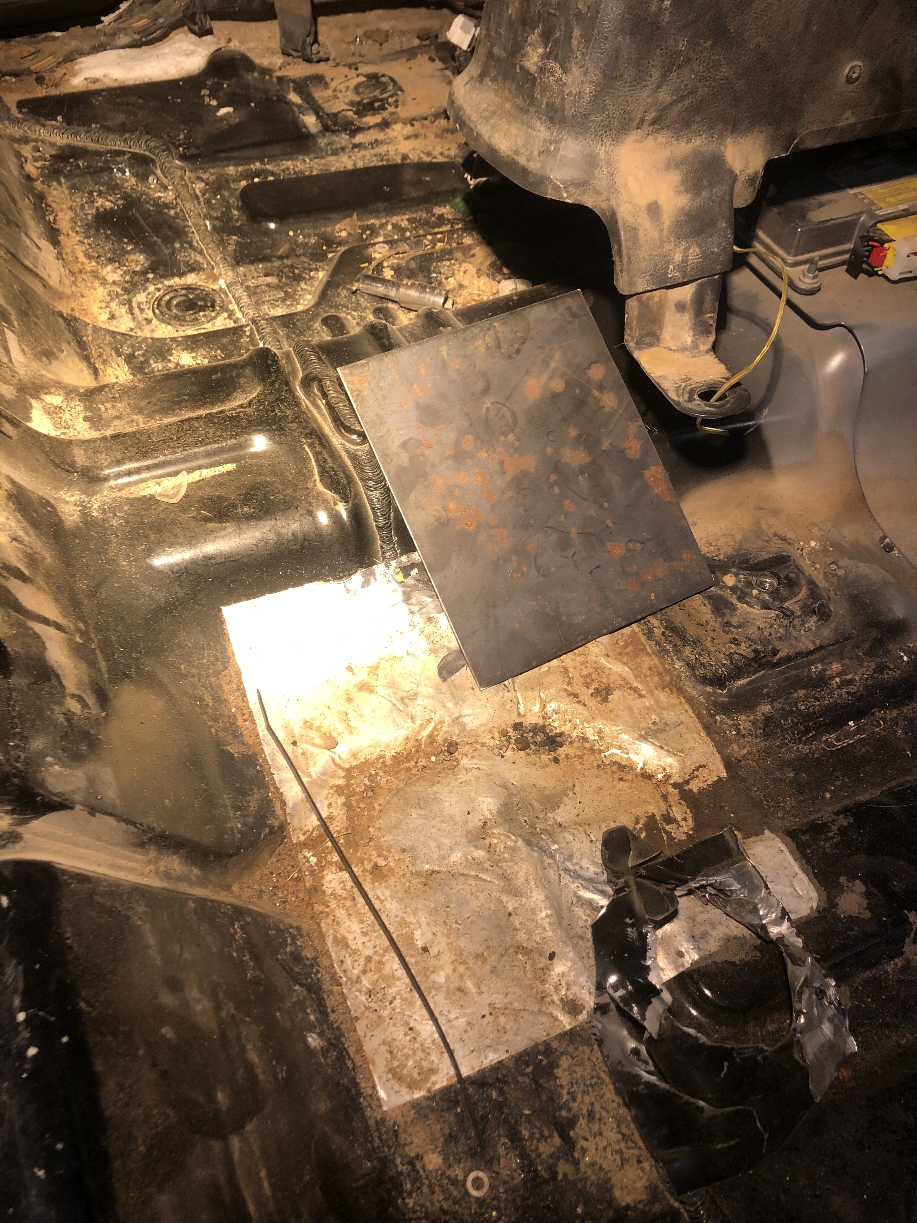

Here’s an example of when my rear, t case end, u joint let go.
Good as new, put seam sealer around the edges inside and outside
View attachment 32994View attachment 32995View attachment 32996View attachment 32997 View attachment 32998

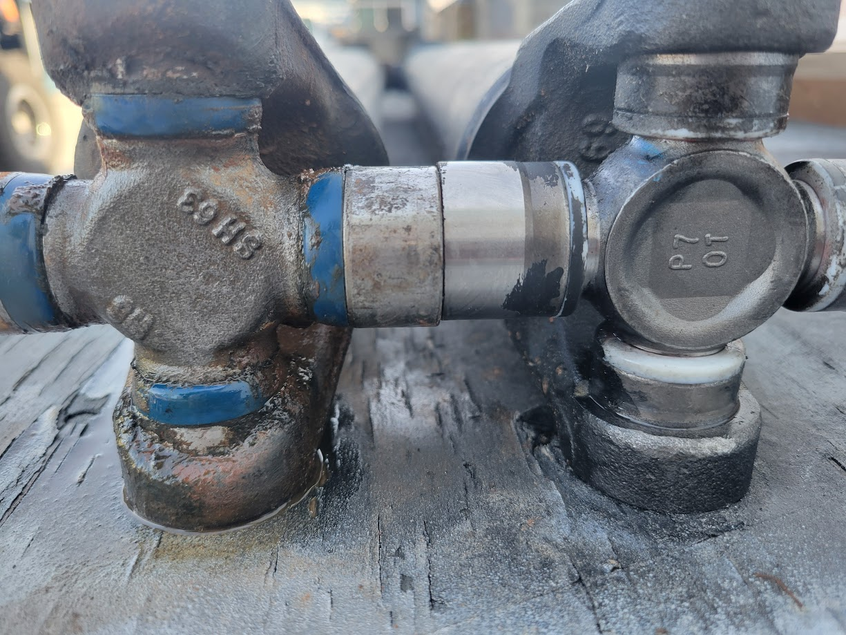

Got the new Fort Wayne drive shaft in. U joints definitely look beefier, picture doesn't really show it but they are heftier. Will replace the old shaft joints with the new greaseless type. Shaft is about a half inch shorter than stock but it shouldn't be a problem, plenty of yoke still in the case.

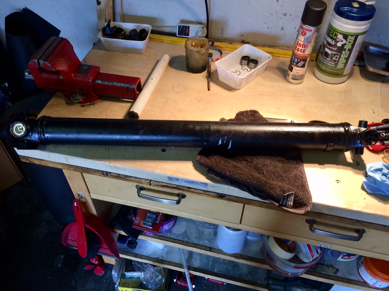

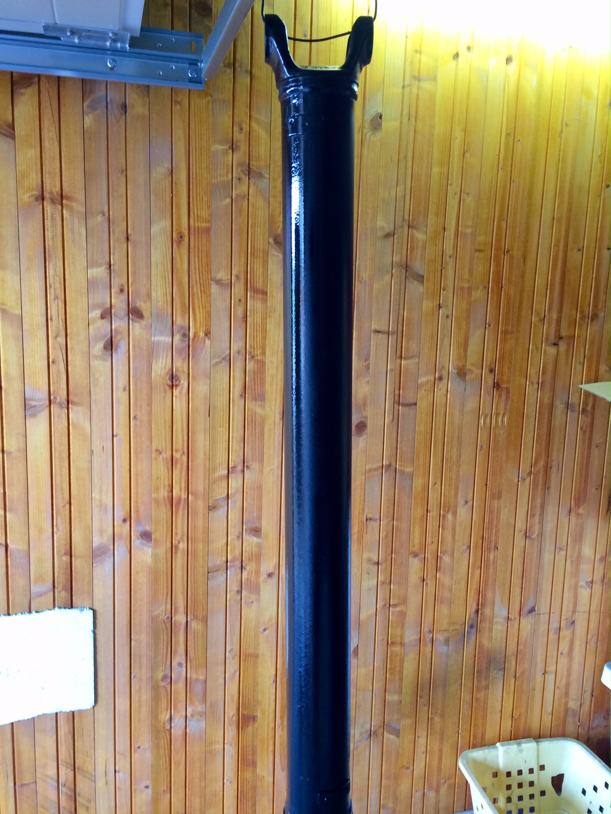

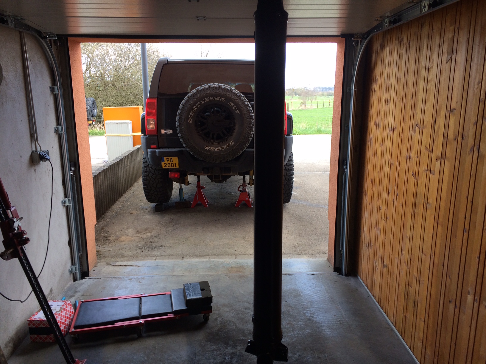

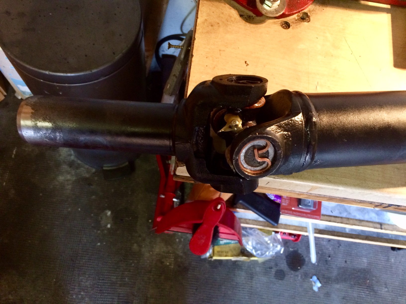

I refreched mine, put a new DANA Uni in and repaint it a moment ago. DANA U joints are greaseable and tuff!
