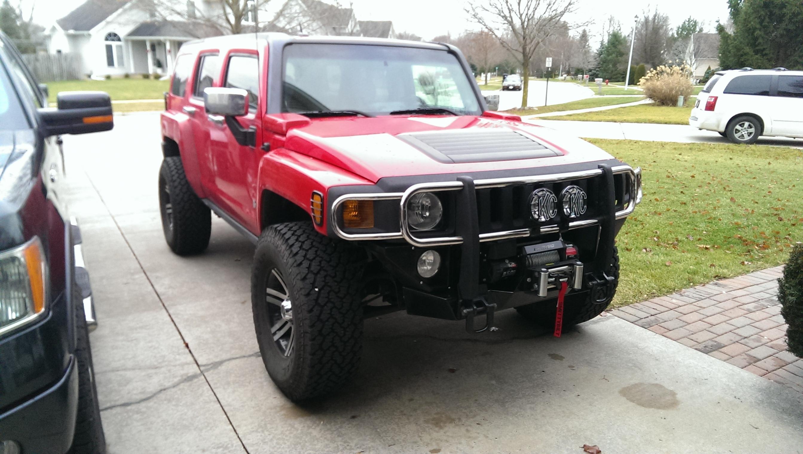

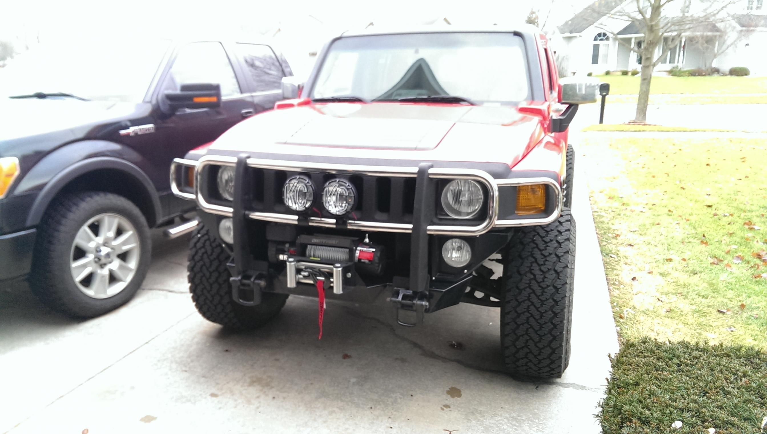

Thanks RamRod, looks good but was a nightmare getting in... Have to make a new bracket for the control box because my grille blocks the controller plug in... Gunna be angled forward slightly... But still looks good even now. :)

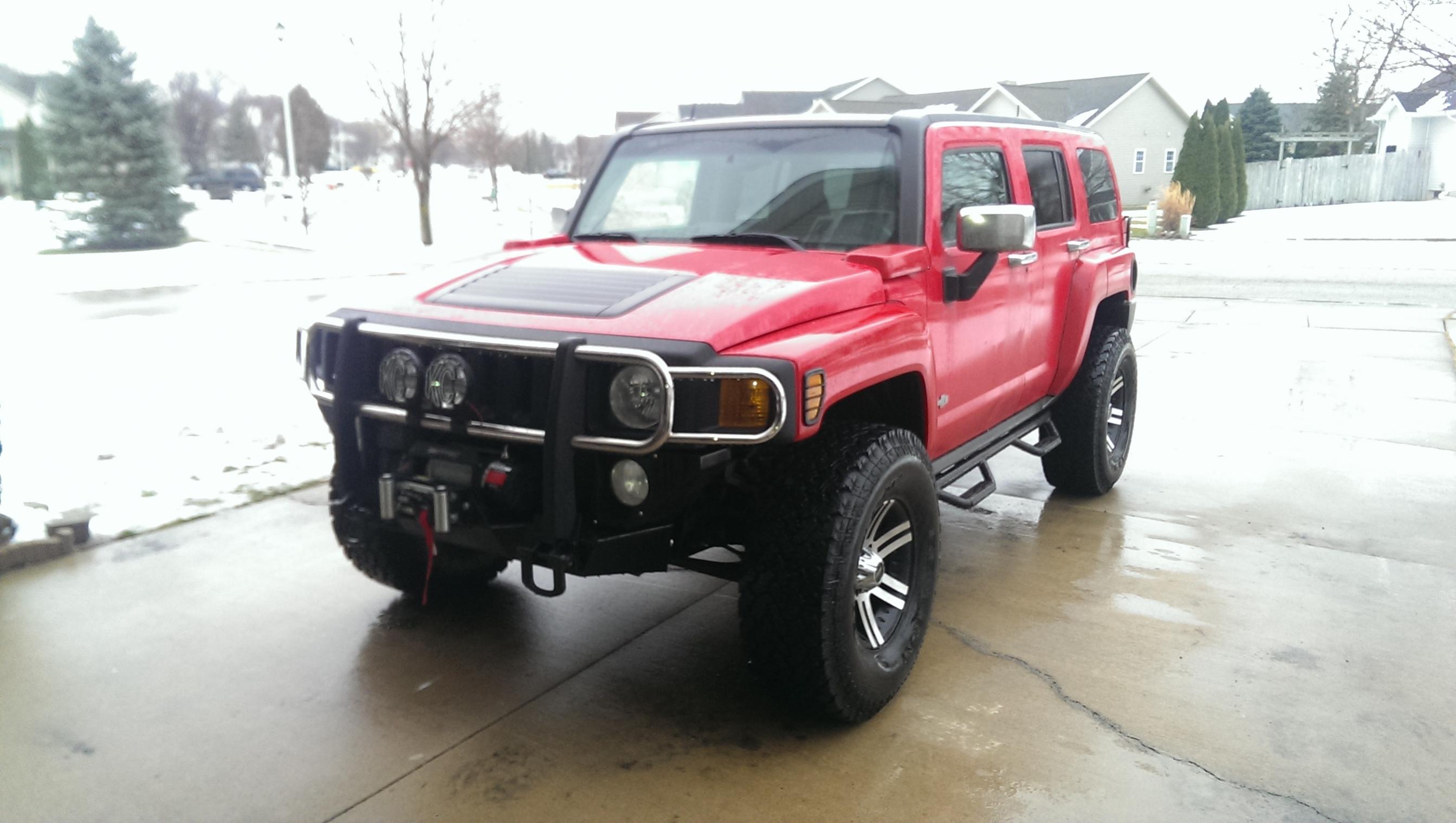

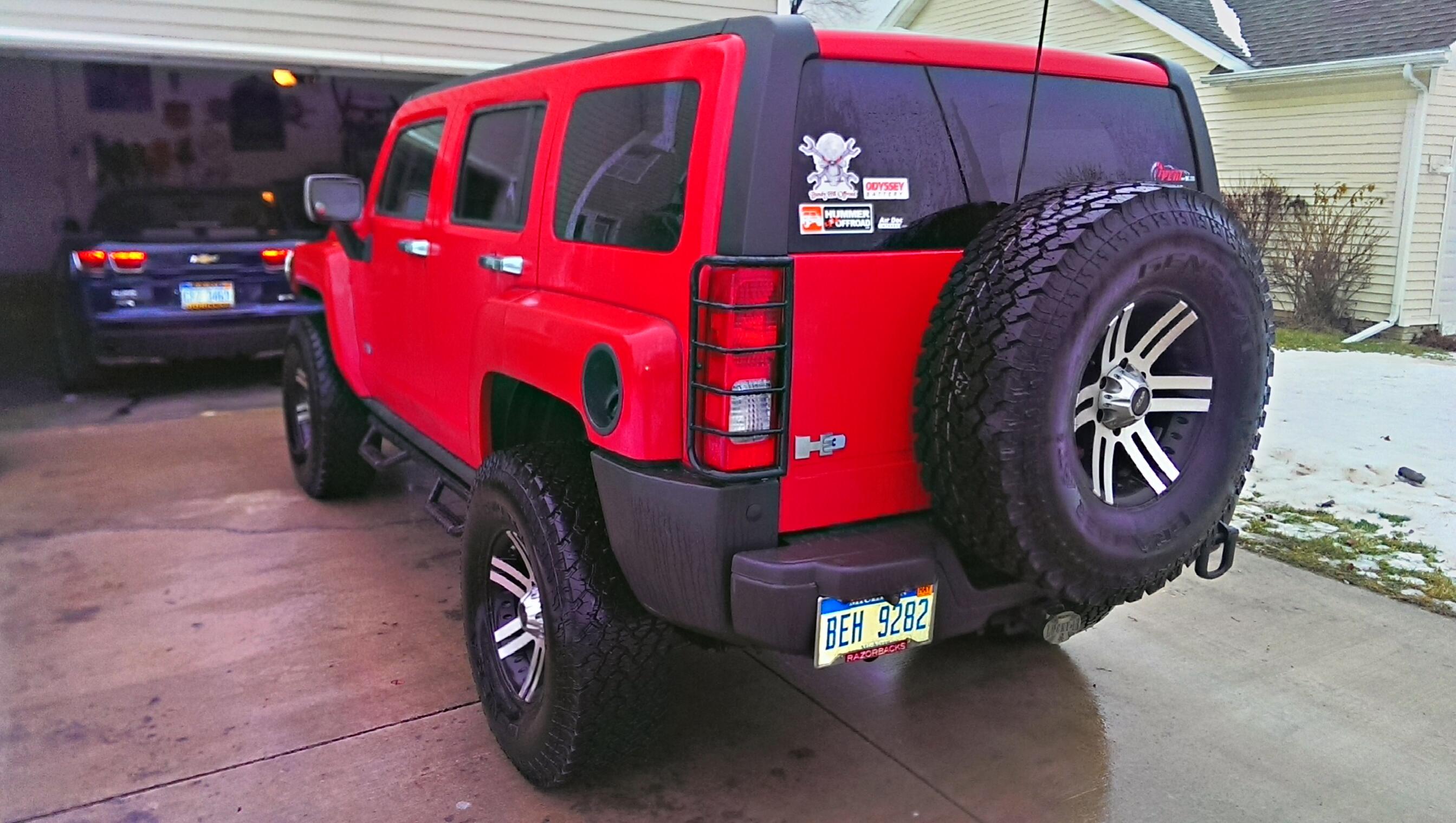

Got some N-Fab Wheel to Wheel step bars "installed"... Was tired of ripping my pants every time I'd go to climb/jump in.
A quick review of these things... THEY SUCK... Quality and looks are good but the fitment is the worst I've ever seen. (Kinda like a one size fits all GM vehicles thing) Had to force the holes to line up... Unbolt the brake clip thing by the rear driver's tire and jimmy rig it around the rest of the brake line just to get it close enough to the bolt holes... And it still doesn't fit, rubs and squeaks soo badly that the radio turned all the way up doesn't drown out the sound... But they do look good... Guess what I'm trying to say, DO NOT BUY THESE FOR THE LOVE OF ALL THINGS HOLEY AND HUMMER... (I know guys, rock sliders are the way to go or nothing at all but I couldn't afford them nor the cost of a pair of jeans every time I go for a drive haha, plus I don't really have plans to go through boulders like at Moab... I'm more of a basketball sized rock crawler. :giggle:)

Also are the bolt holes/ brake line placement on the 2009-2010 H3's different in some way? Because I went to a bunch of different site, trying to find instruction to see what I missed since I didn't get any in the box, and read that these only fit those years... I didn't think that GM changed anything about the bolt holes where the steps go or the brake line location?

I feel you... ruined my khakis. How thick are they and what are they made out of?
Hey Derian, yeah, and now even with em' on I still step up higher... Guess I got soo used to jumping/high stepping that it's weird using a step? They won't stop a boulder too well but for the wheeling and prius crawling I do, they will protect some... They are a bit thicker than the tin foil steps we all got from GM... And their stainless steel (I think, steel something) with your choice of textured black or in my case, Gloss black (Didn't get a choice) But I think that I've figured out part of the problem, the driver's side mounting brackets are rubbing my brake line plus the brackets on both sides are coming into contact with the body just under/behind the plastic rocker panel, soo I'm gunna have to drill or cut some holes in the mounting brackets to give the brake line some wiggle room... Then maybe I won't have to hear soo much creaking and groaning...
And you could justify a body lift now to solve the rocker panel rubbing!
Haha, yeah... if I had the courage to put one on... not sure how difficult that would be though... does that lift everything up except the frame?
If it lifts the frame it would be called a suspension lift. But yes, it lifts everything except the frame and whatever is sitting/attached to it (engine trans suspension...)
