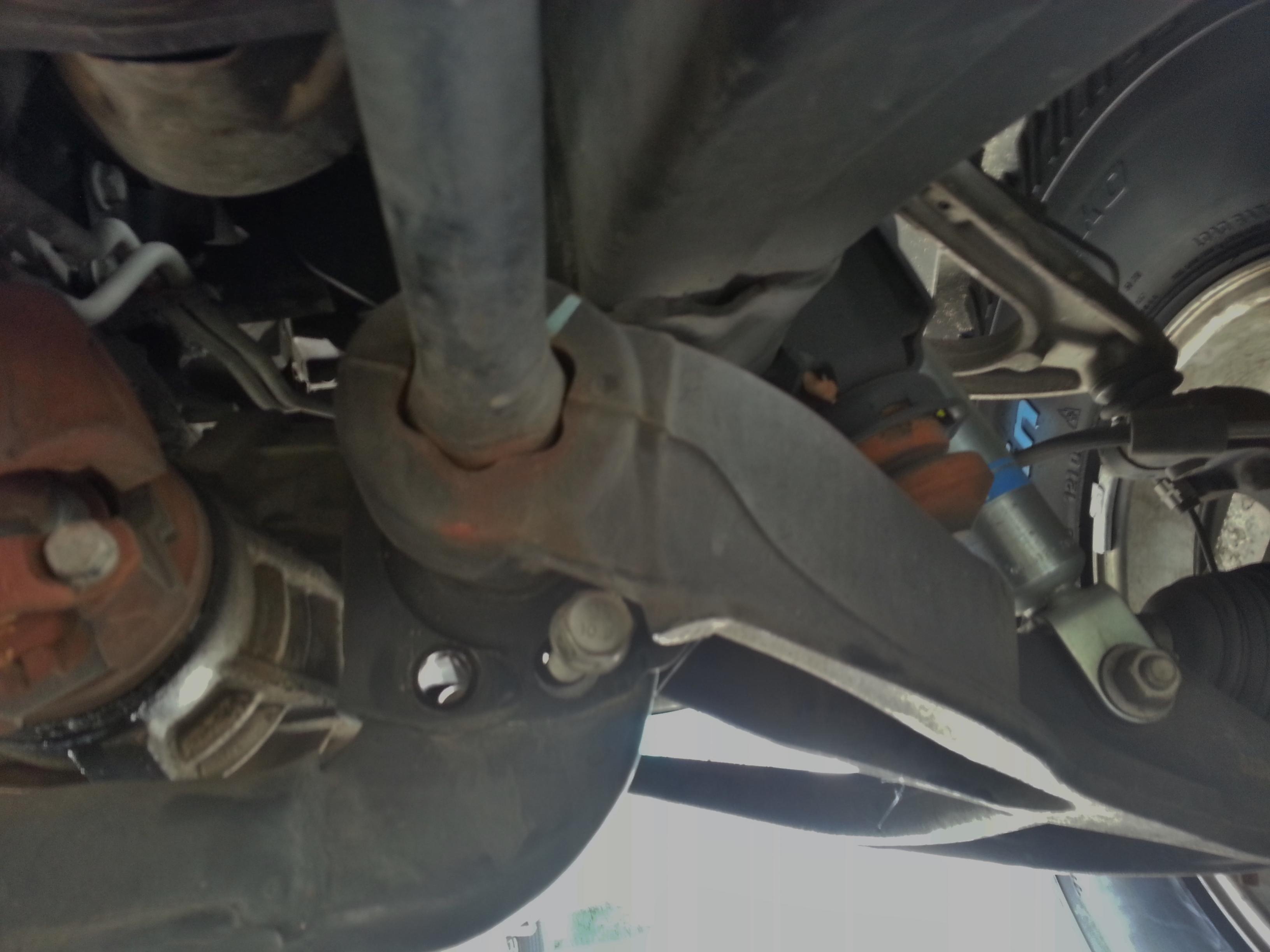

Some pictures before I turned a wrench. Mine was bad but not as bad as others.
My first problem, and only problem, was the passenger side outside bolt hits the A arm and would not slide out. I used my bottle jack to raise the A arm and the bolt slide right out.

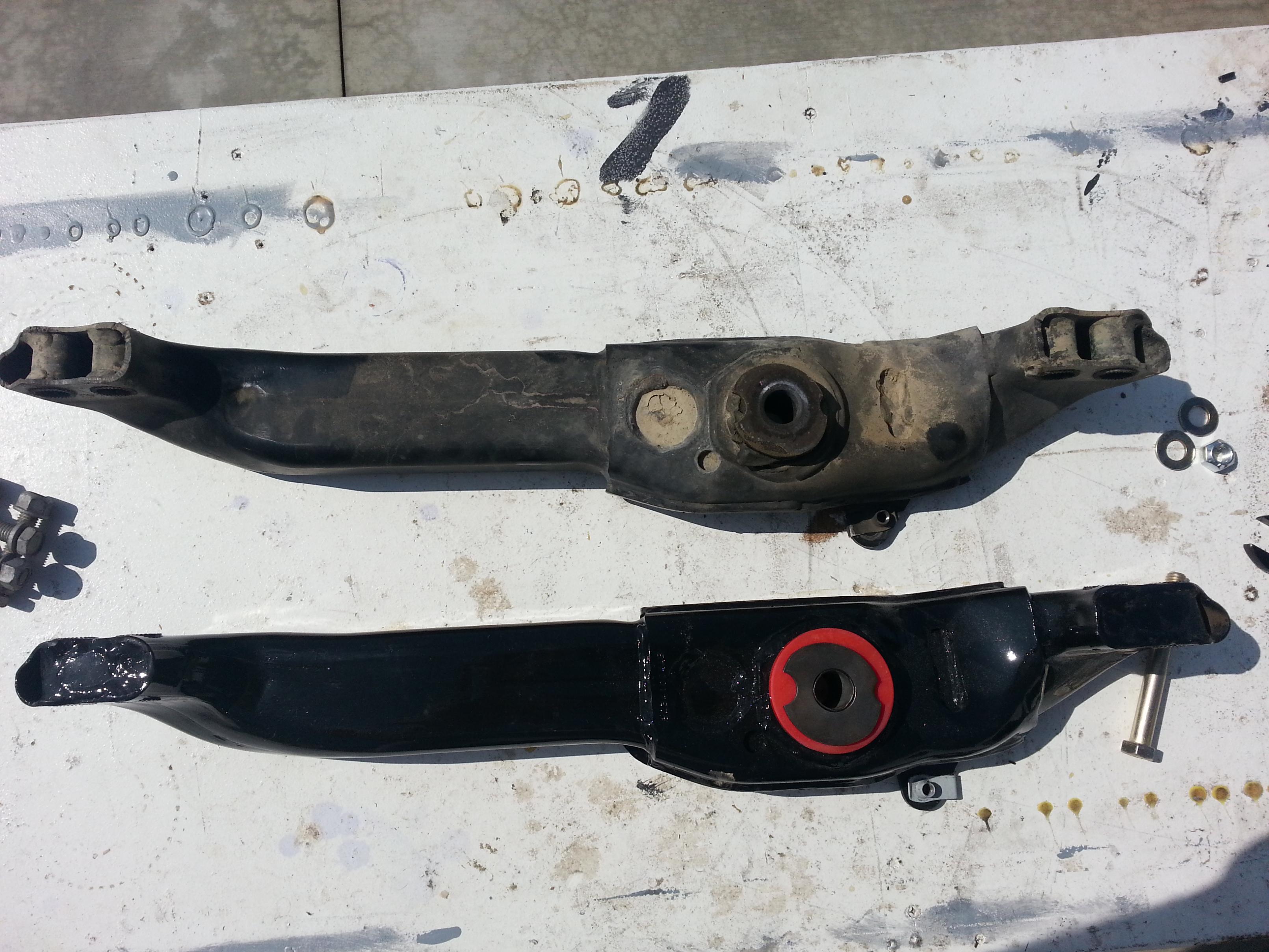

Side by side comparison. Old and abused next to New and improved.
Re-installation was a snap, used the bottle jack to help push it into place and the rubber mallet to tap it in.
After all was done, I drove it around the block a few times and the noise was gone. Nice and smooth.

Thanks for the pics and recap! Glad you used the new Grade 8 mounting bolt. The existing one, when reused, has backed out on some owners (bolt was torqued out, one and done?) which resulted in the bolt breaking, the diff flopping around an inconvenient situation (tow truck ride). The four side bolts get reused as they don't see quite the same stress. I think I reversed the direction of my side bolts because of that clearance situation, or because I forgot which way they had started.

The bolt went back in with no lifting of the a arm needed. If I worked it a little more it probably would have come out with using the jack but since I already had it there I decided to not take a chance and ruin the threads.
