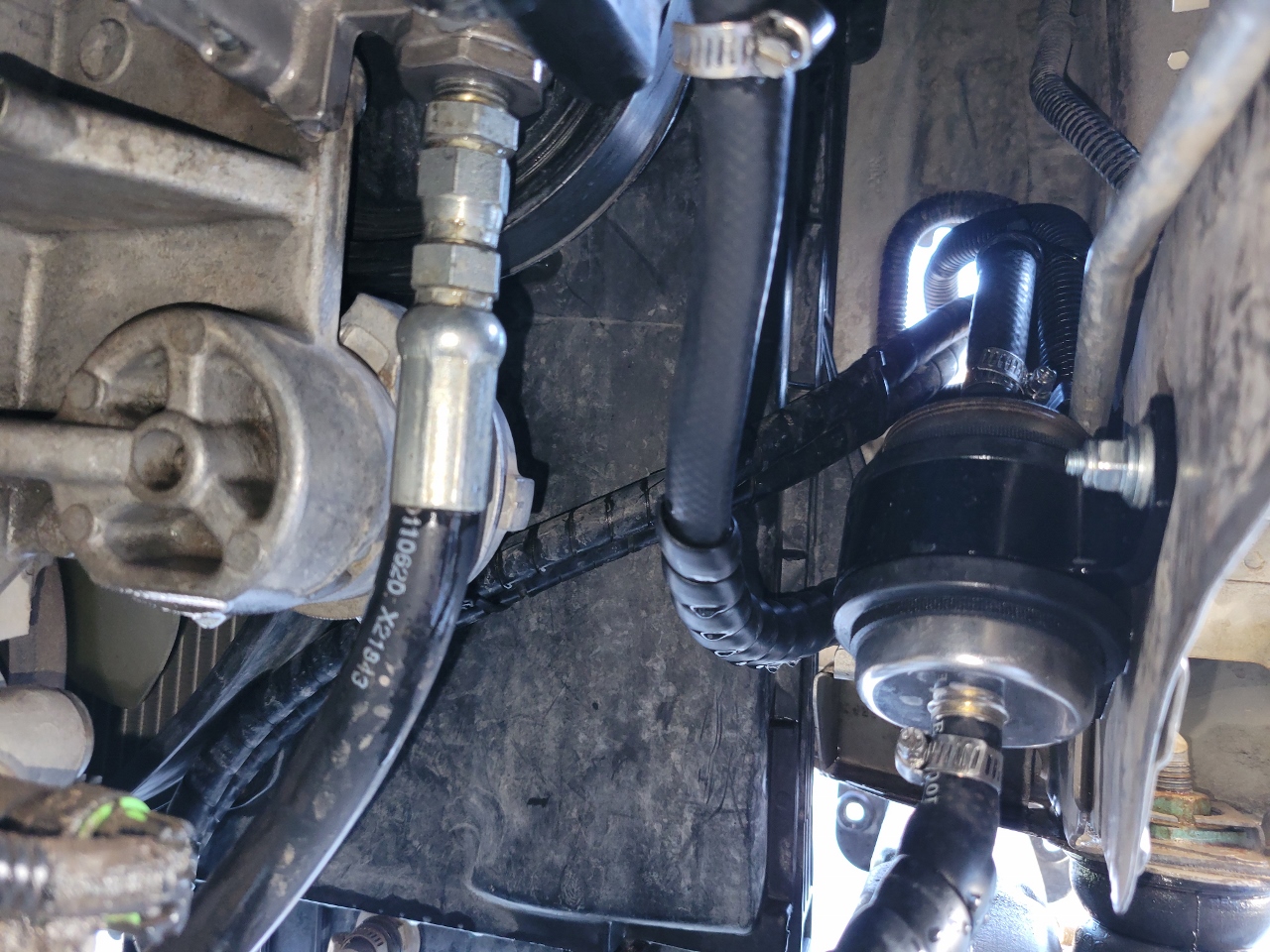

Installed new upgraded power steering pump. Shop cleaned up the vane cavity for more flow and a few more PSI. Had to modify the new cooler a bit, at full compression on the passenger side, the drag link was just hitting the fins. Added a filter that has an internal magnet and some new hose. GM was nice enough to have 2 holes that perfectly aligned with the filter clamp.

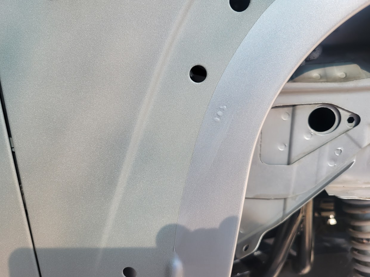

Decided to strip all the trim off the H3 and finish my "paint" job, dessert pinstriping was getting bad and clear coat was starting to flake off. 3 years ago I sprayed the roof and hood, the clear coat was pealing off and looked horrible, typical GM problem. The roof and hood have held up really good for 3 years so now was a good time to finish. The Raptor Liner came out great, I'm 9 out of 10 happy with the results. Was hoping for a bit more of smoother finish but it should get better after a few washings or a 3000 grit wet sand.
The best part of painting anything is prep work. Took longer to do first round of tape than to spray.

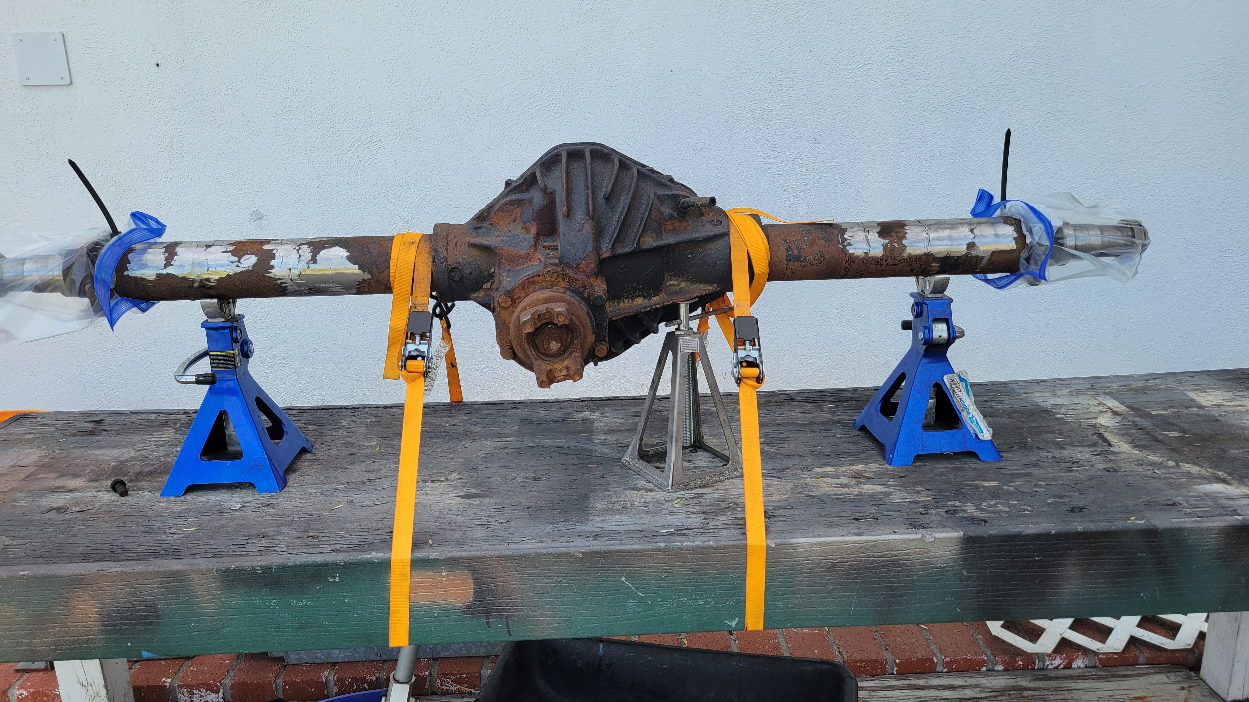

Broke a rear axle for the first time trying to pull someone out. It was enough for the stars to align, and I bought a 14 bolt. Found a 1999 2500 Silverado FF for $200. Looking for some input from the few that have already gone down this rabbit hole, here is a list of what I have already bought, then a list of what I think I need. Looking for ideas and input, good, bad, and ugly. Need to make it quick and simple for a Rubicon trip this summer for a special occasion. Will add E brake and ABS later. Conner and Chris have already made recommendations, and a truss and anti-wrap will be down the road. All OEM mounts have already been removed, waiting for Barnes parts to arrive. Last picture is proof I did some of the work myself. Big props to my son Derek for doing most of the cutting and cleaning.
Parts already bought:
Yukon Parts
R&PYG GM14T-538T
YokeYY GM14T-1410U
Master Overhaul KitYK GM14T-C
Diff CoverYHCC-GM14T-S
Grizzley LockerYGLGM14T-30
U Joint 1410-1350YUJ1435
Spicer U BoltYY UB-004
Parts I'm thinking about:
Lugnut 4X4 Disc Conversion
BYO w/E-Brake
Barnes 4WD
U Bolt EliminatorB4W0066K
Pinion GaurdB4WK1004H
Shock TabsB4W25026P

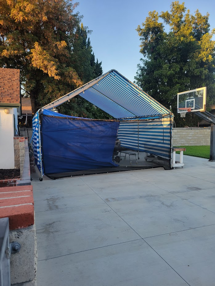

Makeshift paint booth.

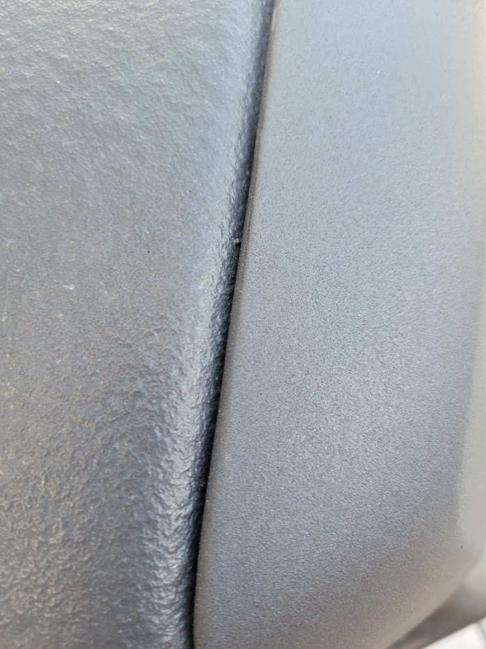

Comparing the new Raptor with the old paint.
Comparing old Line-X to new Raptor.
