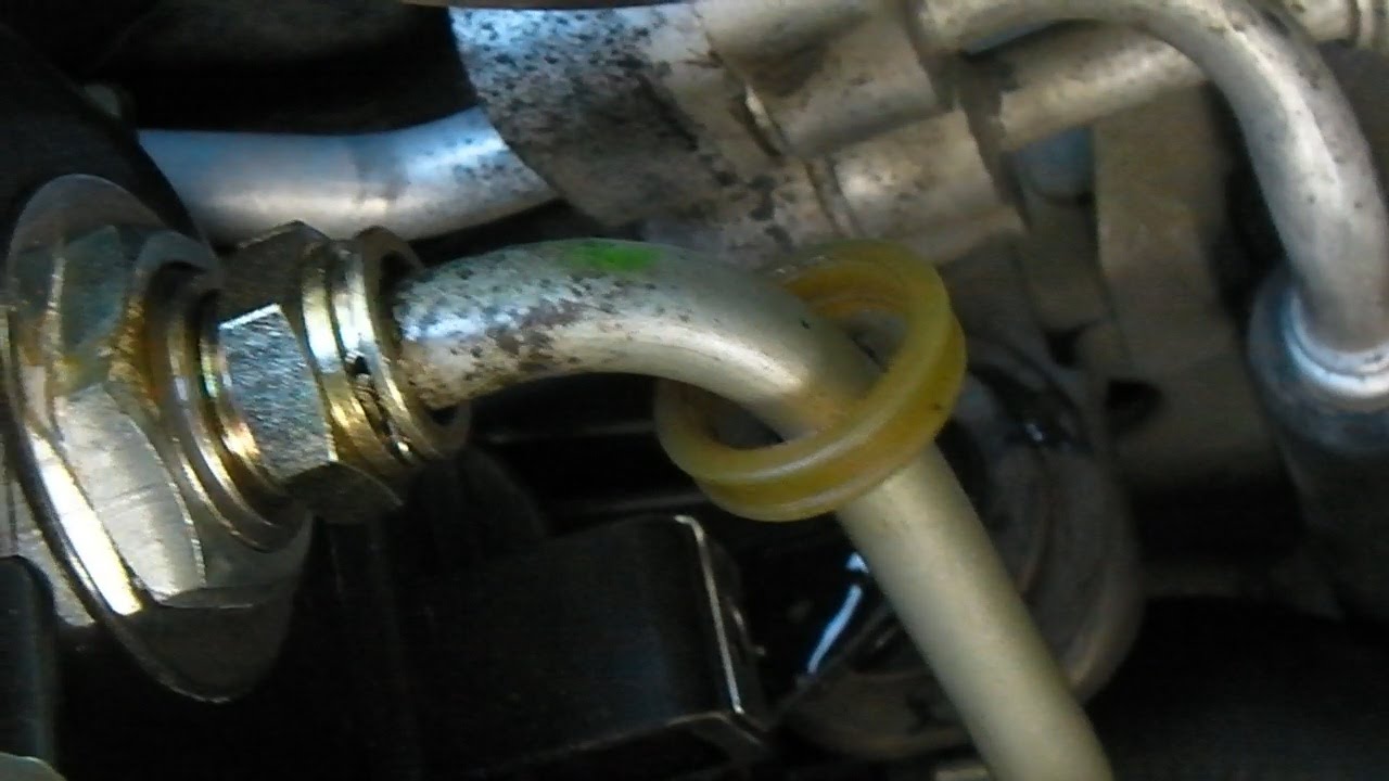

Me and my brother did it in an hour or two and it was very easy for us home mechanics.
Price: I dont know, sorry
Things to look out for: make sure they put the black collar back over the clips for the transmission lines (bottom of radiator). We forgot to do it on mine and it drove fine for a whole 1/2 mile before the rpm's violently started lowering/rising and parked me in the middle of the road with a lake of red fluid leading up to me :)
long story short the tranny lines connect to the radiator via clips which are held in by black collars. They are very easy to forget and can take a little ride before giving out. Just my horror story.
picture with collar off:
