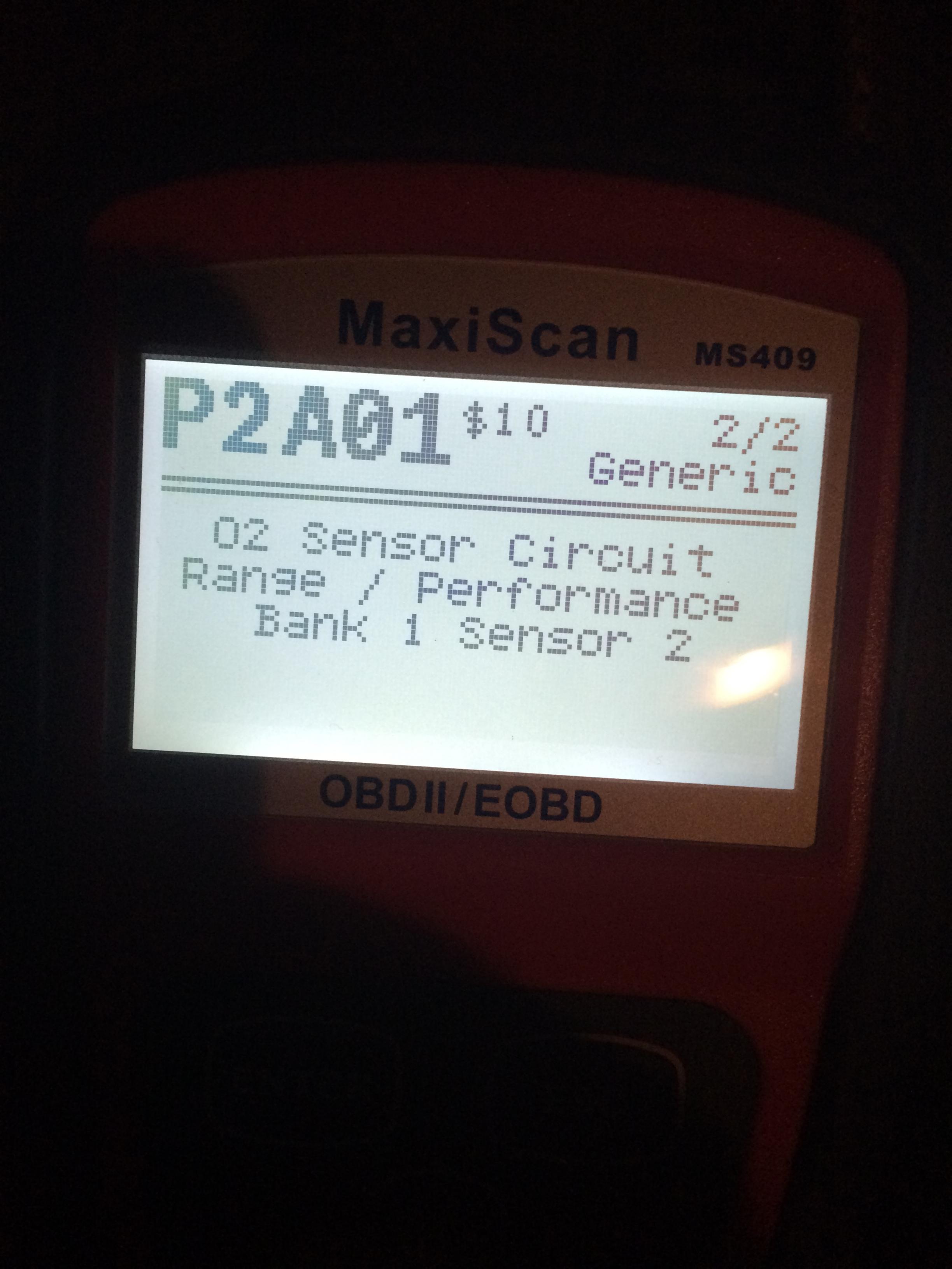

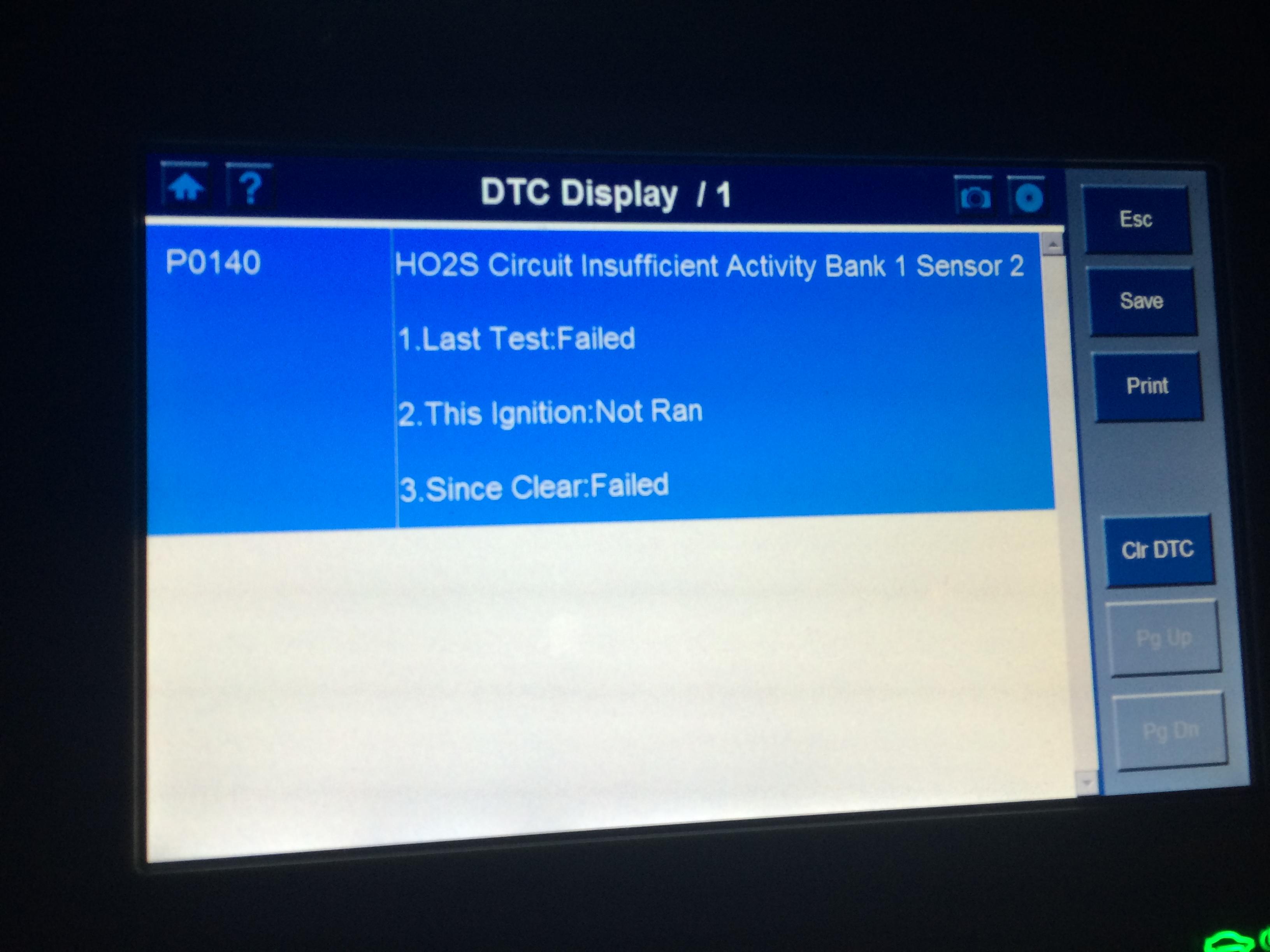

P0140 and P2A01 any suggestion?
Ali Jamal
33
second O2 sensor is changed same codes appear cel is on again after i cleared it :gaah:
any suggestion?
thanks in advance.

Did you replace it with an OEM sensor or another brand? Non-OEM could be the issue. Watched a friend fight it on his Jeep - replaced four sensors until he bought an OEM one then the issue went away.
Ali Jamal
33
I found that the original one is made in japan but the new oem id assembled in U.S.A
