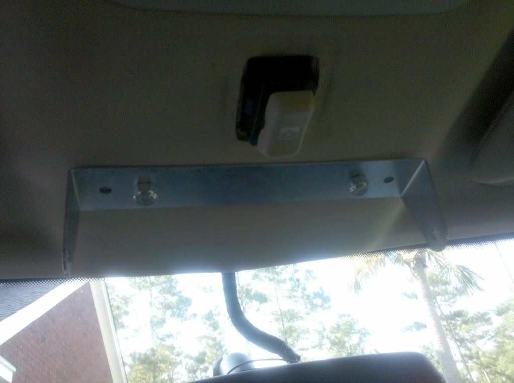

I thought I had a thread here on my CB install but cant find it so I'll add this here.
Here is where I have my CB.
Here is how it is mounted.
For reference, I believe there is a brace that runs between the B pillars between where this monitor is mounted and the dome light.

Steve#1 i like your install looks clean and simple did you trim around your bracket? Or sandwich the headliner?.
There are cross braces at various points on the roof. You can see in your picture that little plug? That is the line where the cross braces are (you can screw through the headliner there w/a 1/2" screw and not worry about puncturing the roof (Note: I take no responsibility if you puncture the roof :)). The headliner sits about 1/2-1" below the metal roofline (perfect for adding sound deadening and insulation if you feel motivated)...

I just cut slits in the headliner for the bracket to go through so, yes, I would say the headliner is sandwiched.
I used a piece of I believe1/2" plywood glued to the roof to mount the monitor which was the right thickness to fill the gap.
