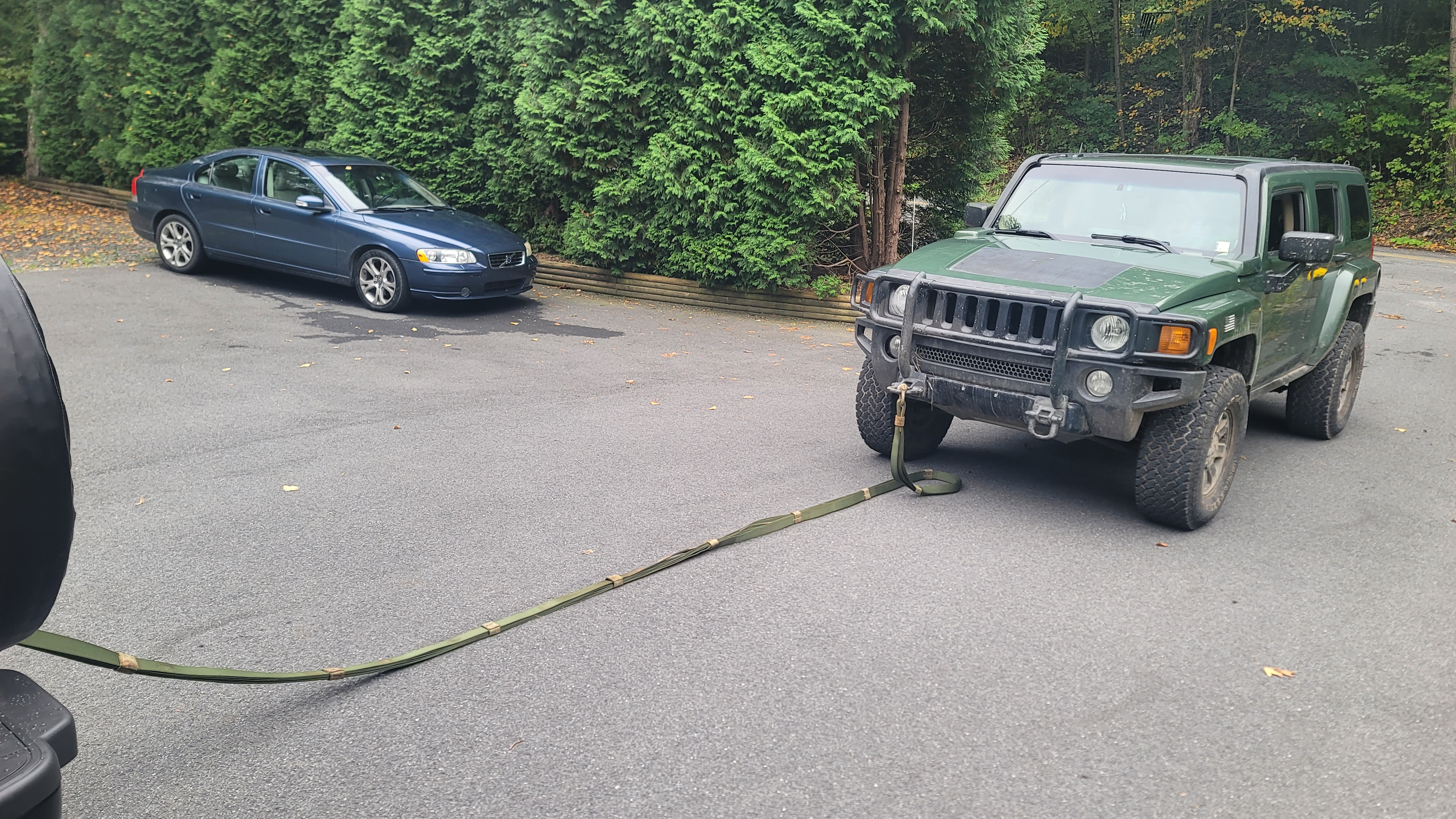

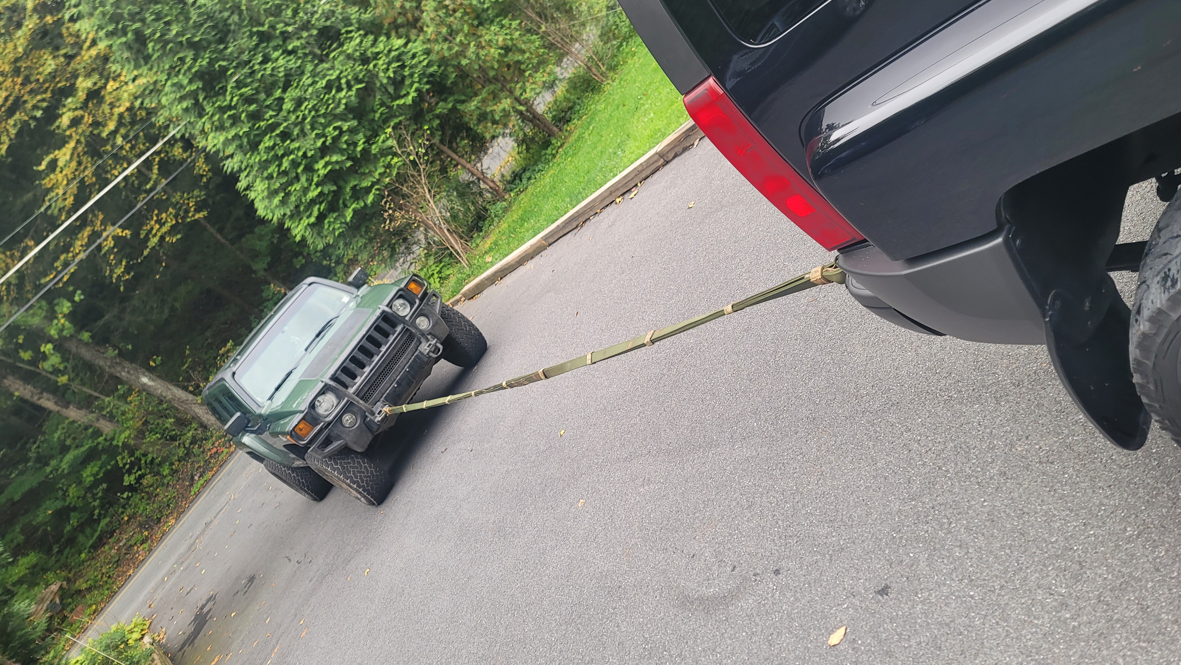

I just had the same exact thing happen to my 06 today. I was off roading at Rausch Creek a couple weeks ago and heard some clicking coming from the front left while accelerating. We thought it was surely a cv shaft. Changed that but still clicked. Found the front drive shaft boot was almost completely gone at the cv joint by the transfer. Changed the drive shaft but still made the clicking noise while accelerating. Drove to a mechanic uncle of mine who said it's probably the front diff. On the drive home, about 300 yds from the house, it broke with all the same symptoms as described as hummedout. The only difference in symptoms, from what I understand of his symptoms, is that mine WILL stay in high lock. The front drive shaft spins, the rear doesn't just like hummedout. Good thing I had a spare H3 to pull this one back to the house 🤣.
I'll keep everyone posted as I diagnose and repair this thing. Any advice is appreciated. And good luck hummedout. I hope I'm helping your thread, not distracting from it.

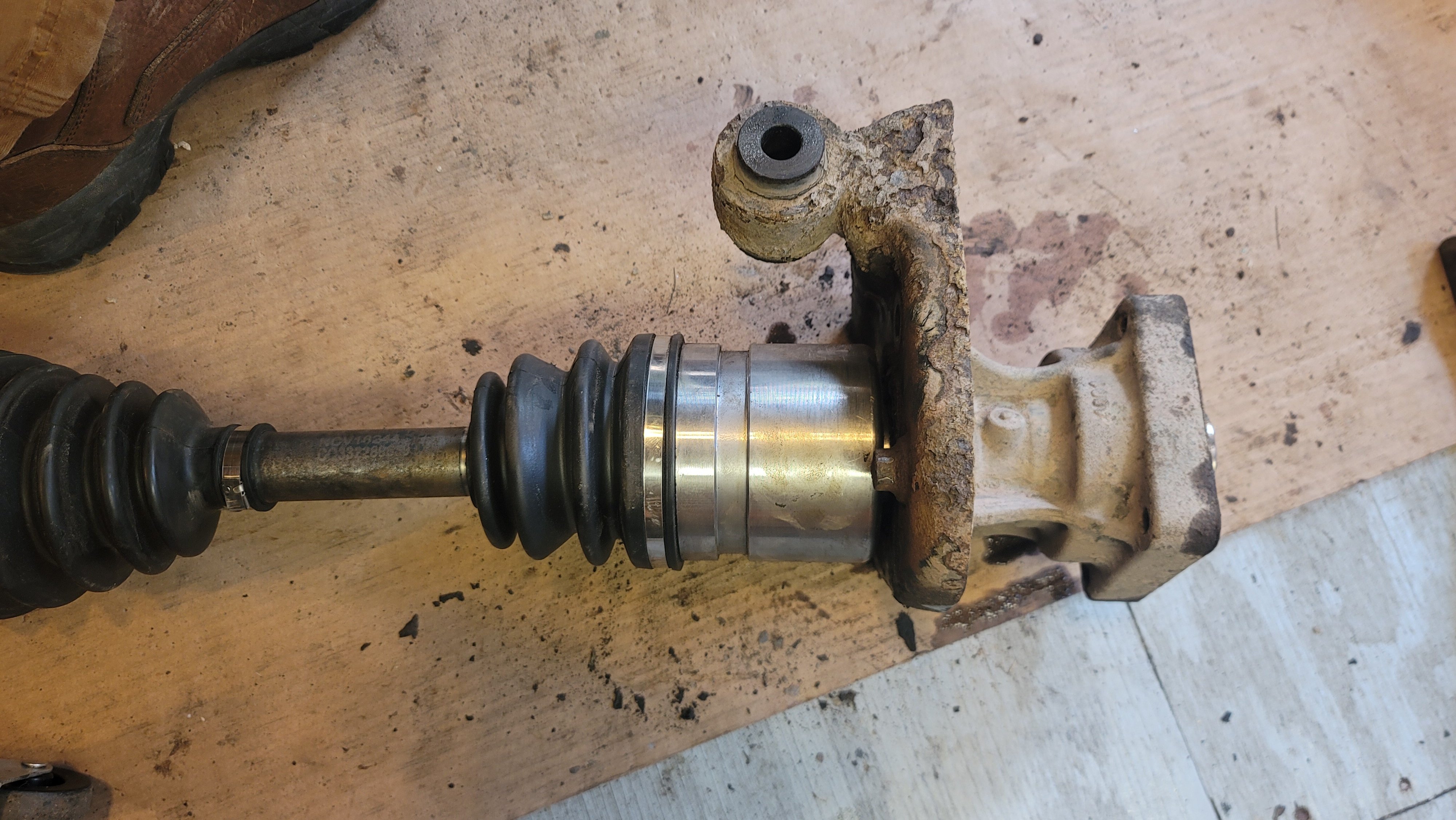

Update.....front dif is fine, intermediate shaft is fine with no metal pieces in the shaft housing. CV shaft is stuck in the coupler (I think that's what its called). See picture. So I'm thinking the problem lies in the coupler or the carquest(not AC Delco) CV shaft. It was about 3/16 shorter, compressed, than the old CV shaft that I removed. The clicking noise actually did get worse when I put the new CV shaft in.
I also snapped the bolt that holds the coupler to the frame. I have no idea how I'm going to solve that problem yet. Good times.
Hummedout, did you get your dif replaced? I was thinking about going that route until I saw the dif was ok.

I got the CV shaft out of the coupler with a little hammering from the inside on the end of the shaft. The c clip was really hanging on. I can't find anything wrong with any part. All seem to be in good shape. Clean oil, no shavings or chunks of metal anywhere.
With intermediate shaft removed and passenger front tire jacked off the ground, I start it and put it in drive and everything seems to be working properly in the dif. Pinion spins ring, spins spiders, spins side gears both in the same direction. But the passenger CV shaft and wheel don't spin. ????No grinding noises either. With engine off, I spin passenger wheel which spins side and spider gears but not the ring gear. I think this is all correct. What am I doing wrong? Or missing?
