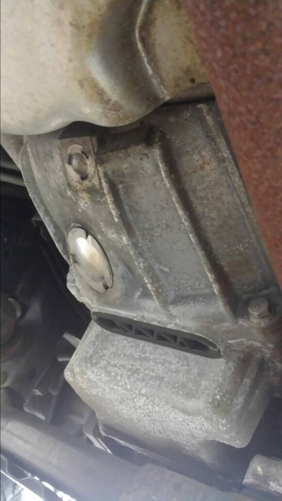

I am trying to figure out a metal noise when driving it only happens for a few seconds at different speeds. Has a tin sounding noise to it. I went underneath to see maybe if it was a heatshield but they dont budge at all. I found this metal circular thing on the bottom of the trans that moves and maybe is the cause of it. I took a picture. .. anybody know what this is and should it move? Thanks

I have had the same issue since March. Very annoying. My "rattle', just as you describe, can be heard at 1k and 2k RPMs then goes away. I have checked the muffler/catalytic converter heat shields more than a few times but that are fine. I've had the dealer try to figure out the source and no luck so far. Let me know if you figure it out and I'll do the same.
Sent from my DROID RAZR using Tapataint
I had a similar issue earlier. Managed to replicate it at the dealers by holding the brake pedal as I was revving up my engine while on Drive to that specific RPM it rattles at. It turned out to be a loose front skid plate in my case.
10,660
Another common noise is the heat shield on the exhaust manifold. Loose skids are common. Even had it once where a loose aftermarket center cap caused it on one of my wheels.

I had the same kinda noise the dealer thought it was the heat sheild on the convertor.It turned out to be the guts in the convertor broke apart.If you hung onto the convertor it would quit.

Got it up on the lift today. I drove it while a friend checked it out. Sound is coming from the heat shield on the exhaust. Heat shield itself is tight but there were a bunch of worm clamps with the excess metal not cut off. Took the excess metal off and rechecked on the lift. No noise the ride home :D. Im glad it was something simple.
