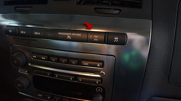

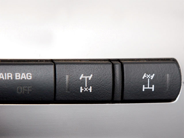

Also please correct me if I'm wrong, but want to also double check that the Adv. Package is indicated with the rear locker button above the radio, correct?

315/75R16's, and yes, adv pkg will have buttons top right above stereo on same button bar as the 4high, 4high lock, and 4 low lock( on top left)
