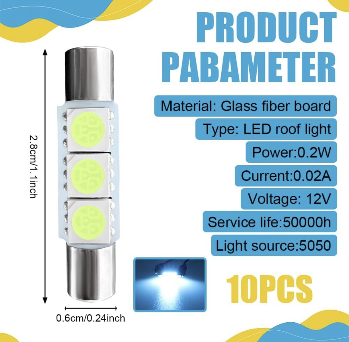

I have had LEDs in all the interior locations for years with no issue, might replace the vanity with different bulbs. The FV on the LED may be causing issues.
I attached the only specifications on the vanity bulbs.
