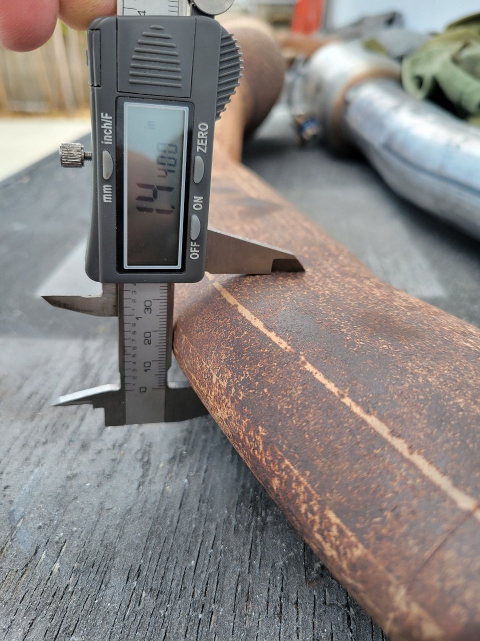

Got the new rear cat, Walker Ultra EPA 54480. By comparison, the pipe alone should gain me 100hp. The stock 2.5" pipe is horribly pinched. For a few more $$$$ I'm sure a good shop could make a free flowing pipe. But, I need quick an simple.
Make sure to install the manufacturer's stickers in that box to unlock the full HP potential.

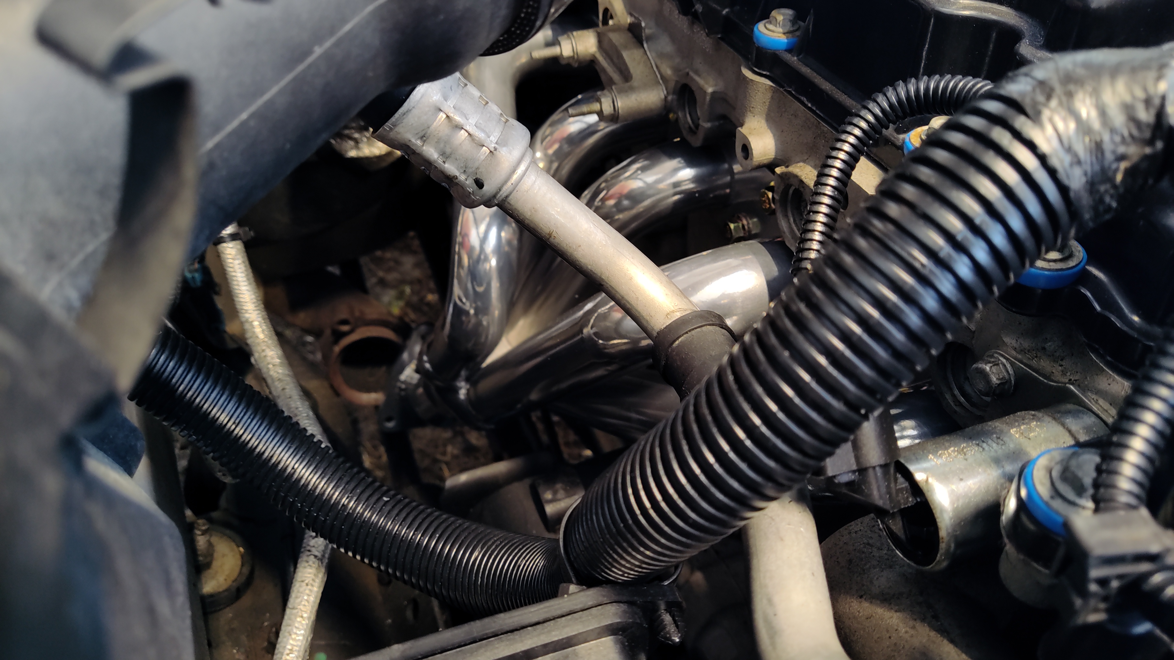

shoot - i didn't think nobody still had a LT header for these. every time i'd looked for one, everybody was out of stock.
this colorado one fit right?
Ridinhigh1500
35
Raleigh, NC
They are basically made to order from the place in California and the fitment is excellent. Since putting it on the throttle response is amazing and it sounds awesome too.
