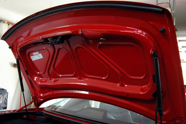

Here are a few pics of my 18 year old Reatta when I sold it. It had over 120,000 miles on it and had been driven in every Michigan winter for 18 years. It was my daily driver - as is my H3 now.
